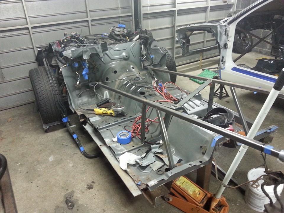

Thanks ......no rack issues th a im aware of yet .........I will be using the rack setup from the camaro ......so it wo t be on the fire wall like it was on the beretta. .......that would be a problem :b

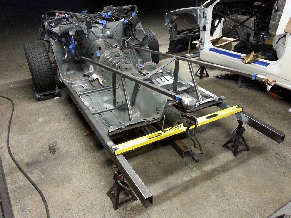

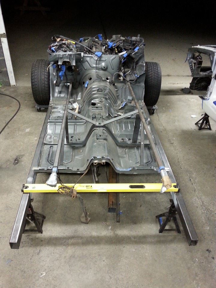

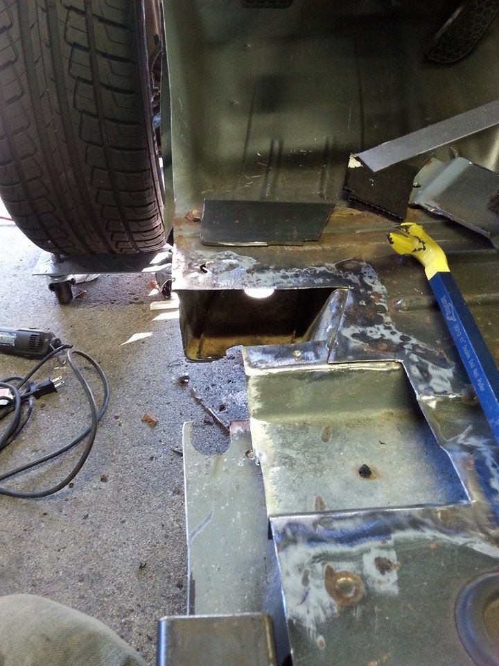

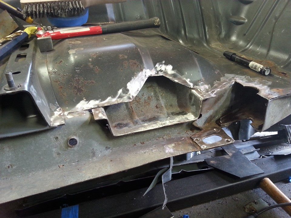

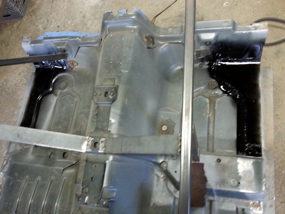

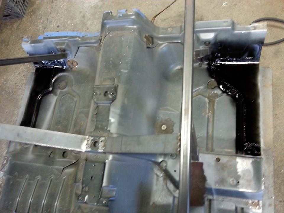

Just more cutting .......floor and front wheel wells of the camaro narrowed down to 48" ....camaro front rad support and frame rails next to go under the knife
Re: Beretta Z28

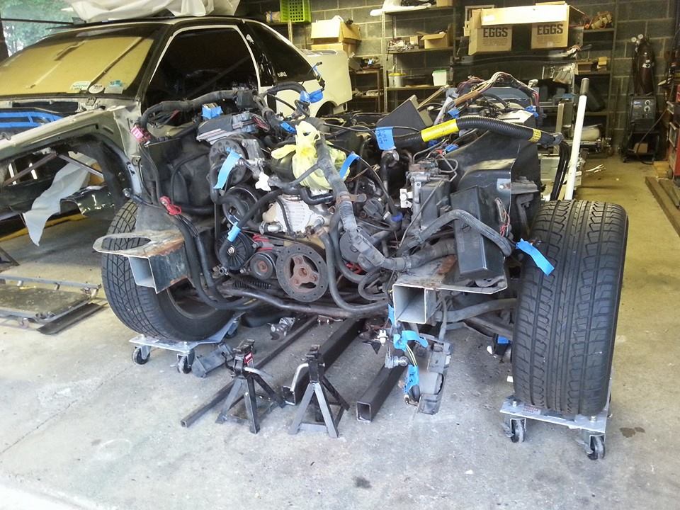

removed rad, and overflow bottle, battery tray and air filter to clear some room up front........ front rad support and frame rails cut.

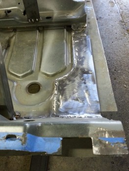

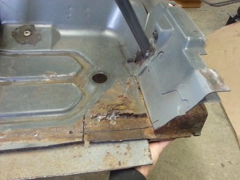

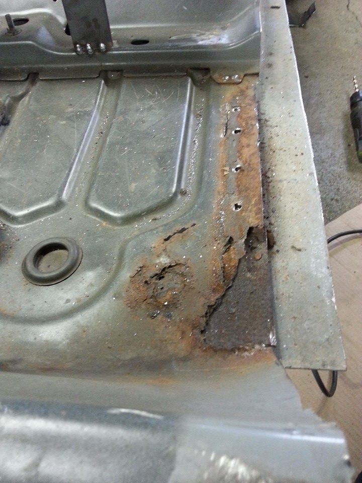

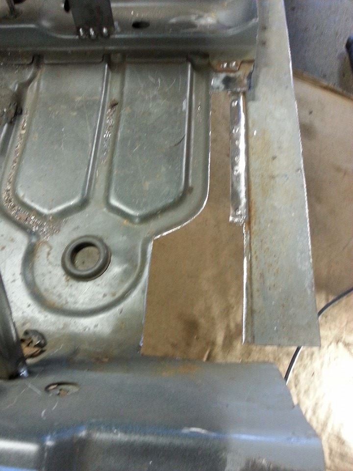

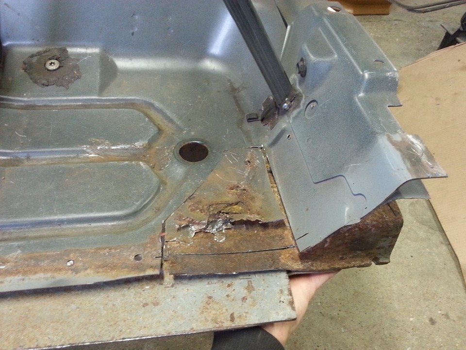

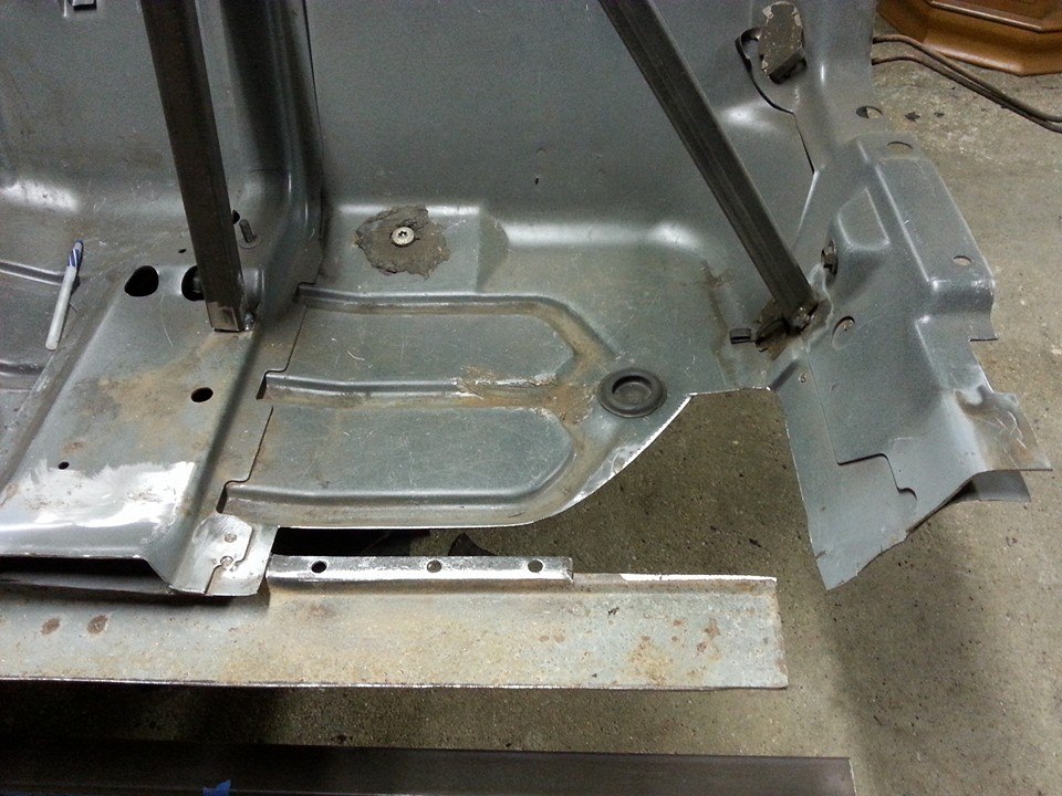

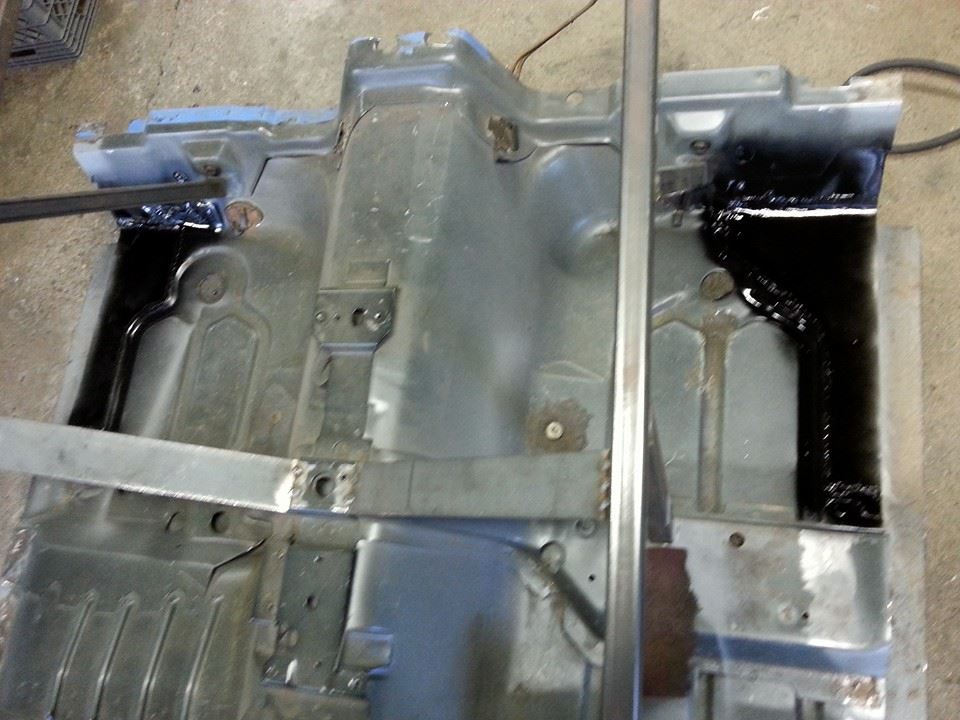

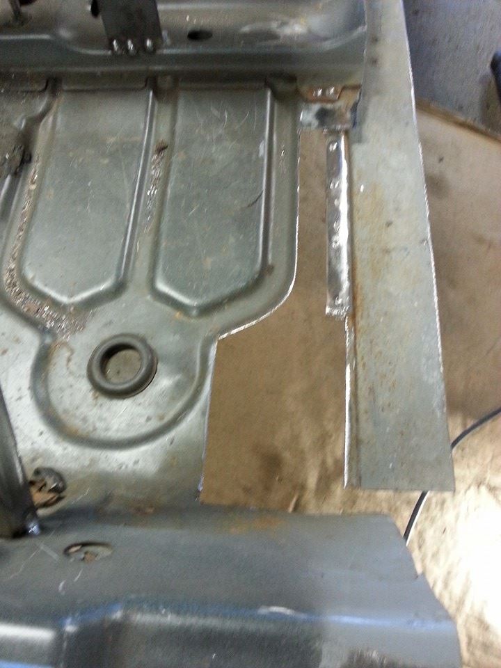

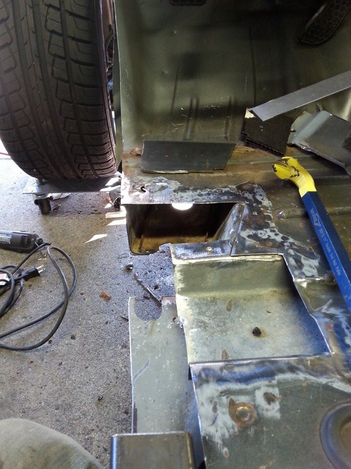

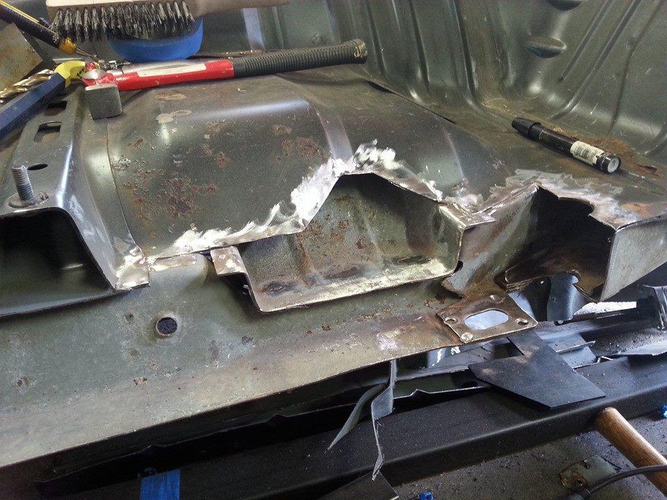

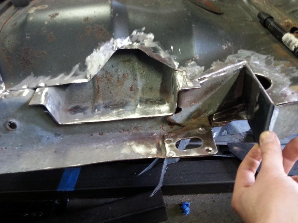

Cut out all the rot on the rear floor pan and cut the rest of the old rusted rear subframe out from under and replaced the new floor section ......almost ready to set in the body rails

Amazing build work going on there.
A bit shocked about that rot..but for that particular build, doesn't matter at all - Its getting royal treatment anyways! Keep it up. Following closely.

yeah.....rust sux!!!! but its gone now .......got another spot/spots to touch up on the front floor pan too but over all i think the rest is fairly clean........ either way im not gonna let it stop me

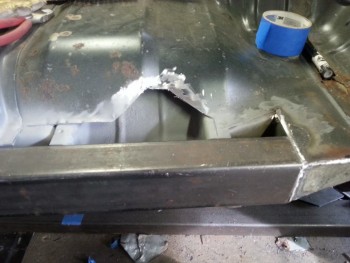

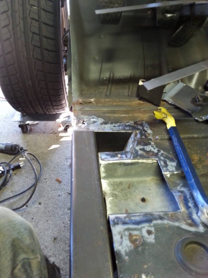

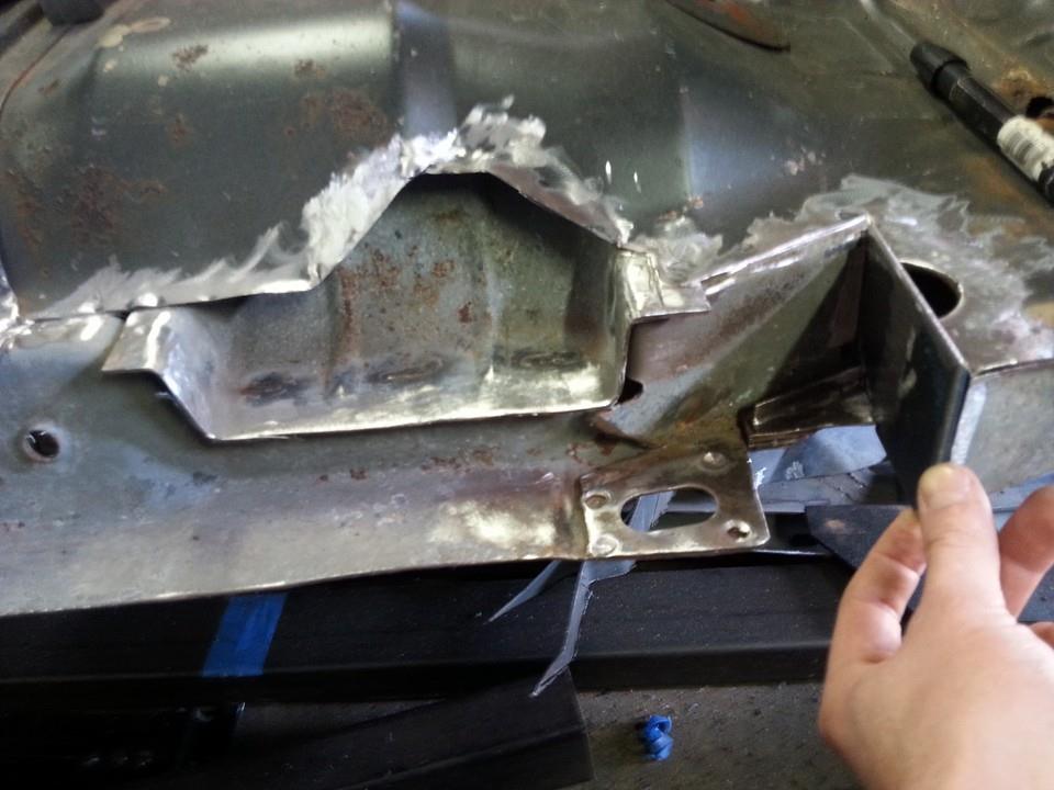

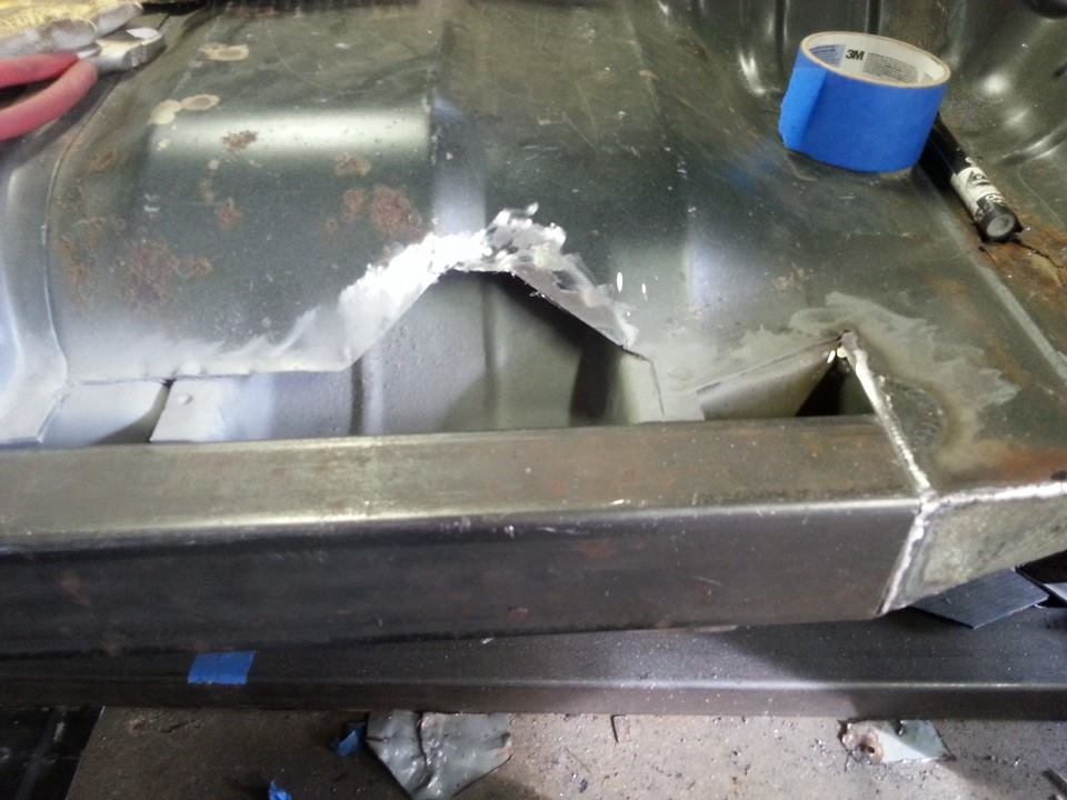

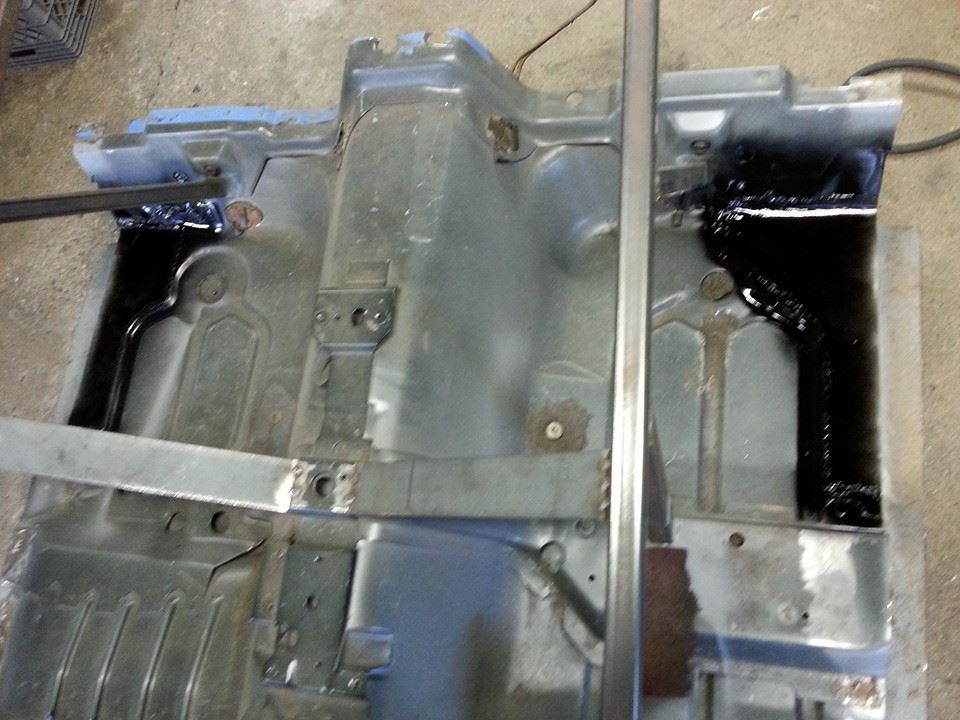

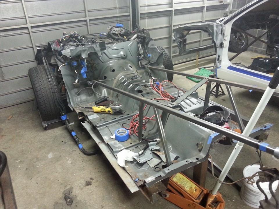

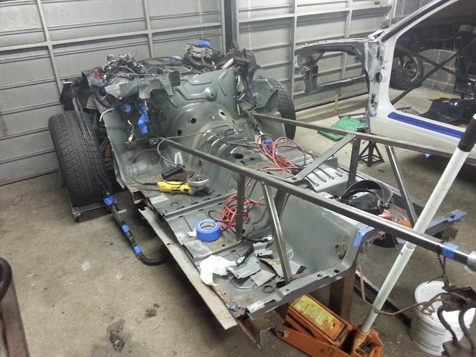

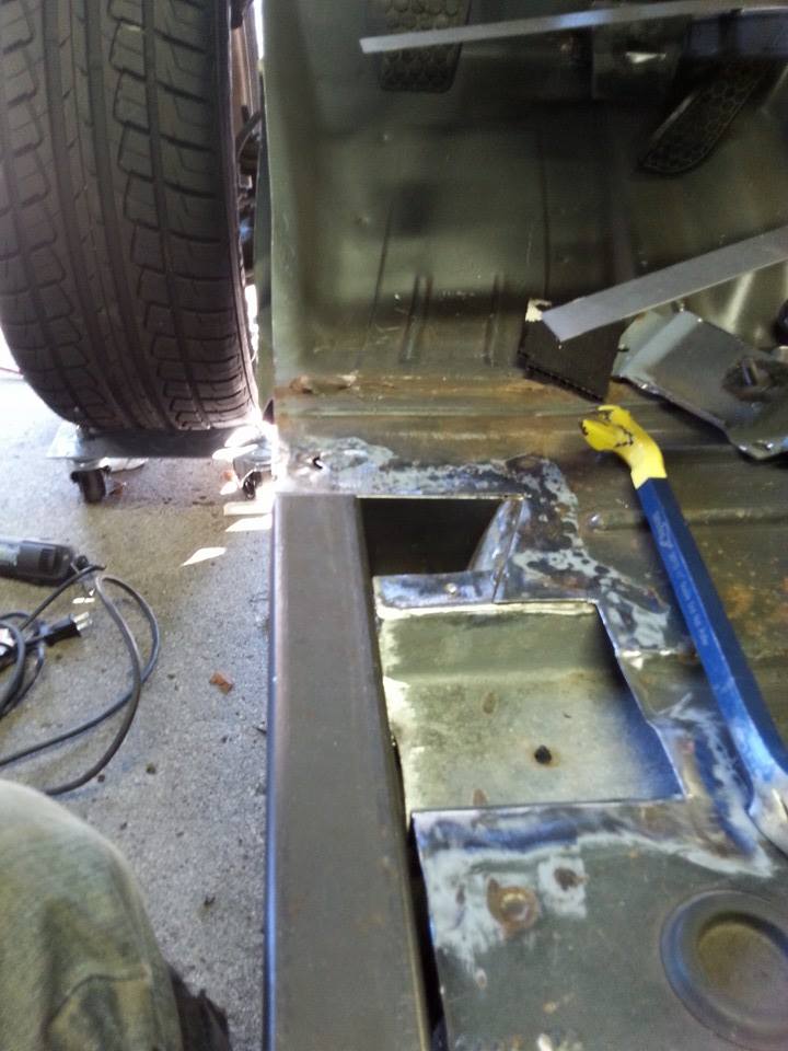

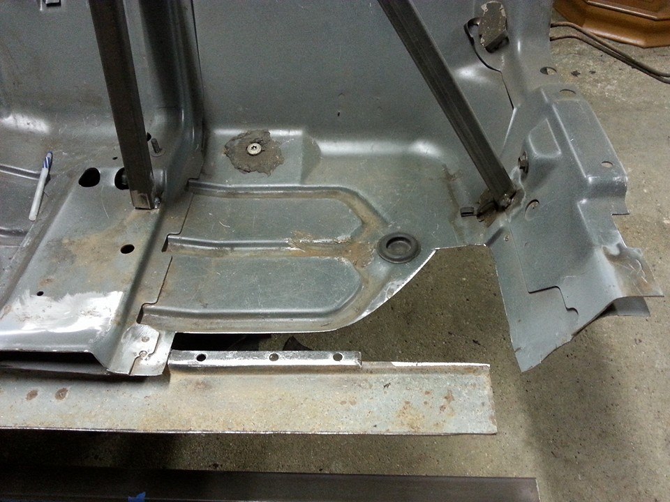

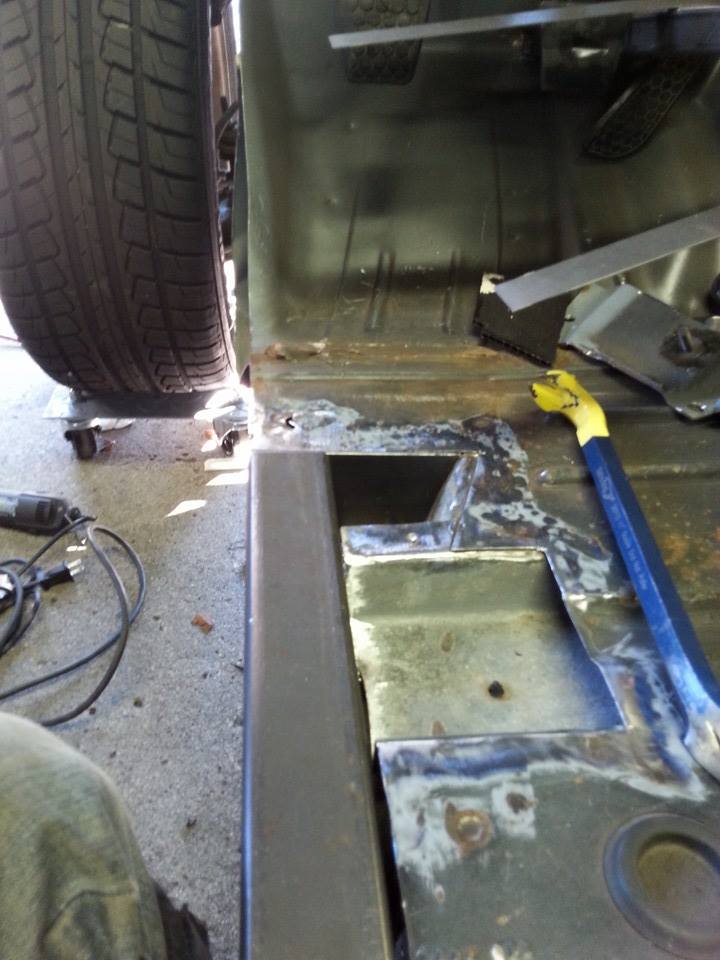

Front frame rail block off/tie in plates mocked up and final fitment of body frame rails. opened up the little windows on the floor pan so i will be able to weld the cross members into the rails for extra strength too.
driver side
driver side

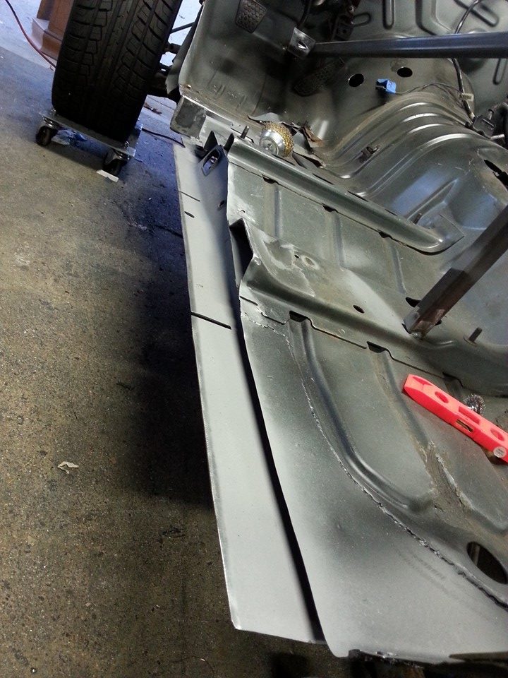

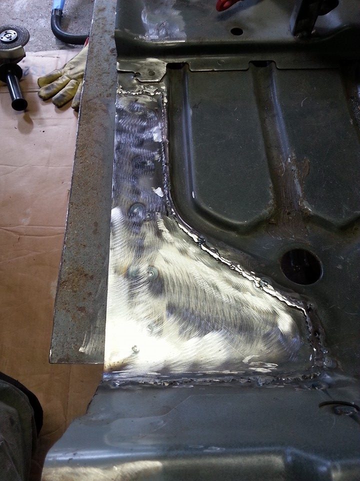

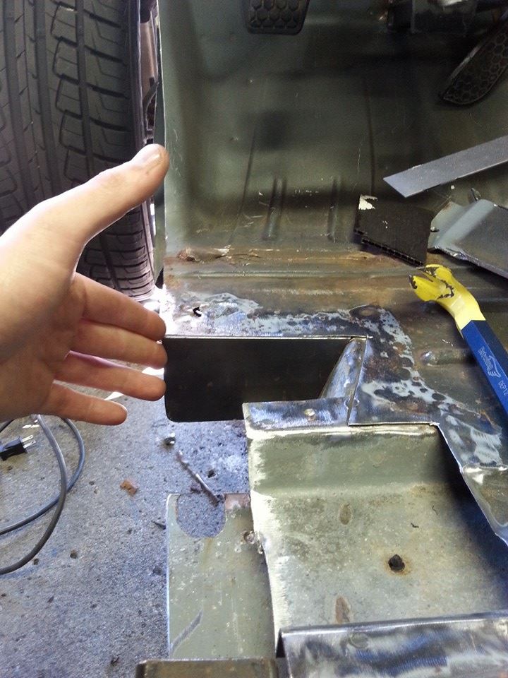

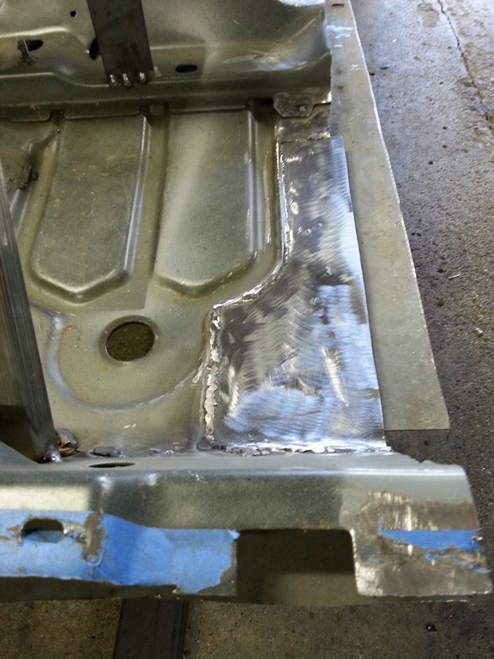

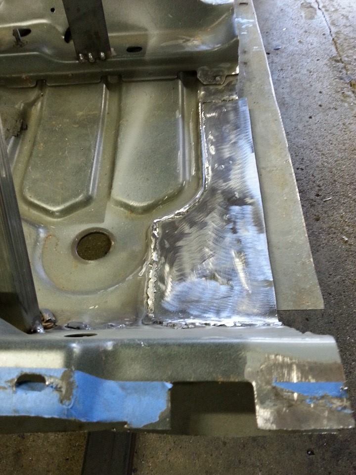

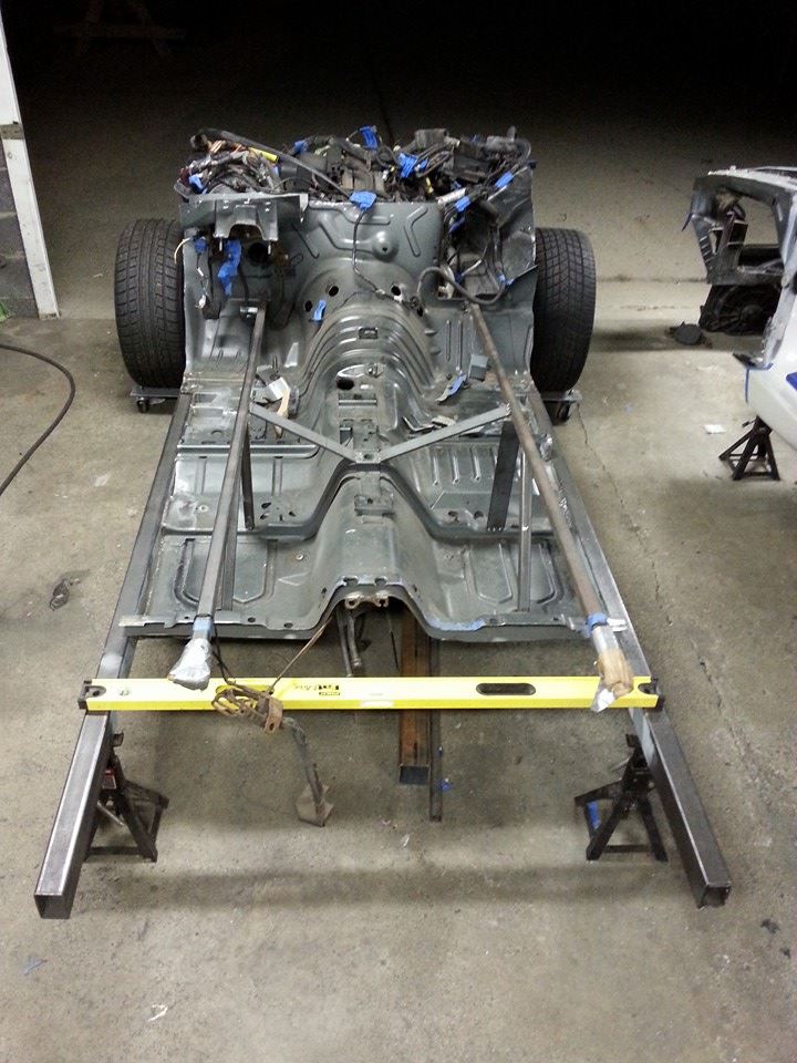

Cleaned up the old rail inners and welded in new body rails on floor pan....
