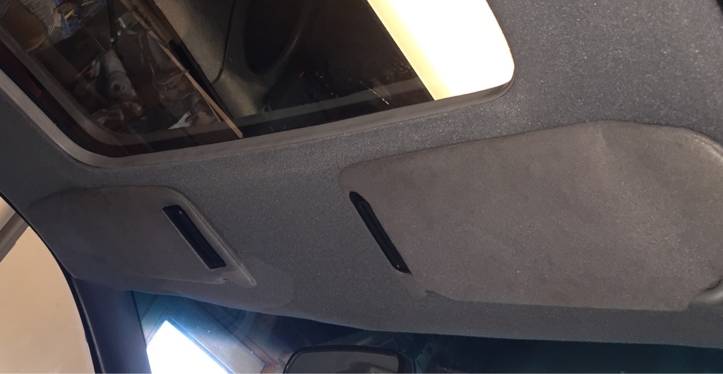

Many small things done this weekend

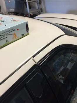

Cadillac visors installed
Small weather roof stripping installed
Interior plastics

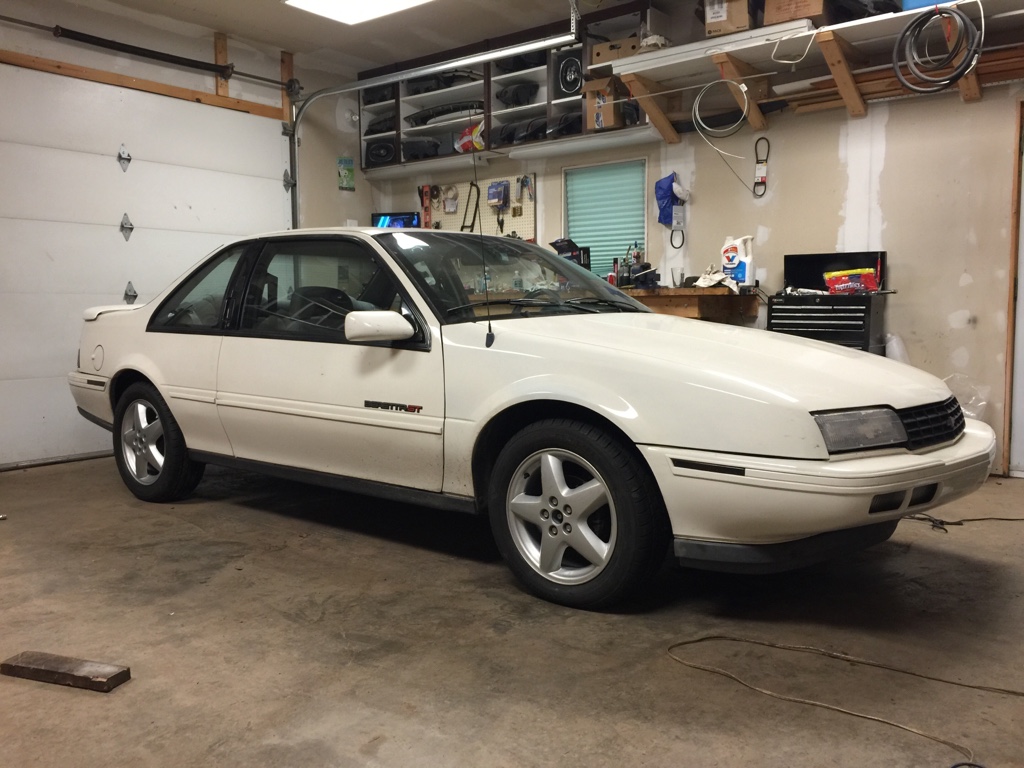

Installed new rims and Tires

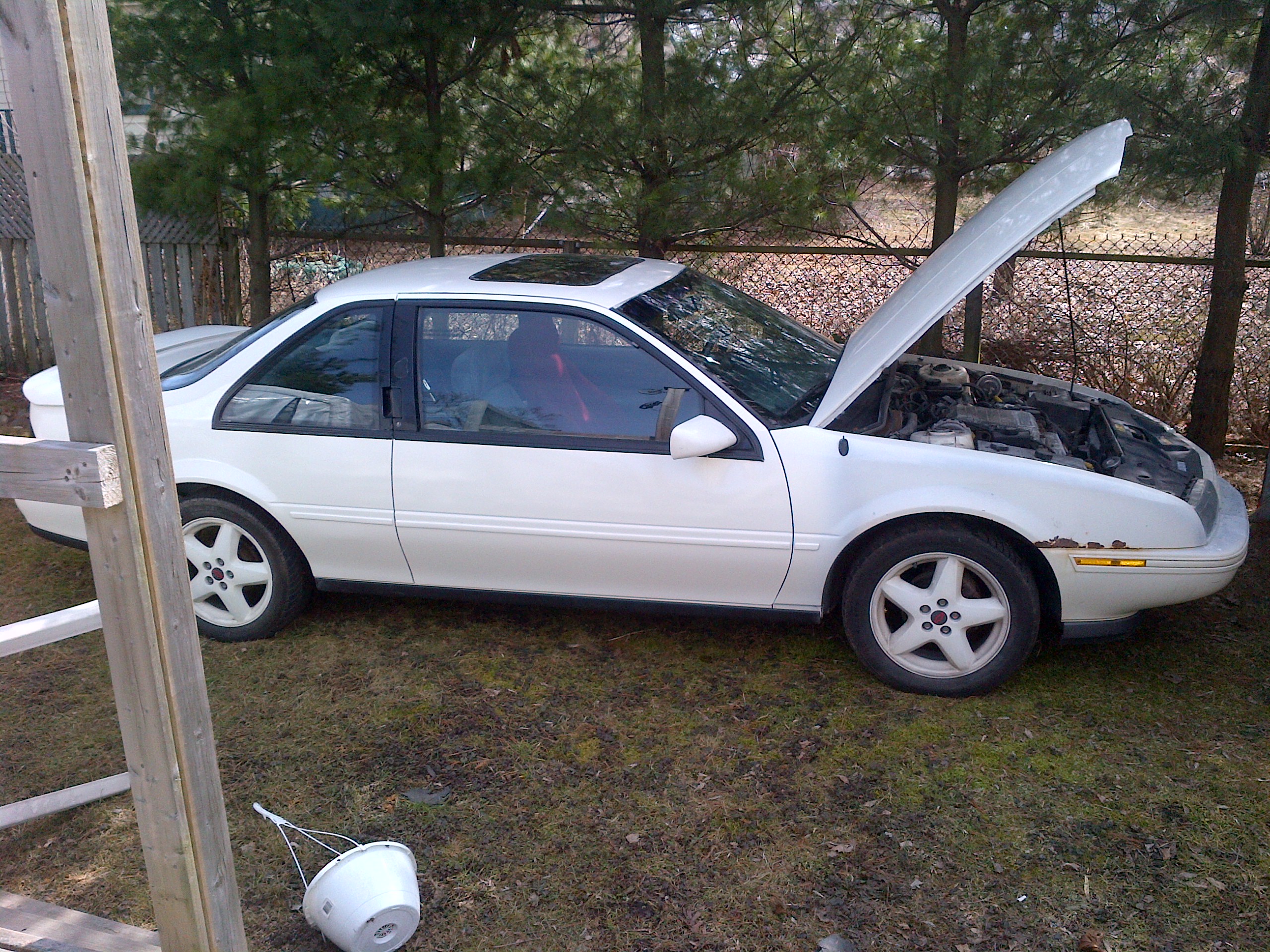

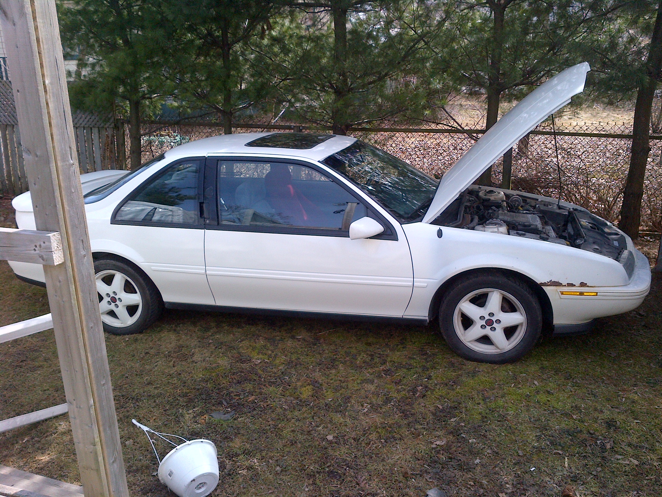

Re: Don't mess with texas - 3400 swap project

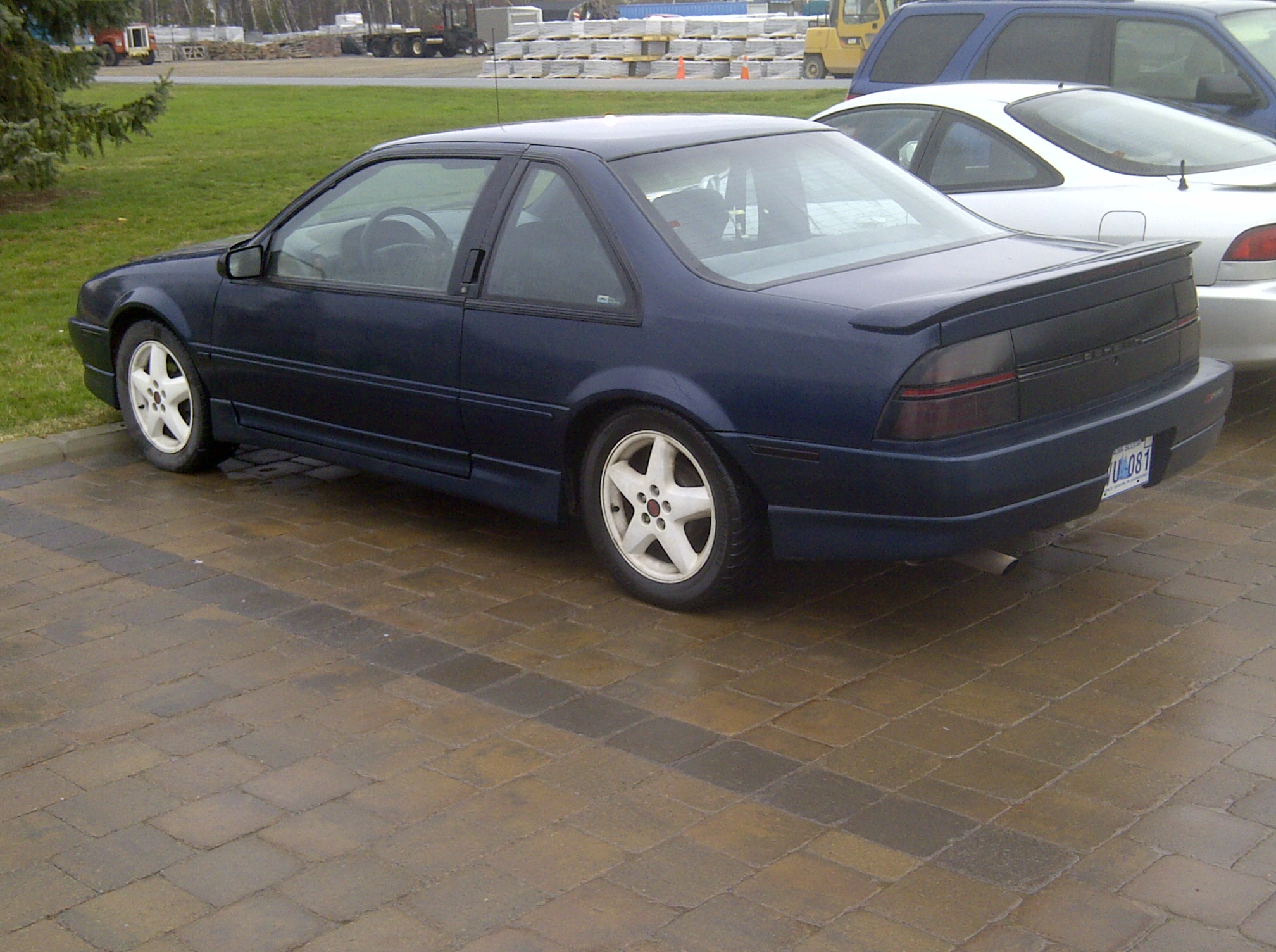

Man that thing is clean. What wheels are those?
Posts: 1832
Cavalier Z-24 16" rims, circa 1997. I ran the set from my '97 Z-24 on my Turbo 'Retta for a while, but for some reason it made the car sit wrong and made it look like a giant Matchbox car. :no: Now they are scattered amongst my front-drivers as full-sized spares.
I like those sun-visors! Nicely done. I have Olds Aurora sun-visors in my '90 'Retta, it is a cool set of visors but don't fit right like yours do...
Don't seem to be rounded enough, looks more like G6 wheels to me. I see a 97 Z24 every weekend.
Rettax3 is correct 1997 z24 wheels with 2003 ztype centers. I spent many hours sanding them and prepping for a professional base clear paint. They were the second set of wheels my original 1995 2.2 Beretta had on them (painted white back in the day). He is also correct about the stance, the offset seems a little different but still personal preference going to keep them on the car they hook up better than the 15" tires I had.

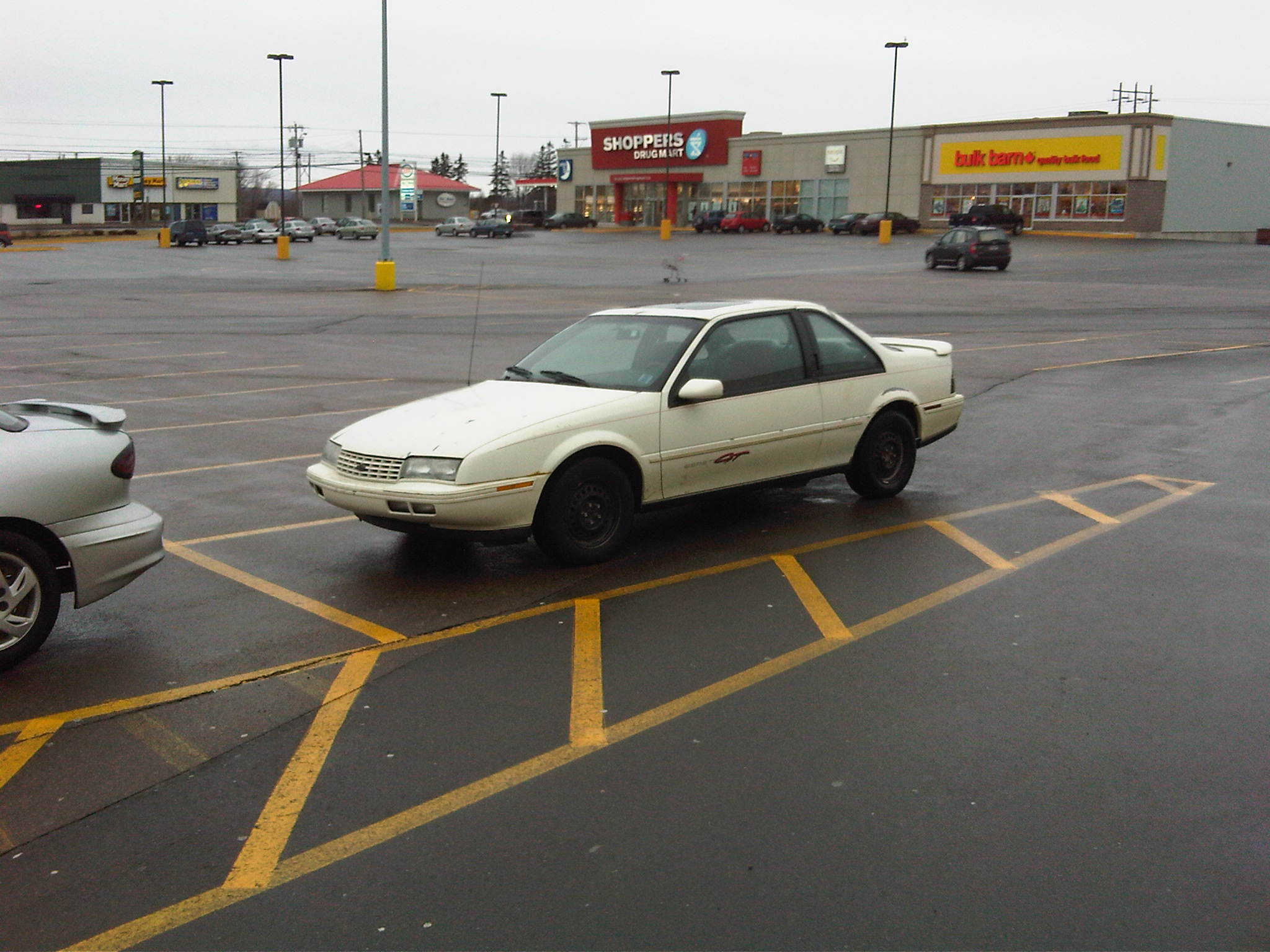

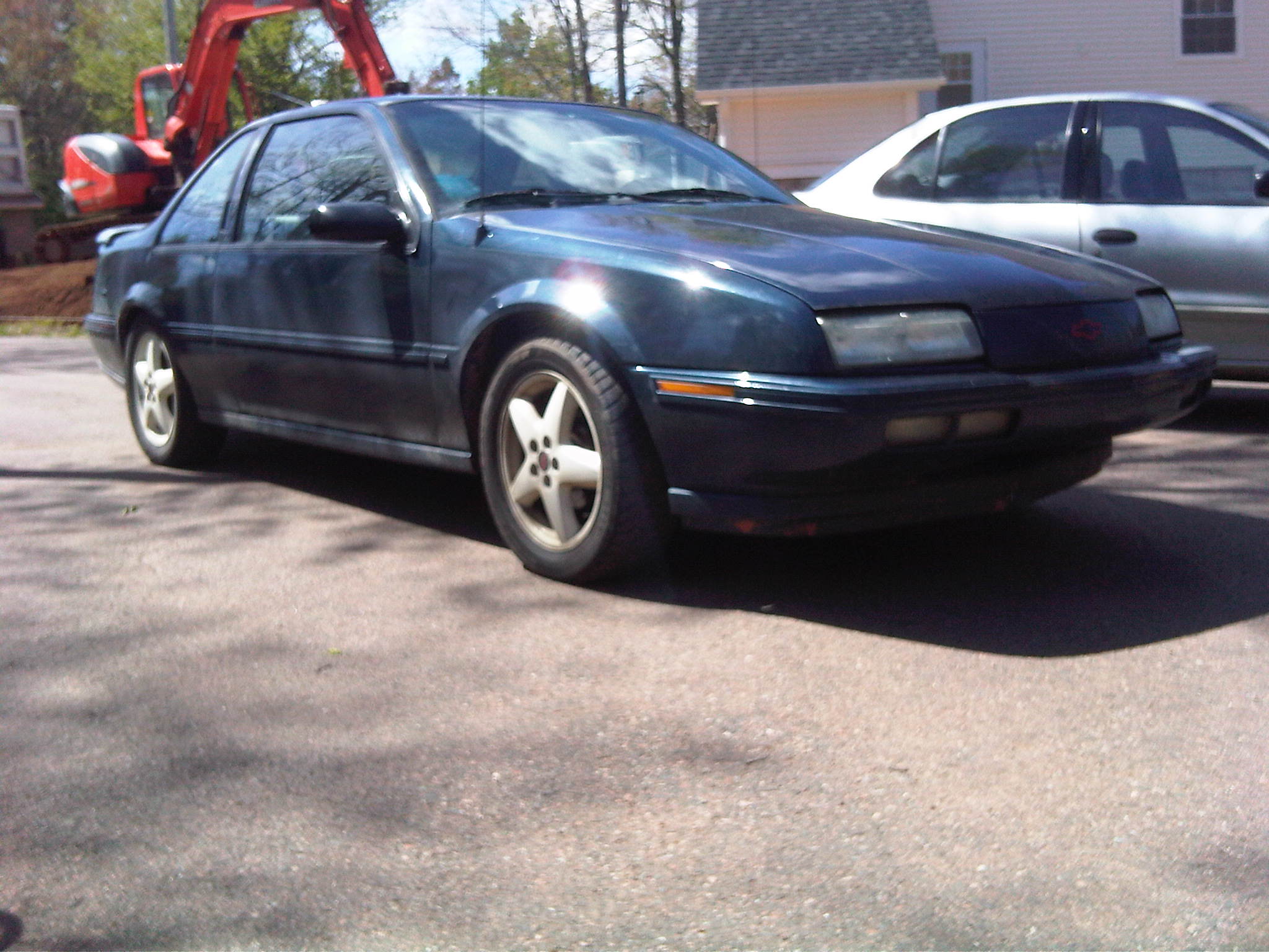

Blast from the past looking though old blackberry pics! Hopefully people on the forum like pictures of old rusty berettas!

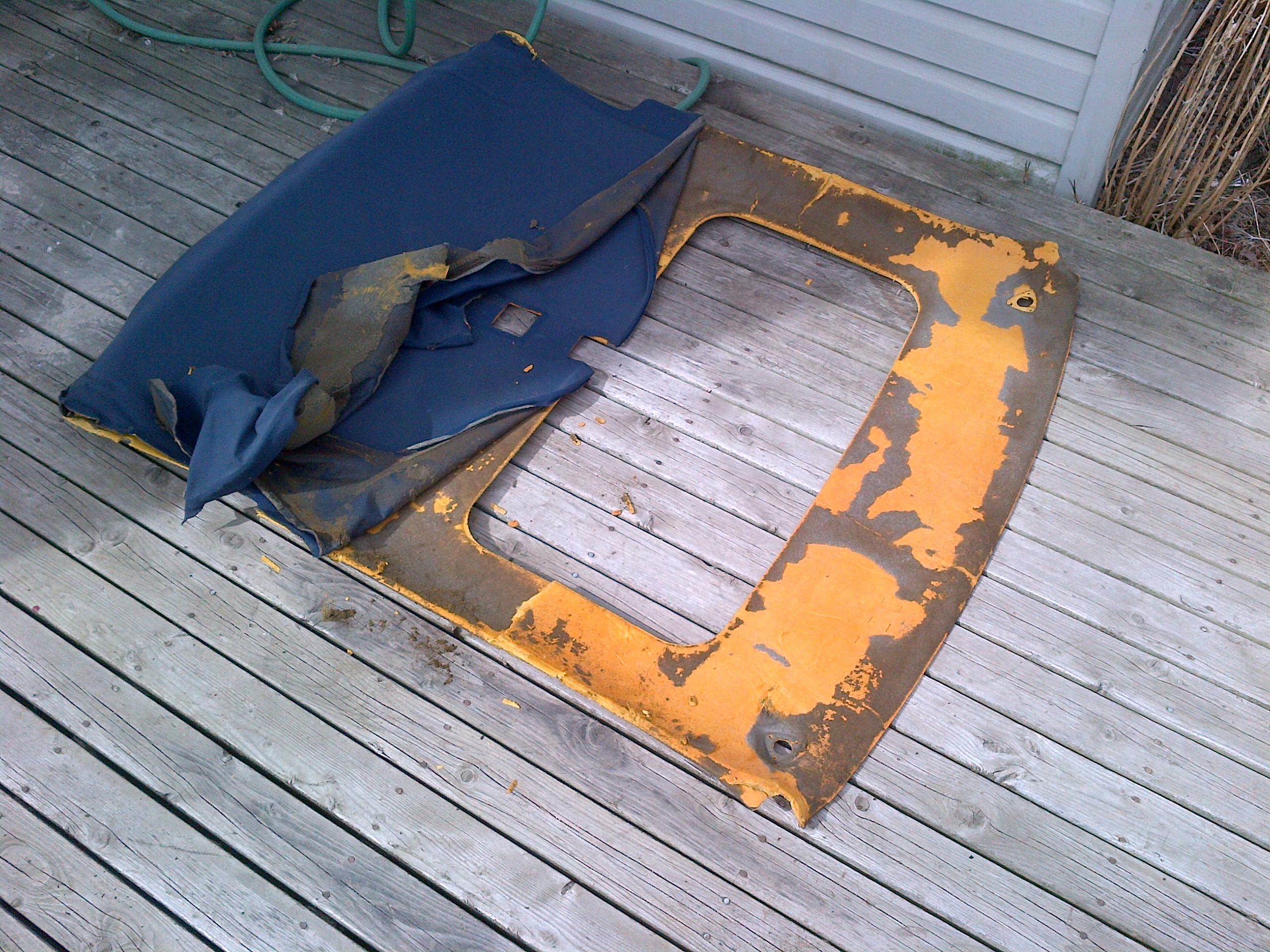

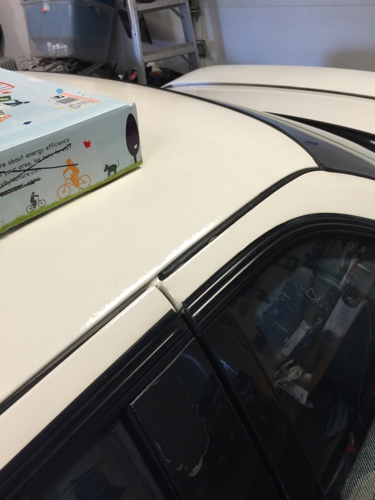

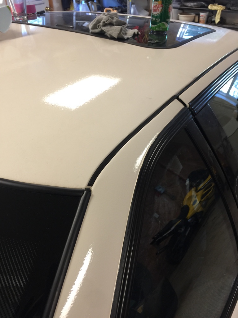

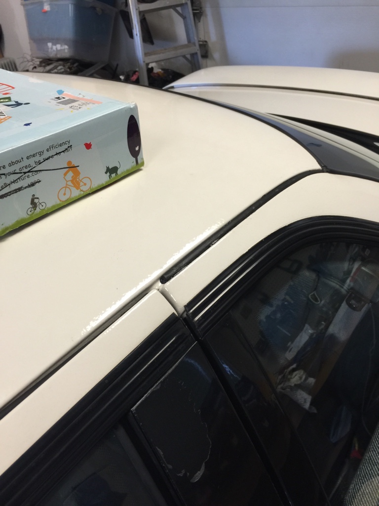

Texas cars poor headliner, came out in 8 pieces. fiberglassed a new one together. Stupid sunroof.
1995 base after Z26 kit was installed (RIP)<br /><br />This was the donor car for fenders
1995 base before Z26 kit was installed (RIP)
Texas car with half its paintjob done, couldn't get aftermarket fenders to finish it. 5 speed swapped
The texas car soon after I bought it. 3.1 automatic 3 speed

themixer wrote:Rettax3 is correct 1997 z24 wheels with 2003 ztype centers. I spent many hours sanding them and prepping for a professional base clear paint. They were the second set of wheels my original 1995 2.2 Beretta had on them (painted white back in the day). He is also correct about the stance, the offset seems a little different but still personal preference going to keep them on the car they hook up better than the 15" tires I had.
Man, you are so right about the way those wheels effect the Beretta's grip -I don't think I was able to turn my '90 hard enough to lose lateral traction, and I was actually able to launch that car pretty good with those wheels on it too, whereas everything else I've had on it just spin, with or without the turbo spooled. It is really bad on that car now, since I got the 3.4 with the headers and the big-@$$ T-4 together and back under the hood.

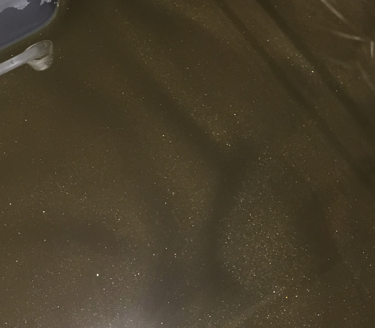

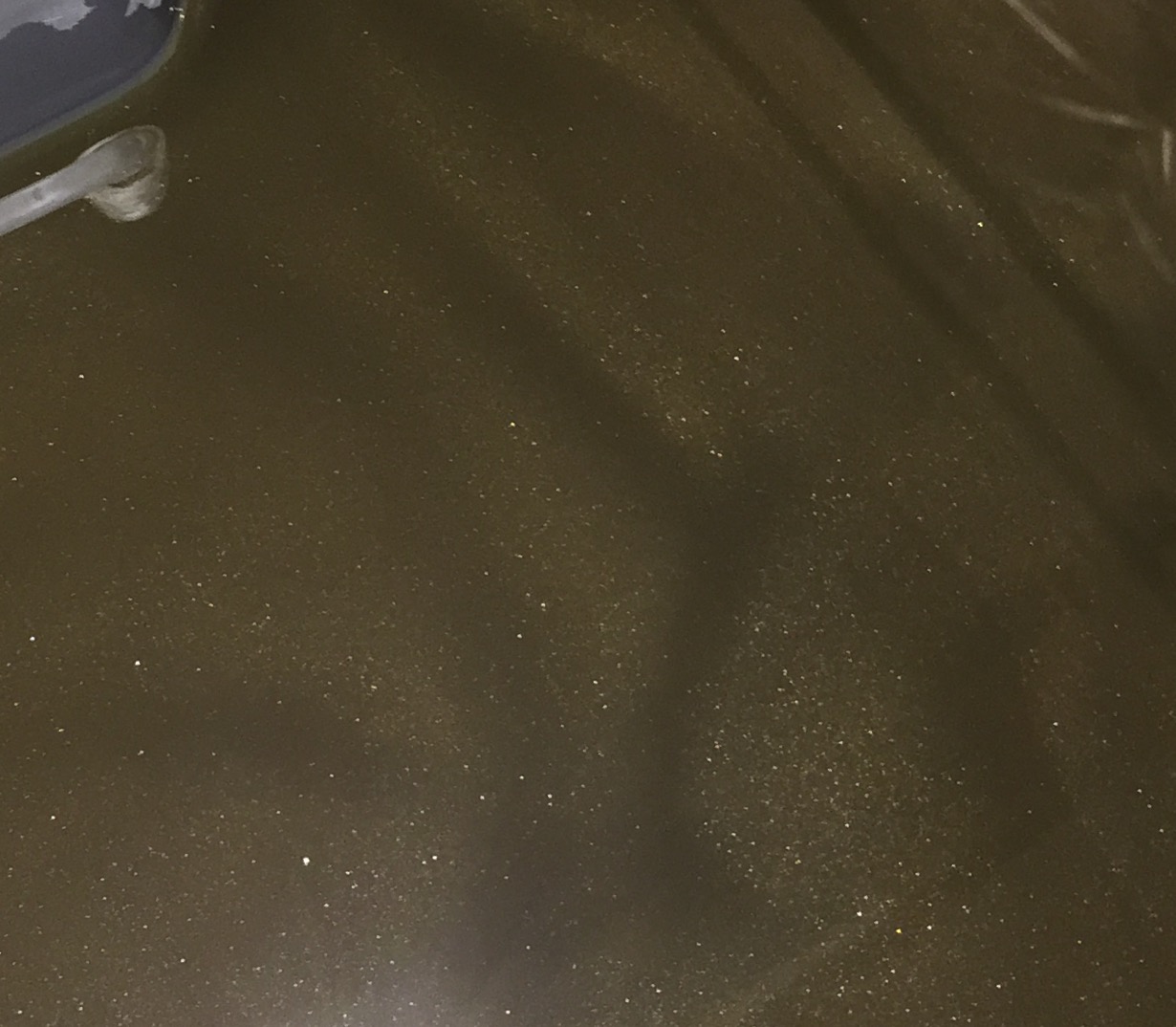

Bad news tonight there is some metal floating around in the transmission! So mine is being ripped off and sent to the dealership for repair. 240k on trans with 80k of my aggressive driving about 5-8k on the 3400 swap. I think it had a good life.
I read that heavywoody may have a rebuild kit no longer required so sent a PM, if not going to order one off ebay. Hopefully the bearing that is no longer available is still good on mine.
Not a good day but shouldn't be too bad to change out.
