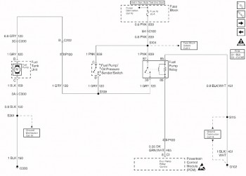

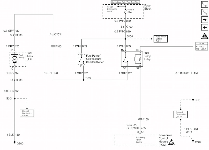

I can't find anything that I can change to modify the time it runs or when it clicks on. I believe the oil pressure PSI setting is manual and inside the OPSU. Now looking at the schematic of the fuel pump system it appears that the relay on the strut tower is only used during the priming situation... after that the OPSU controls or re-routes power to the fuel pump once it sees pressure.
I will have to check the wire coming from the ECU to see if it's hot when running or if its only hot at KOEO for the set 2-3 seconds.
If this is the case then I can replace that relay with a N.O. delay timer relay that will get triggered by the ECU's output and then remain on for up to 2-min after that ECU trigger is shut off.

This is what the service manual says..
GM wrote:Fuel Pump Electrical Circuit
When the key is first turned ON, the PCM energizes the fuel pump relay for two seconds to build up the fuel pressure quickly. If the engine is not started within two seconds, the PCM shuts the fuel pump OFF and waits until the engine is cranked. When the engine is cranked and the RPM signal has been detected by the PCM, the PCM supplies 12 volts to the fuel pump relay to energize the electric in-tank fuel pump.
As a backup system to the fuel pump relay, the fuel pump can also be energized by the fuel pump and engine oil pressure indicator switch. The normally open switch closes when oil pressure reaches about 28 kPa (4 psi). If the fuel pump relay fails, the fuel pump and engine oil pressure indicator switch will close and run the fuel pump.
An inoperative fuel pump relay can result in long cranking times, particularly if the engine is cold.
An inoperative fuel pump would cause a no start condition. A fuel pump which does not provide enough pressure can result in poor performance.
Re: 1996 Mr.Pink
Ok so the oil relay is a backup. I was going to start wondering that because I heard the relay click after it was running last night.
I'll have to see how the timer relay operates with a steady input and if it only runs the timer after power is removed from that input. It may still work.

I saw timers like that but for them to operate properly I think I would need them to be in parallel with the wire coming from the ECU since that is also triggered once RPM is detected and used in the running condition. If I put it in parallel it can take over when the ECU stops the 2 sec prime and basically be bypassed later... But I would have to have a diode between the output of that timer and the ECU so it doesn't feed voltage backwards to the output pin on the ECU. The Timer Relay would be neat because that would stay contained and replace the current relay and I wouldn't have to worry about something feeding power back to the ECU... It would just keep engaged for the time limit after the ECU stops sending it a signal for 2 seconds.
Honestly I don't know how long I want it to prime but I want it running the whole time it's cranking over and I'm trying to start the engine... so in reality I would only want it to stop in a condition where I do KOEO and I am flashing the ECU, so if it would prime for 30 seconds that would be great.
I'm tempted to hot the relay wire with just an ignition voltage source so the pump would be on all the time when in KOEO mode... and I could put a switch inline to disable it if I wanted.

That's what I'm looking at... Wondering how it operates with a steady input signal if maybe it stays on and the timer isn't enabled so it will work like the normal relay during run.
