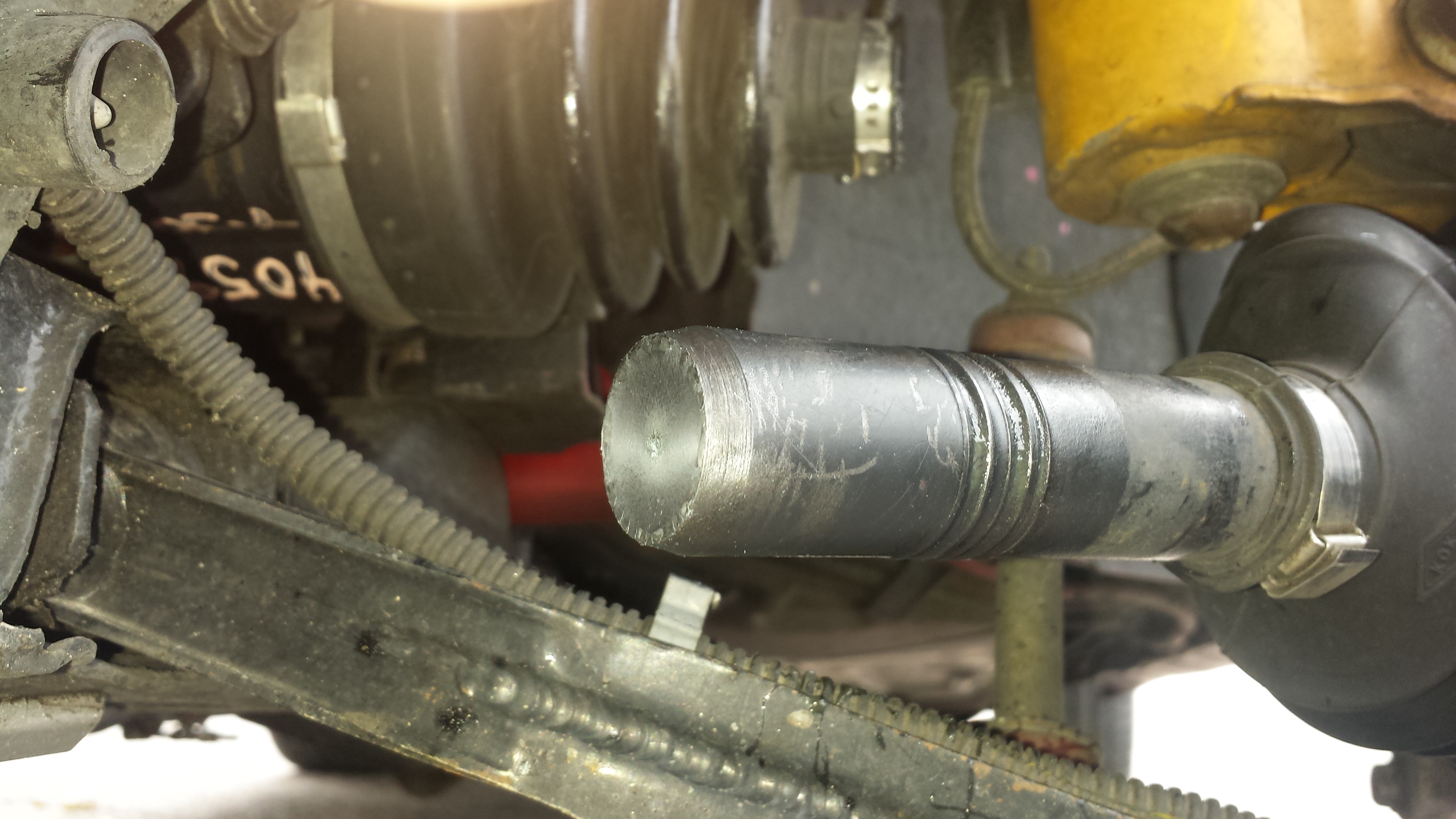

Well that didn't last long... Didn't even make it off the line.
Had to take the Forester and camper home, grab my friends truck and enclosed trailer, drive back up to NH load the car and then drive back home... YIKES... made for a long night that's for sure.
Re: 1996 Mr.Pink
Perfect shear. Sure didn't see that coming! At least it got back home in style and not on the back of a tow truck.

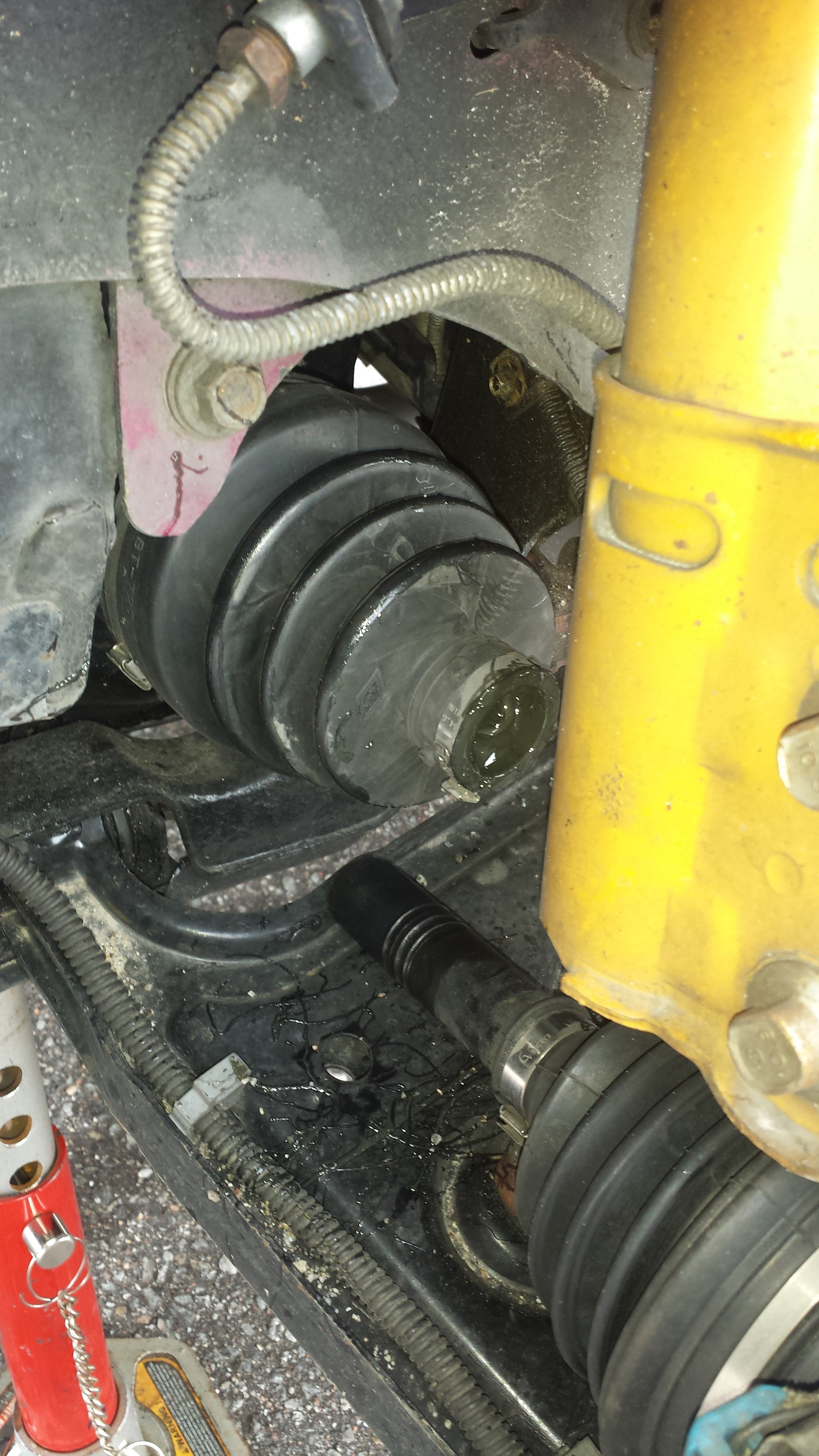

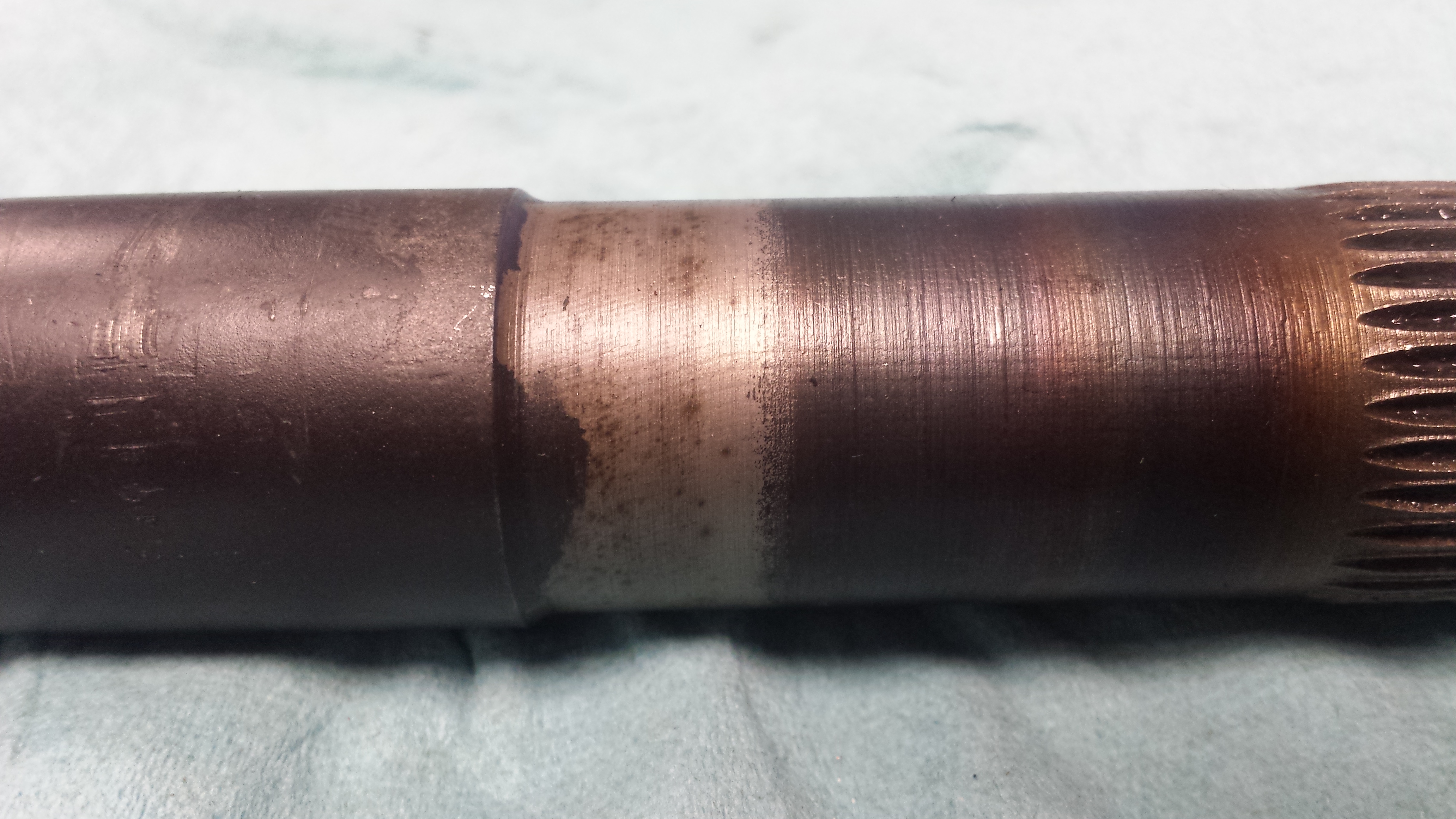

Re: 1996 Mr.Pink
Maybe it's just me, but I wonder if these lines are showing a twisting happening to the bar... This is the same bar that broke but on the outer CV side...
