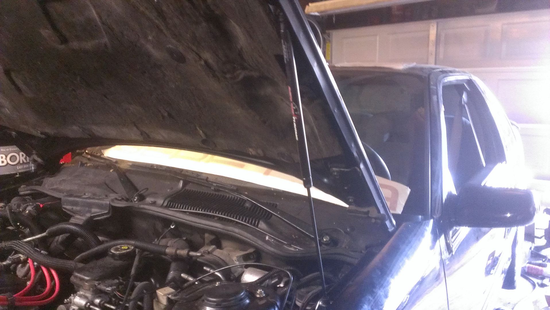

The Redline Tuning Hood Shocks shipped in today!
Since I am using the W-body/van mount to stabilize the trans/motor I cant use the stock prop rod at all..
Cant wait to get these on!

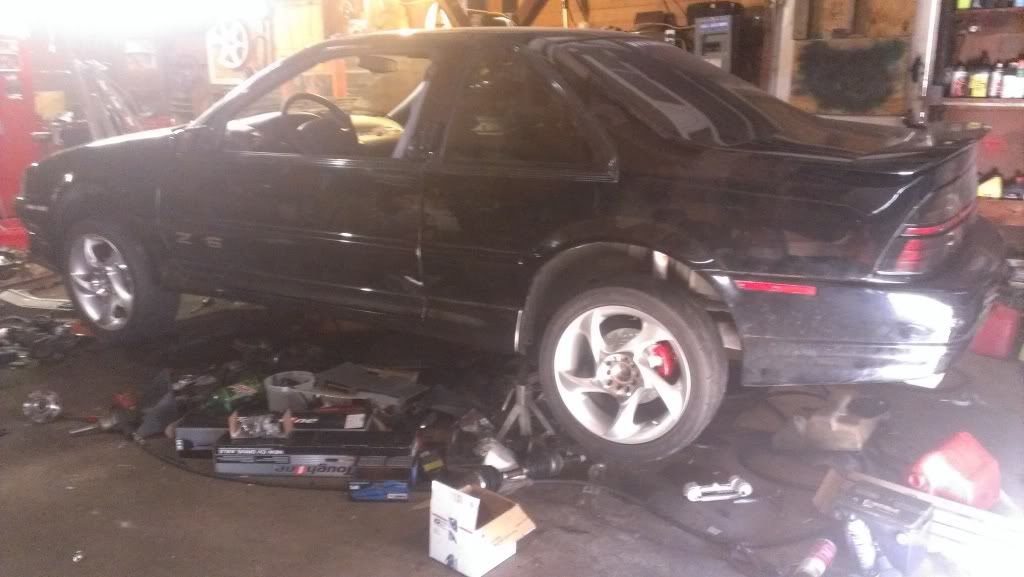

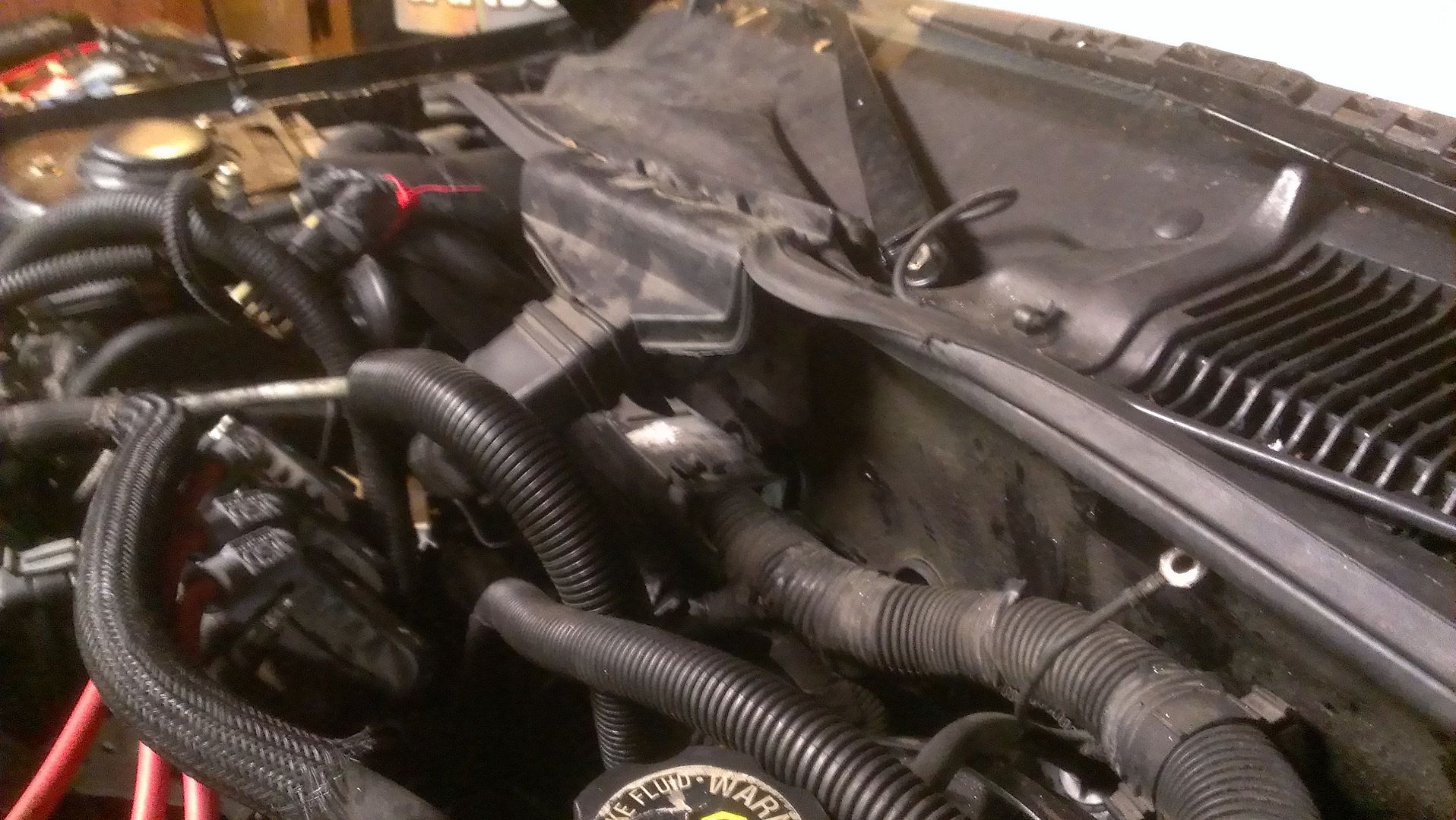

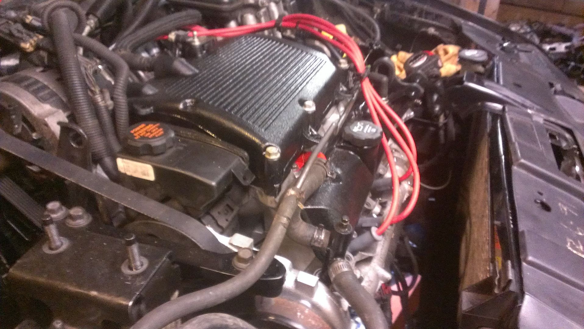

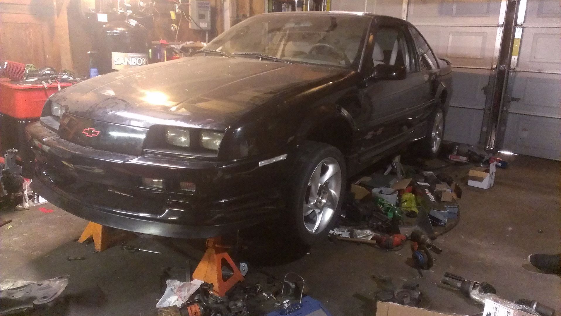

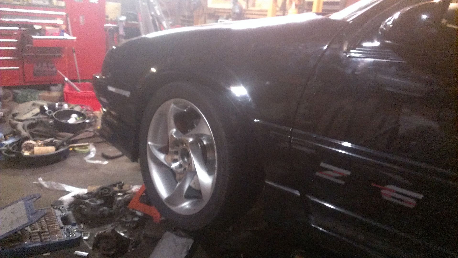

We made a ton of progress this weekend!
I will start off with my favorite picture...
Got the redline tuning hood shocks installed..

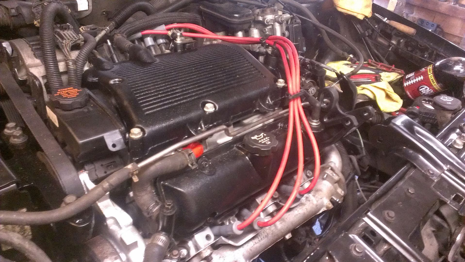

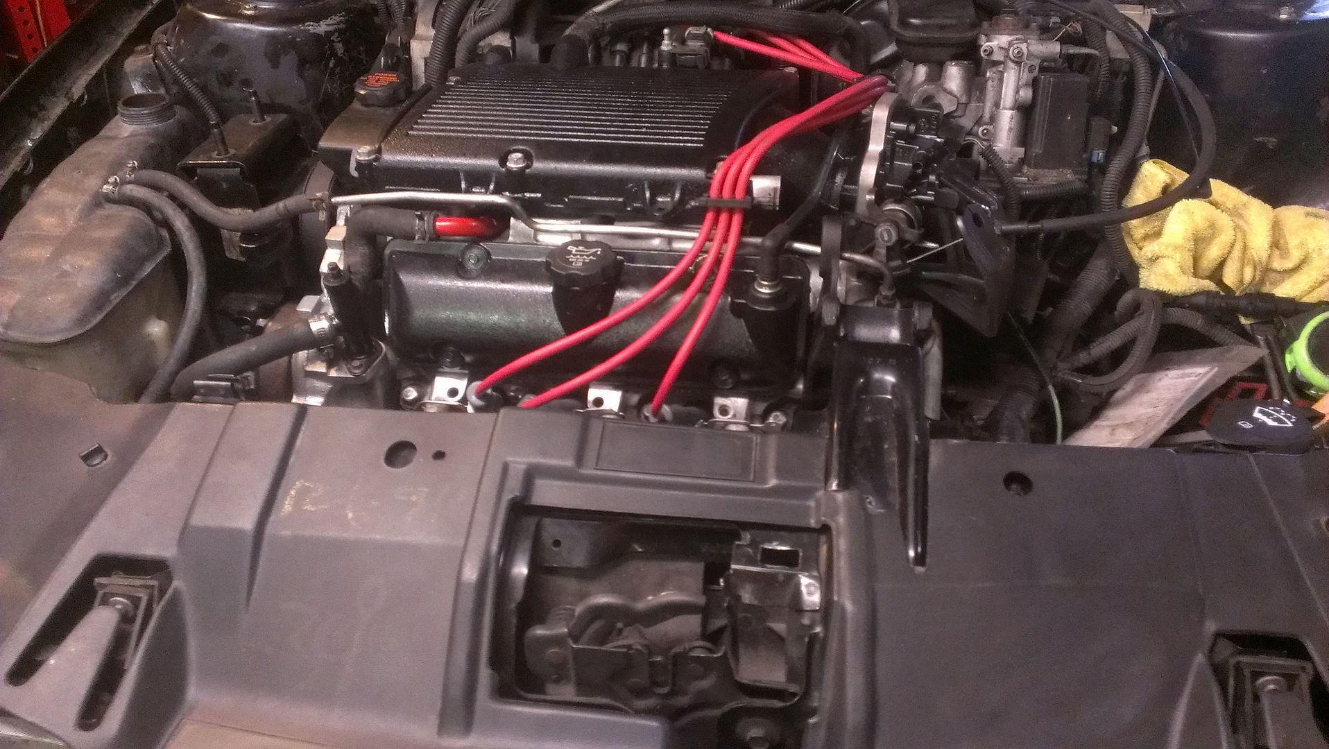

Got the motor put together..

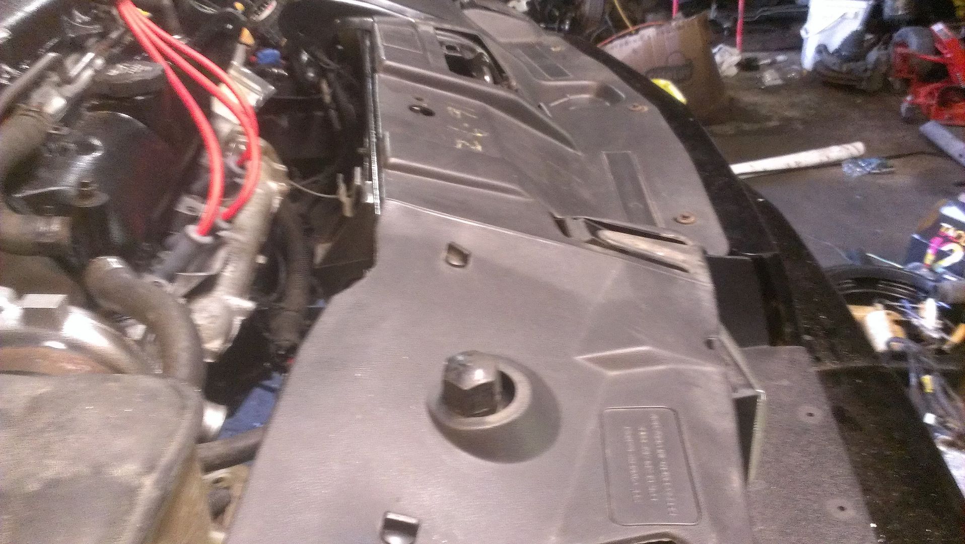

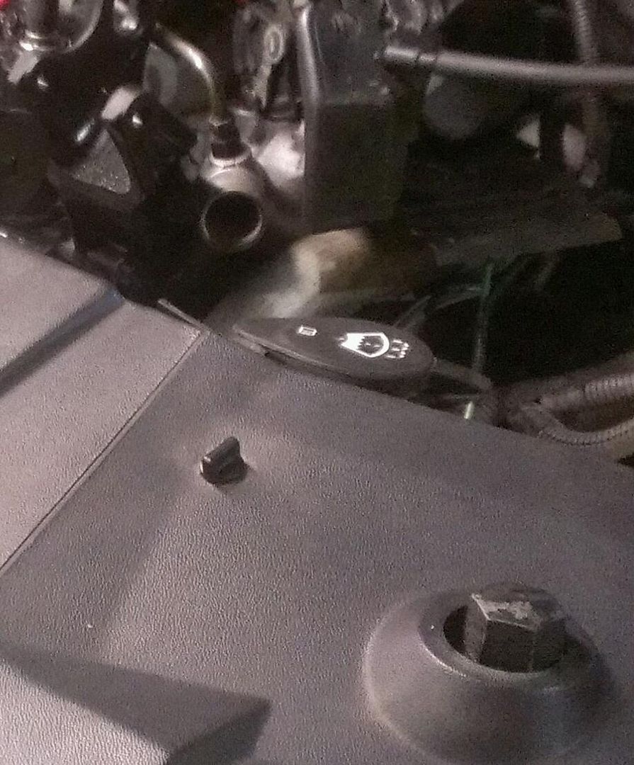

Cover trimmed for the W-body mount..

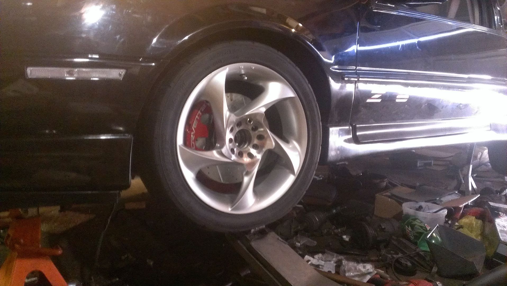

Got a windshield washer fluid cap of a 06 Malibu to match the oil cap I got off a 06 Uplander.. I am going to get a brake fluid cap to match so they all have the owners manual logo on them.
G6 shifter assembly under the stock shift plate
Alternator cooler on.

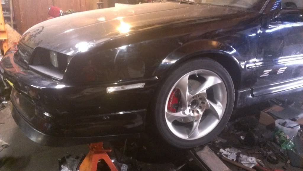

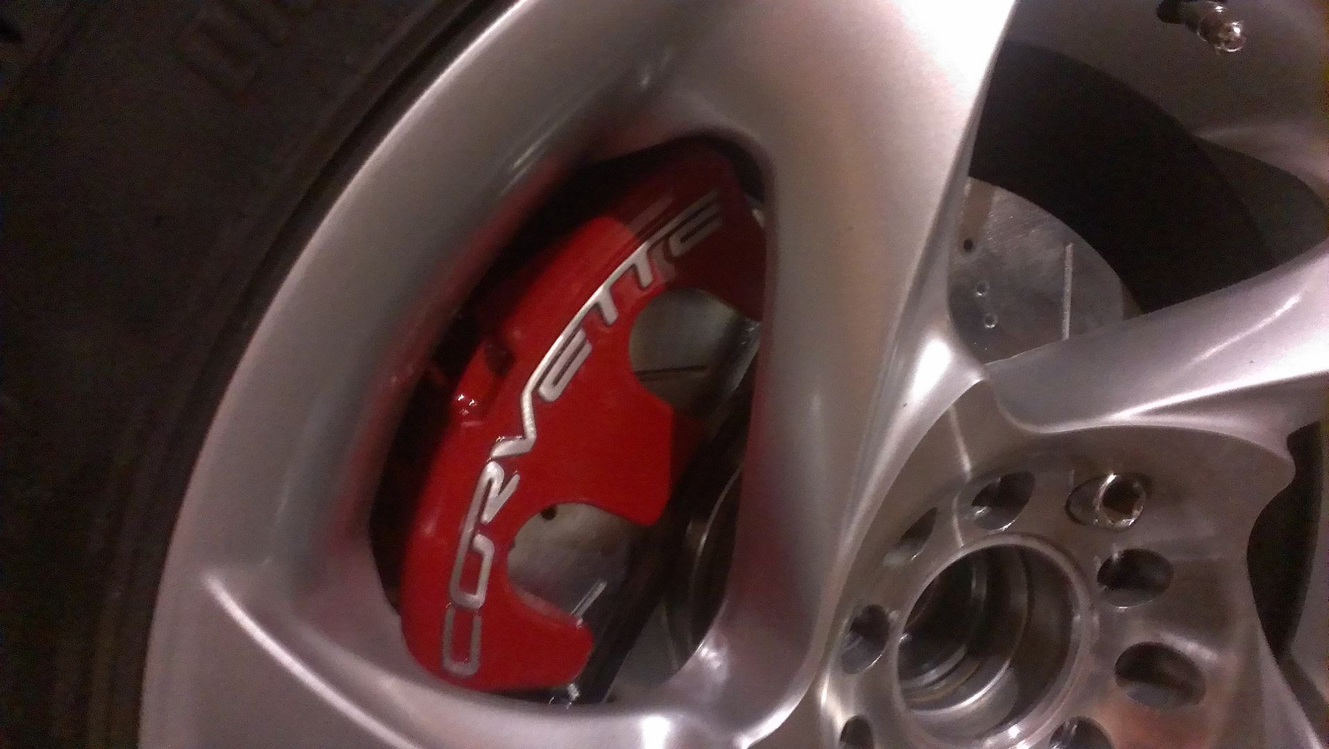

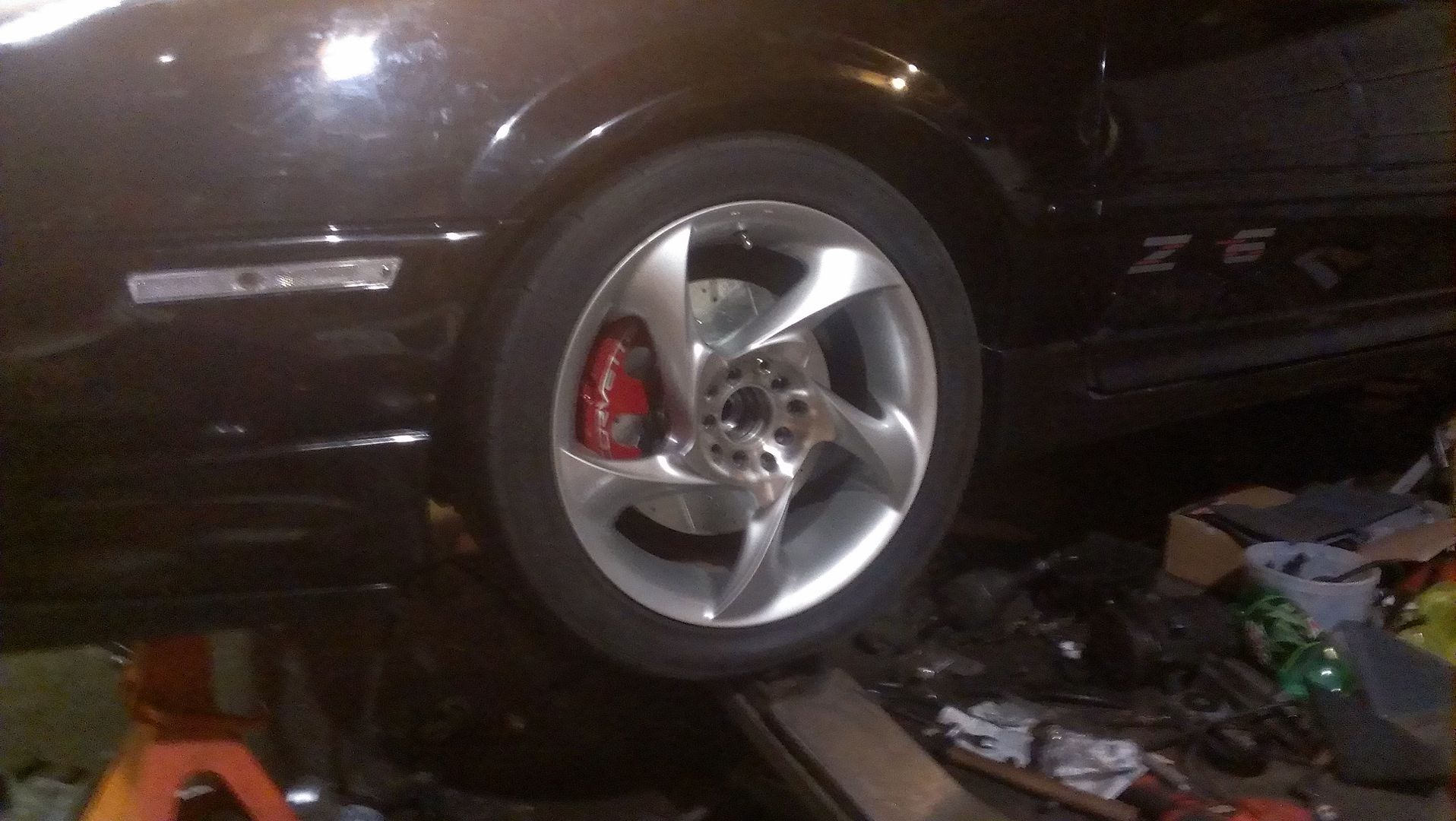

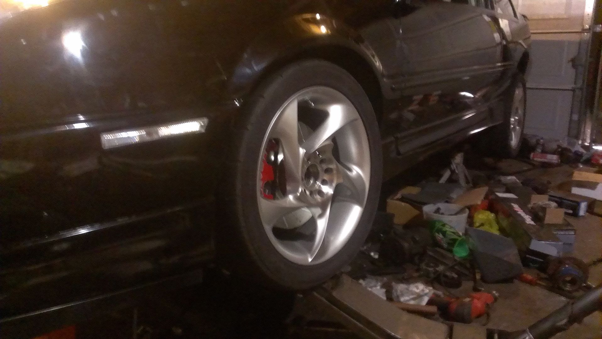

C6 Corvette Caliper..

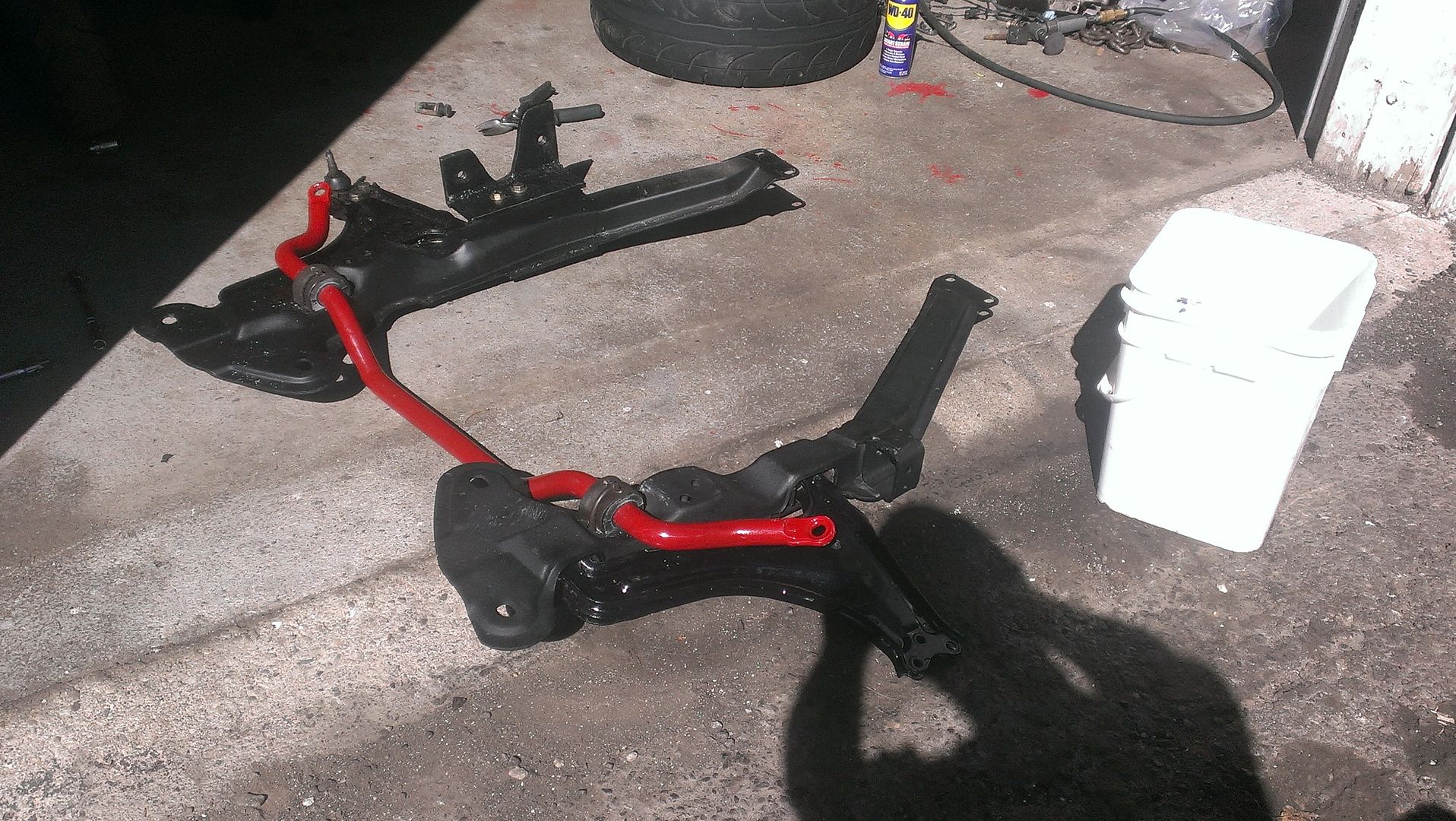

Subframes/swaybar together

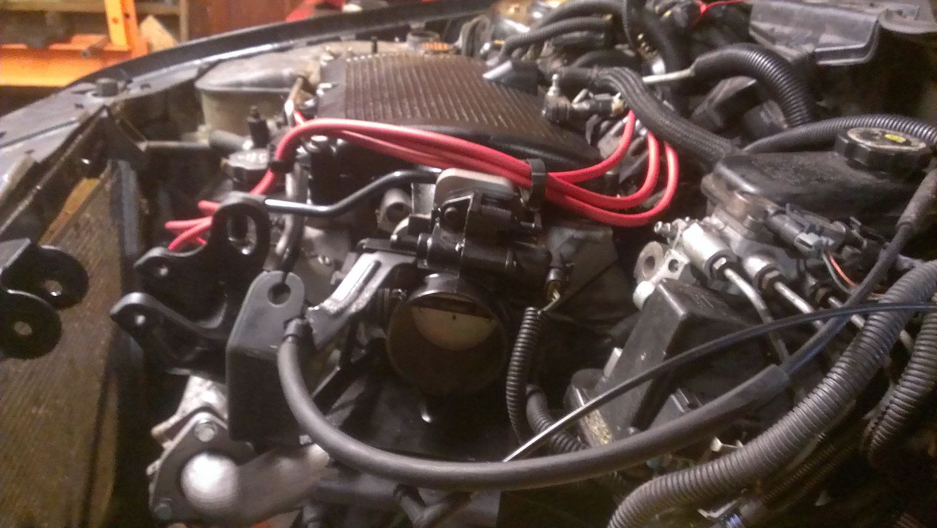

More pics...
Let me know what you think!

Yum! Looks nice. Don't forget to beef-up that upper radiator support though...
Re: The trip into the "big leagues"
Rettax3 wrote:Yum! Looks nice. Don't forget to beef-up that upper radiator support though...
X2!

We got the mount bolted mostly onto the stronger part that the hood latches on to.. Its pretty damn sturdy as it sits. I forgot to get a pic of that without the cover on it..

SummitBalt08 wrote: We got the mount bolted mostly onto the stronger part that the hood latches on to.. Its pretty damn sturdy as it sits. I forgot to get a pic of that without the cover on it..
I'm not trying to be an ass, I'm just being honest but whoever thinks the point where the hood latches is stronger in the front to back flexing motion does not know what they are talking about... There is not enough strength in the metal thickness alone of the radiator support, and the flimsy stamped steel bracket for the hood latch is not going to improve that strength for that motion at all.
Shawn you can leave this as is, but honestly I think you will have some more flex than you want, or you will bend something shortly after running the car.
SummitBalt08
Posts: 1062
Location: Sidney, Ohio
Post by SummitBalt08 »
Even without that core support mount on.. just the lower dogbone, T mount, and the custom mount in the subframe using a F body poly trans mount the motor barely barely moves.
I will see how it works out but either way I might have to take an easy on it to get it home then look into a metal bar type support under the core support.
