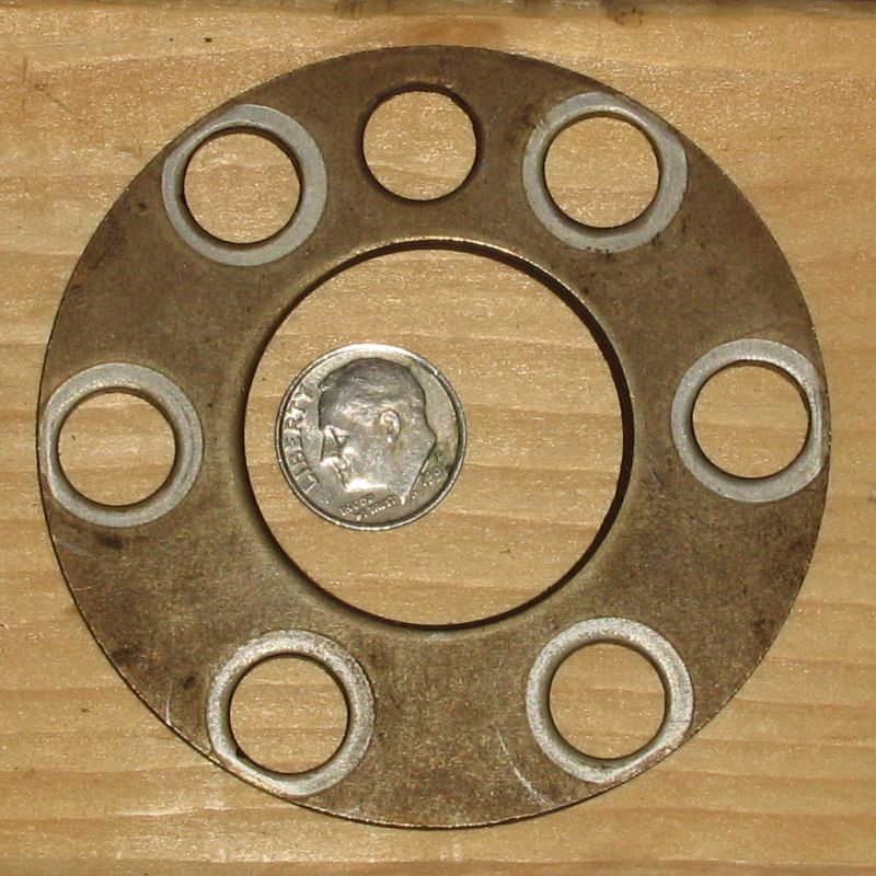

The only things I can think of is the bolts might be over torqued and stretched, bolts might be bottomed out, the crank/flywheel isn't a true flat surface, or the bolts might not be good quality.
I've read about people getting an expert machine shop to machine the crank and flywheel with dowels to help relieve the bolts of the shear forces, that could be a possibility.
Being an aluminum flywheel I wonder if aluminum creep is happening (I know Aluminum can dent easily), where the metal deforms under the bolt heads and it becomes loose enough where the bolts can shear off. (Because the friction between the flywheel and crank gets reduced).
I wonder if he needs something like this made of strong steel to help clamp the aluminum flywheel to the crank:
