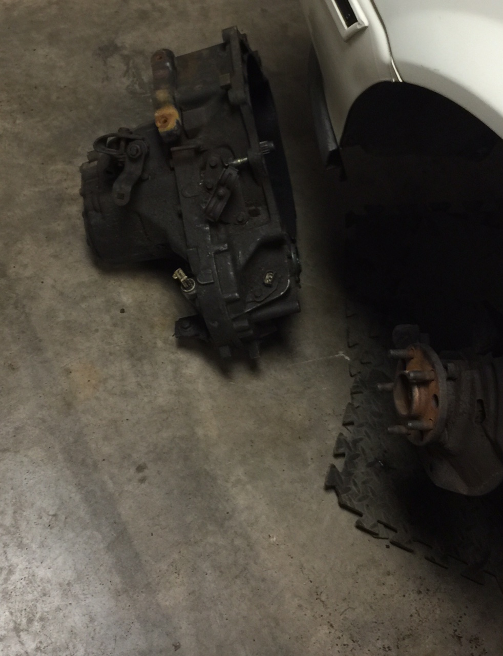

its out and at the dealership to be split apart!

wow that thing is DIRTY

Many years of undercoating, I never clean engine parts. Worried way more about function than looks.

The way I see it is the part is malfunctioning and leaking if it's getting that much oil and dirt on it

Metal flakes inside the transmission oil was a dead give away to me. I drained it last year before putting it away to replace a axle seal, so its only recent metal. Only put on this year maybe 1500k, You must have internet photo x-ray vision!
My donor car for the 5 speed swap was pulled out of the ground, and towed to my house I have no idea what happed to it for the first years of its life. Since I have owned the transmission, it has leaked from the axle seals a number of times, had probably 10 different sets of axles installed. All this is now cured with the proper rear engine mount, if only I could go back in time and fix my mistakes. Coolant leaks, that was fun, and is sorted out now also. The old 3.1 also leaked a shitton of oil all over it with the o-ring failing in the fake distributor hole. Drove it about 1000k dumping oil into it to get home for repair. Its been though a lot (burnouts, clutch drops, abuse etc.) and deserves some new parts put inside. Would rather this happen here than 1/2 way to beretta fest!
