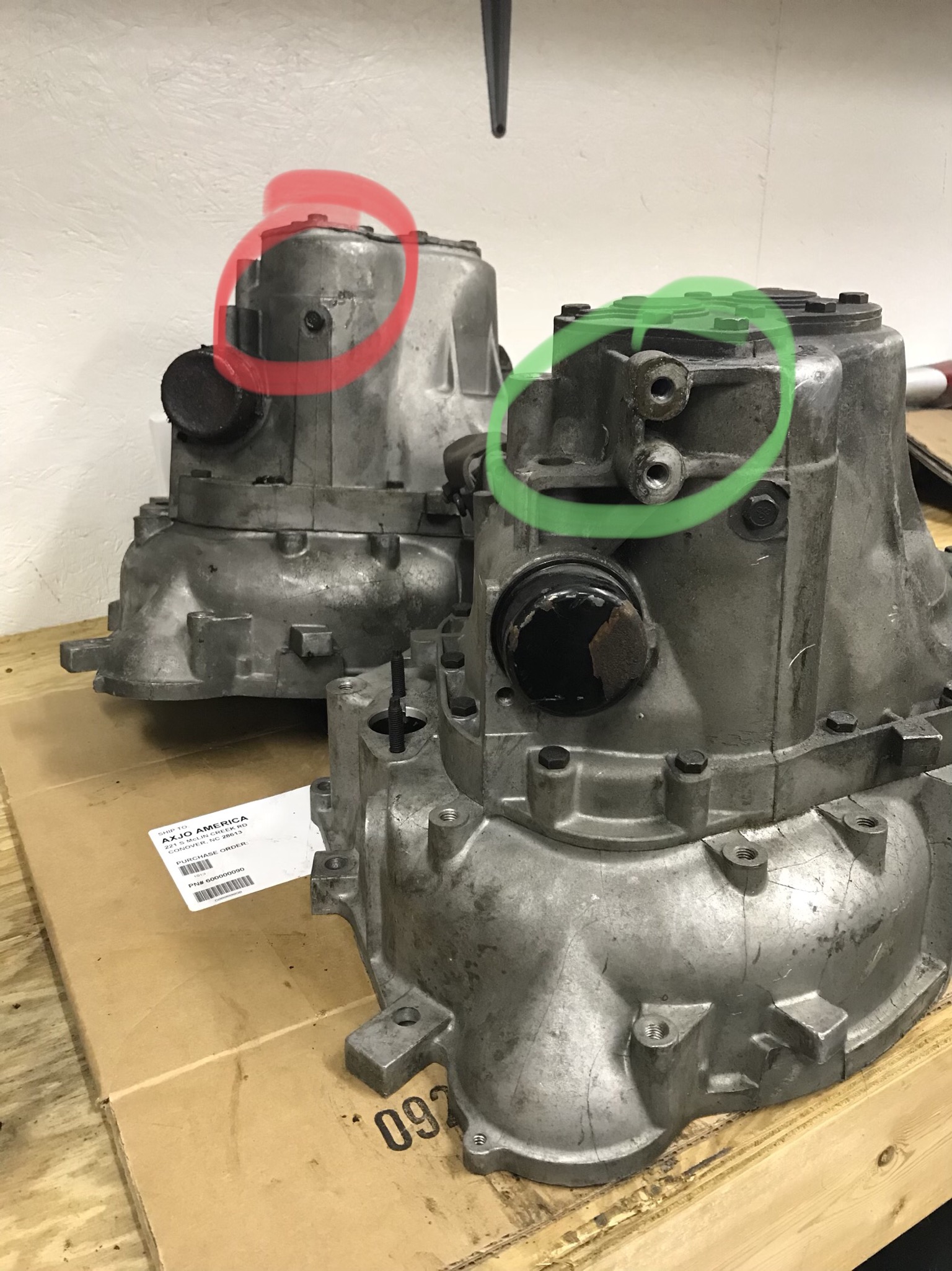

So I got the transmission out of the Alero and looked it over closely; hmm, how are those 5spd mounts supposed to bolt to it?
The trans is from a 94 Cavalier, which doesn’t have provisions for the front 5spd mount in the casting. The rear mount bosses are there, but only 1 of the 3 mounting bosses used are drilled/tapped.
Thankfully, I have a trans from a 92 3.1 Beretta, so all I have to do is swap the outer bellhousing. That’s all... sheesh. Talk about extra work for minimal gain.
The trans in front with the green circle is the 92 Beretta one, and the red circled one is the 94 Cavalier.

The difference you're showing is in the case. So you'll need to swap all the guts over too then. What's special about the Cav trans from the Alero? Was it just the diff?

Now I'm confused, I thought 92+ Beretta was internal slave.
I know all Cav trans had the pre-92 mounts and assumed they were also external slave.

I bought a 92 3.1 Beretta trans thinking it was an internal slave, sight unseen (it had 45K on it and was cheapish). When I got it, I got the trans pictured above with the green circle, and it had one of the 92+ mounts on it still. This tells me that 93 was the only year V6 Beretta that used an internal slave.
I know less about the Cavaliers, but can only assume that 93 and 94 V6 models used internal slaves, based on what I was told the trans from the Alero is. I didn't know they used the old style mount until the 95 refresh. Doesn't make sense to me as to why GM would bother having two different castings for that side of the trans case, but then again, I'm not running a multibillion dollar company either.
I'm told the trans out of the Alero is originally from a 94 Cavalier. It is a Getrag unit at least.
The Alero itself was a bastard - I have a *growing* list of stuff that was hacked on that car.

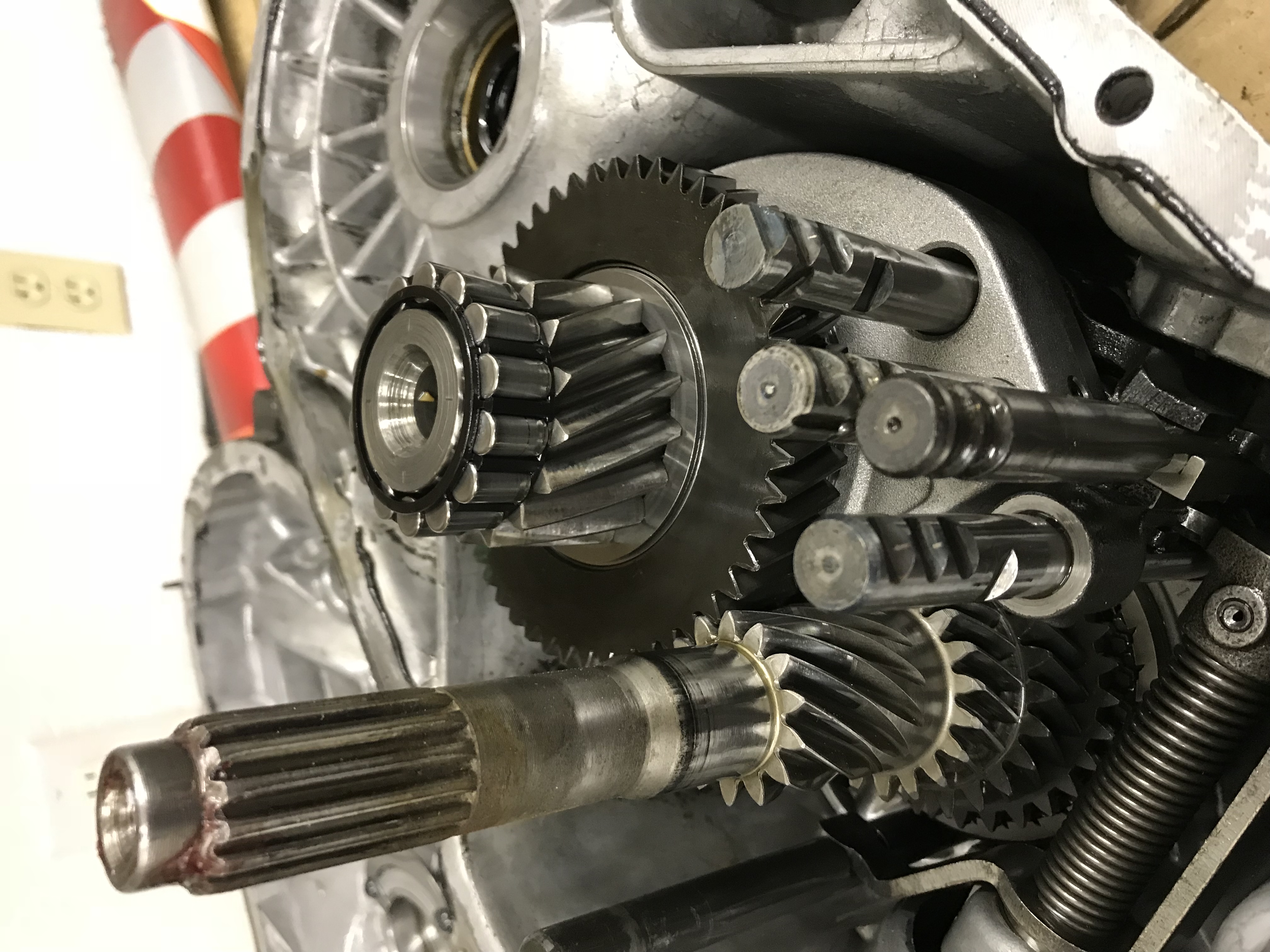

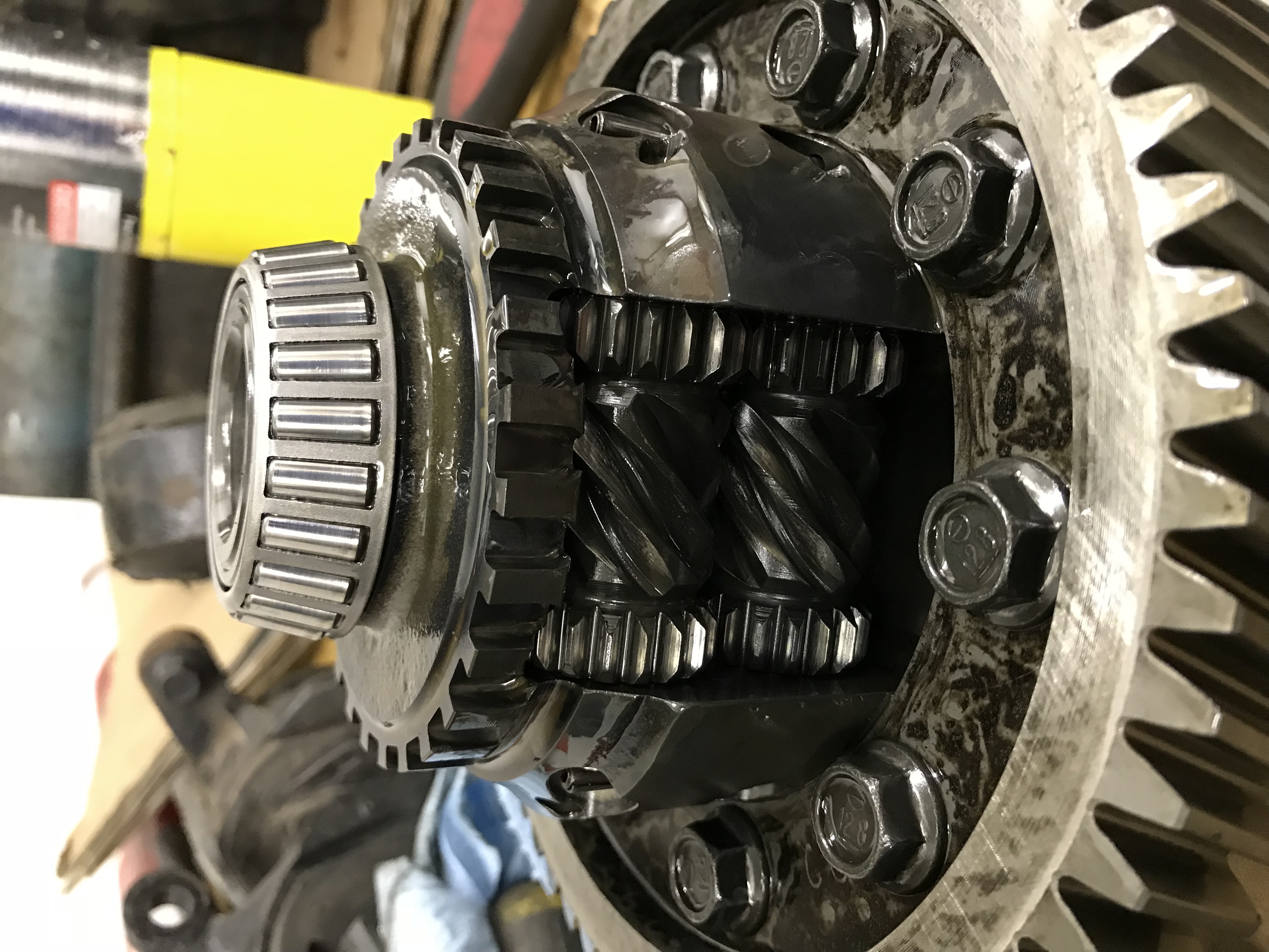

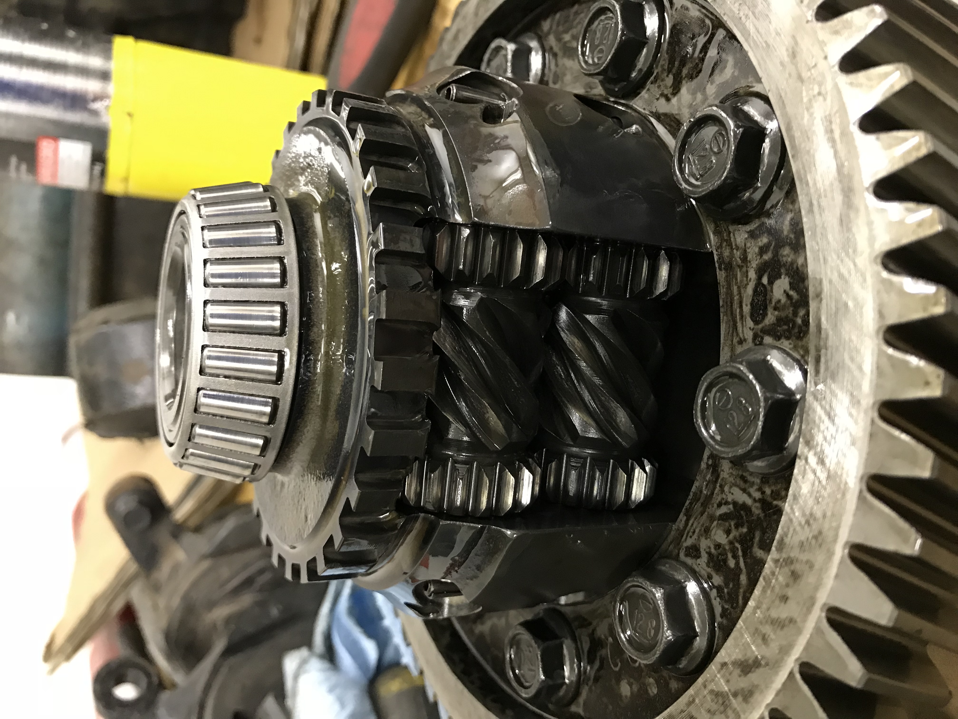

Started pulling apart the Cavalier trans to get the guts out for a case swap.
Torsen love!
Torsen love!

I don't see those input and output shafts liberated yet. Get your 12mm 1/2 drive allen socket?

Got the trans reassembled with the Torsen LSD and the cryo-hardened gears, put that in the Z26 using the new 92-96 mount setup. The detent balls were a little tricky, but once the first one got in, the rest seemed easier to deal with. Installed the jack-shaft as well (switched over to the solid axle instead of the aluminum housing unit).

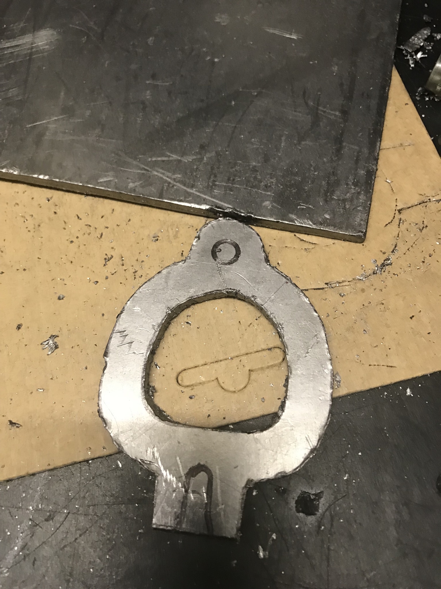

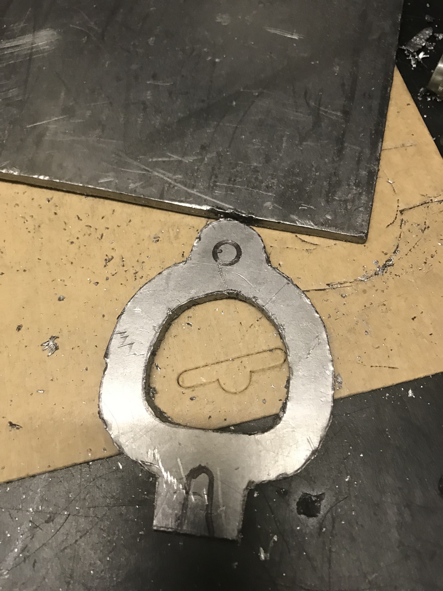

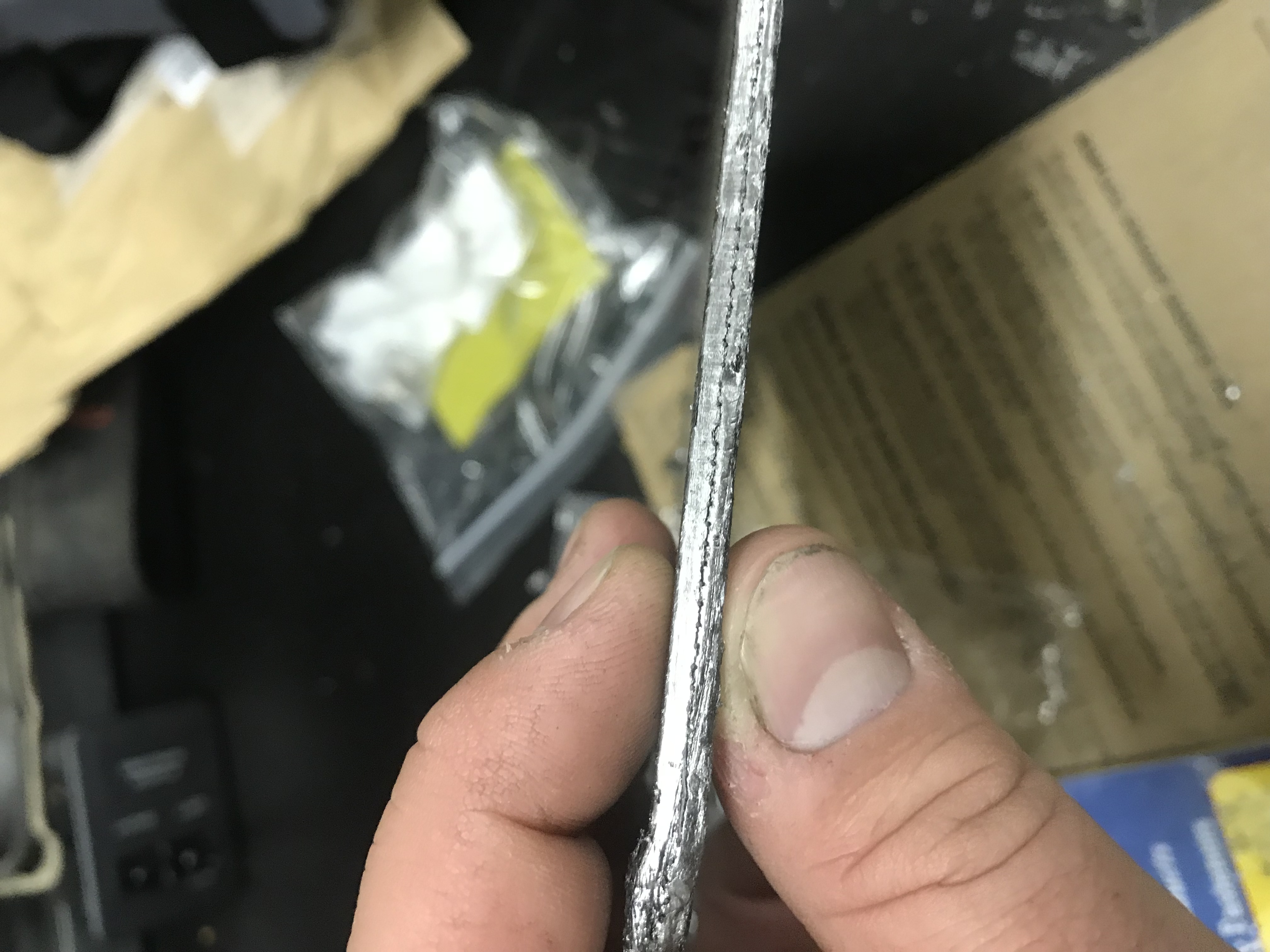

I started cutting out the gaskets for the turbo headers - using Remflex. It's all graphite material and is supposed to seal any imperfections, which I think they'll do. I have a few more to cutout then I can get them bolted to the heads and mock up turbo fitment. I will need to extend the T3 inlet for the turbo to make room for a proper wastegate inlet, but that shouldn't be difficult. Initial placement shows a perfect routing for the downpipe.

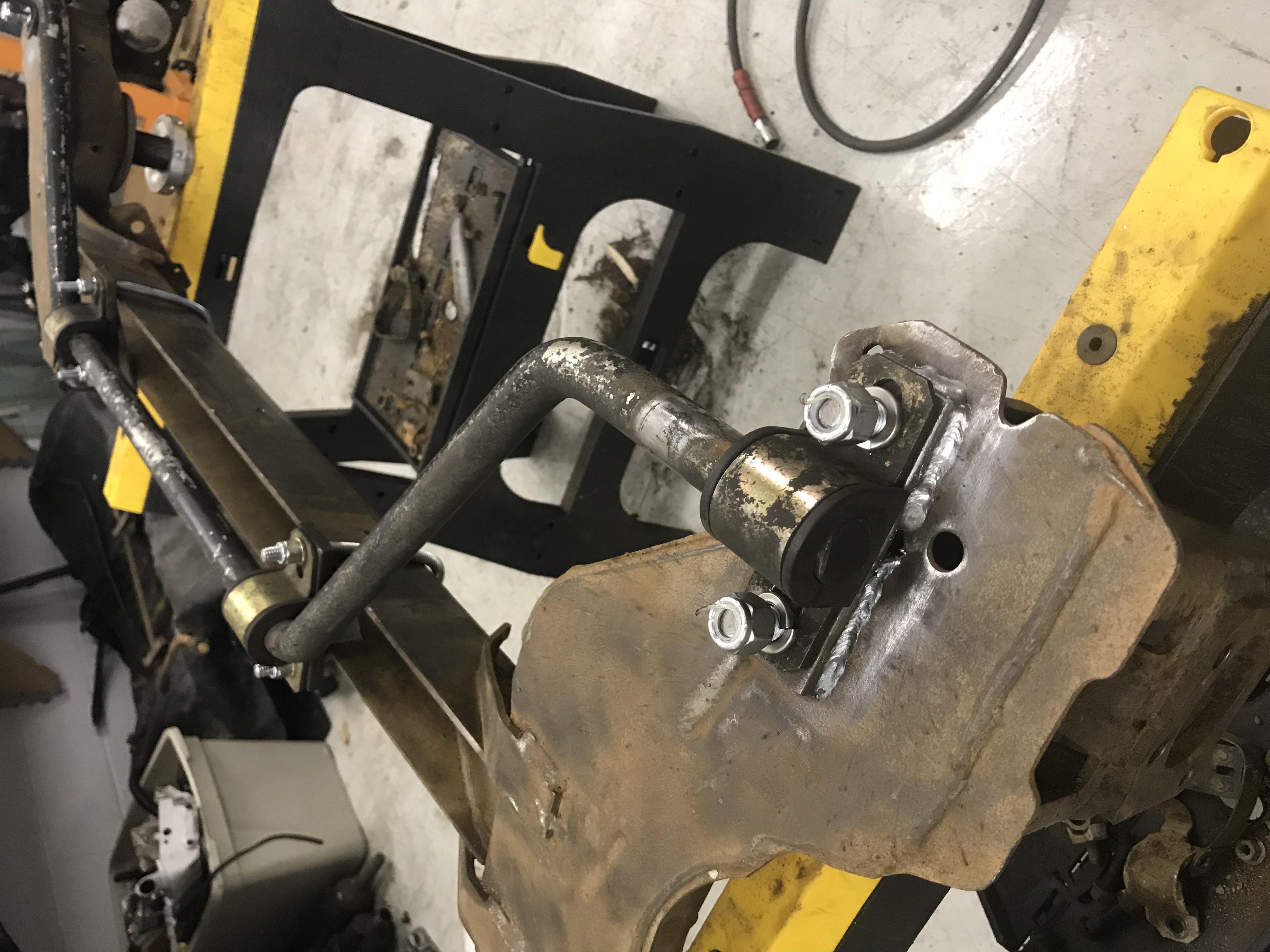

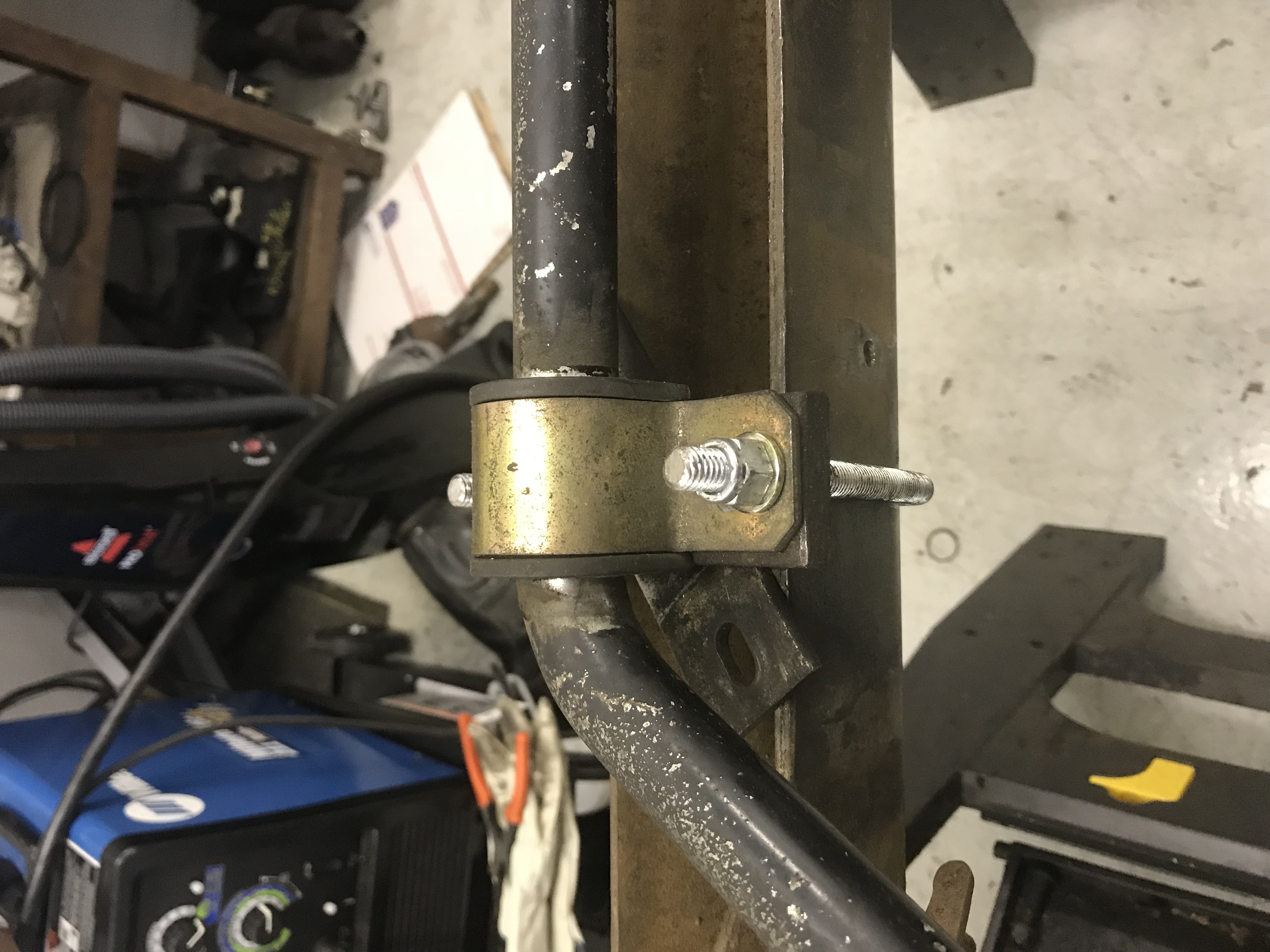

Did a lot of work on the J-body rear axle - I'm swapping because the J-body ones are a little narrower. I already have rubbing issues with the 245's on my 8" wide wheel, and putting rear discs on will make that even worse, so the J-body axle works out perfectly for that.
Shane and Brian really did most if not all the work on the axle. They stripped it down (I bought it loaded with everything on it still), cleaned it up some, got the bushings burned out and removed the steel from the bushing. Later, Brian positioned and welded in the Wolfe Racing adjustable coilover spring mounts, then we looked at how to mount the 26mm Addco bar to the axle. The "beam" section on the J-body axle is narrower than the L-body axle, so the Addco mounting hardware wouldn't swap over. A trip to Lowes solved that with some 3/8" all-thread for the center mounts over the beam. We reused, but modified, the Addco hardware from my old setup. For the ends of the bar, we again reused the old hardware, but tapped, threaded, and welded in studs for the bar to mount to. Then Brian welded them into place after careful measurement.

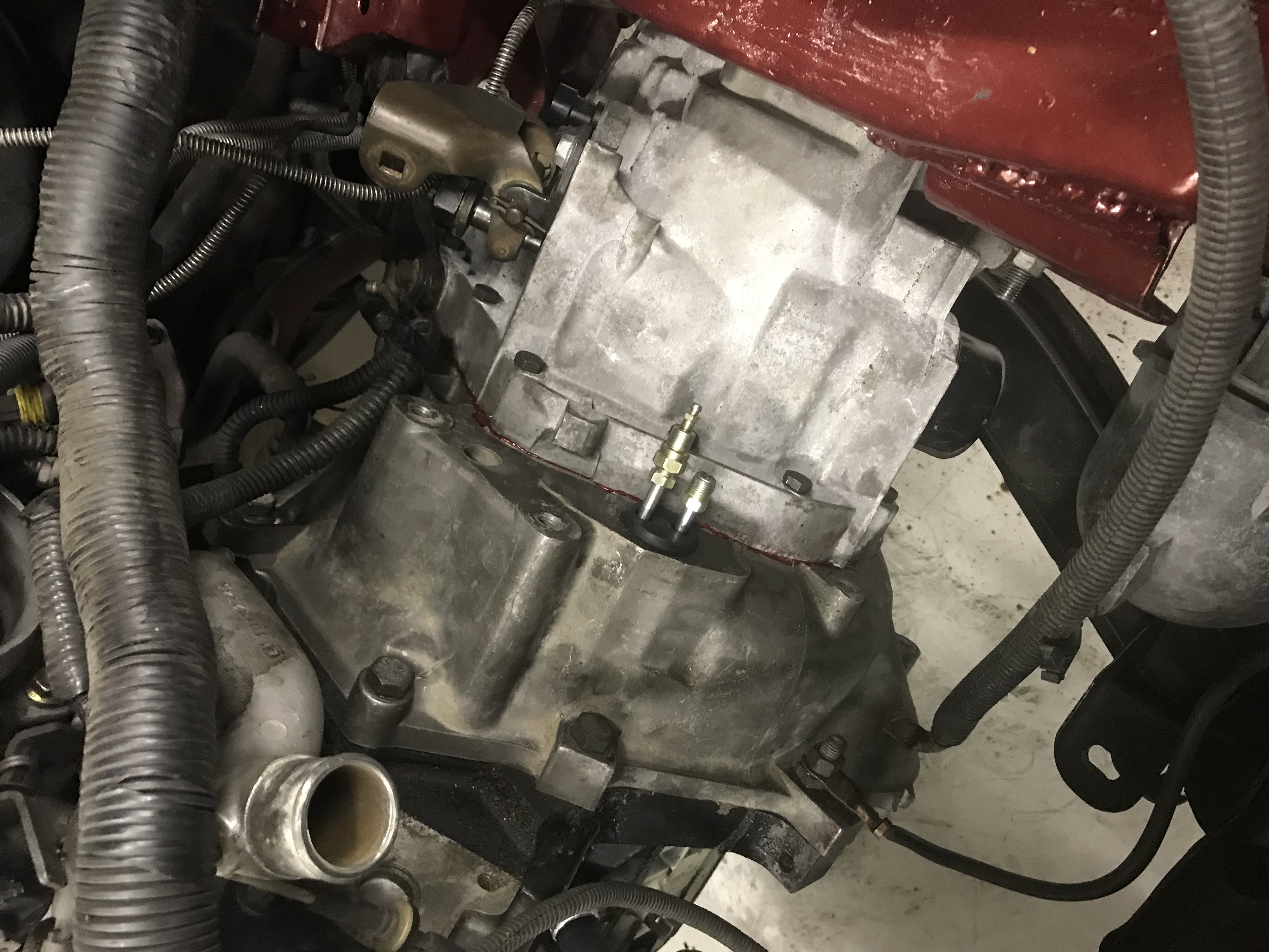

Before Brian left, we threw the F23 transmission up into the Alero so I can get that done and out of my hair.

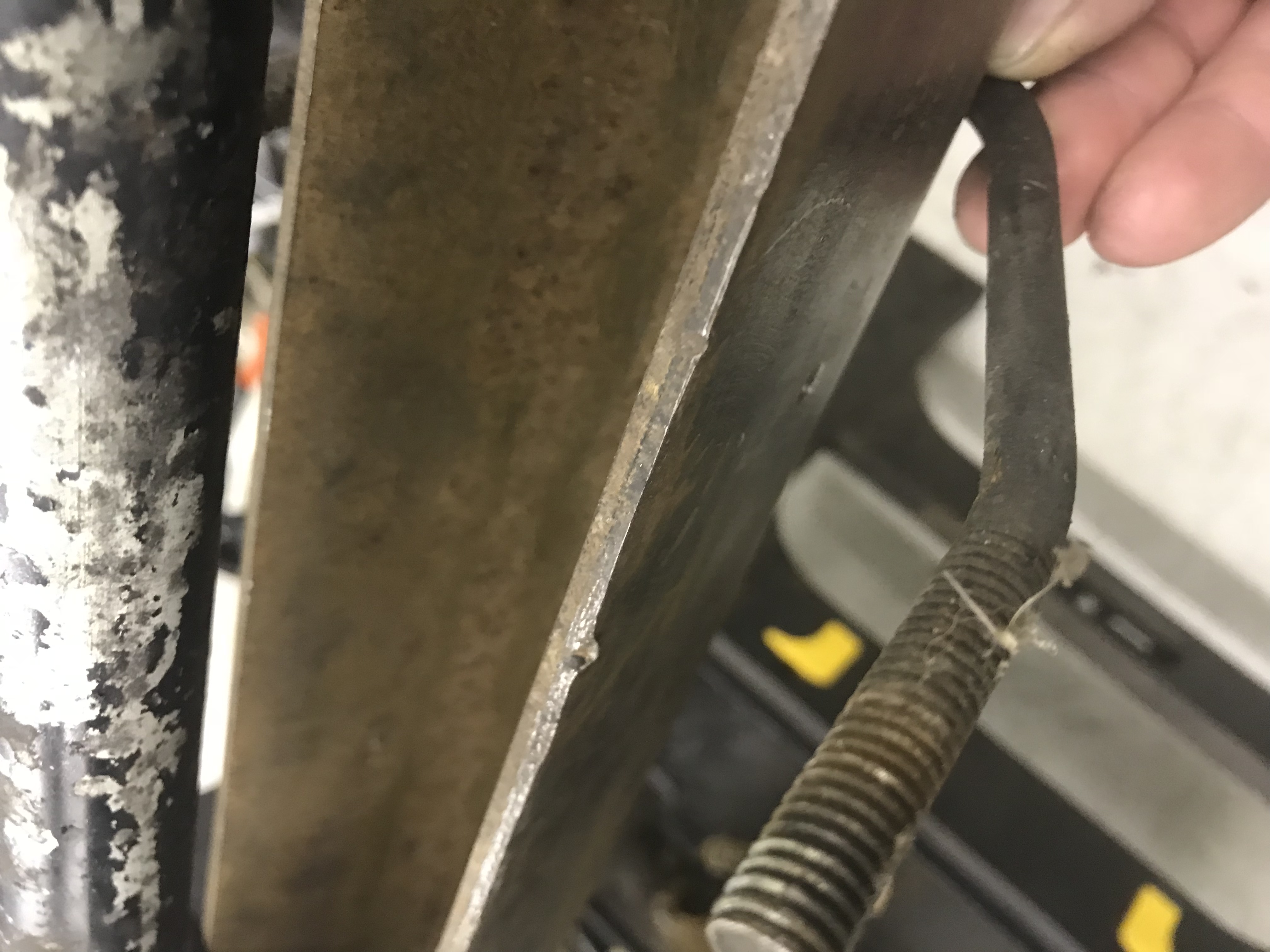

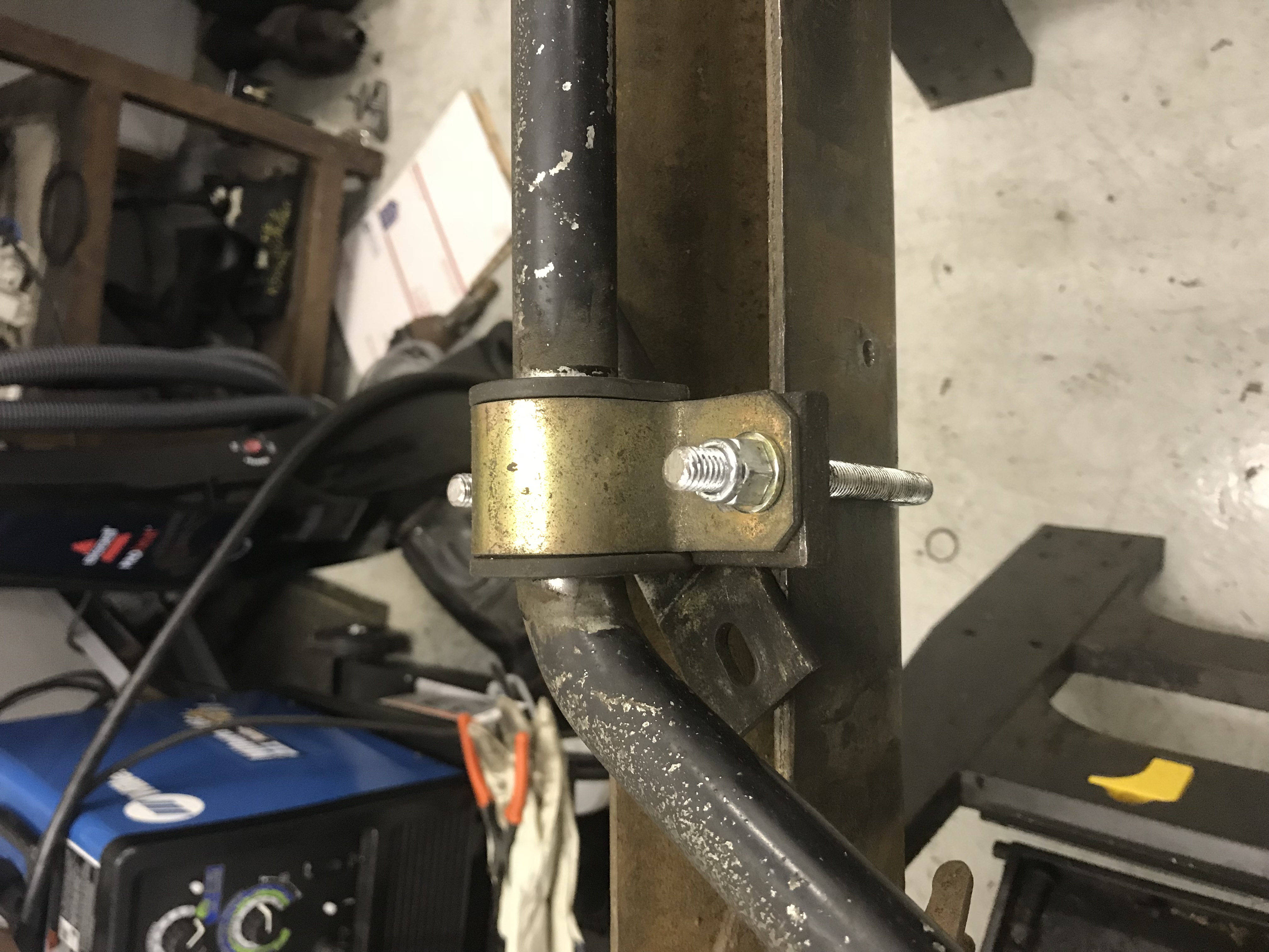

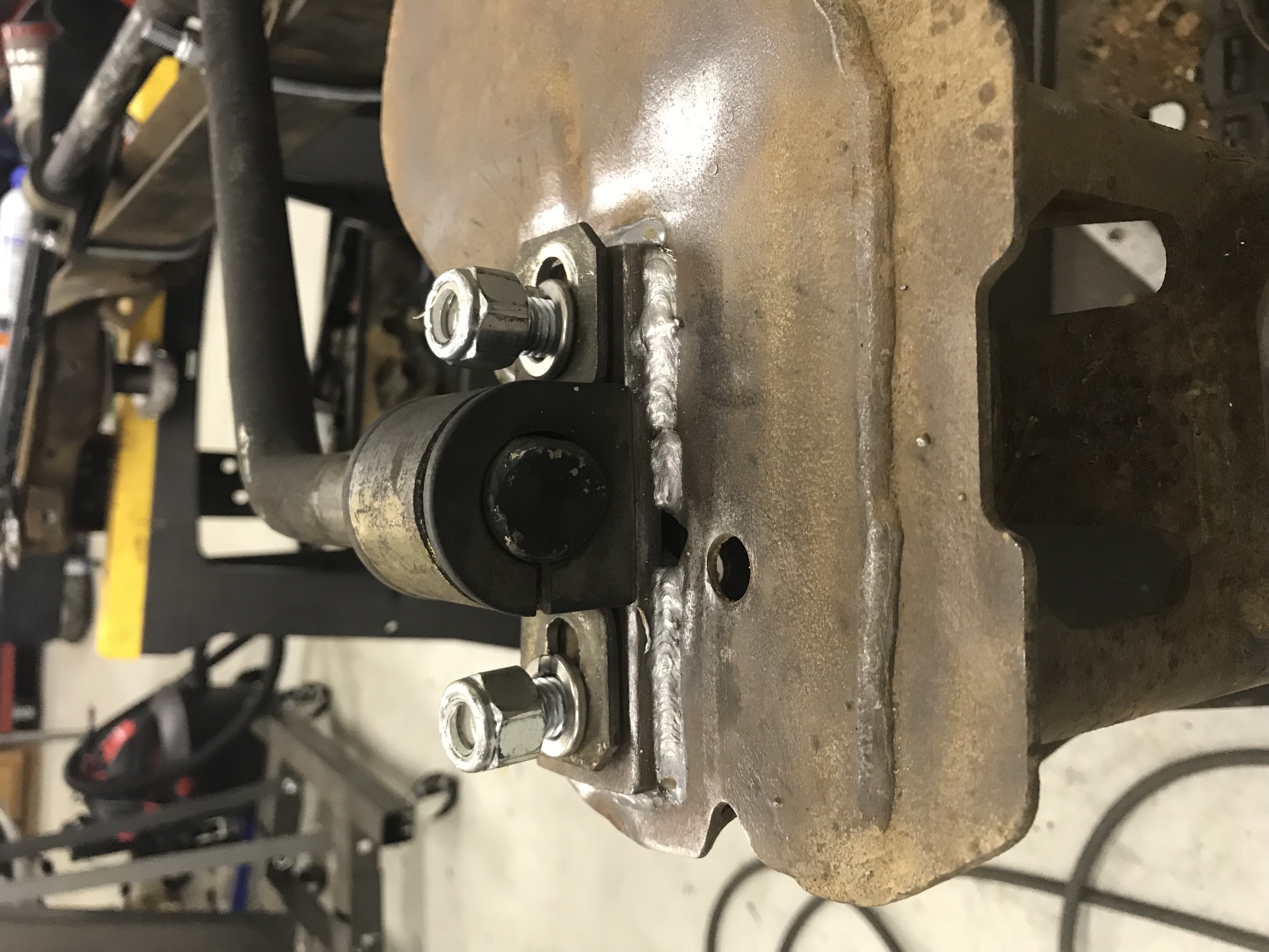

One thing to note - if you look at the swaybar mounts that are hung over the axle, you'll see the spacers placed under the hardware - those are there temporarily as I'm going to box in the triangular section of the beam for more rigidity. This will reduce beam twist and also make up for the lack of an internal swaybar on this axle.

Those welds looked good one facebook, I wondered if that was you! Haha
Never heard about using a J axle beam. Sounds like a good solution.

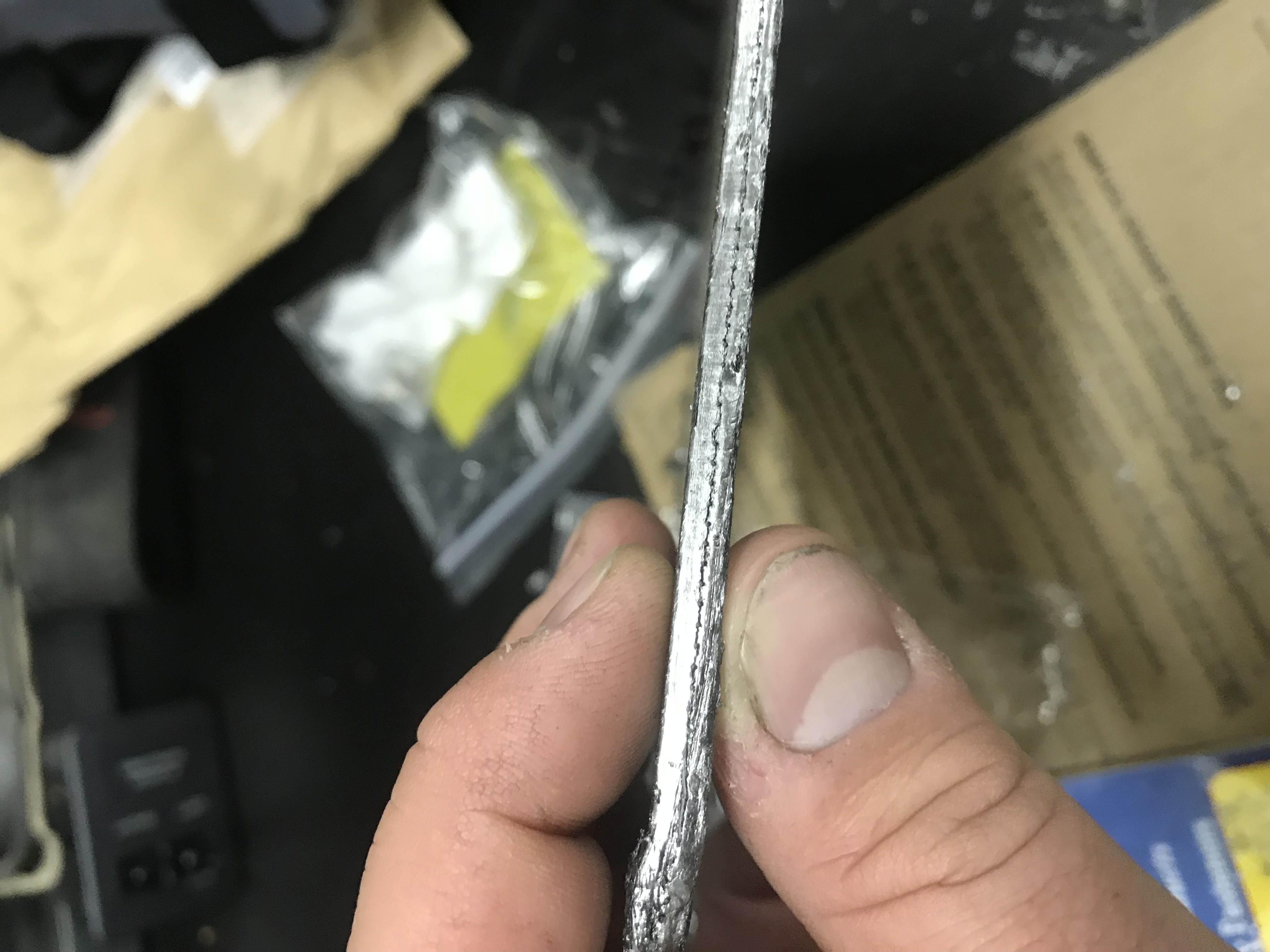

I can weld thicker stuff no problem - it's the thin crap that I struggle with - need more practice.woody90gtz wrote:Those welds looked good one facebook, I wondered if that was you! Haha
