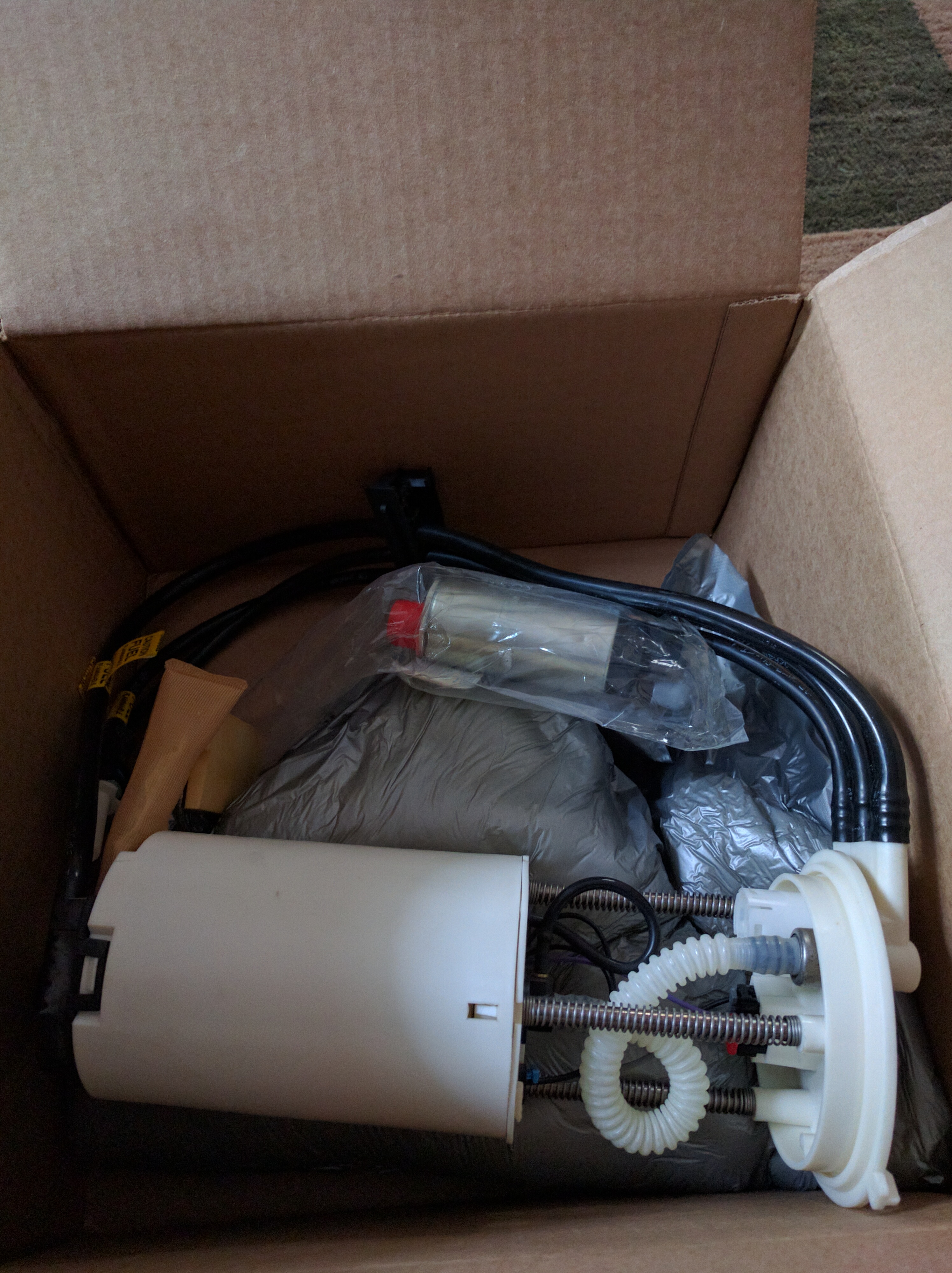

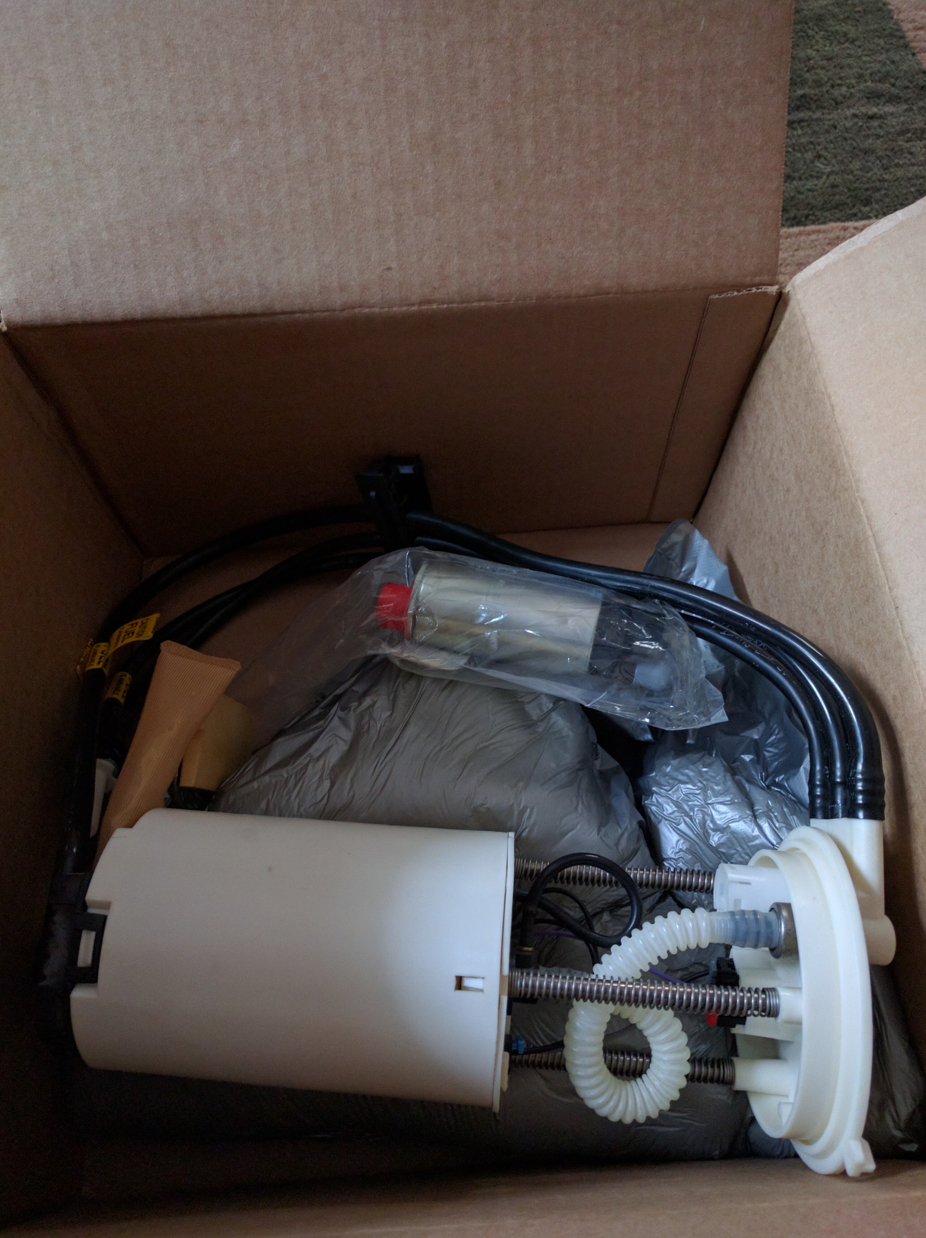

Spent some more money on the pig... Picked up a brand new ACDelco fuel pickup assy on ebay and to go with that I picked up a new Walbro F20000169 pump to go in that pickup. I'm making sure the fuel system is perfect before leaving this year... lol

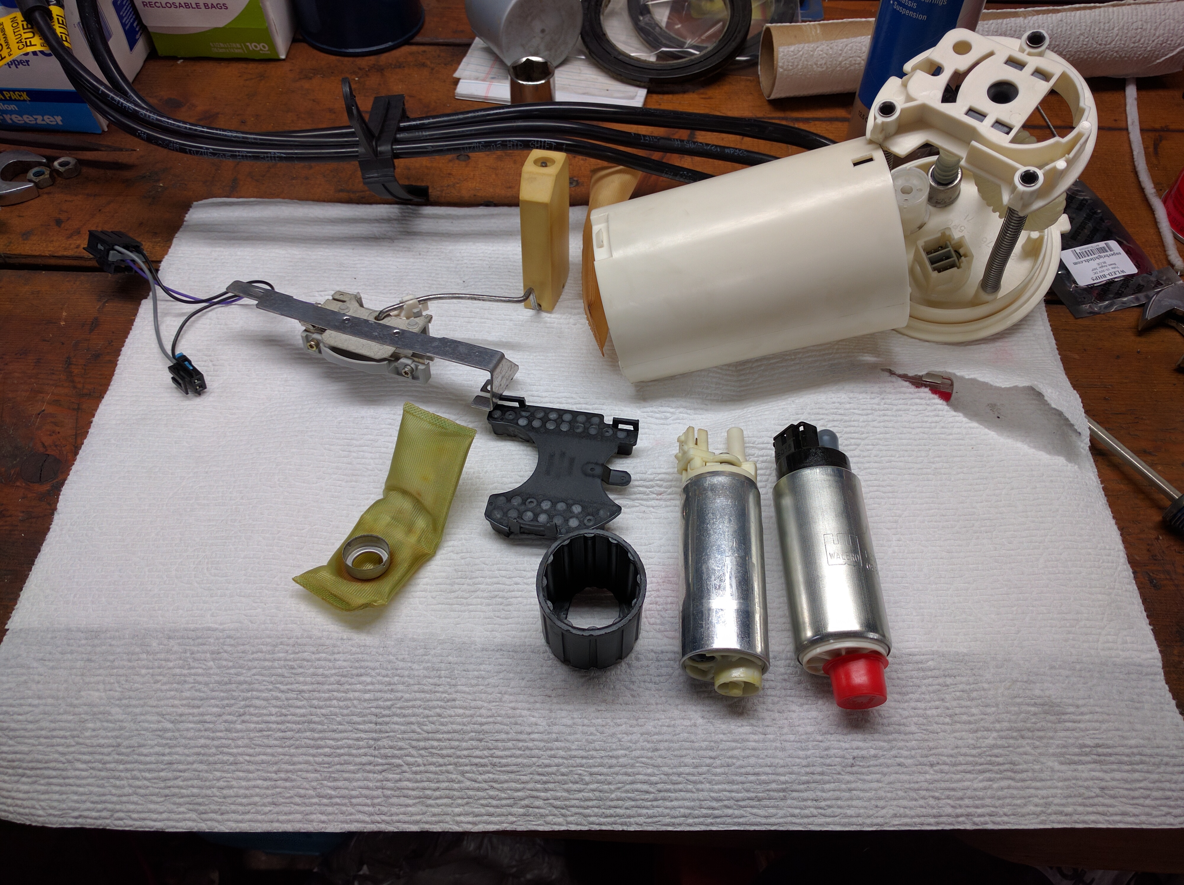

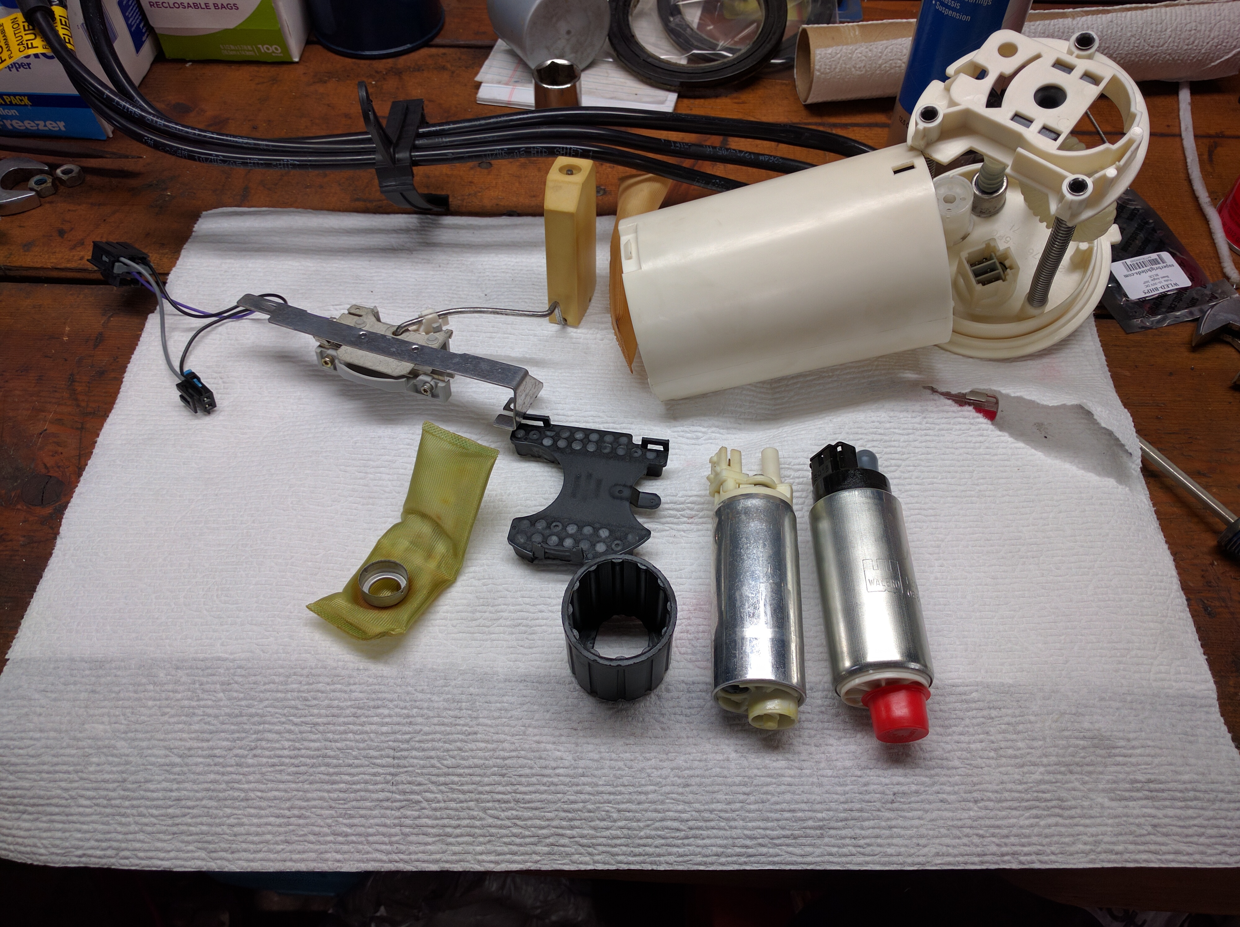

All of my fuel system stuff is showing up today... It will be very odd to be able to work on, setup and ready a full fuel pickup assembly with a new Walbro pump and not stink of gas afterwards... Everything is new!
Re: 1996 Mr.Pink
Smells minty fresh... Not like gas... LOL
Such a simple swap, take bucket off, remove pump, insert Walbro, put back in, Connect adapter wires and put bucket back on... DONE.
Now I just need to install it in the tank. Also putting back my Aeromotive AFPR setup and hoses to replace the stock components.
Re: 1996 Mr.Pink
Fuel pump/pickup swapped... Re-installed AN fuel lines and Aeromotive AFPR and it fired right up with no leaks
at least I know my fuel system will be up for the ride this year... Now I just need to double check everything else lol.
