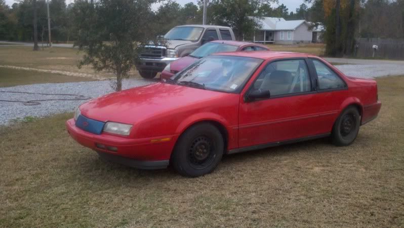

Has anyone else put this grille on a base? I figured it was bolt on, but looks like I'll be doing some trimming.

Problem is, the base bumper has a lip on top of it (that part that goes from under the headlight down that little dip then under the grill), where the mesh grill meets it. The Z04 bumper does not have that lip. So you will have to trim the lip off of the base bumper in order for the Z04 style grill to fit better. Or trim off the bottom section of the Z04 grill so it doesn't hit the bumper lip. Either way.
Now you just need to paint that red! lol

And cut a hole in it so some air gets in there.

Naw, it will still get air from underneath. Or enough anyway.

Hopefully! Seemed to do fine this morning.

Yeah...Berettas are bottom breathers. No need for an open grille.

So, does anyone think it'll look better without the Chevy emblem? Can't really put it back after I take it out.

You know what would set that look off? Put some sort of mesh in.
