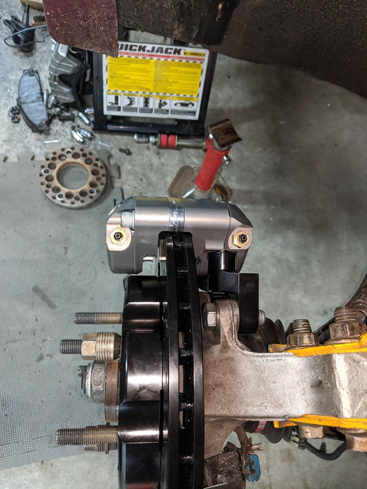

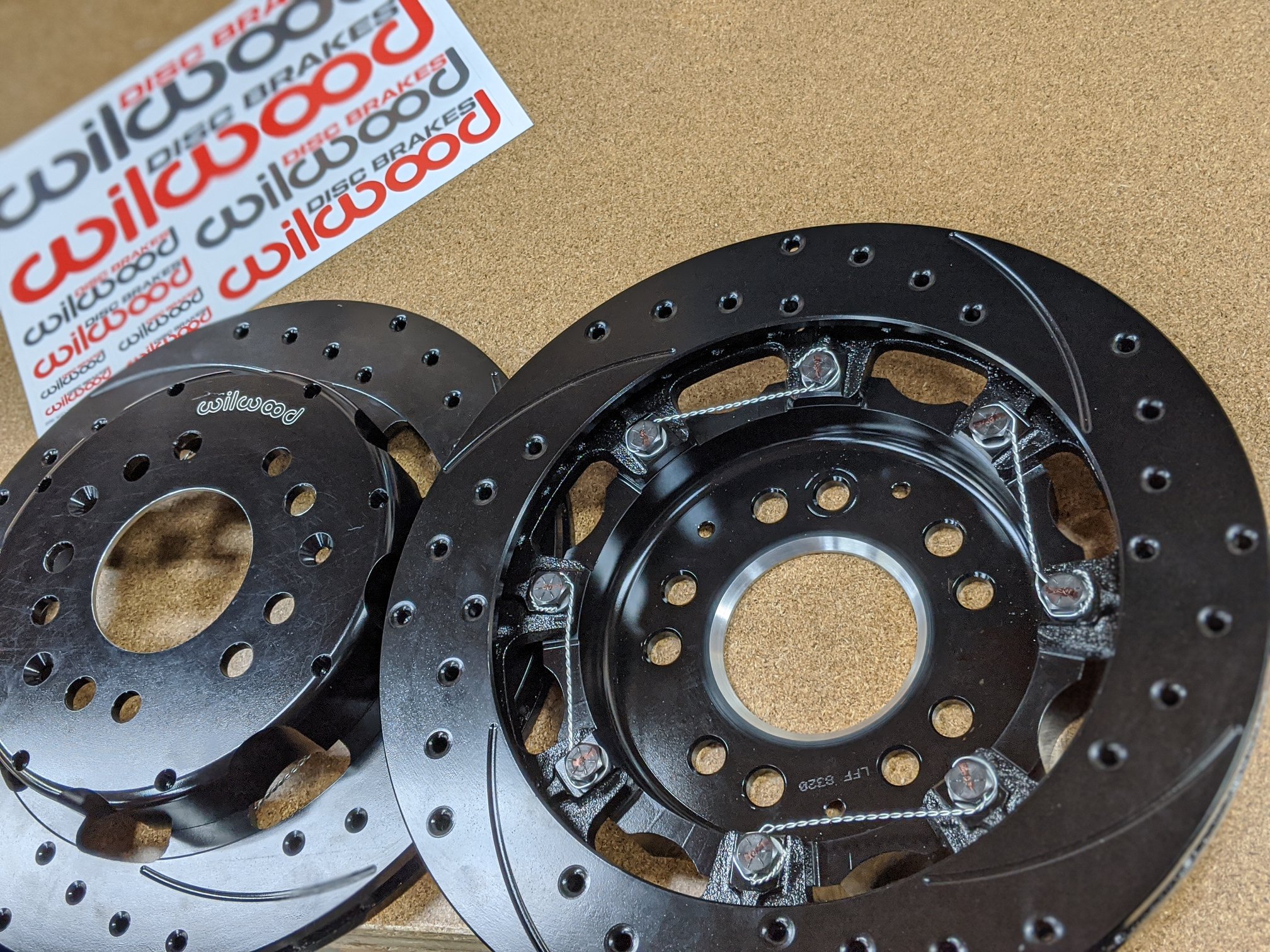

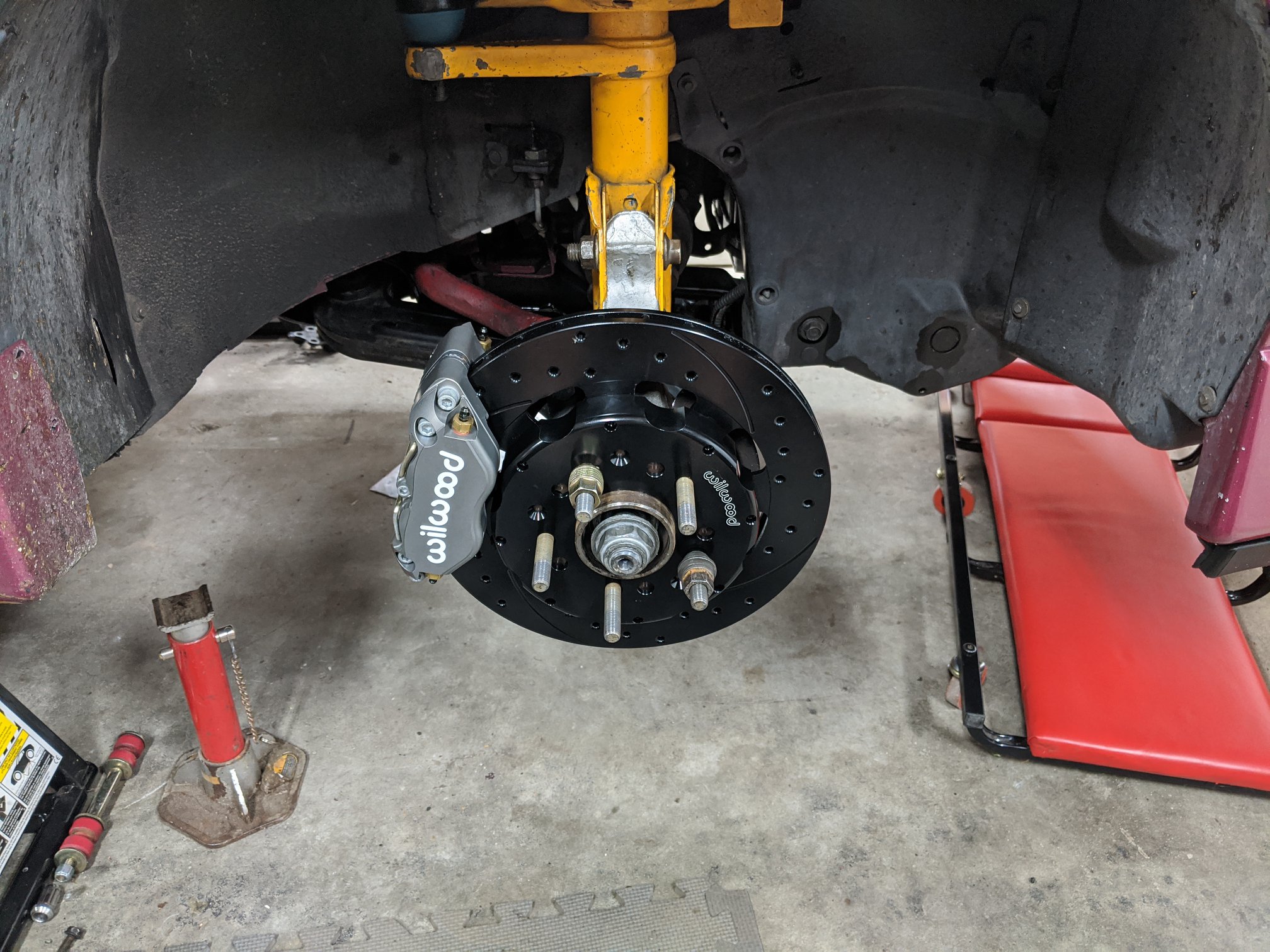

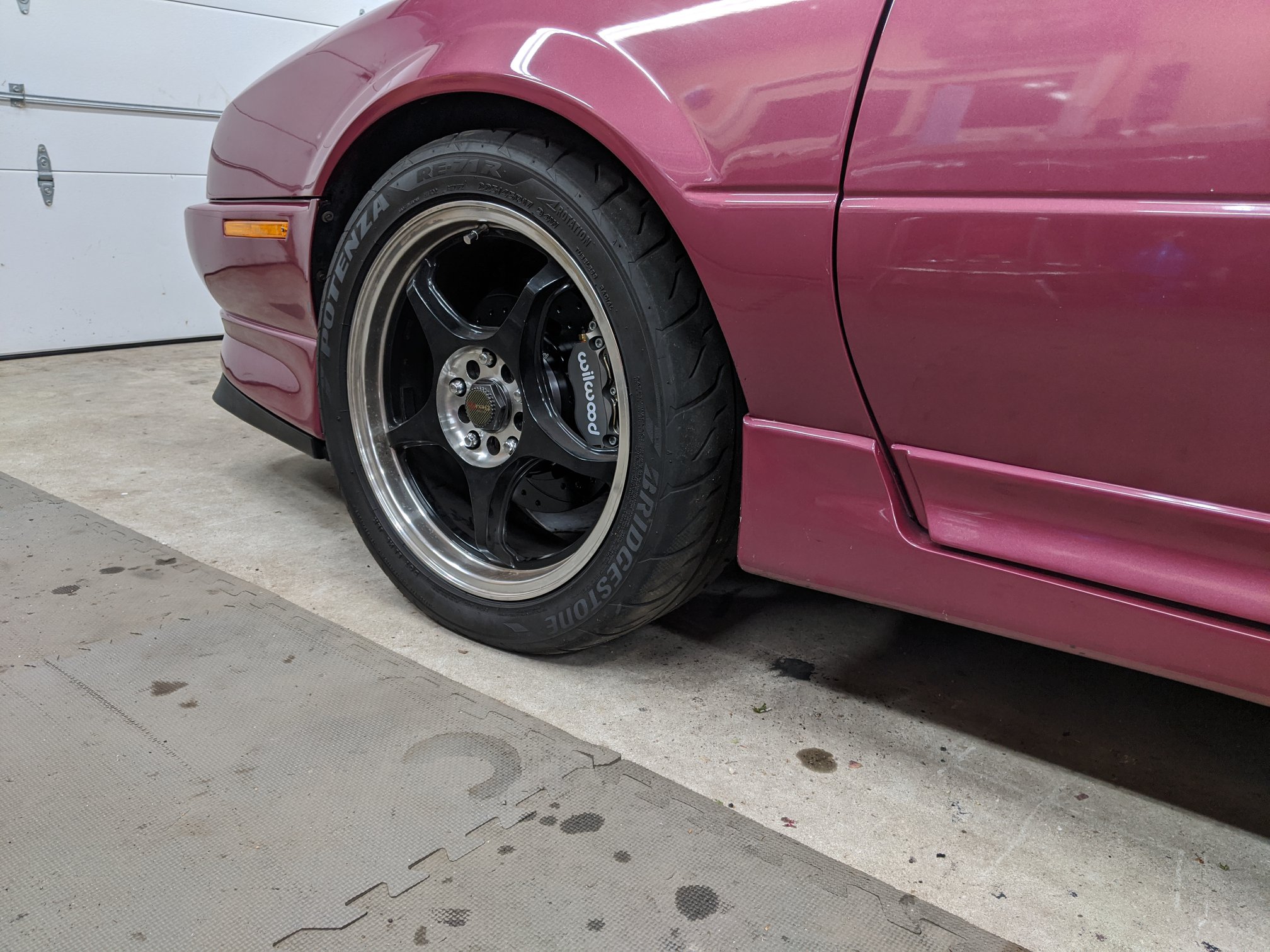

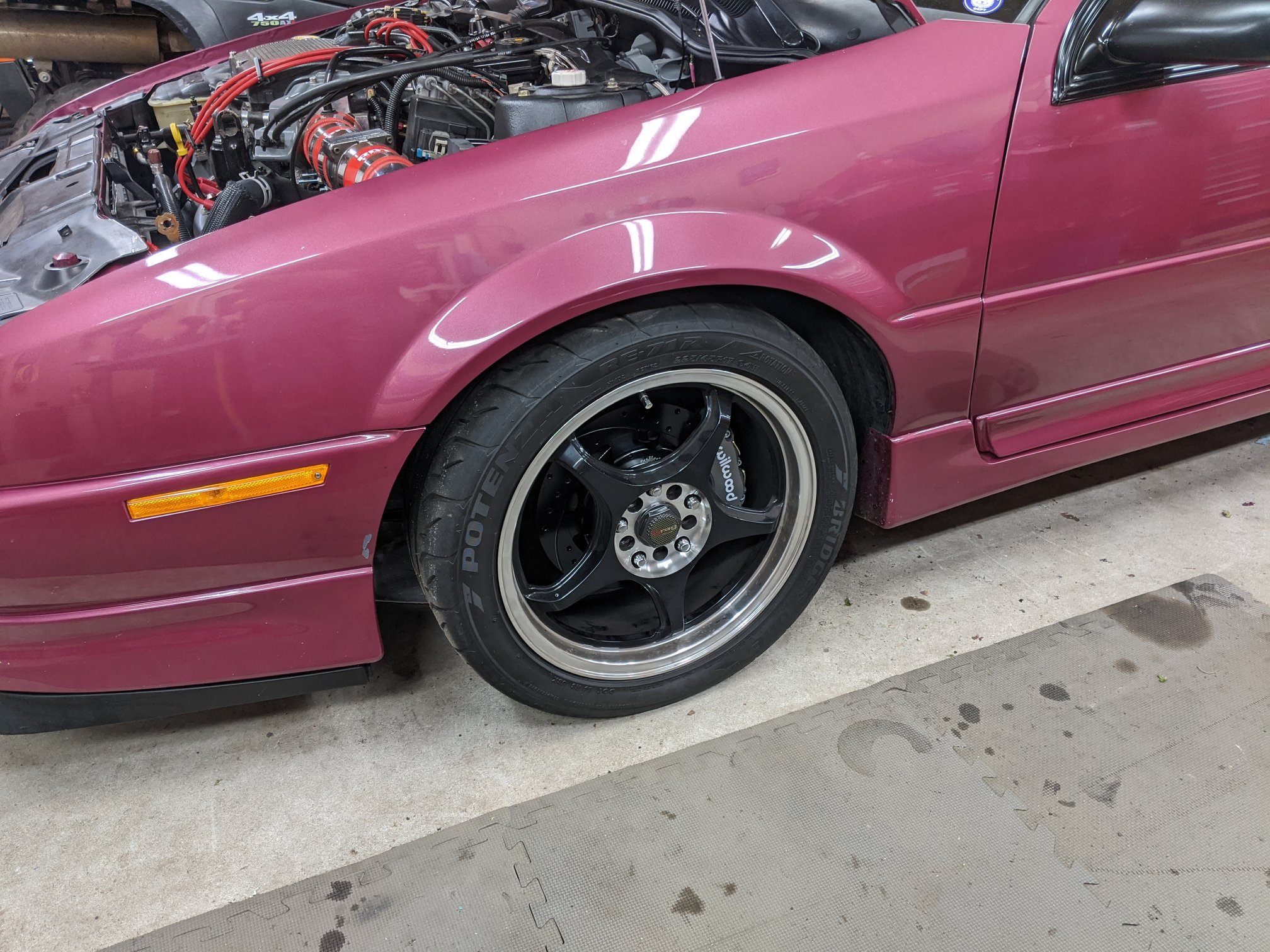

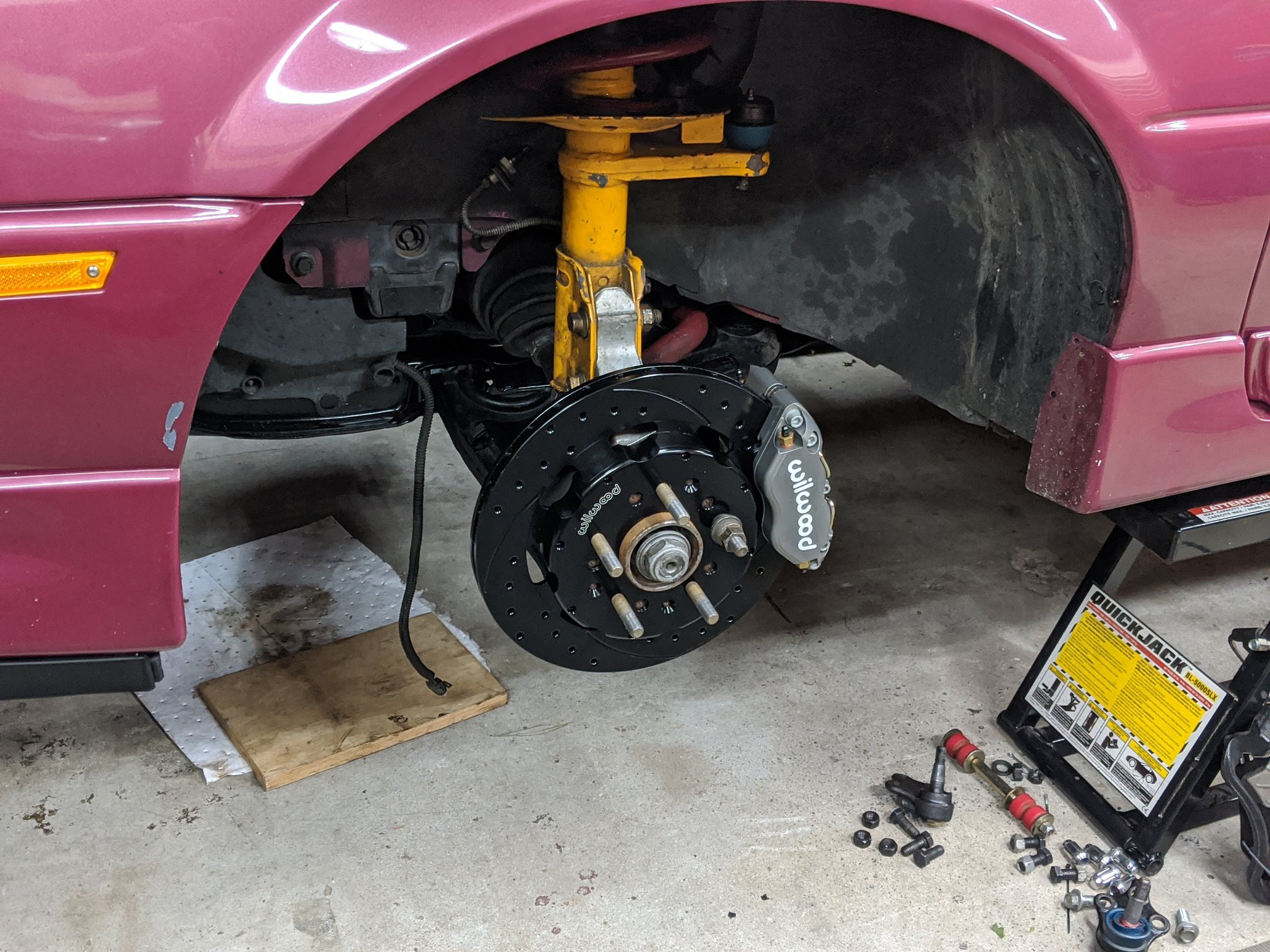

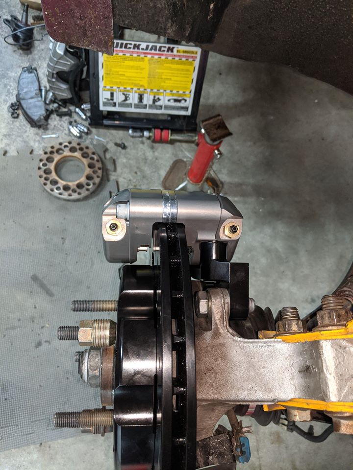

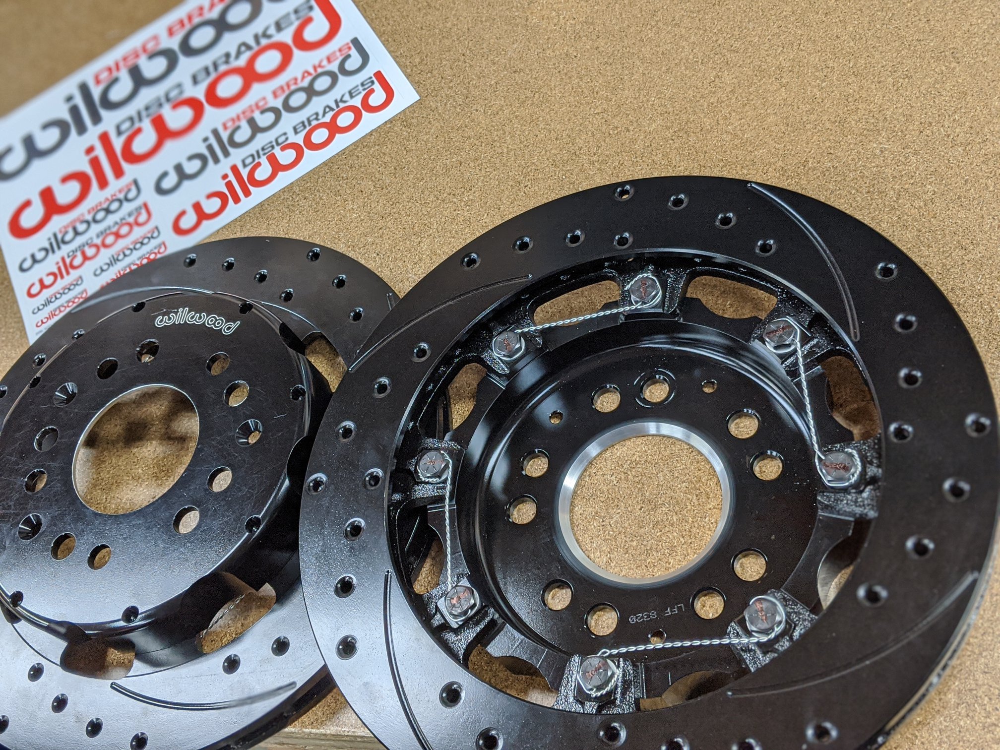

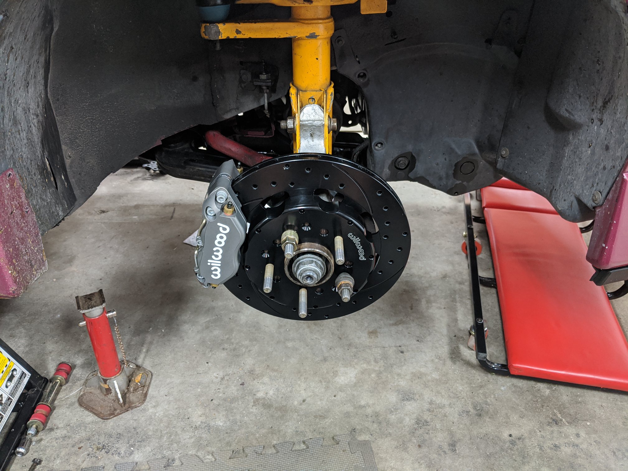

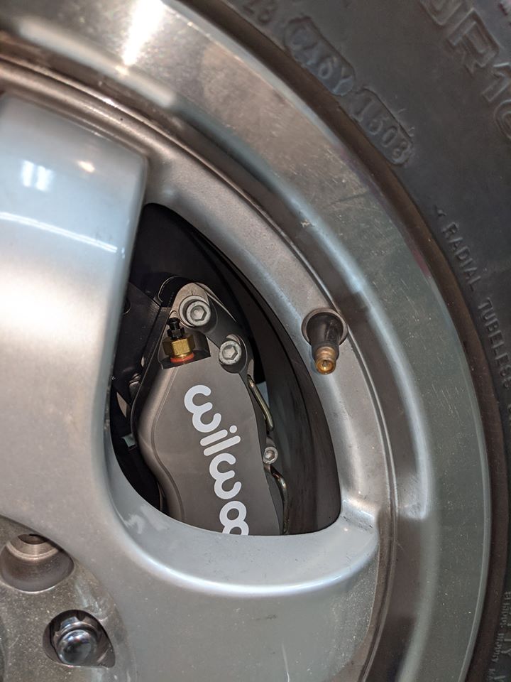

This project took a bit of fitting since I bought a 2000 Camaro Drag Race kit assuming it would fit since I can run 2000 Camaro brakes. Long story short, Factory brakes the abutment bracket mounts to the inside of the knuckle, Wilwood decided to mount theirs to the back side of the knuckle, and the N-body one isn't as thick as the F-body one. This resulted it me having to source a shorter rotor hat to bring the offset in. Thankfully I found a combo that worked and helped the rotor also clear the ball joints which was another interference issue.
I'm quite happy with how these feel and I'm extremely happy to go from a 13lb 10.75" rotor to a 9.5lb 11.75" rotor. BIG gain on the weight of the setup, and the increase diameter adds leverage to the whole braking system and you can really feel it.

Wow those look awesome, and I'll bet it's a world of improvement. Like you stated, a lot of fitting, but pretty slick how the hats are interchangeable. I had never messed with aftermarket brakes so that's news to me.

That is a really light big rotor. If my memory servers my correct, the stock rotors were around 5.5kg. The Subaru ones I'm using are 11kg and yours is coming to only 4,30913 on unit converter :o
Re: 1996 Mr.Pink
Yes that is correct... they weigh just under the weight of a factory rotor which I believe is around 10lbs... The N-body stuff I had been running was 11lbs each, and the F-body stuff, near 18lbs per rotor IIRC... If I went up to the 12.75" setup I believe that is a 10lb setup, but my abutment bracket would require longer studs and a spacer under the caliper to accommodate that. Plus I don't think it's necessary, this thing stops like a dream now.
