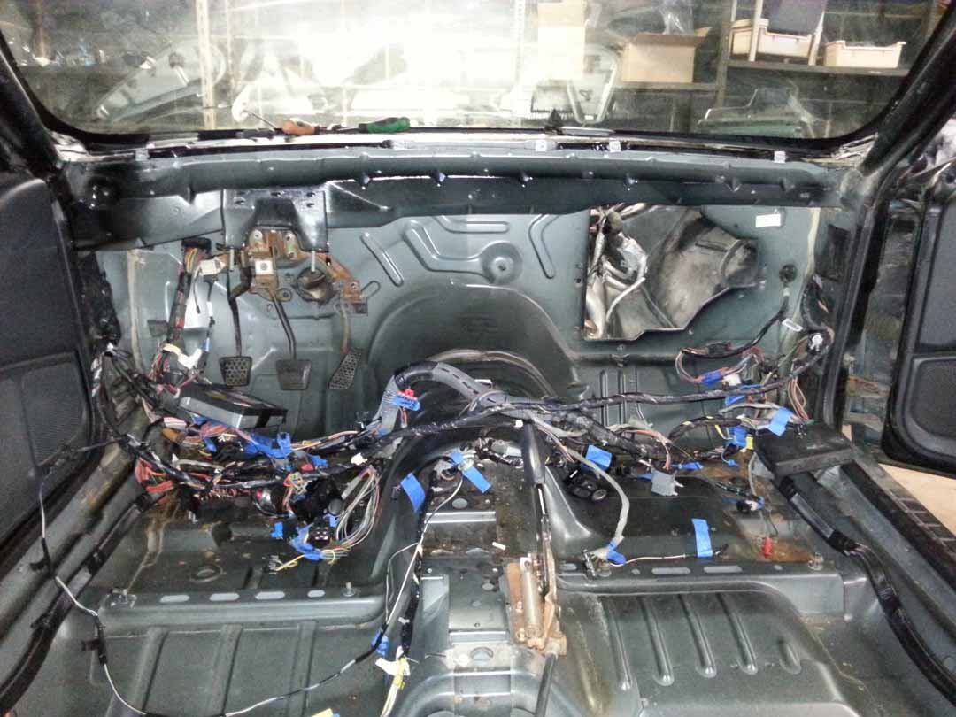

small progress update.....Most bolt on exterior body panels removed, all interior removed, fire wall cleared,

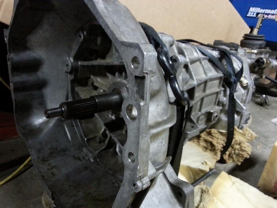

Post by jjanke »

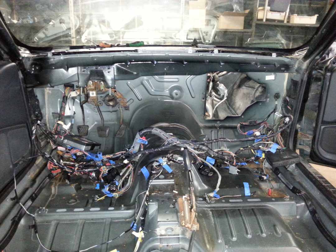

got a reconditioned T56 6 speed and mocked up the manual pedals as im also doing a manual swap

Post by jjanke »
reconditioned T56

woody90gtz wrote:Sweet deal! Can you do me a favor and measure the distance between the pivot point and attachment point for the clutch pedal? I'd like to figure out the stock 4th-gen pedal ratio and adjust mine to match while I have everything apart. Thanks.
Can u be more specific. The clutch pedal mounting point is on the fire wall where the master/slave cylinder pokes through and kinda also up top near where the steering column mounts.....im assuming u want to know how much travel the pedal has????

The attachment point for the clutch master cylinder rod to the pivot point...should be a couple inches I'd guess. And then also the total length of the pedal from the pivot point to the pedal pad. That would be sweet.
The clutch pedal on my 6spd swap lets out right at the top, where the other 3 manual Chevys I have it lets out in the middle. Makes the Camaro tougher to drive until I get used to it again. haha

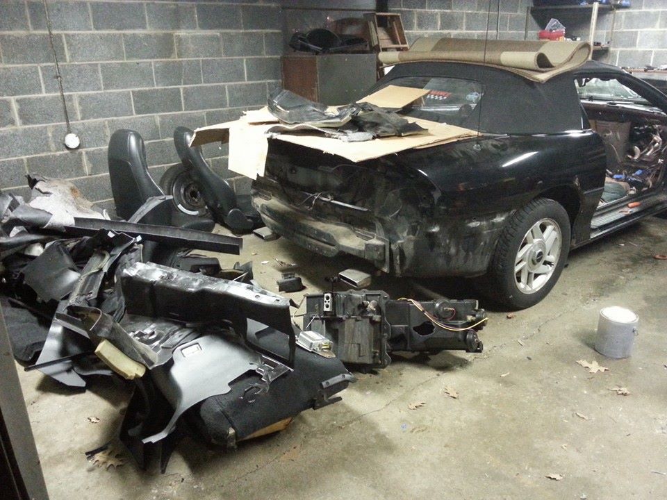

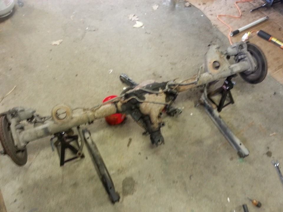

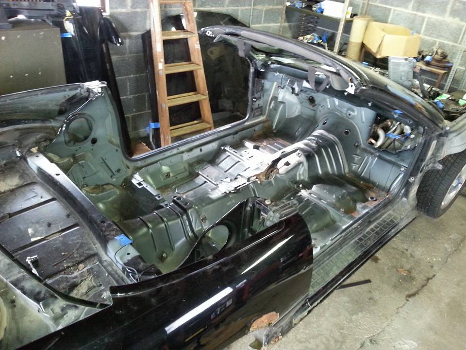

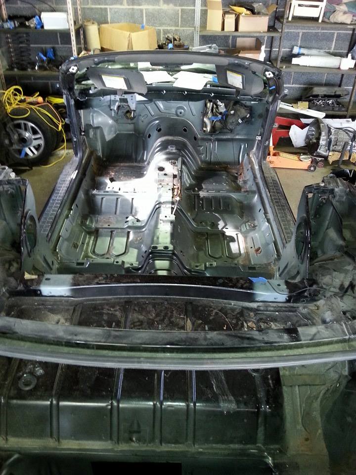

Post by jjanke »

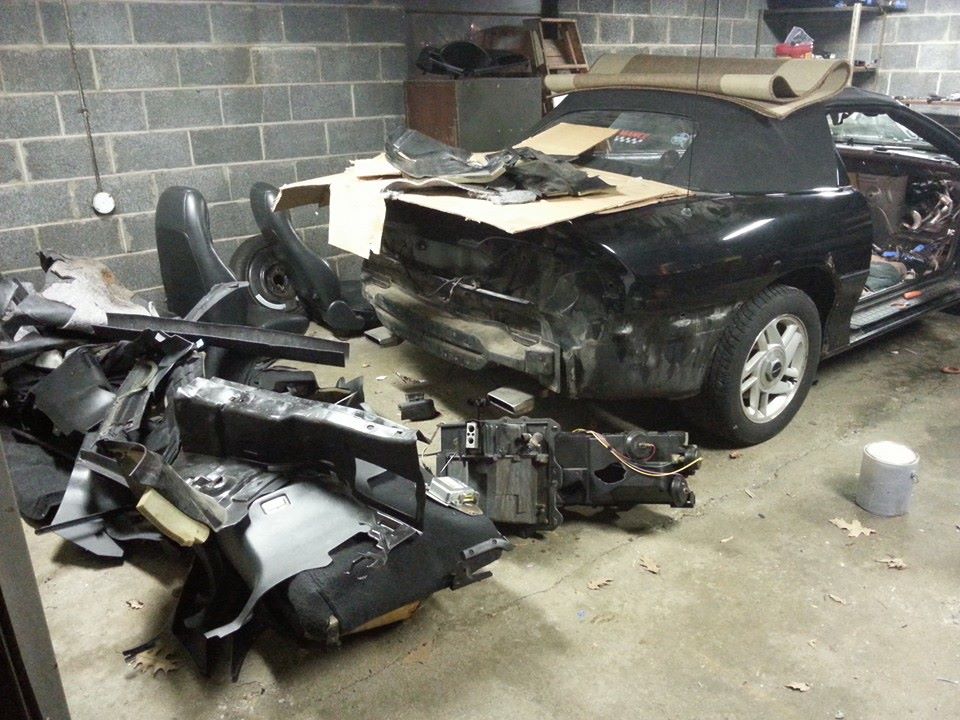

some more up dates... completely striped down to the unibody from the fire wall back. all wiring, fuel lines and tank, rear end, suspension, exhaust and convertible top and hydrolics/pump. Im ready to brace the floor and cut off the body. due to some crunchy frame rails under the body i have also decided to replace the rails with some 3x2 box tube from the rear up to the fire wall to stiffen up the chassis and have something solid for the roll cage to tie into.

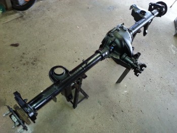

Post by jjanke »

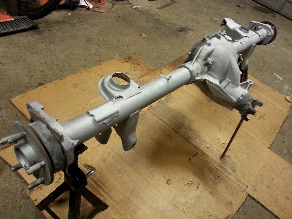

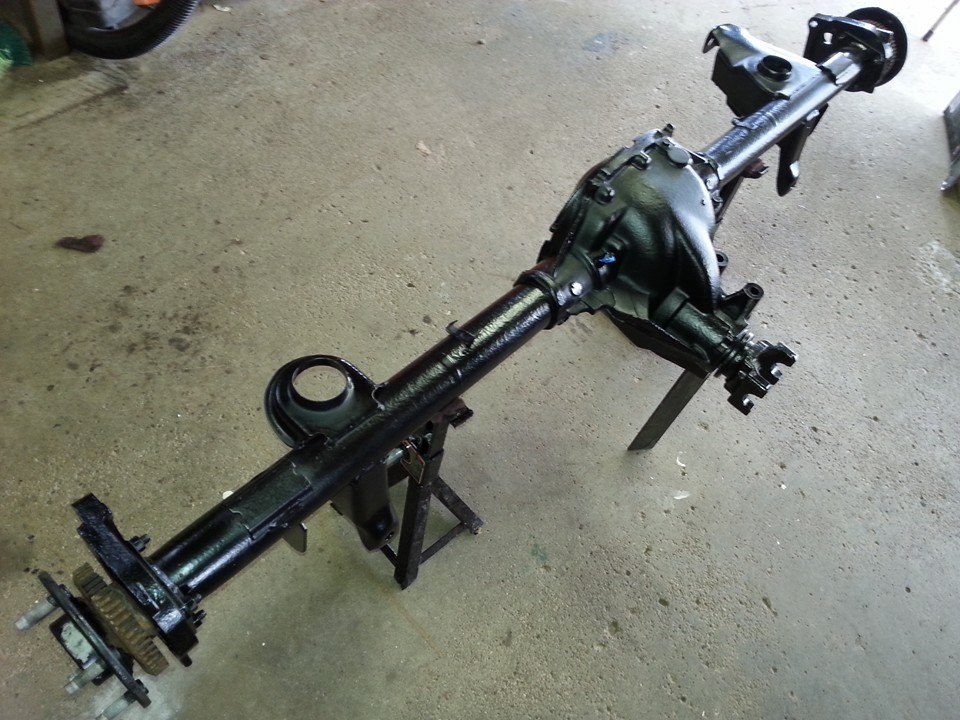

also cleaned up the axle and got 1" drop springs adjustable panhard bar and adjustable rear trailing arms.
