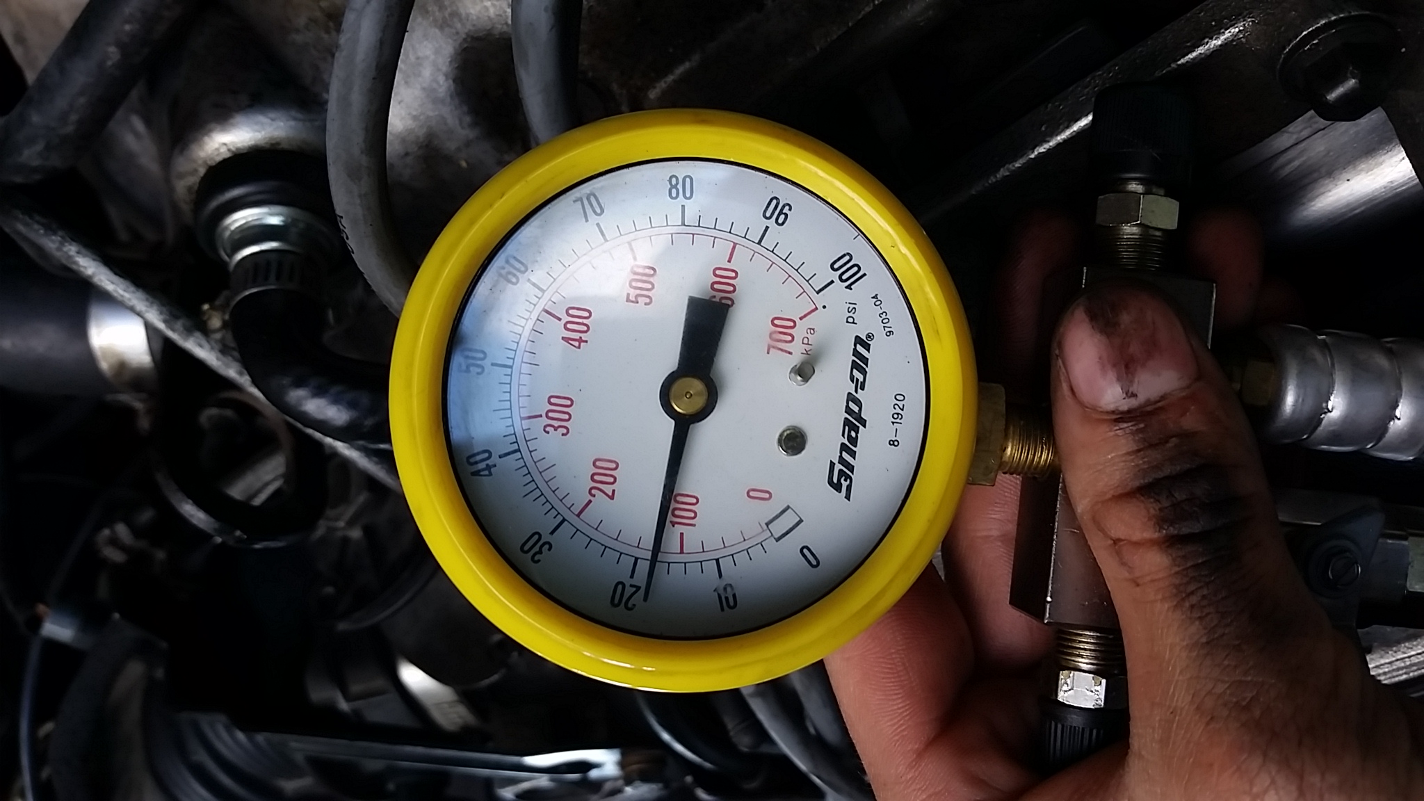

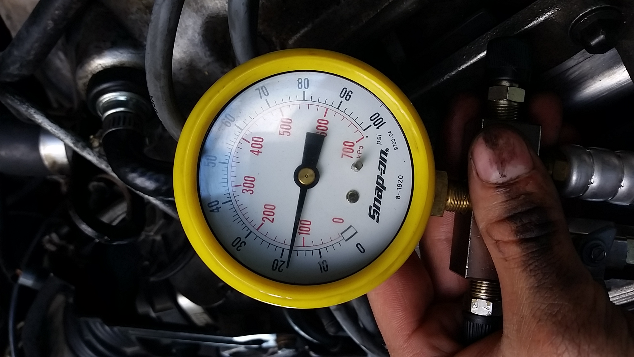

Re: 95 3100 Starting/acceleration problems
Post by Luckymc420 »
So just got to the garage. Gonna try replacing the filter first and see if my pressure changes.
Fuel pressure the same with and without the fuel reg. Vacuum plugged in.

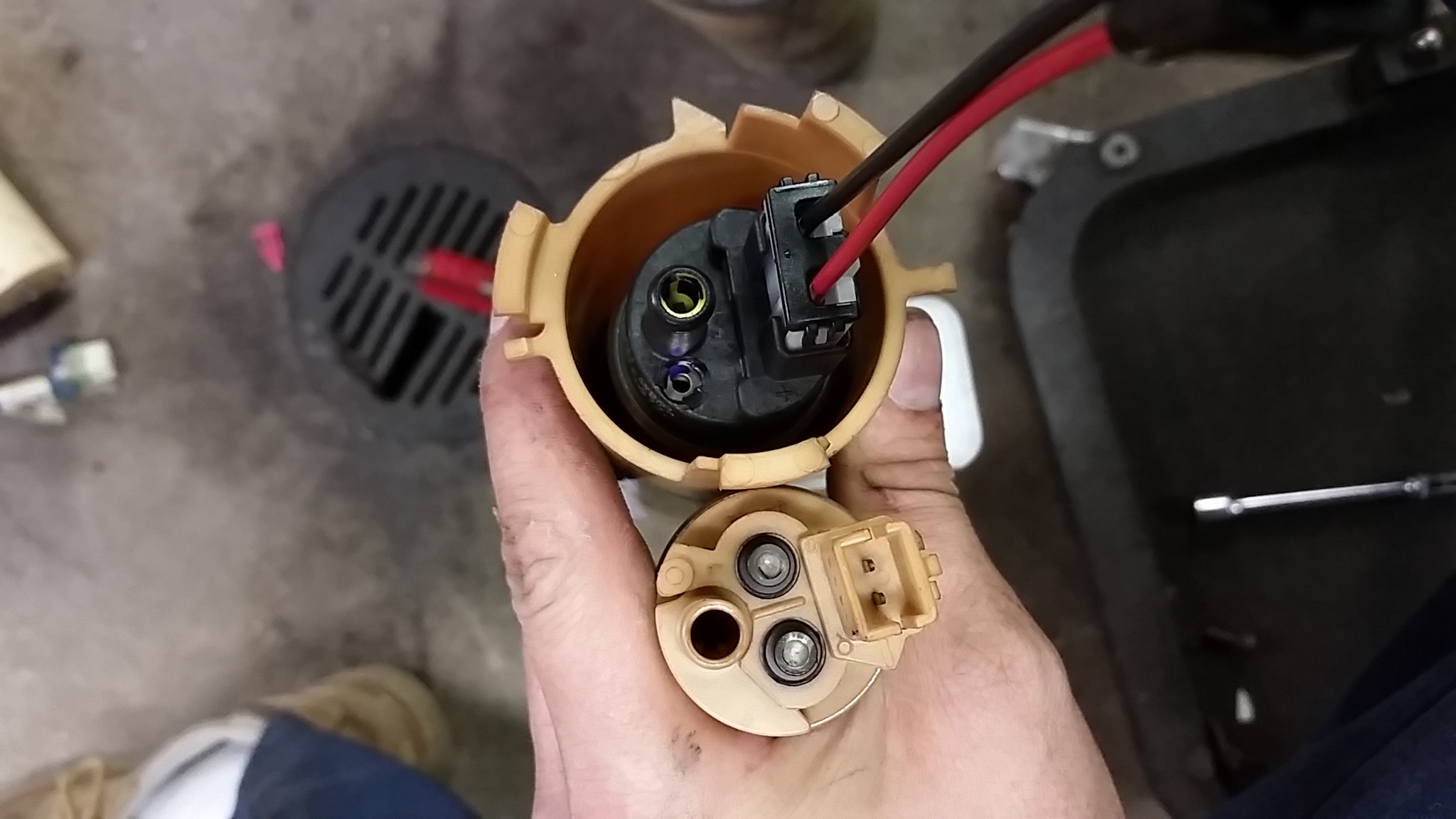

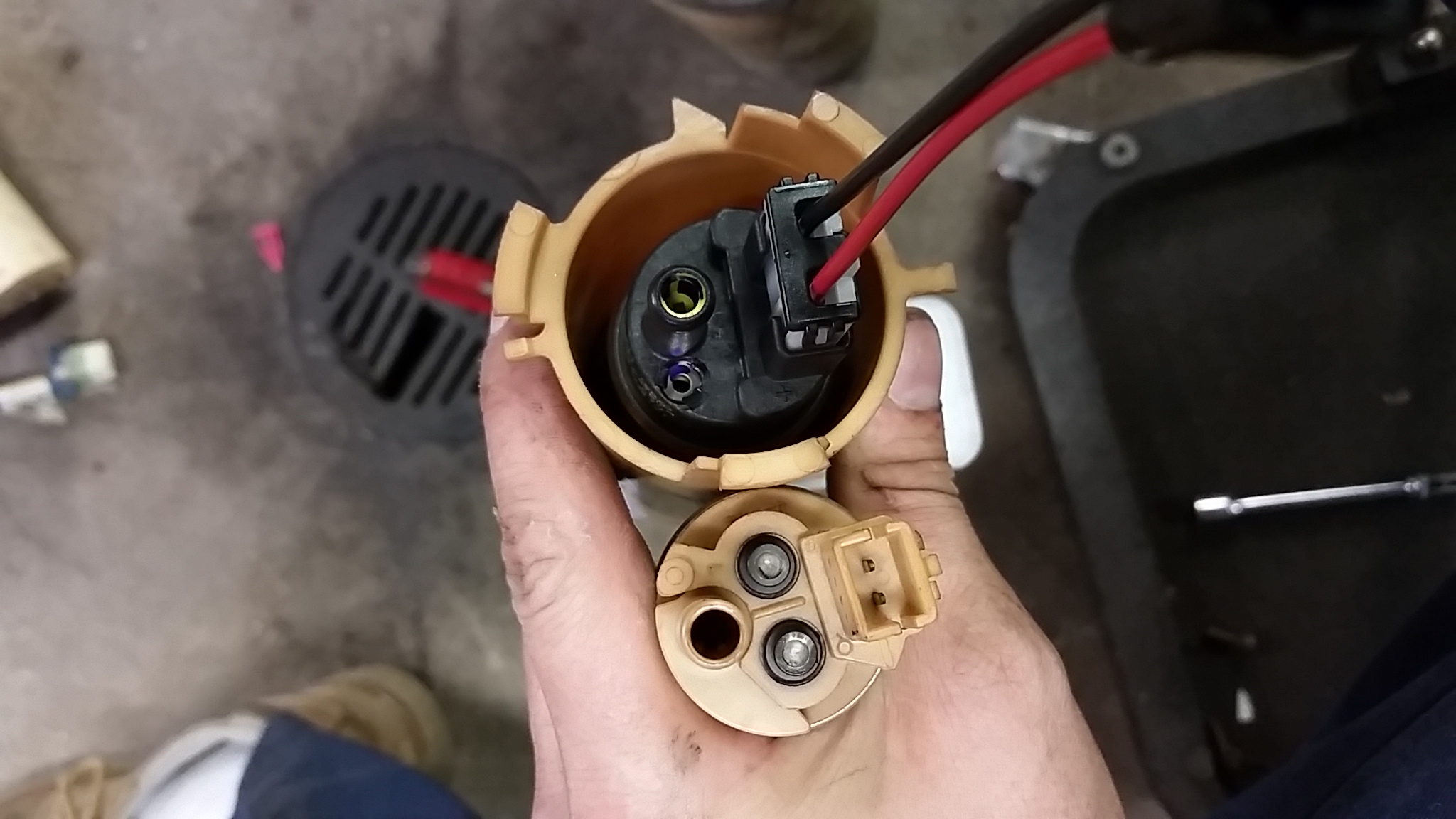

Well ran into a few problems. Glad I got those straps. This time the pump won't fit right. The space between the connection and the tube are different. Great! Thanks Napa. I managed to get it to work. Going back in after I cut out a strap bolt that broke...
