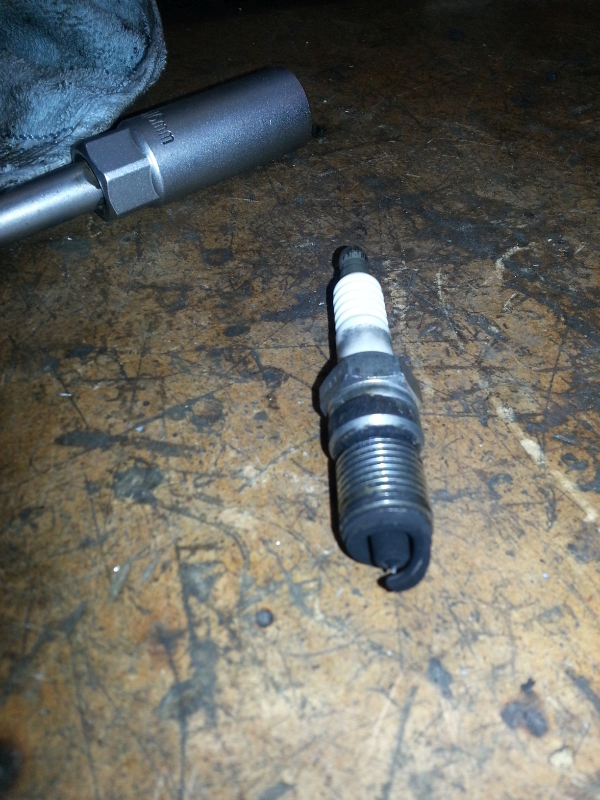

Also do all the plugs look like the one pictured or is one whiter than the others? This condition
would help confirm a bad injector.
Again, if one is bad and doesn't open to spray fuel, it will cause a lean pulse which the oxygen sensor
will tell the computer to richen the mixture. The good injectors will then spray too much fuel.

One plug was whiter than the others which were black. The car had a lumpy idle
which became worse after it warmed up a bit.

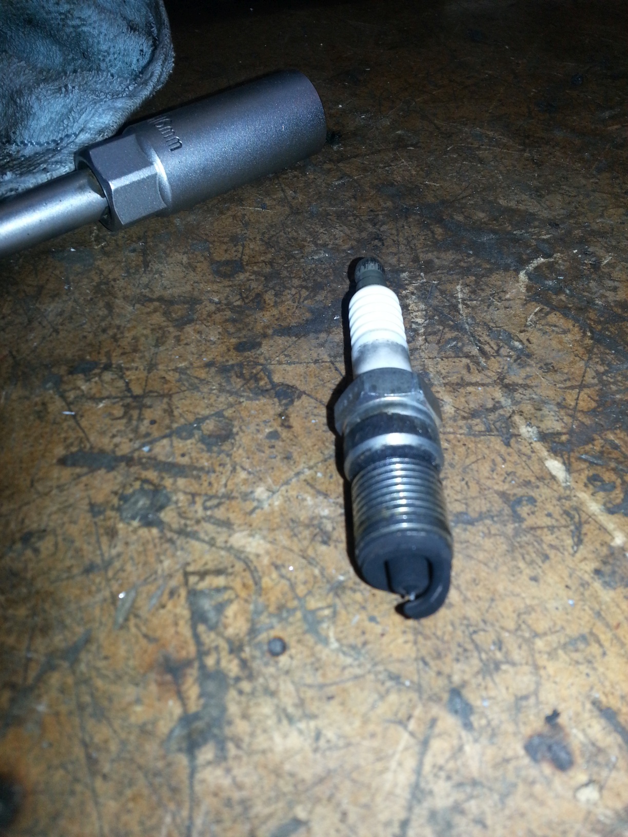

Yeah, will check all injectors when i get them back. And yes, all spark plugs looked like that spark plug you see in the picture. When i took them out we cleaned them and let the car idle for some minutes and take it to a testdrive... after that they nearly looked like the same as on the picture.
