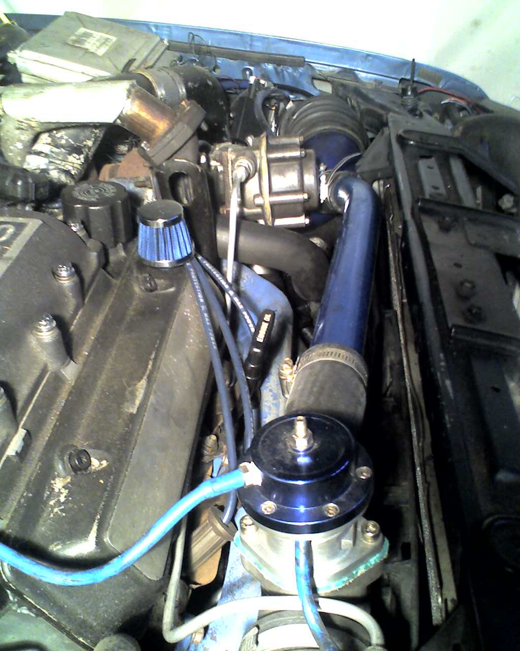

Be careful with what you buy -for instance, "T-3" and "T-4" refer to a specific flange type for mounting the turbo to the exhaust, not necessarily a specific capacity for boost pressure or volume. Generally, the T-4s are bigger, but the A/R and "trim" numbers tell much more. There are people here that know more about this than I do too. T-3s and T-4s are very interchangeable too, and are easy to hybrid. I almost did that with mine, using my T-4's huge .60 A/R compressor section with the turbine and liquid-cooled body from a T-3 I had "lying around", but opted not to restrict my exhaust that much. As a result, I have (because if the specific options on my T-4) an oil-cooled body (sucks), a gargantuan turbine section (I want to say .87 A/R?) that matches my compressor nicely and doesn't restrict exhaust-flow from my balanced headers but also takes forever to spool, and an external waste-gate, which while controlling the boost better than an internal WG was far more complicated to plumb and required the room for the soft-ball sized WG.
If you are having that cross-over pipe built for you, you might want to have a T-3 or T-4 mounting flange made for it instead of the stock T-25 flange...
The bypass valve is in the foreground -MAF vs MAP required the use of a bypass instead of a BOV.  Too bad.<br />The WG is that sideways distributor-cap looking thing towards the top of the pic.<br />Not all of them are that big, but depending on what you buy for a turbo, you may need an external WG...<br />Also note the piping from it that arcs up over the intake charge pipe to the TB.<br />Making all that clear the Beretta's hood wasn't fun.
