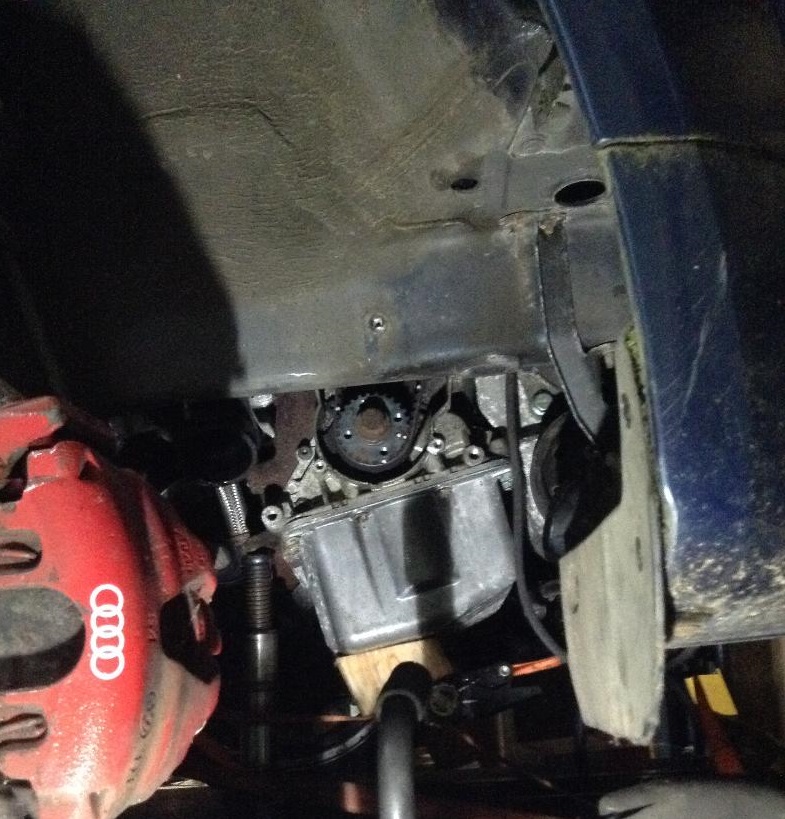

And one more reason to dislike most timing-belts: Take the wheel off and work on the entire face of the engine from top and bottom... Dumb.
I found the belt HAD been changed (Gates brand -what I usually choose too), but the water-pump was original Audi -possibly replaced with OEM, possibly NOT replaced... Either way, plastic junk impeller, had already cracked and was missing pieces. :Search: Nowhere in sight and crumbly as 'Blau" cheese... :D The belt had stretched enough that the hydraulic tensioner wasn't even keeping up anymore. So yeah, the belt and the pump needed to go.

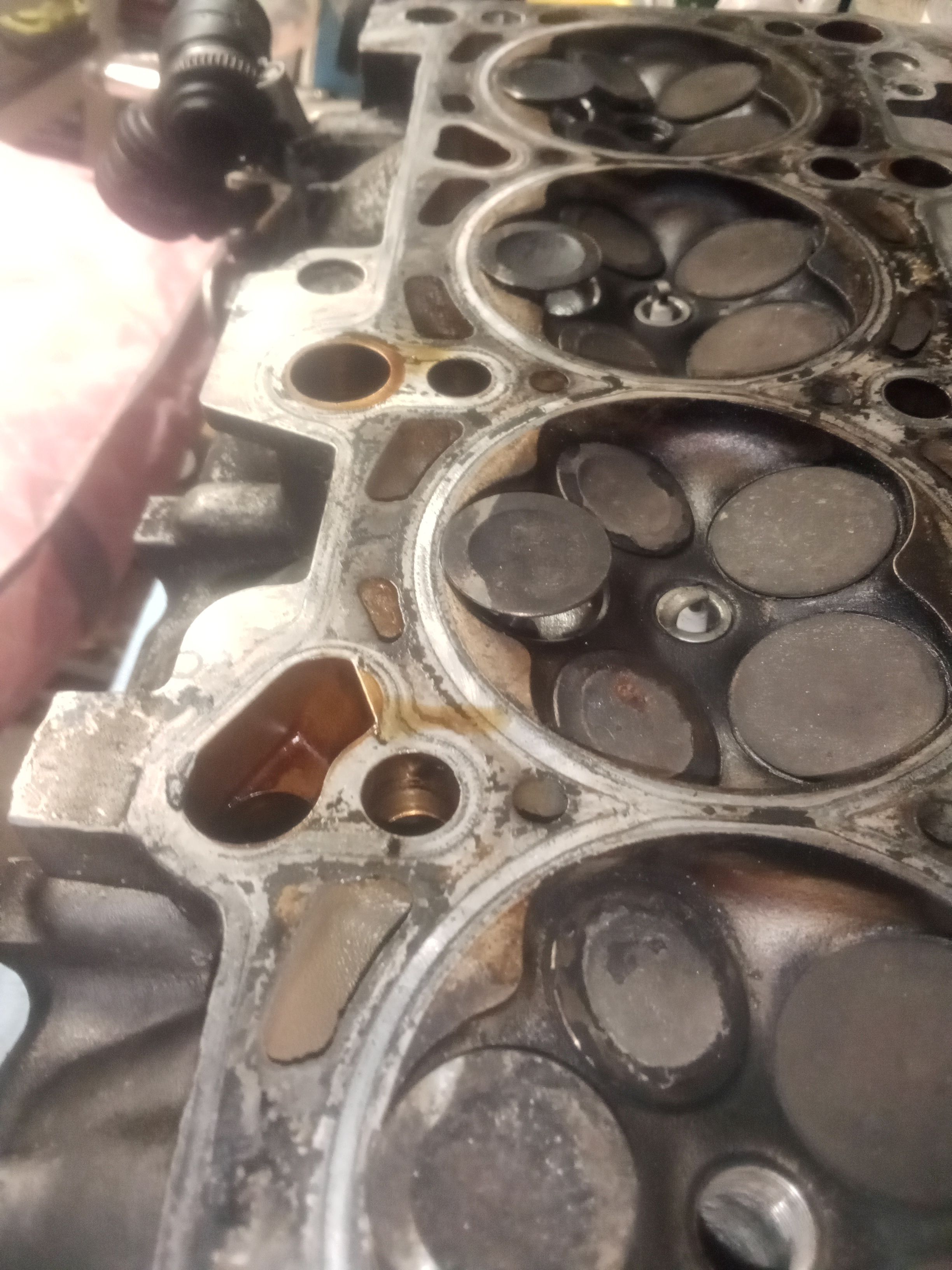

So, after a season's worth of months, I finally dragged the little car into the shop, and got to work.
Dem be some bent valves... Stupid interference design...

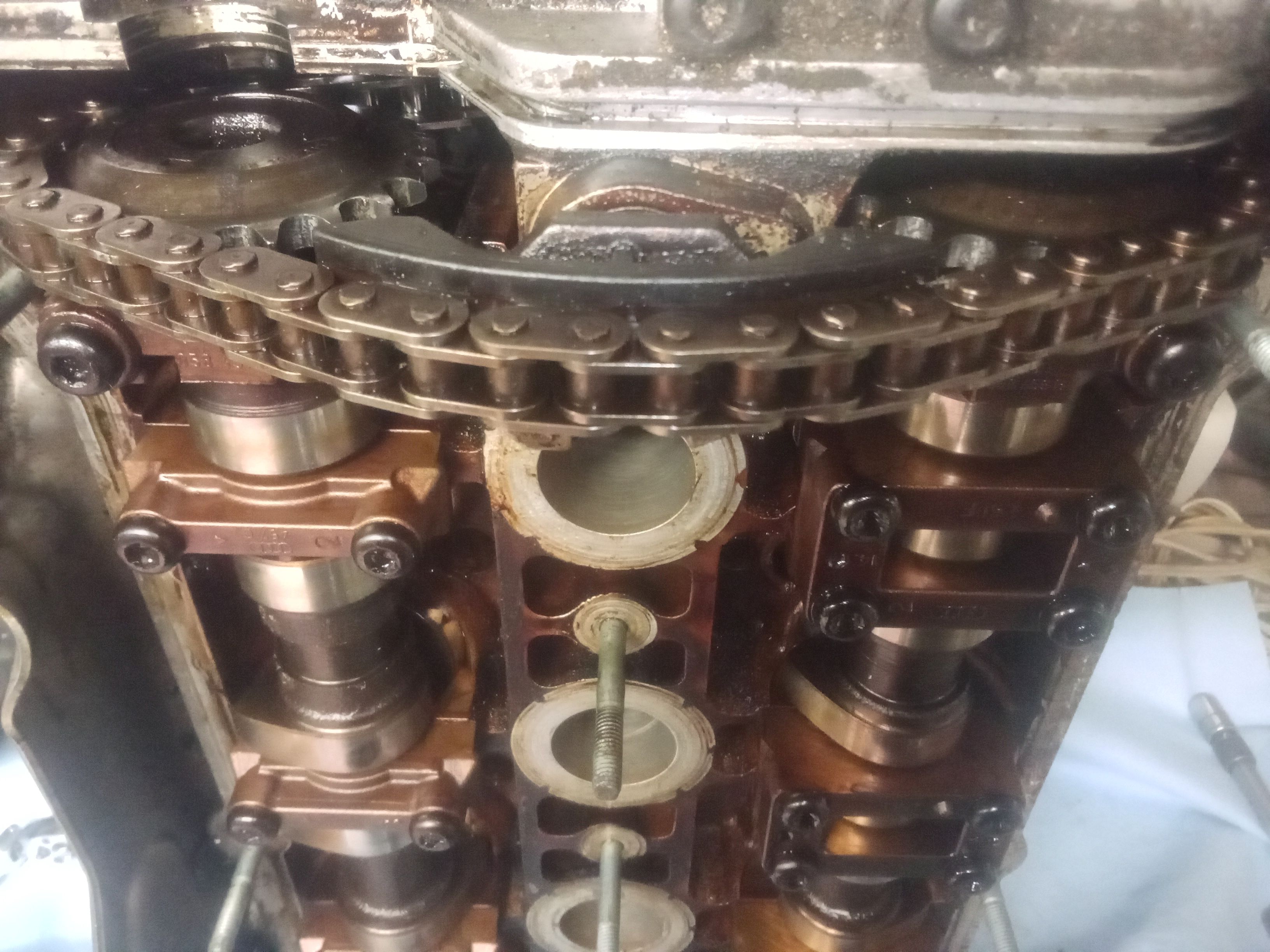

Riddle me this, Batman... If VAG can utilize a CHAIN to drive the Intake Cam off of the Exhaust Cam, why the !@$#! don't they use a frigging CHAIN to drive the Exhaust Cam in the first place to avoid breakdowns and repairs like this?  GM did with the Quad-Four and 2.4L Twin Cam engines, just saying...>:(
