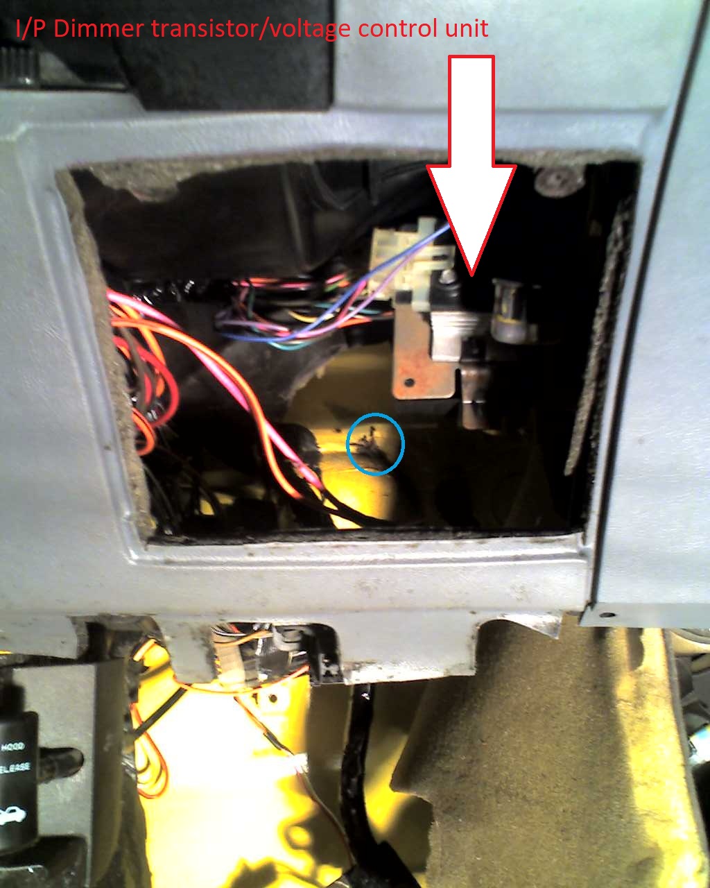

For your dimmer problem, that is much easier. Since your backlights are not controlled nor regulated by the cluster itself, the problem isn't some mysterious VDO voodoo magic. :) This is usually caused by the interior light dimmer voltage control. It is behind your map-pocket under the left side of the dash.
I know O'Reilly sells them as the 'dimmer switch' (not a switch at all, actually a transistor) part # DS349 runs ~$44 from them -probably half that from Rock Auto. Virtually every GM vehicle from the era used that thing, or the hat-shaped transistor in it, so when I bought my Yellow Indy several years ago, I replaced mine with a junk-yard part and saved the money -they don't fail often.
