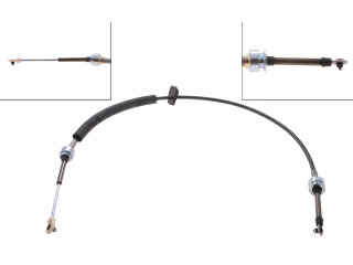

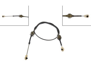

My notes I guess.
I am getting some mixed info:
I will update this post as I get more info today.
I called GM And got some prices. WOW
Paid in advance and non return:
47.6 in. $233.79 shifter lever P/N 10186817
50.4 in. $202.38 selector lever P/N 10186820
Napa length are 50.875" (selector) and 51.125" (shifter) Those are for a 1991. - need to explain more.
I went to RockAuto parts and used the GM PN to cross and I got:
10186817 = DORMAN Part # 16655 - Shifter Cable (Napa cable) - 51.125" 1991-88 General Motors (Buick, Cadillac, Chevrolet, Chevrolet/GMC Truck, Oldsmobile, Pontiac)
10186820 = Can't find parts.
I went to Dorman site and looked up some info:
Selector Lever
Shifter Cable
THIS IS FOR 88-91!!
I want to make sure I get the right length before I start calling for custom cables.
Any thought?
Selector Lever
Shifter Cable
THIS IS FOR 88-91!!
Any thought?
