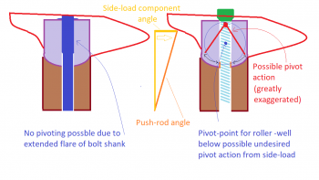

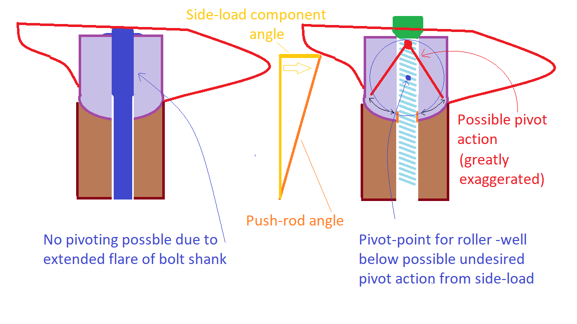

Re: Project 91 "SS" 3400/5spd

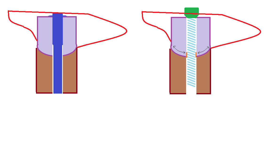

I had a thought on your valvetrain noise. I had concerns over this in the first place, but you handled it so slickly that I dismissed my concerns, and the lifters were an obvious problem, so... Considering how much trouble you have been having and what you have already eliminated as likely causes, could this be causing your issues?:
Even IF the rocker cannot shift back and forth at the top, are you SURE it cannot slide back and forth at the bottom? Have you inspected the studs for any indication of impact from the rocker, either at the top or the BASE of the pedestal? Is it possible that the studs are flexing under the loads? What about the top section of the rocker, with the roller-shaft, could it be pivoting at the top and sliding back and forth on the top of the pedestal? The elongated flare on the shoulder of the stock bolts would also prevent that action, so maybe another reason they were designed that way...
It may simply be time to turn up the volume on the radio and put on a louder muffler...

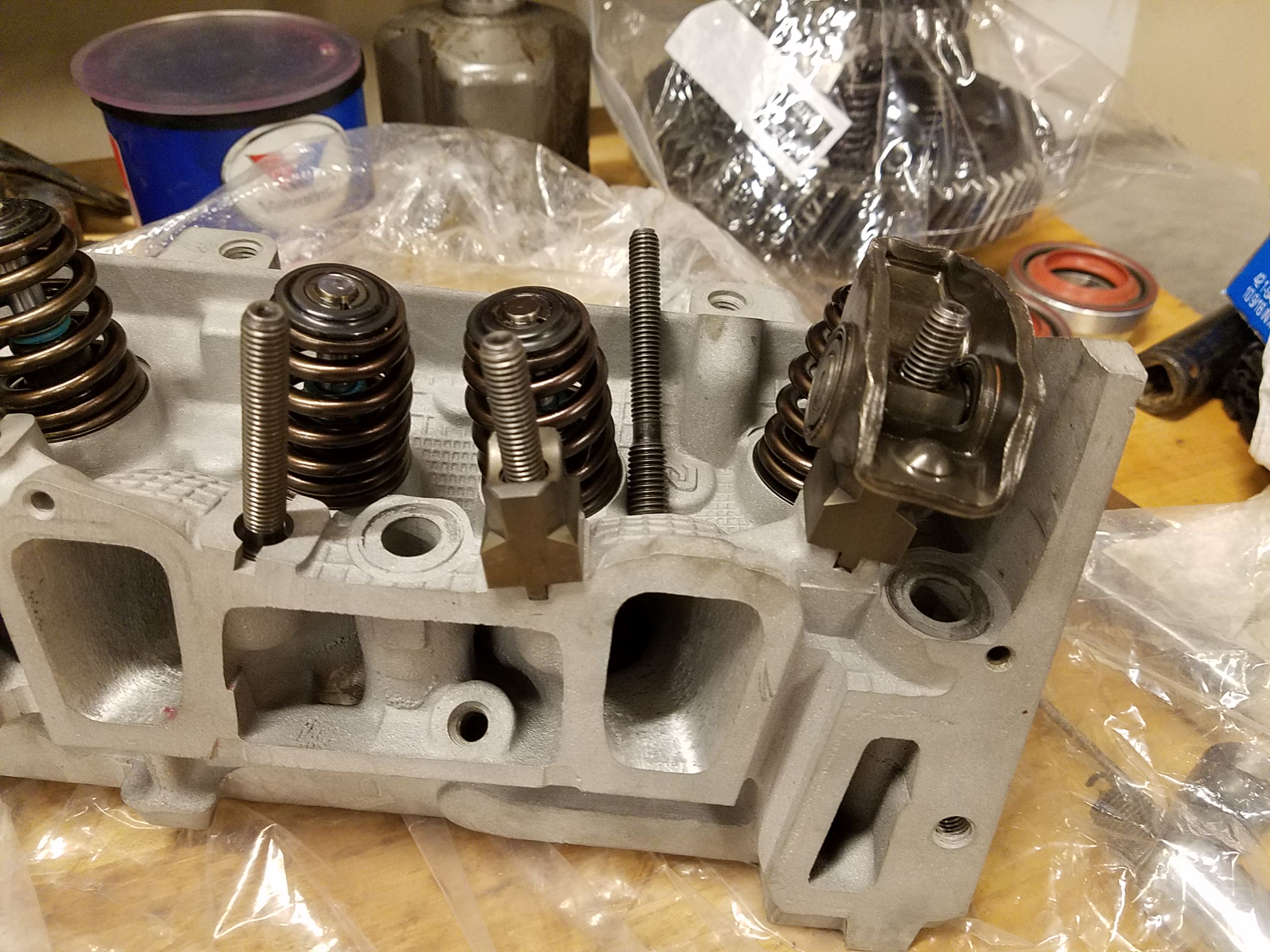

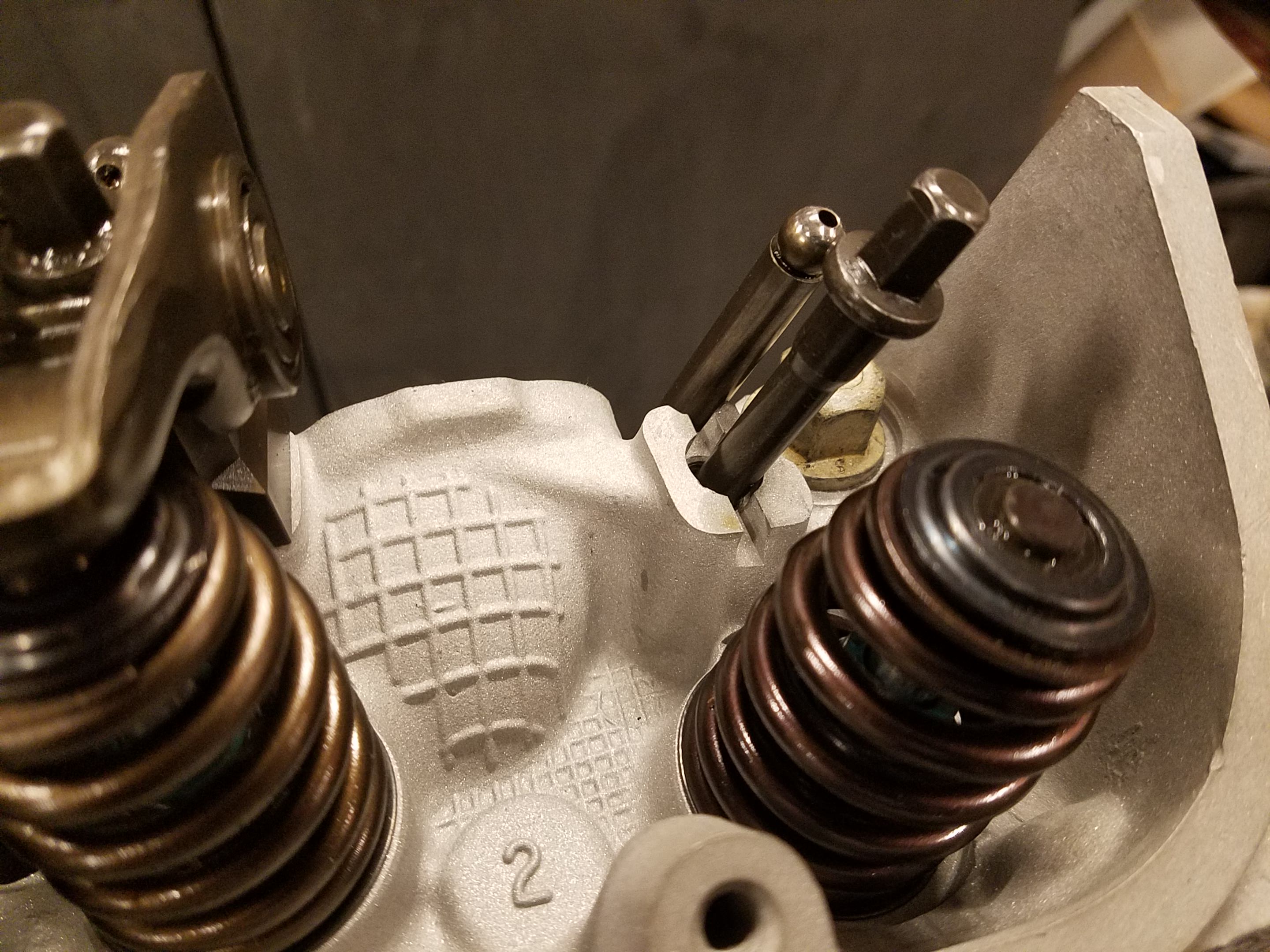

Yeah, I've been super-skeptical about the step studs since that's the only thing "exotic" about this setup. I've examined them closely every time they've been out and went over them with Ben, too.
There are a few things I'm sure of:
The pedestals do sit flat on the head, so the 10mm lower portion is not affecting the seat of the 8mm pedestals.
There is no visible contact on the threads of the stud, either by the pedestal or the rocker trunnion. (There was on one, where a rocker had loosened, but I caught that the same day and it was a distinctly different sound.)
I cut a conical seat in the nuts on the top side so they will self-center on the stud like the oversize shank on the stock bolts.
A couple things I think:
The diameter of the stud threaded vs non-thread shouldn't really matter, because the pedestal bottoms out on the head and the rocker trunnion bottoms out on the pedestal. There isn't anywhere for it to flex like an old SBC rocker stud would. The 8mm bolts also have a reduced shank for most of the length that is probably similar to the strength of the 8mm threaded stud.
The small variation in preload that I have cylinder to cylinder may be due to mismatched rocker pedestals and arms. Perhaps they are measured and matched at the factory like lifters are. But the small difference is all within spec of what Ben calls good preload.
What I wonder:
If a set of new 10mm rockers would fix the issue somehow. I have no great evidence to say that it would, other than how quiet a stock 3400 valvetrain is compared to mine. But with a more aggressive lobe, more lift and more spring pressure than stock...it just might not be same. I was going to listen to Jon's car at bfest for comparison and forgot. But Jay's stock setup is much quieter.

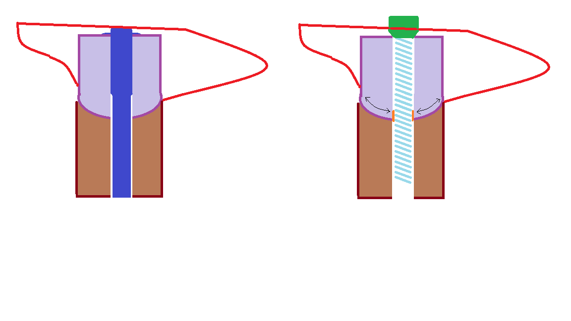

I saw the conical cuts you made on the lathe, that was the main reason I had dismissed my worries about the VW studs. But I got thinking (often a problem that generates many more problems), and this is what I am saying about the extended shoulder on the OE bolts:
Personally, I never liked the 8mm rocker-bolts anyway -too rinky-dink for an aluminum head IMO. As I've said, I have seen them pull out. I don't even know when they switched from the larger bolts, but it might be worth a trip to the junk-yard for beefier parts that offer stock components.
As you have said though, with that cam and other upgrades, you may be stuck with what you have, I'm just surprised in that case that Ben wouldn't expect it too -it isn't like your engine's stats are a new or unusual thing for him.
Bottom line I guess, is that hydraulic lifters are supposed to take out any slop generated by imperfect pushrod length (and change-of-length caused by changes in engine temperature, of course), and they tend to be very forgiving. Using MPFI heads on my 3400 LA1 block with stock Ram-Air H.O. cam (nothing special) and OE roller lifters, I was able to mix-n-match pushrods from both engines to fit the 3400 roller-fulcrum rockers I custom installed -I have never had any valvetrain problems with that engine, and I put that together for the '90 Turbo 'Retta about seven years ago... You are already about six stages of sophistication beyond that build, so I cannot imagine you have a preload or pushrod length problem.
My thought is that the 'trunnion' may be pivoting with the slight side-force applied by the pushrod, which could cause impact noise against the stub, plus whatever vibrational noise as the bottom of the trunnion grinds along the top saddle of the pedestal base, and would change effective distance between lifter and rocker arm. Not much, and I really don't see how it could cause an audible noise without visible damage to the threads of the stud, but valvetrain is a finicky thing. The gap (orange) between VW stud and trunnion (purple) could cause movement. The OE bolt would prevent this movement.Rettax3 wrote:Is it possible that the studs are flexing under the loads? What about the top section of the rocker, ["trunnion"], could it be pivoting at the top and sliding back and forth on the top of the pedestal? The elongated flare on the shoulder of the stock bolts would also prevent that action, so maybe another reason they were designed that way...

So you're wondering about the rounded bottom of the roller actually sliding. I just looked through my photos and don't see one that would show yes or no, but I would really doubt it. The amount of force it would take to overcome the friction to twist that clamped section with a lot of surface area has got to be exponentially more than rotating at the fulcrum on needle bearings. I would think.
Are you thinking Woody's valve noise might be the valves themselves? That would be interesting, I don't think I've ever heard something like that suggested before. Good outside-the-box thinking.3X00-Modified wrote:I can't remember but are those SS valves? or Factory 3400 valves in those heads? I know when playing with those during assy, they made a distinctively louder ting when seating.
I am sure it wouldn't rotate as a unit when it could just rotate on the rollers, I agree, but a side-load imposed could cause a pivoting action at the top, near the bolt-head (or nut, in your case). Was just a thought... I would slap-in the extra set you have access to, at least on the front head, before throwing more money at it for a 'maybe' fix -like Jon says, this may just be part of the territory for upgrading the heads -but I have no idea how bad it actually sounds in real life, so...woody90gtz wrote:So you're wondering about the rounded bottom of the roller actually sliding. I just looked through my photos and don't see one that would show yes or no, but I would really doubt it. The amount of force it would take to overcome the friction to twist that clamped section with a lot of surface area has got to be exponentially more than rotating at the fulcrum on needle bearings. I would think.
