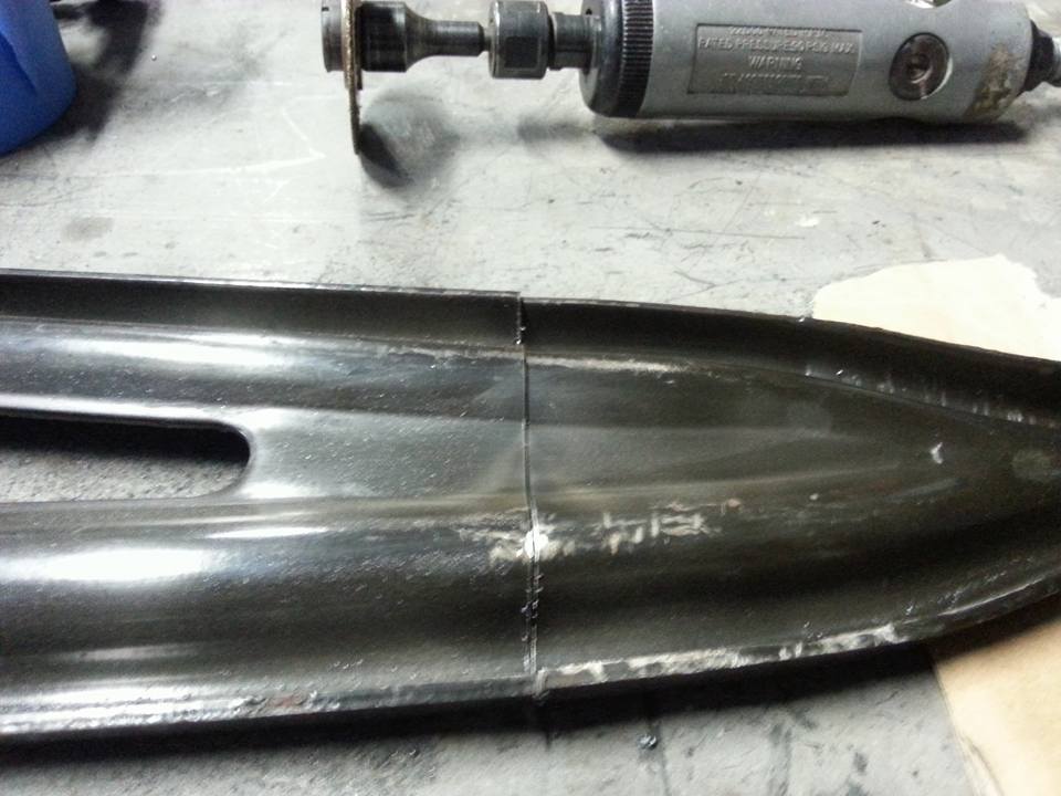

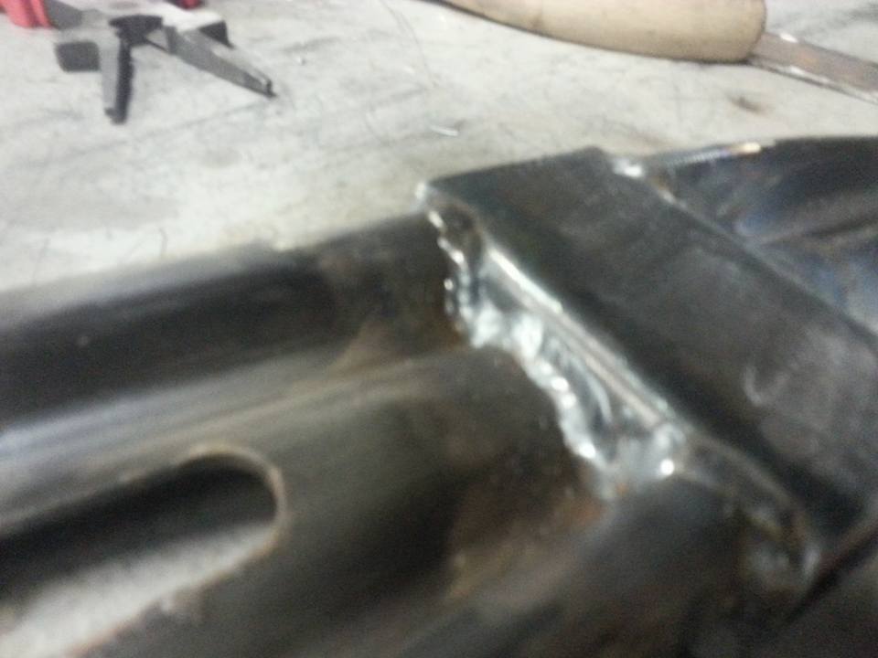

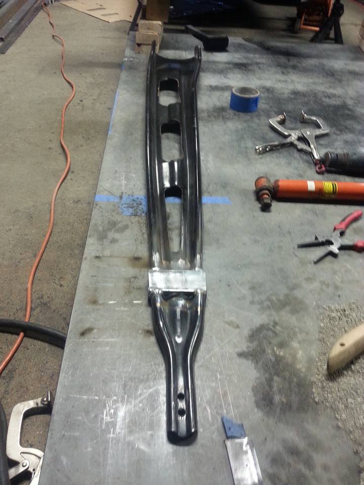

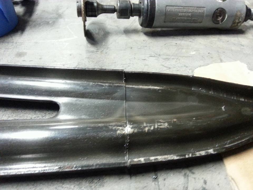

Modified/lengthened the torque arm 2" one step closer to the roller !!!!!!

Posts: 1840
Re: Beretta Z28
My '89 RS (Third Gen) Camaro came with a lot of add-on parts, including a tubular-steel torque-arm. This particular one was designed to attach to a saddle that bolts to the underside of the tranny tunnel. I think the previous owner (if that is who did the work -he was kind of an idiot) put it in wrong because the car 'clunks' every time that torque arm unloads, but overall it is a nice piece. I am sure something like it would be available for the fourth-gen cars too...
Posts: 677
Location: Charlotte, NC
Re: Beretta Z28
Post by bonecrrusher »
BMR makes a torque arm for the 4th gen - but not to the correct length that jjanke needs.

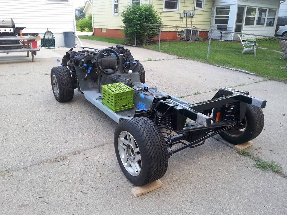

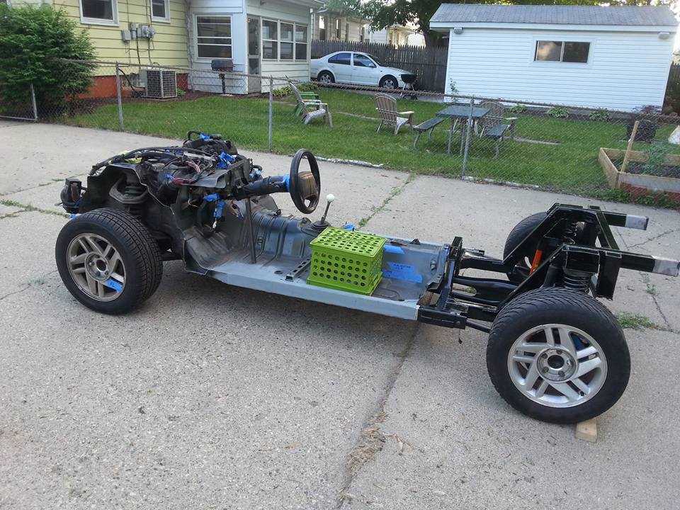

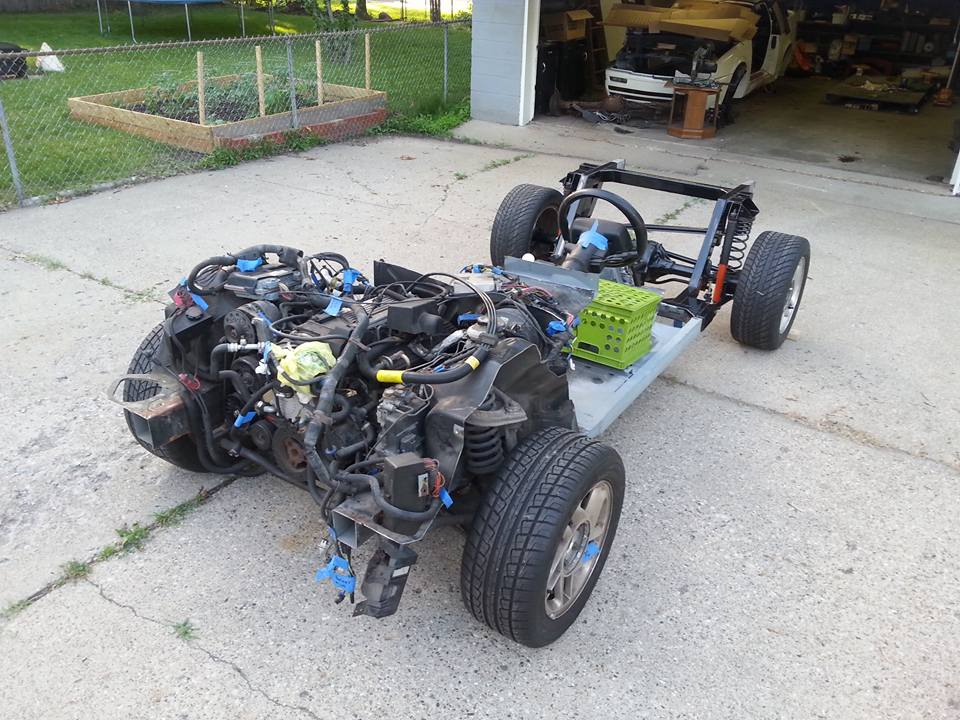

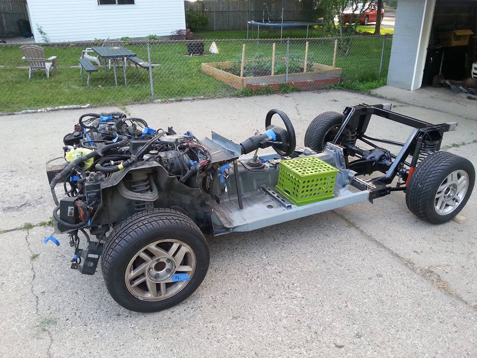

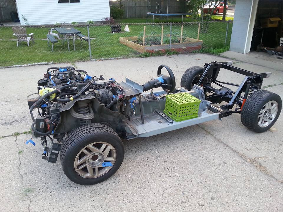

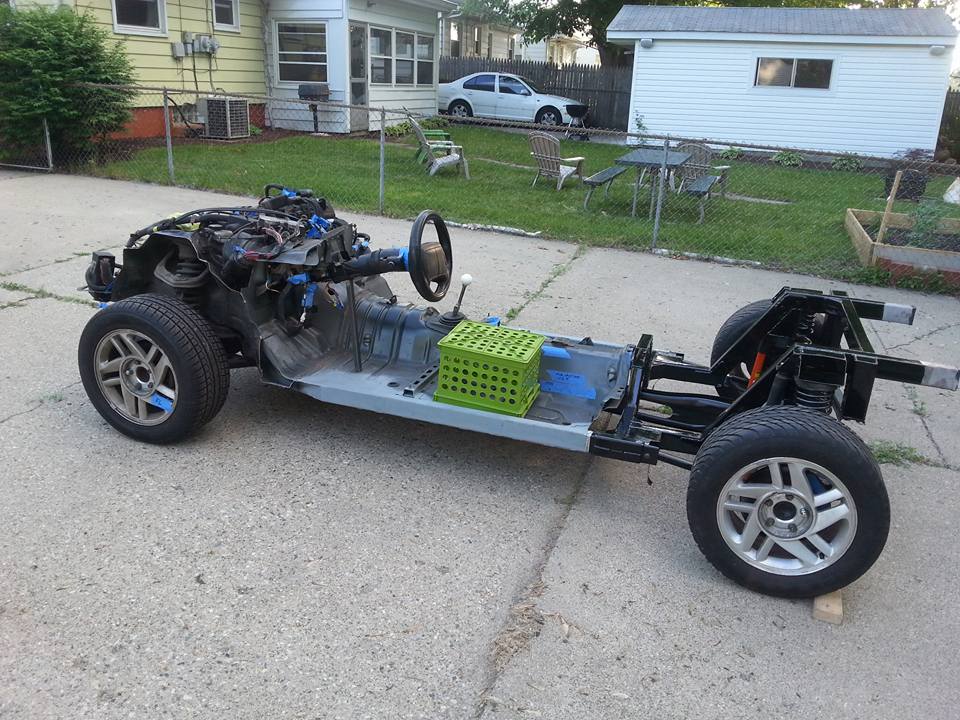

Z28 Beretta rolling chassis. Sitting on all fours complete suspension, steering, and custom racing seat!!!!
Posts: 4763
Re: Beretta Z28
Winning. haha
CorvetteBeretta
Posts: 423
Re: Beretta Z28
Post by CorvetteBeretta »
Imagine the looks on your neighbors faces if u took that for a rip around the block
Posts: 677
Re: Beretta Z28
Dat racing seat - great support in the corners - and can be used for storage!
How are the steering column and seat going to line up with the doors?
Will you be sitting in the back seat?

i really dont think it will be much further back in the interior space...... the 4th gen Camaro was a relatively cab forward (short dash to axle) rear wheel drive proportion. only one way to find out.......

i know right!!!!! Corvetteberetta ....... gonna have to settle for sitting on a milk crate and making engine sounds........ neighbors will be just as shocked

if somebody measures on their beretta from there center of front hub on rim to bottom edge of steering wheel ....or leading edge of front seat (in side view) we could get an idea if its in the ball park......not that it matters now
