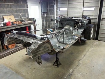

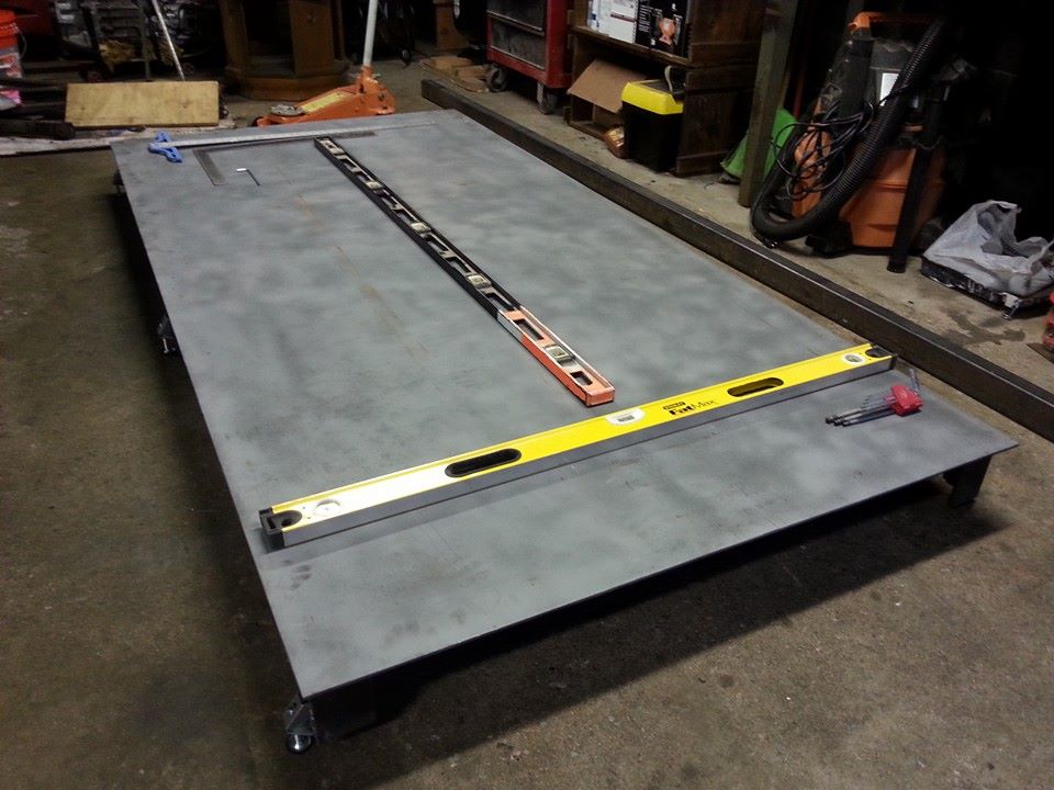

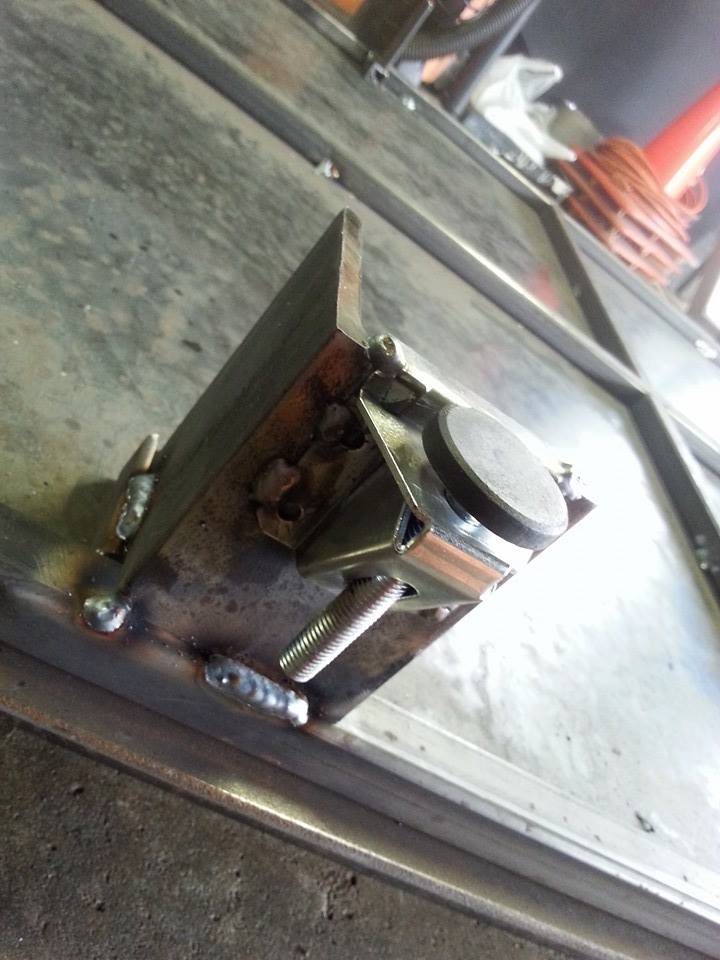

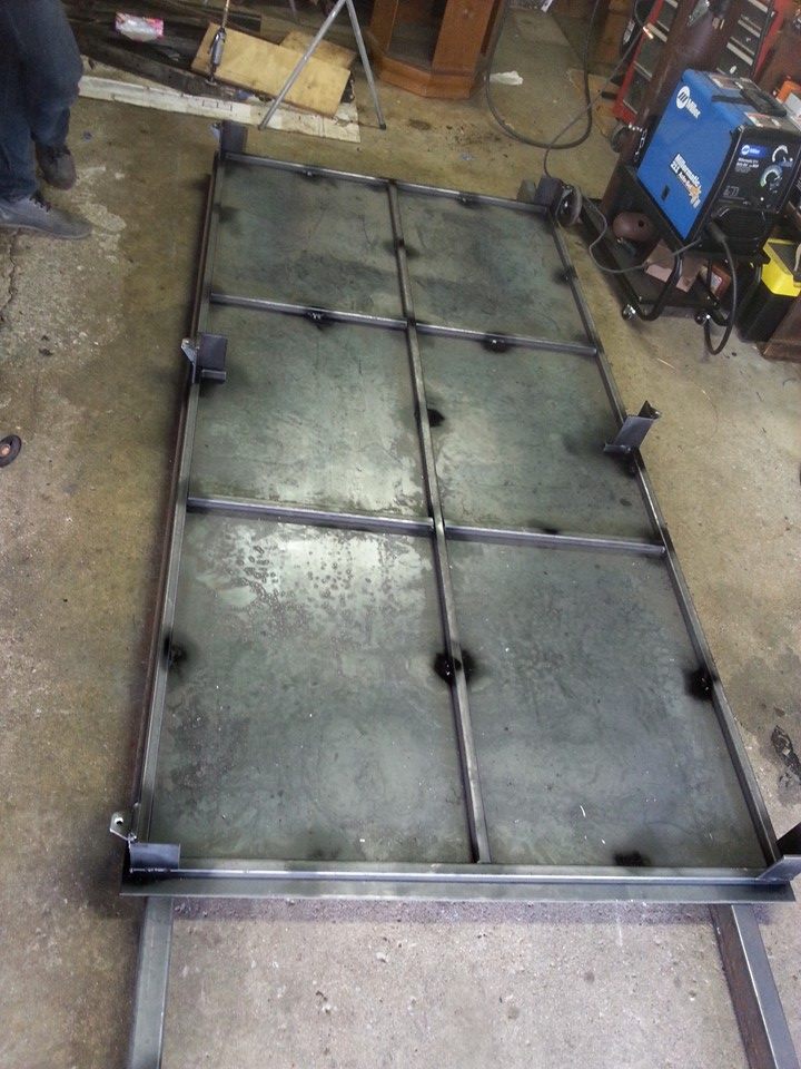

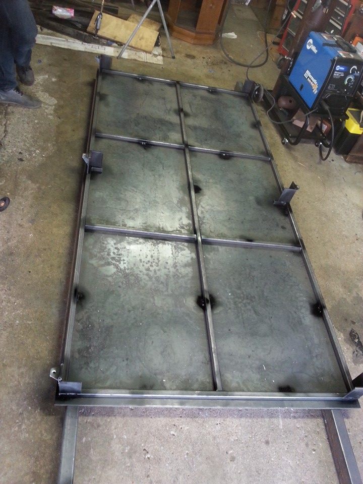

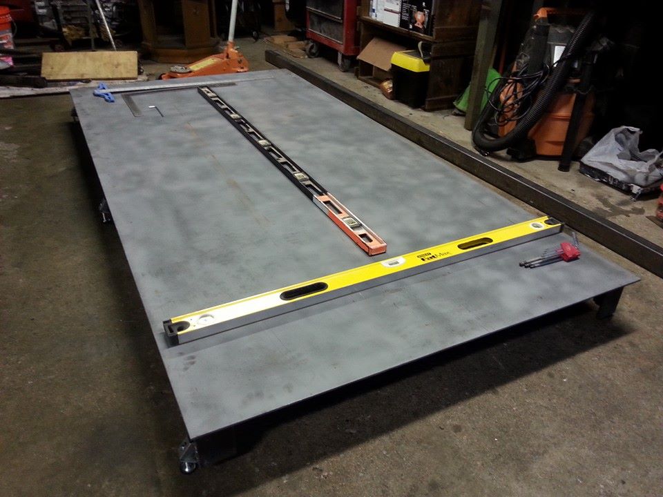

made a 4' by 8' welding table/surface plate. and made templets of the stock uni body frame rail sections from the fire wall back.

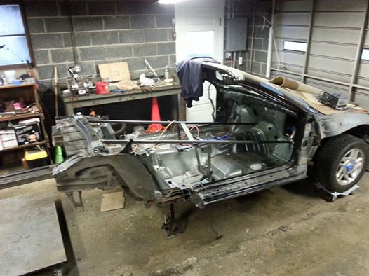

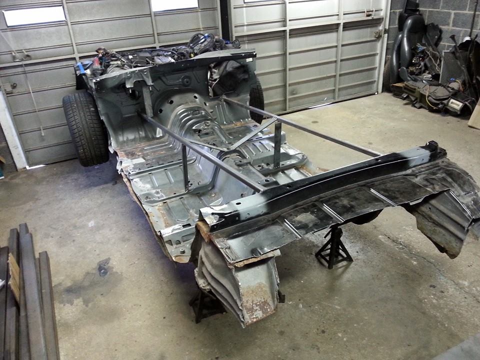

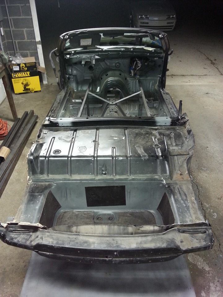

also started rough cutting off the bulk of the what will be un useable unibody sections of the camaro body. lots more to do here.

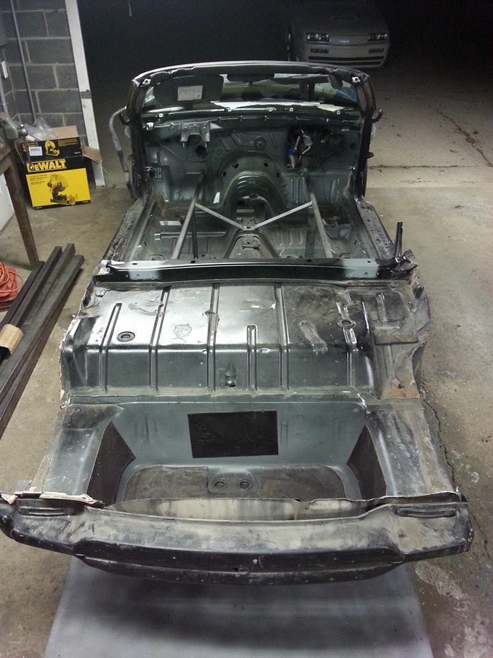

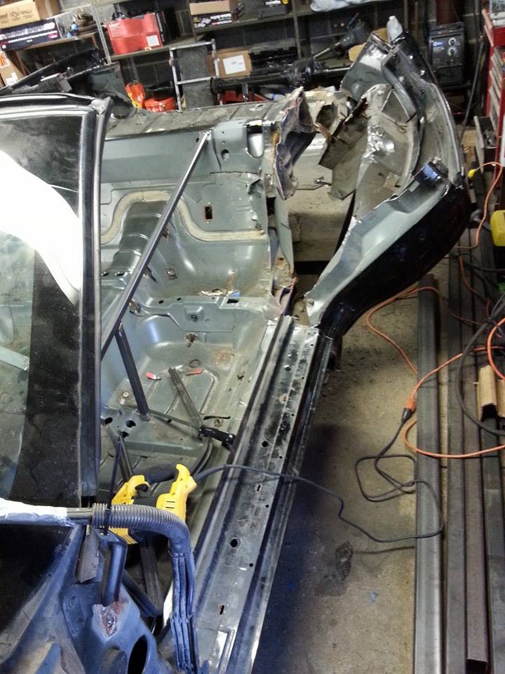

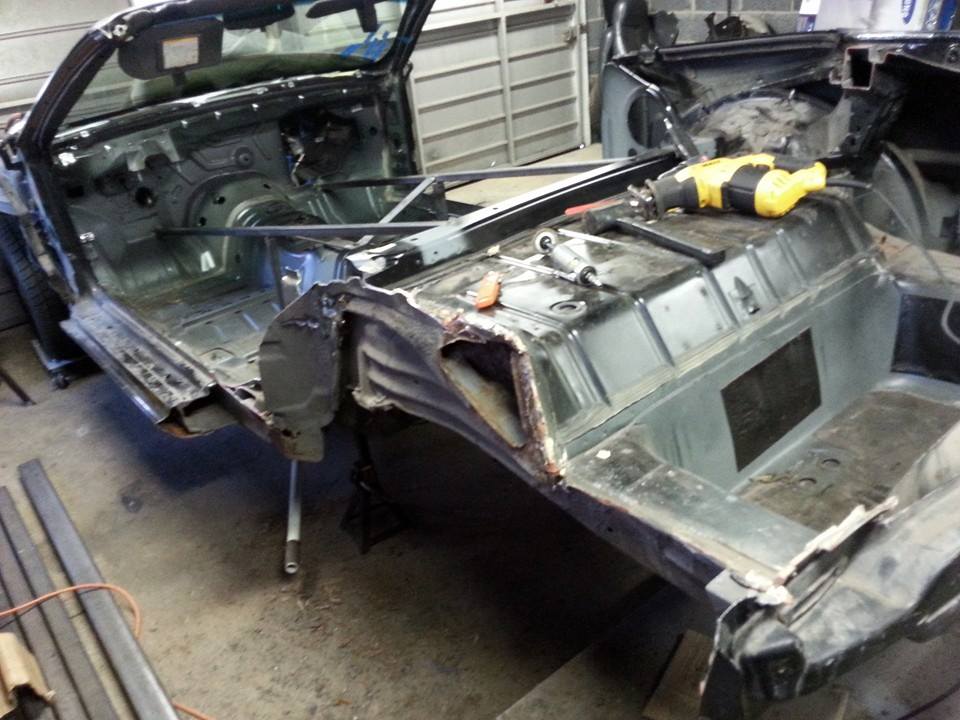

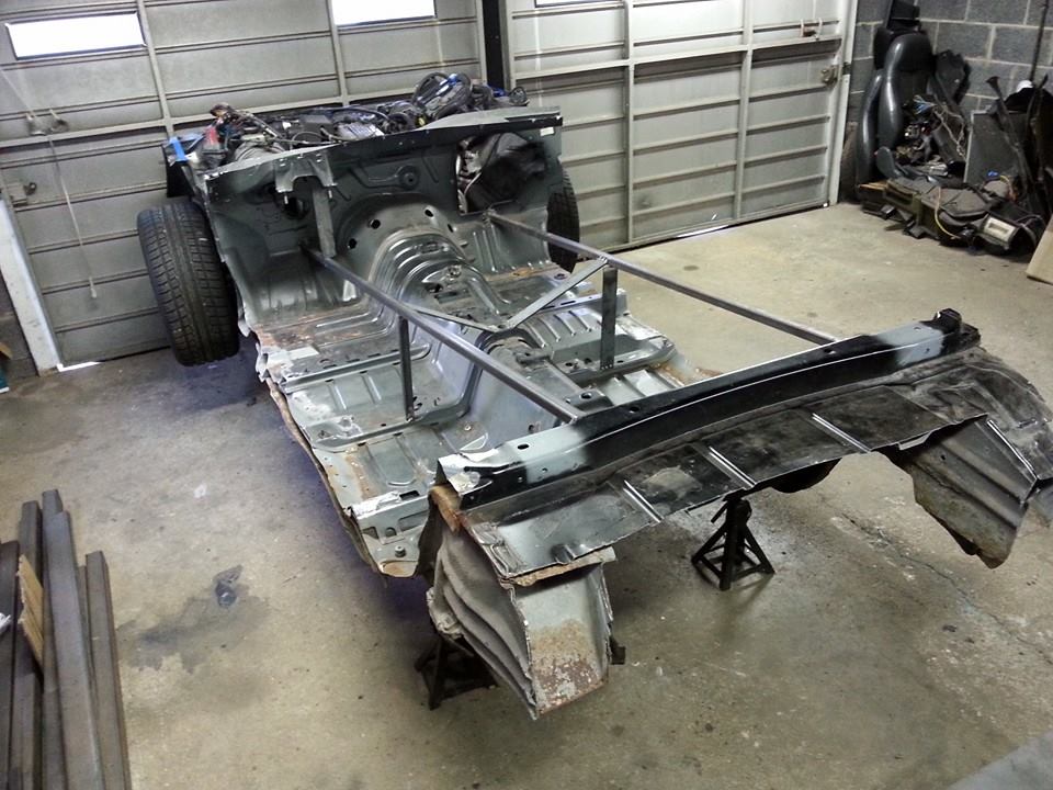

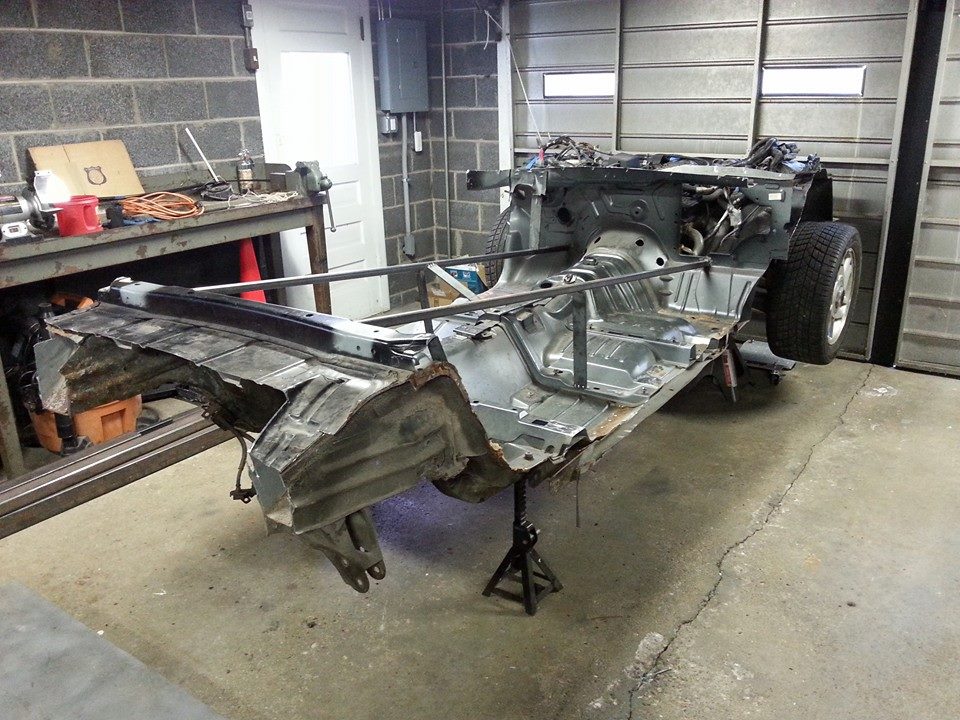

rear quarters cut off and rear frame rails cut off behind springs and panhard bar mount.

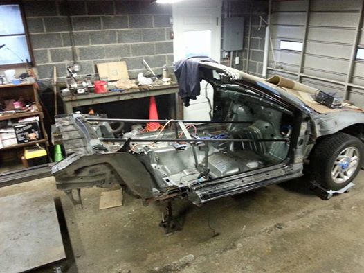

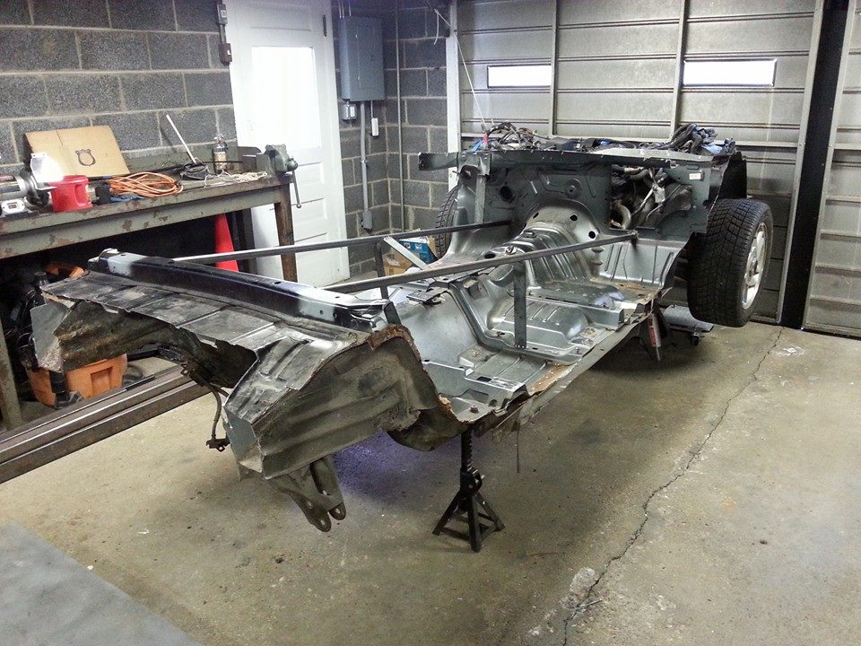

all rough cutting done....time to start construction on the rear sub frame / tube chassis........ mini tubs shouldn't be necessary. there wont really be any rear wheel wells.....or trunk floor for that matter........ so u can almost go as wide as the trailing arms will allow......but i will most likely be sticking with the stock z28 wheels to stay true to theme....more to come!!!!!!!!
