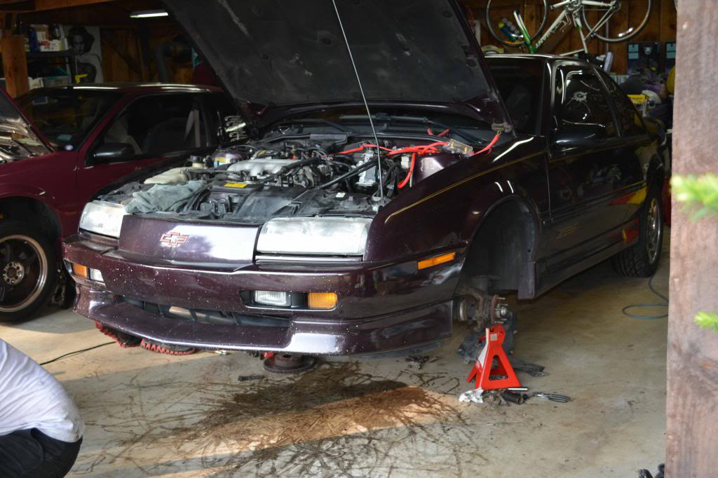

Well, everything went good... Kyle and his paparazzi Ryan (Ryan took most of the photos this weekend, he stayed rather clean... LOL) showed up at around 8ish on Friday they grabbed something to eat and we ended up crashing at around 10... Up early at 8am to get started...
Started with just getting the old sucker out... Kyle and Ryan worked on that while I buttoned up his new trans.
Had the trans out by around noon time and stopped for lunch.

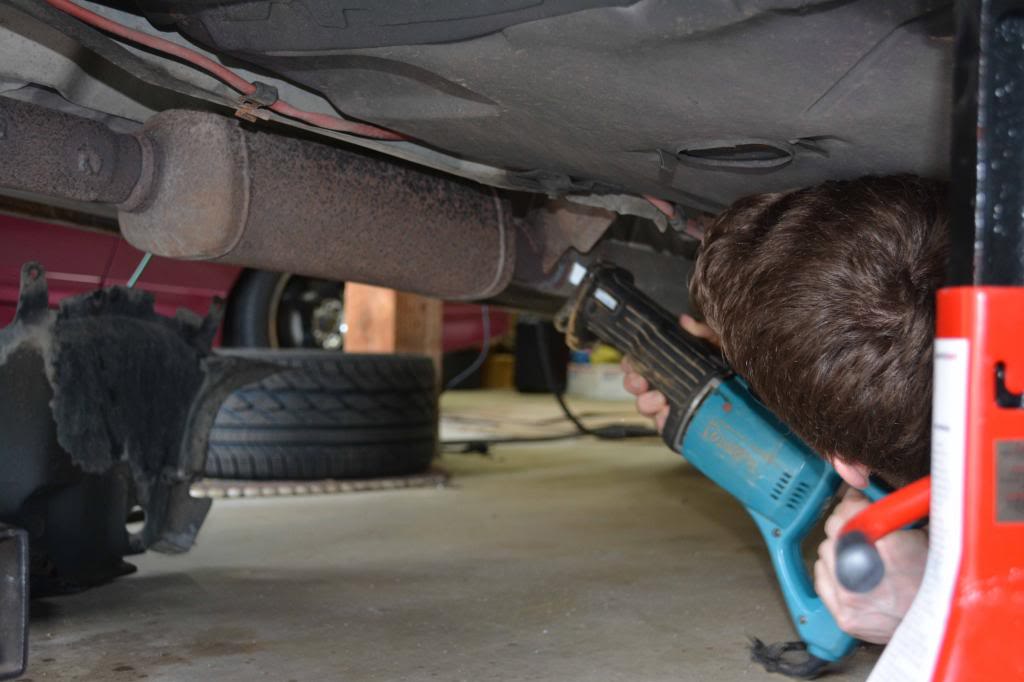

After lunch we headed to Advance for a filter kit, fluid, Oil pressure sending unit and new threaded coolant pipe adapter for the heater core... Found that leaking when taking the trans out. Also stopped at my parents house to pick up my fathers saws-all to get his old down pipe off his exhaust.

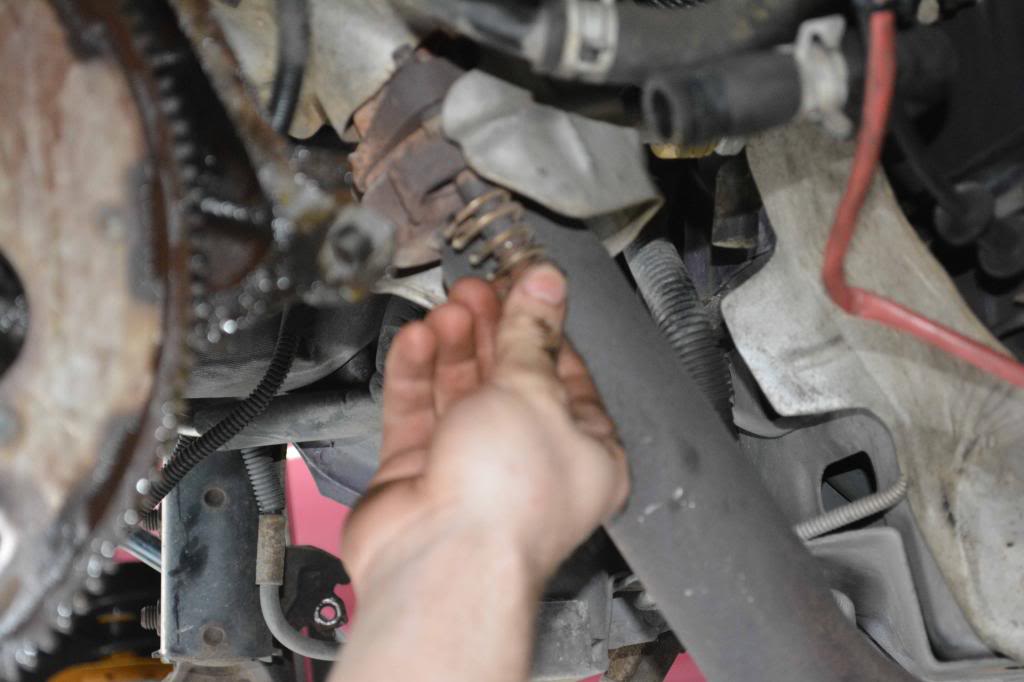

After a few issues with the new trans, the parking engagement rod being busted we got the whole thing in around 6ish, all buttoned up and sub frames in and ready to go... Just had to build a down pipe from there.

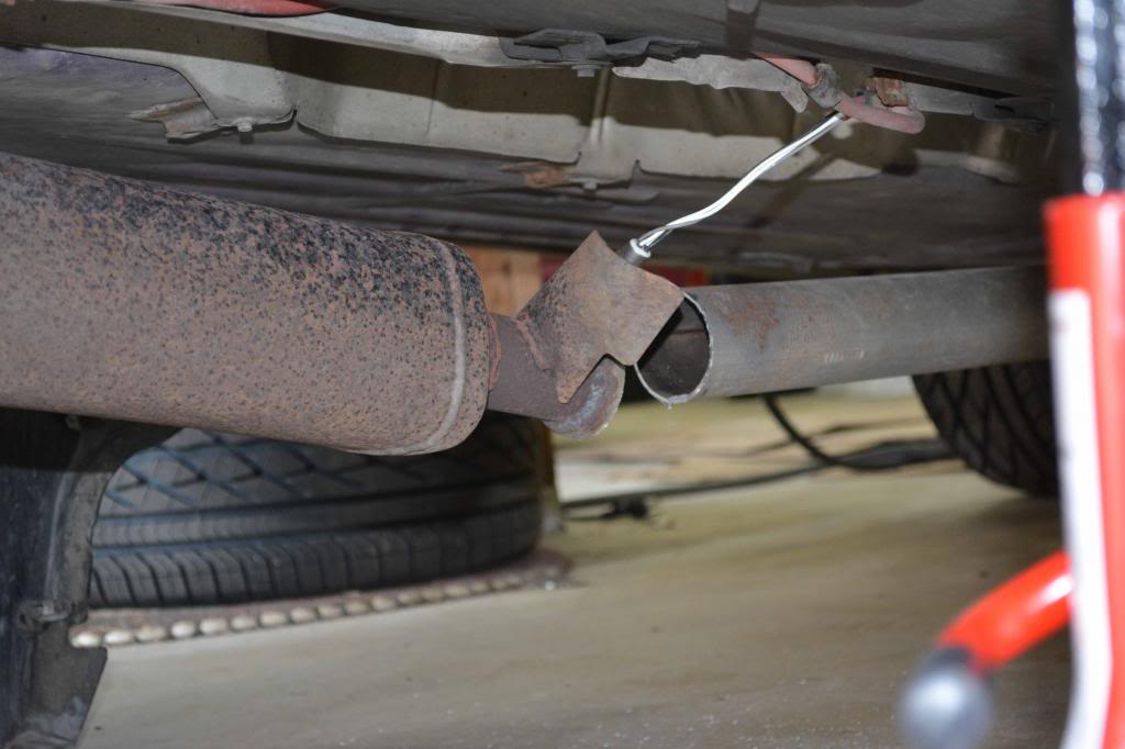

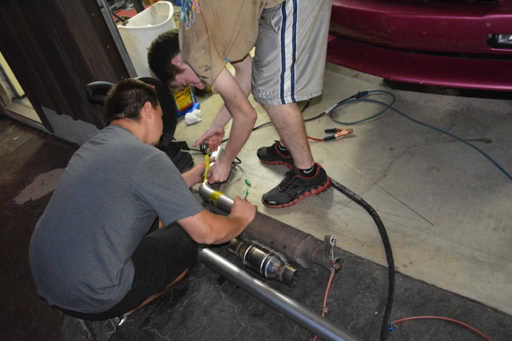

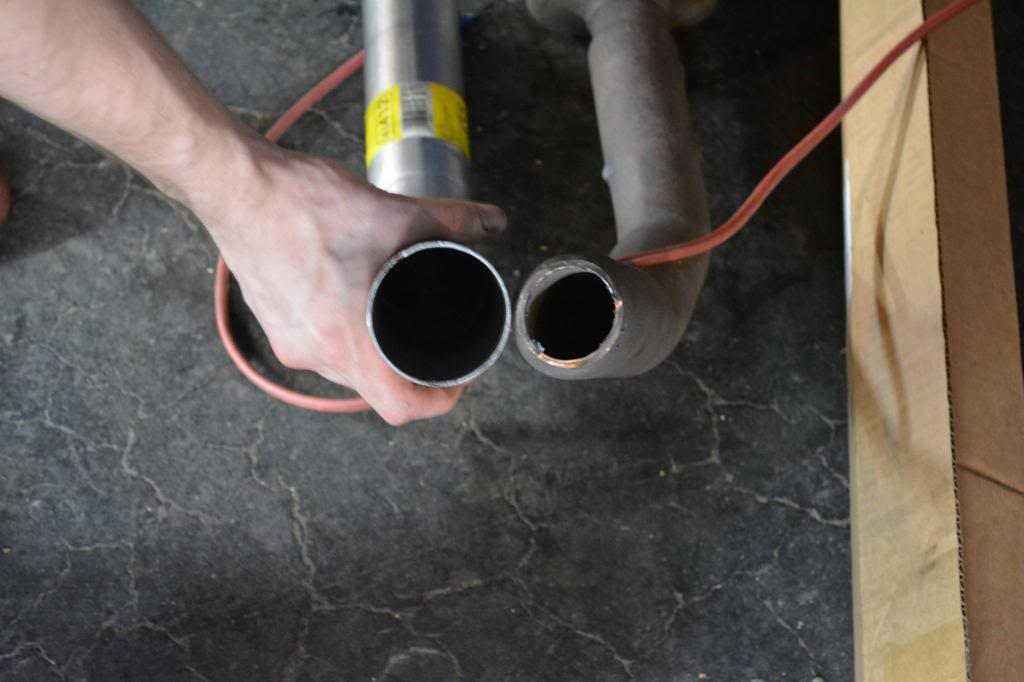

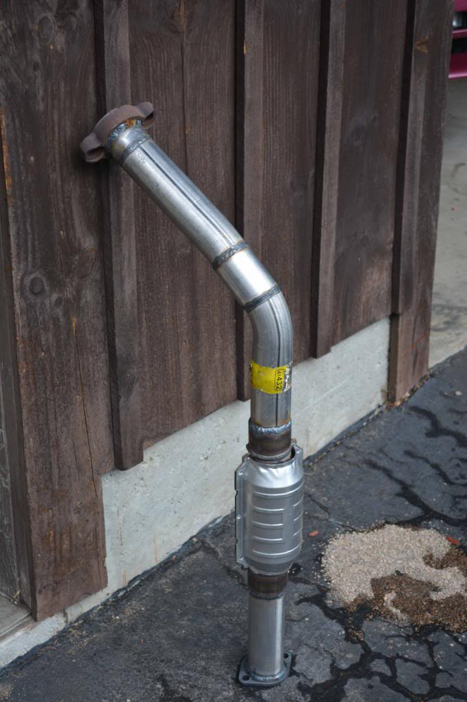

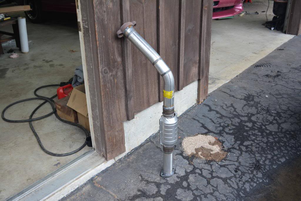

After Dinner we started on the pipe... I used a straight section and a 90* mandrel bend to replicate the 3100 down-pipe from 2 1/2 pipe. Welded it direct to the stock flange, That is apparently cast so that was fun to do...

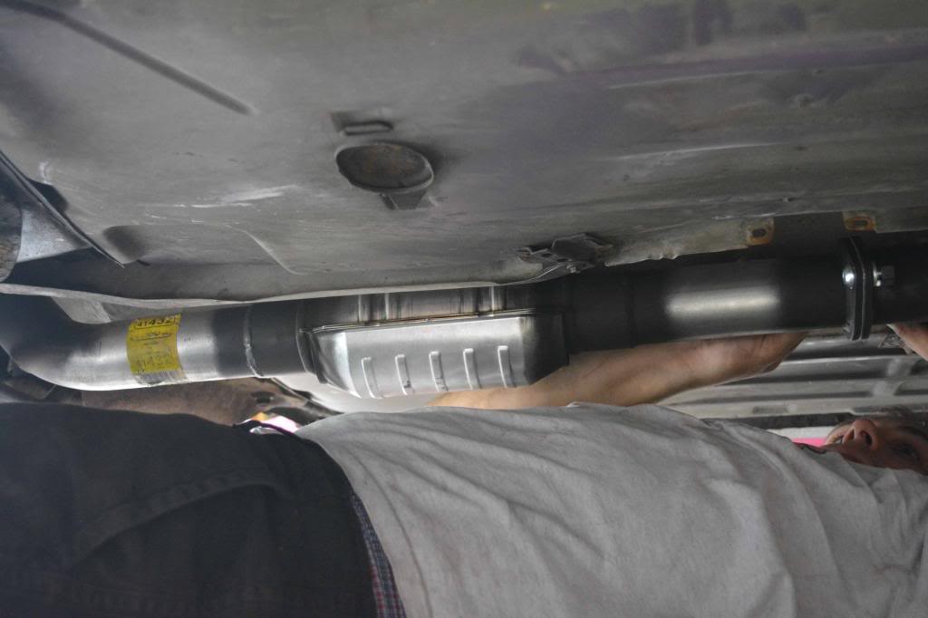

In the end came out pretty good, slapped on his new dynomax cat (Nice cat I may get one for myself for $60) Put a 2 bolt flange where they had just welded the rear section to the down pipe and bolted it all up... Everything is nicely Tig welded

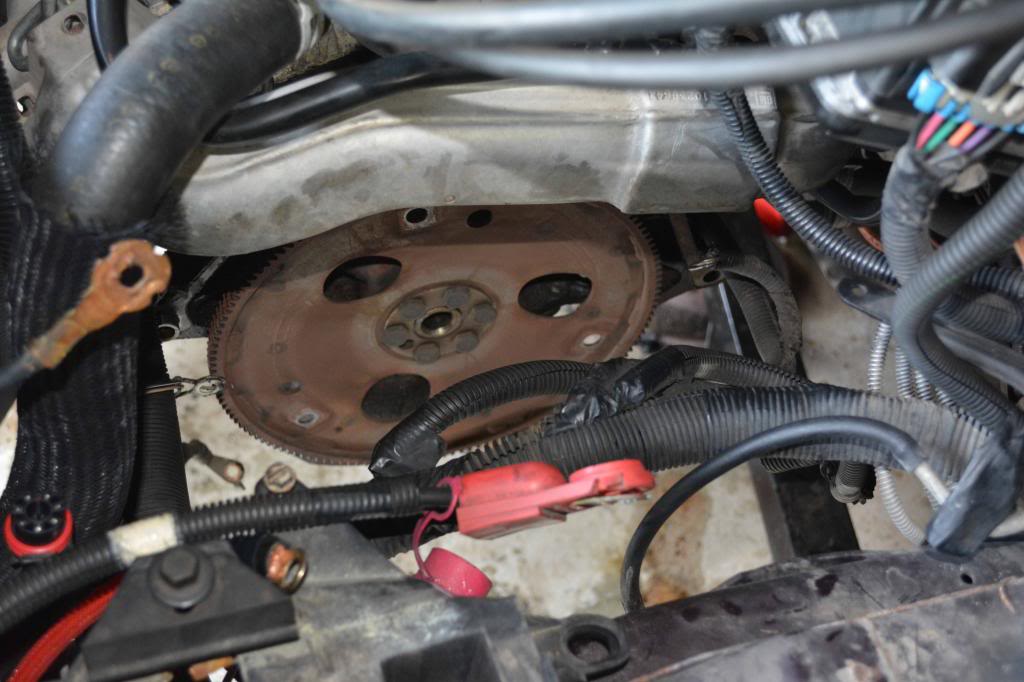

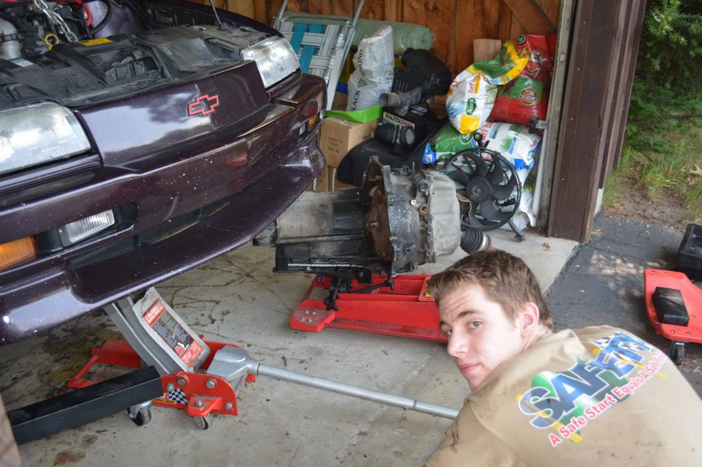

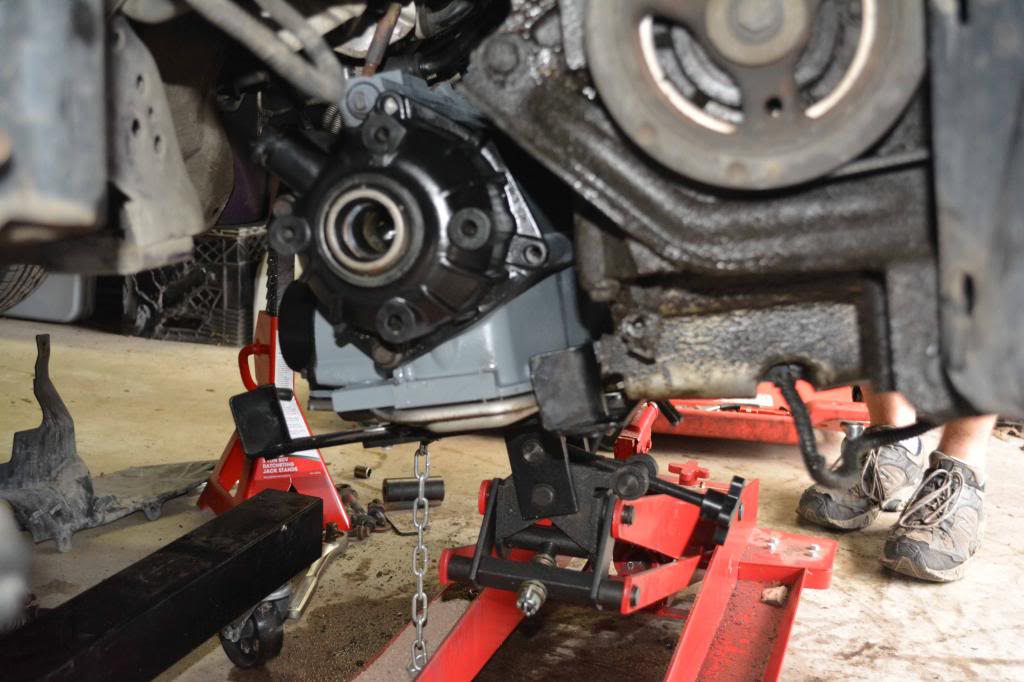

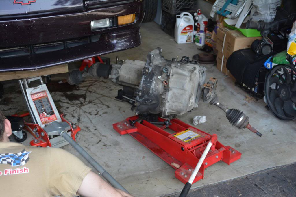

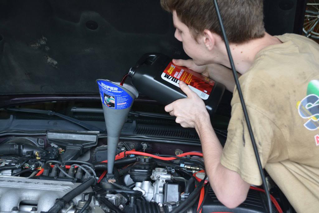

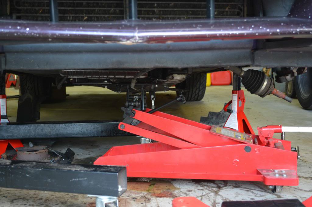

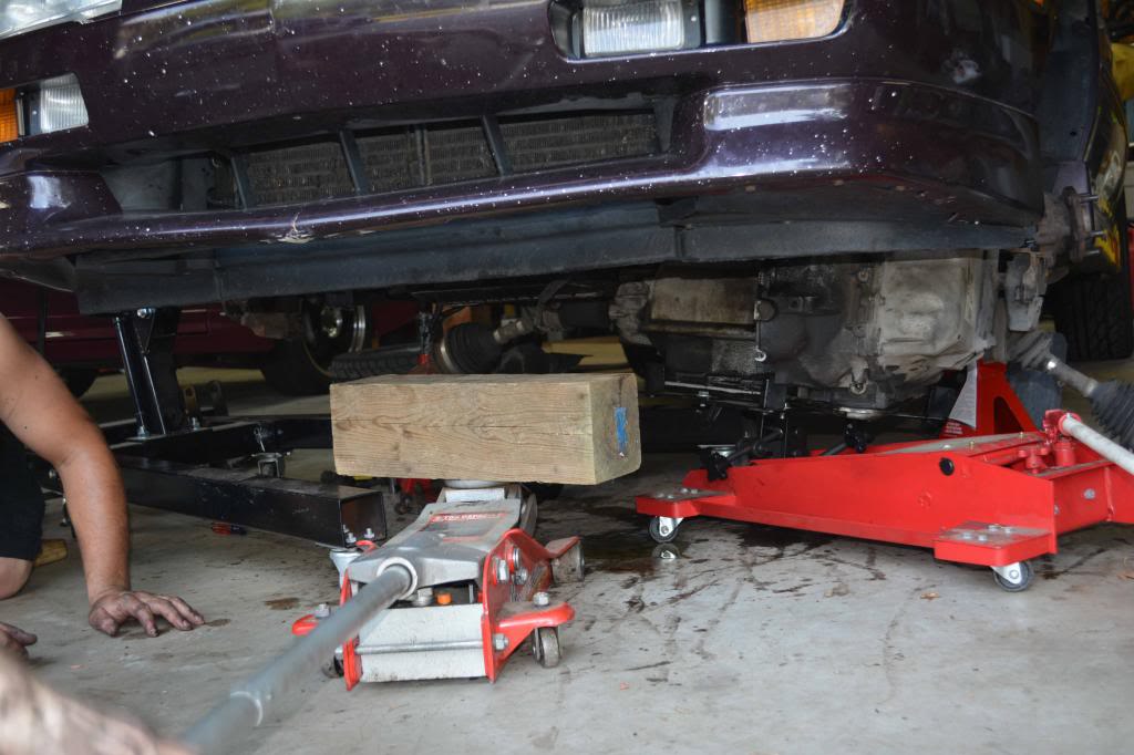

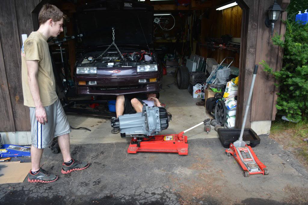

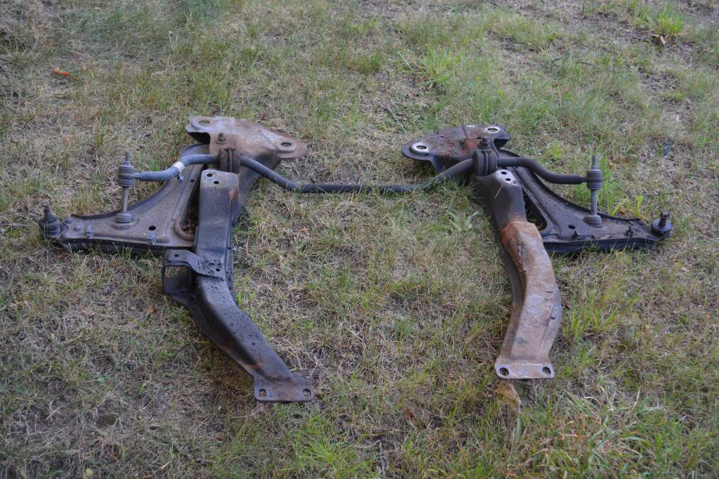

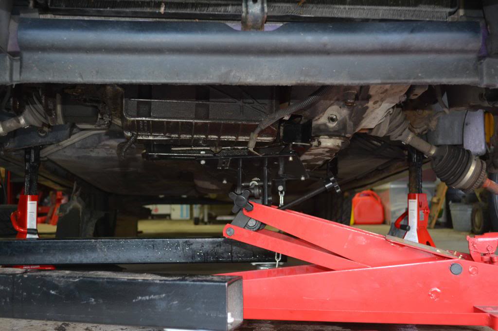

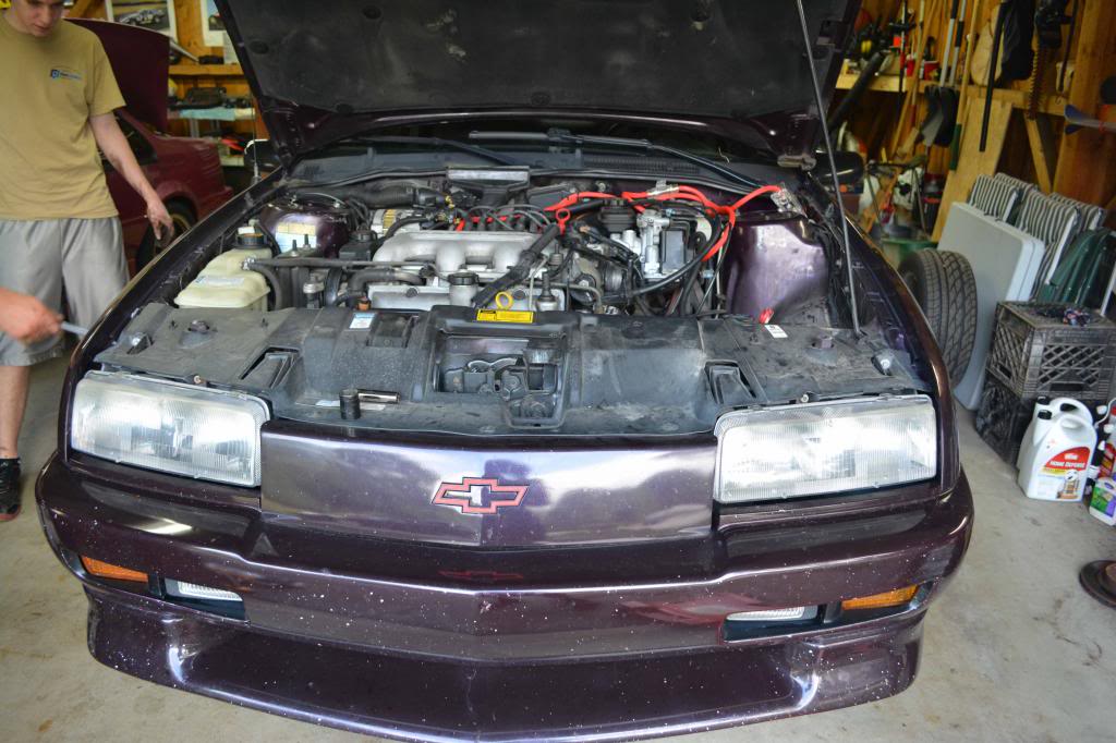

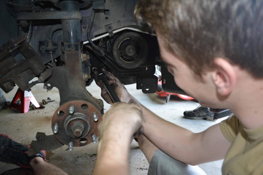

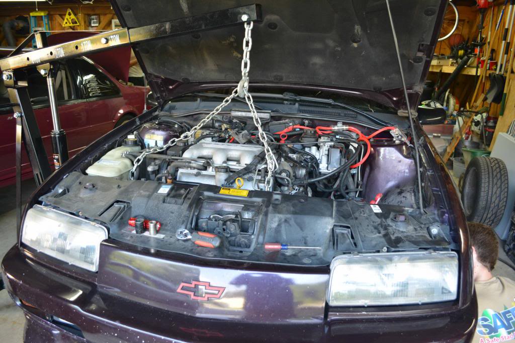

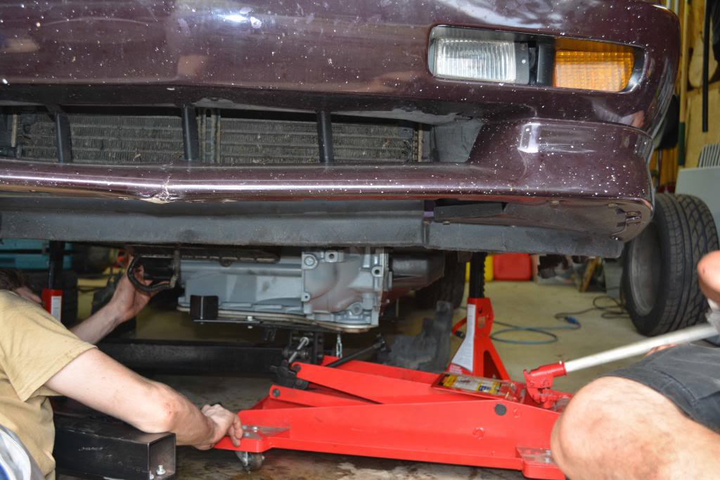

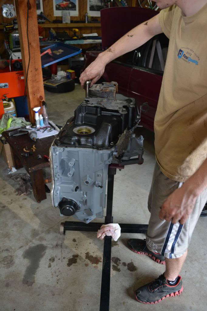

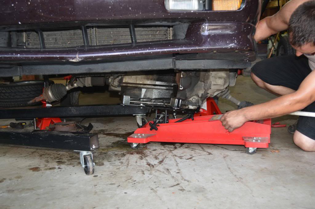

Ok Kyles pics now...

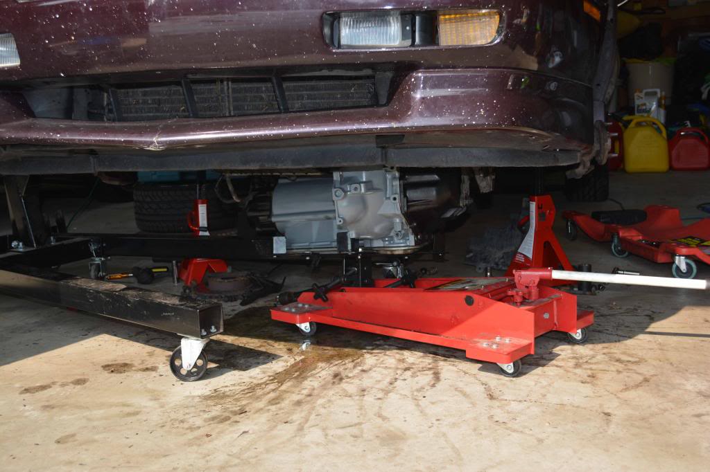

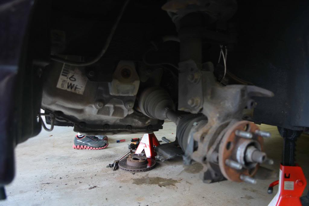

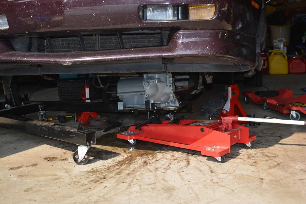

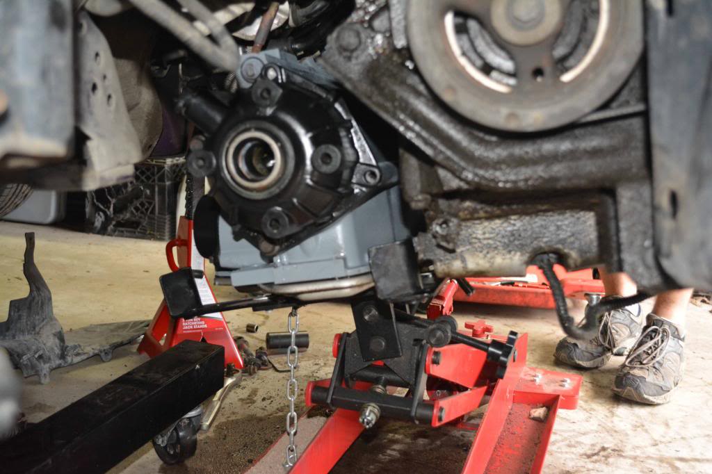

Subframes out!

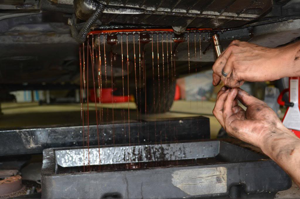

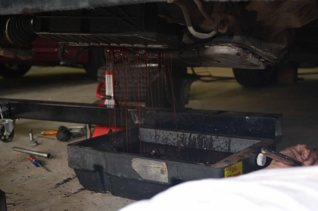

Just the start of it all.... Draining the old sucker
Gotta love the right tool for the job.

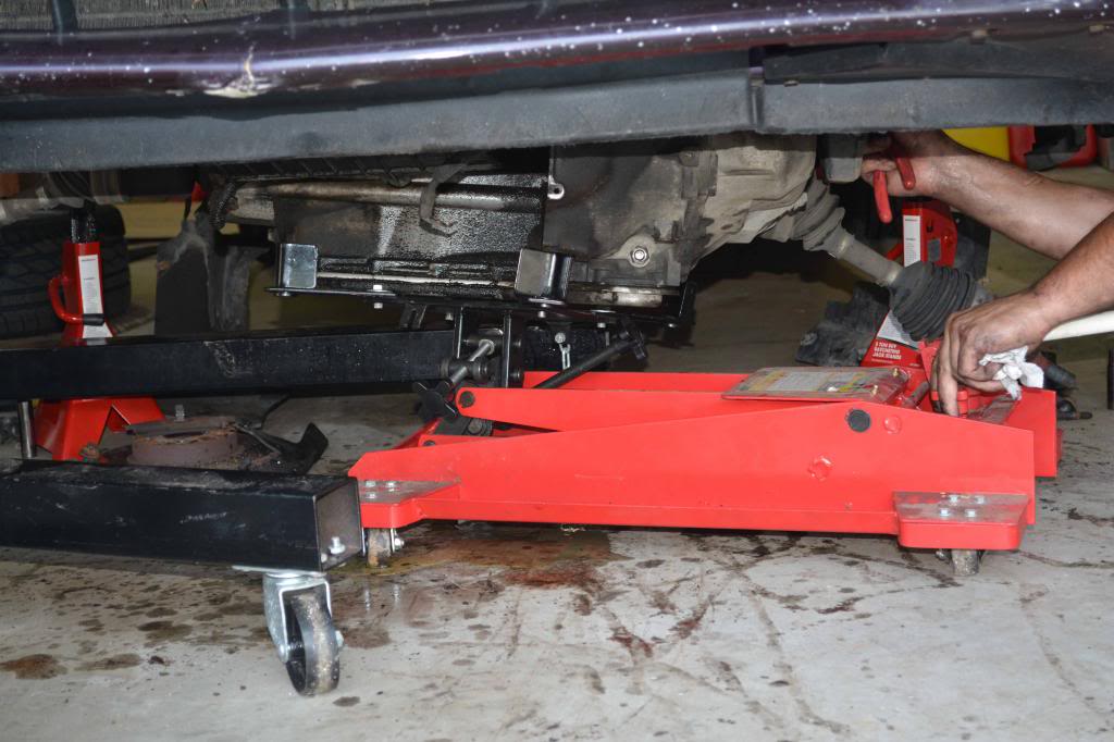

Car wasn't high enough of course...

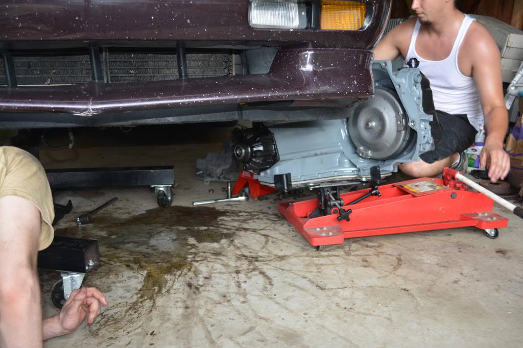

OUT!
All without removing the exhaust cross over... WAY easier to deal with not having to take that ou.
Downpipe time...
Subframes out!
OUT!
Downpipe time...

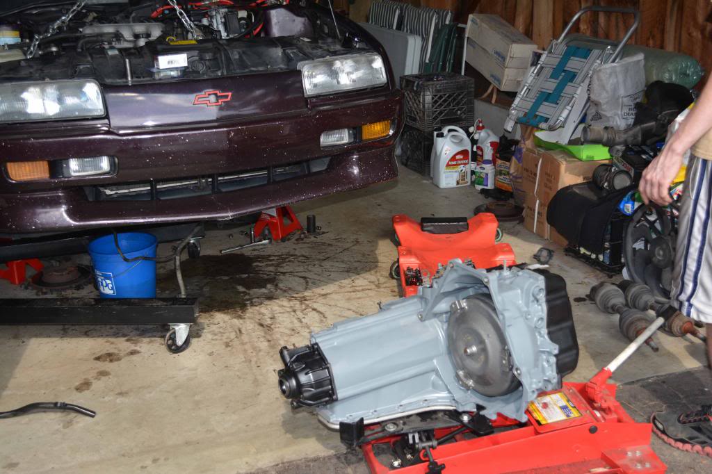

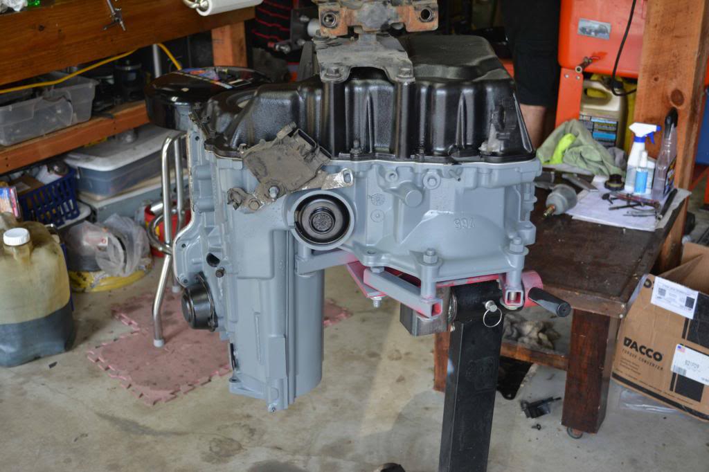

Kyle working on his new trans.
After a few hiccups of the parking engagement rod being bad we are ready to go in...

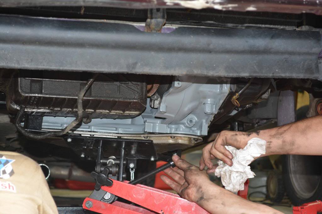

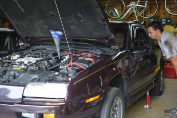

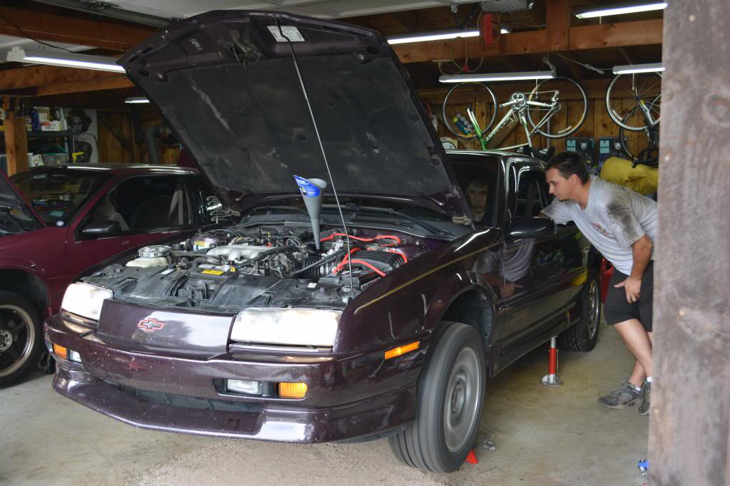

IN!
All buttoned up and soaking up the mess we made.

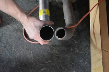

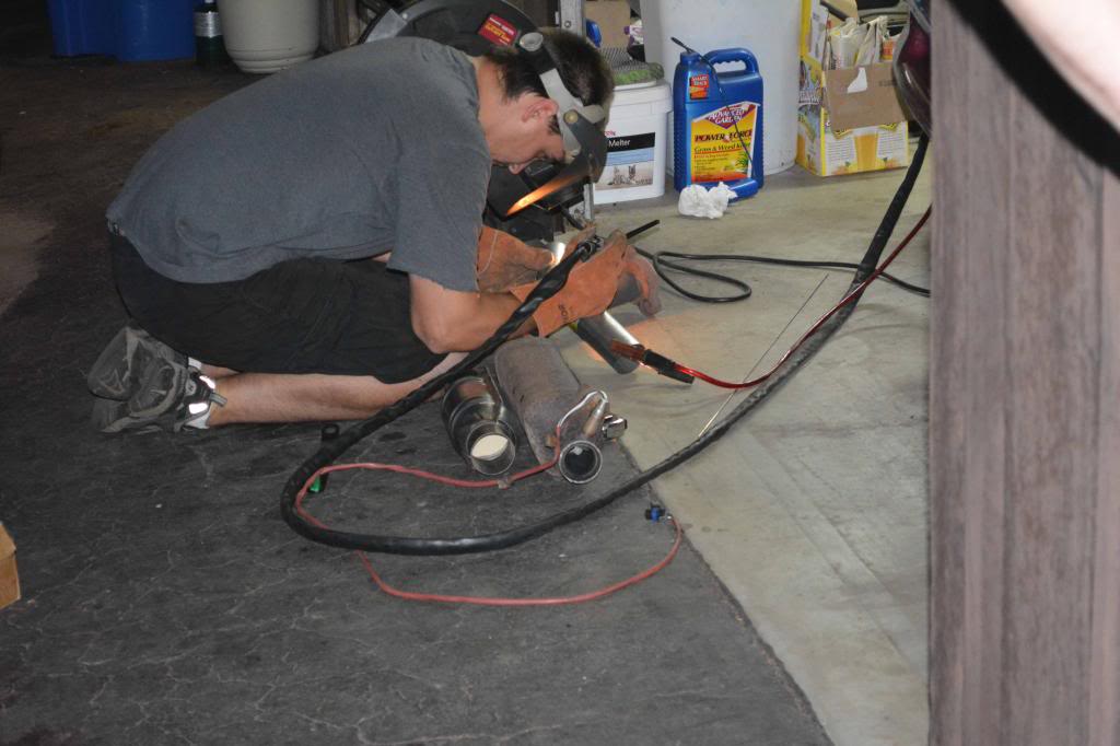

Measuring the downpipe... Yes I need a metal bench to work on... My other bench was COVERED in crap and stuff from Pink car so to the ground I was banished.. LOL

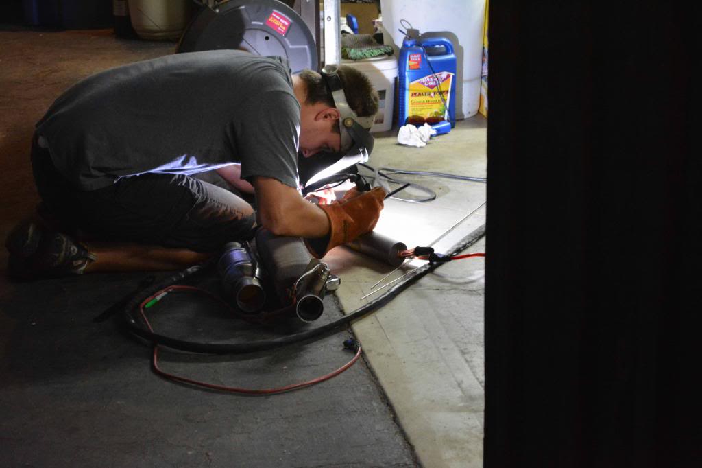

TIG away!
Difference
Next day, After about 2hrs of mind numbing tig welding...

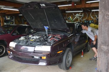

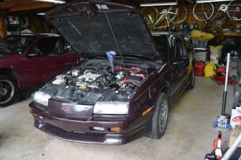

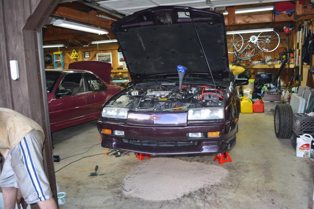

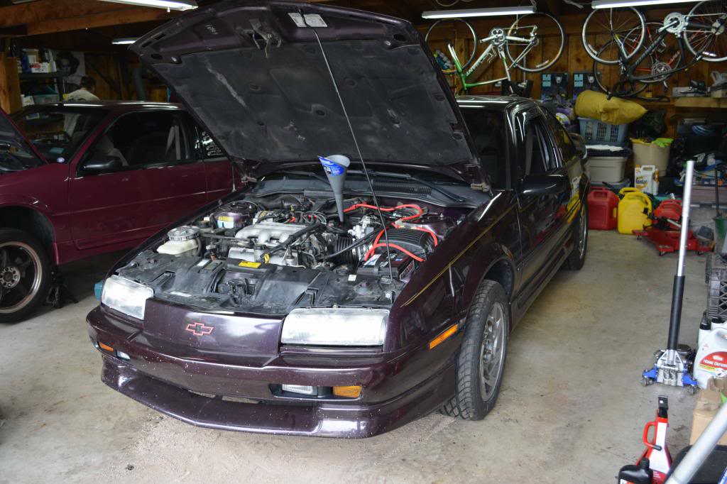

Fill her up!
Installing the downpipe.

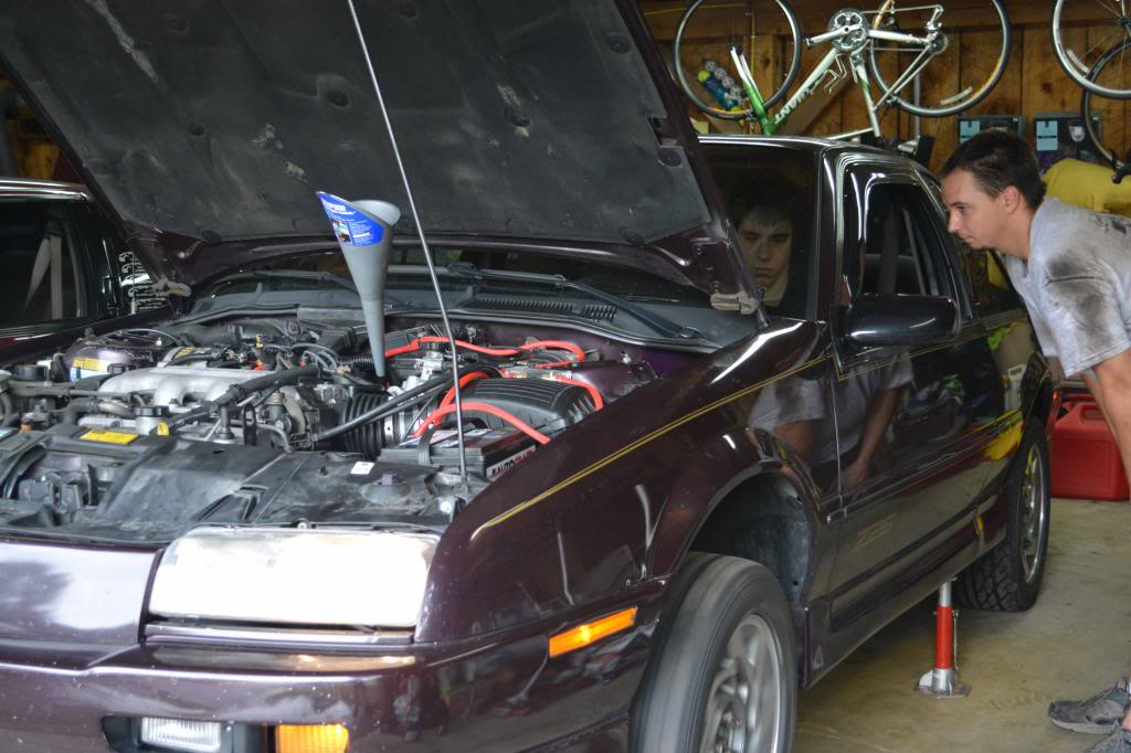

Testing the shifting before dropping it and checking for leaks...
Ready for the test ride!

IN!

Freaked me out there 3X00, I will never put a car in gear on jackstands. The photos were great and that was a nice way to do it.

I had the same thoughts, although I'm actually nuts enough to do it too. An old co-worker of mine was having problems with his Porsche 944 a couple of years ago, wheel bearings, or CVs, or transaxle hub bearings chattering, he couldn't tell. He flat out refused to lift the car up and drive the wheels in the air for fear of the car coming down (which honestly, it isn't that unsafe or I wouldn't be getting underneath these cars in the first place...Money pit Beretta wrote:Freaked me out there 3X00, I will never put a car in gear on jackstands. The photos were great and that was a nice way to do it.
