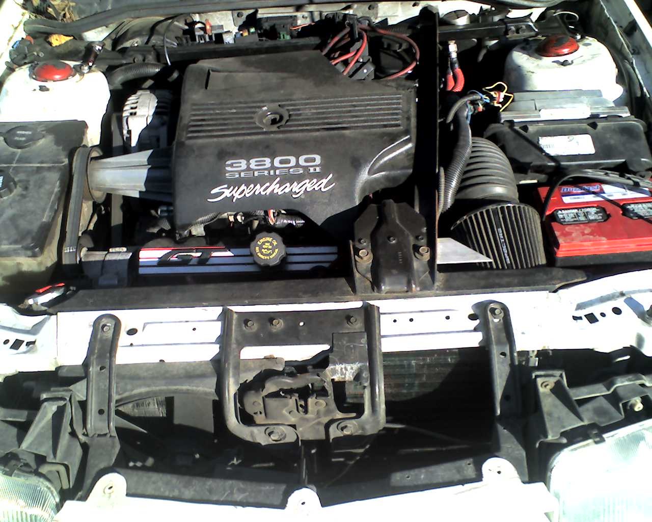

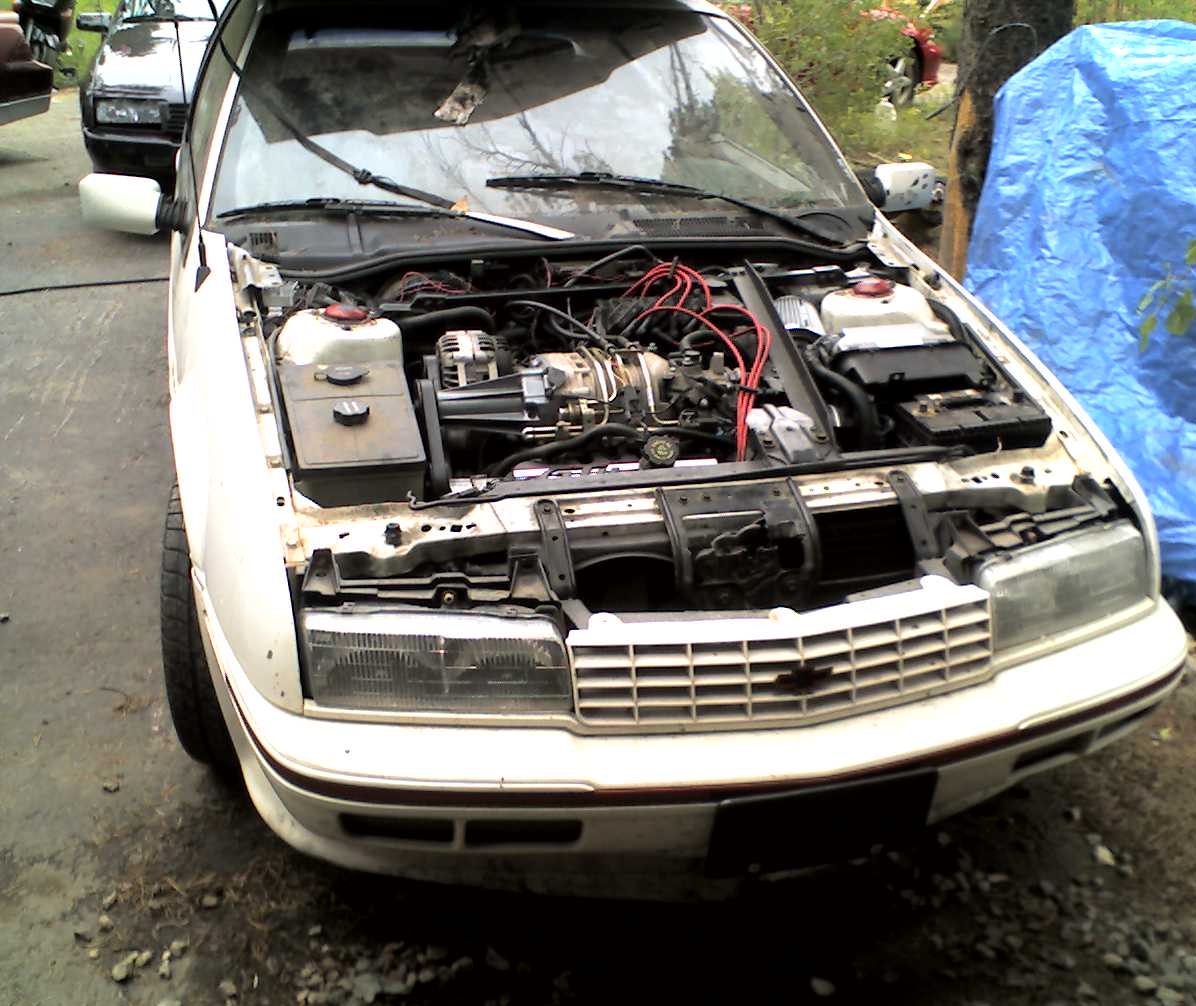

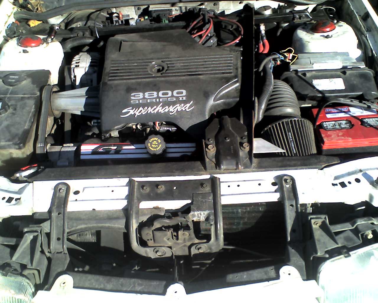

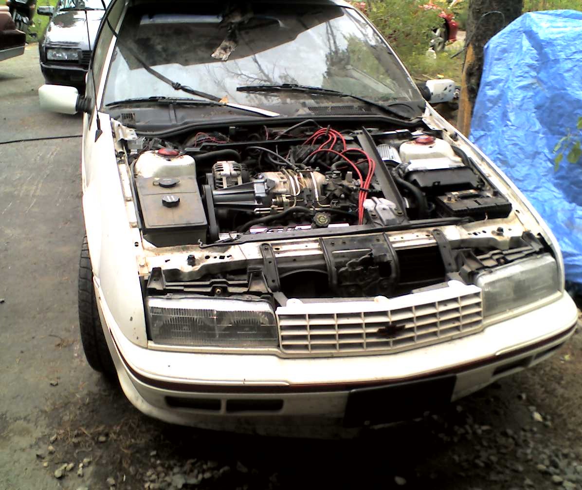

This was back when I was just finishing up the swap.  I ended up moving the air-cleaner to the front, instead of behind the TB.  Now that I can start playing around with the PCM, I will probably get back to using the 76mm N* TB I had set up for the car, which will mean some porting work at the opening to the M90 (Super Charger).

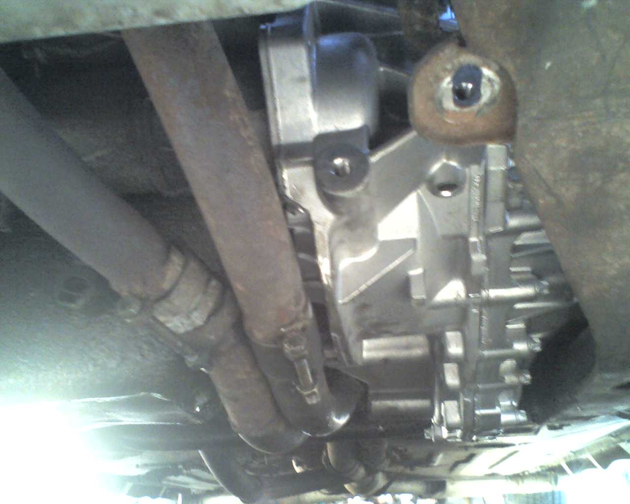

The 'slightly' modified F40 six-speed trans, showing-up the rusty headers with its' bright-shiny newness... :(

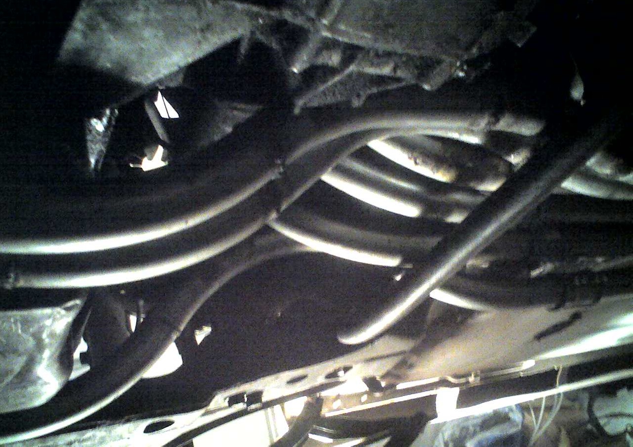

This is how they used to look.  The intent was to run all six headers all the way to the outlets in front of the rear wheels, each with its' own muffler, and a dynamic damper setup in the outlet to regulate back-pressure.  I couldn't get the car quiet enough though, so it hasn't happened.  I am running a true dual 2" mandrel-bent exhaust now, with five mufflers underneath the car, and she is still too loud <shrug>.
