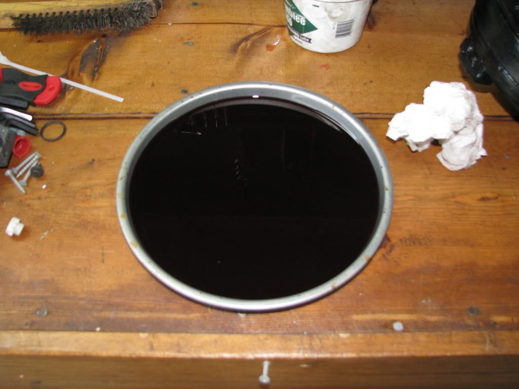

This is what I saw when I was draining the torque converter.
HOLY BLACK FLUID. It looked red when pouring but once concentrated it black as night. This is when I thought, Oh TQ fucked.... but nope....

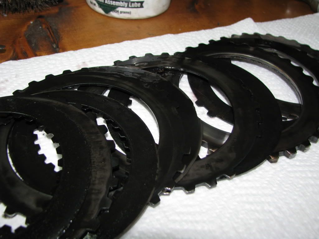

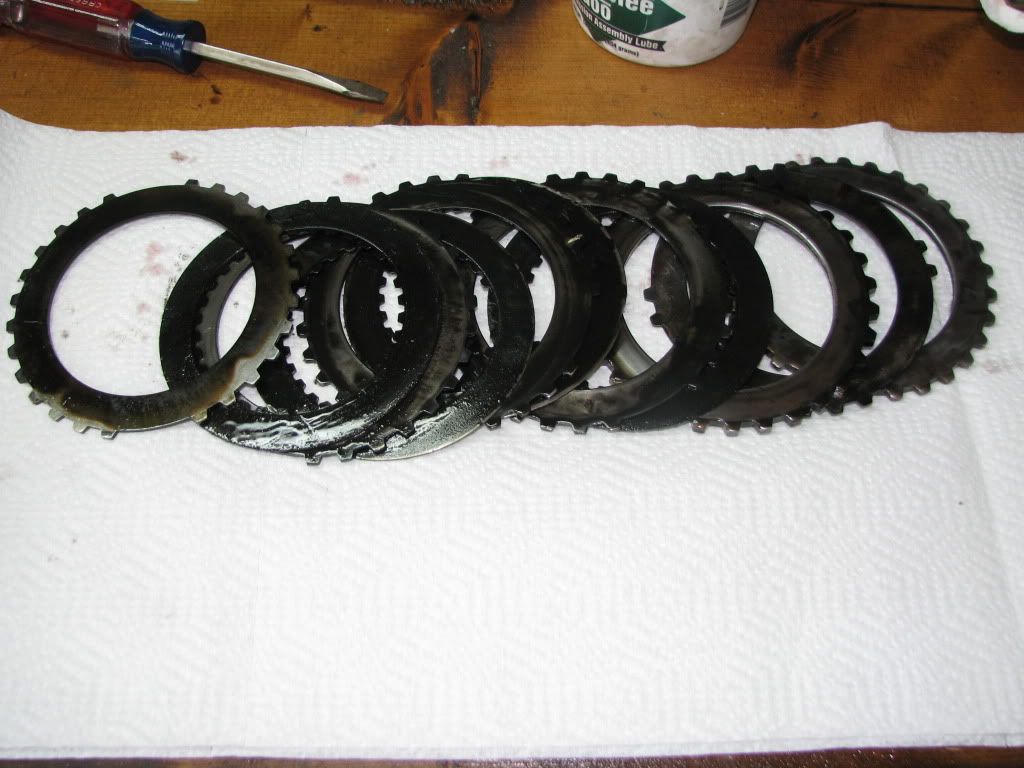

I dig deeper and I found this. BTW The clutches are supposed to be Red...
Only after showing Amy what happened I then realized why. I used a WIDE c-clip to hold in the 3rd clutches, and a thin one to hold in the input ones. SO when the piston applied it wedged itself up and got stuck on the wide c-clip... There was no room for it, so then once applied the input clutches never released and burnt to hell.
