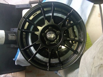

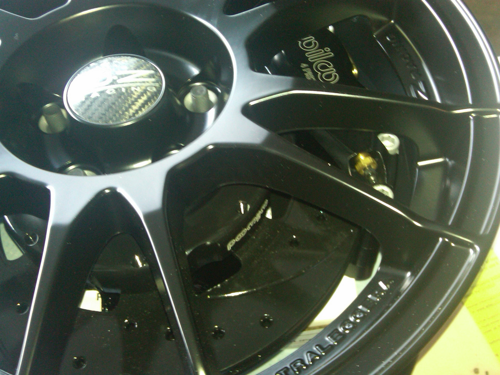

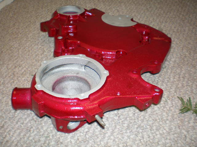

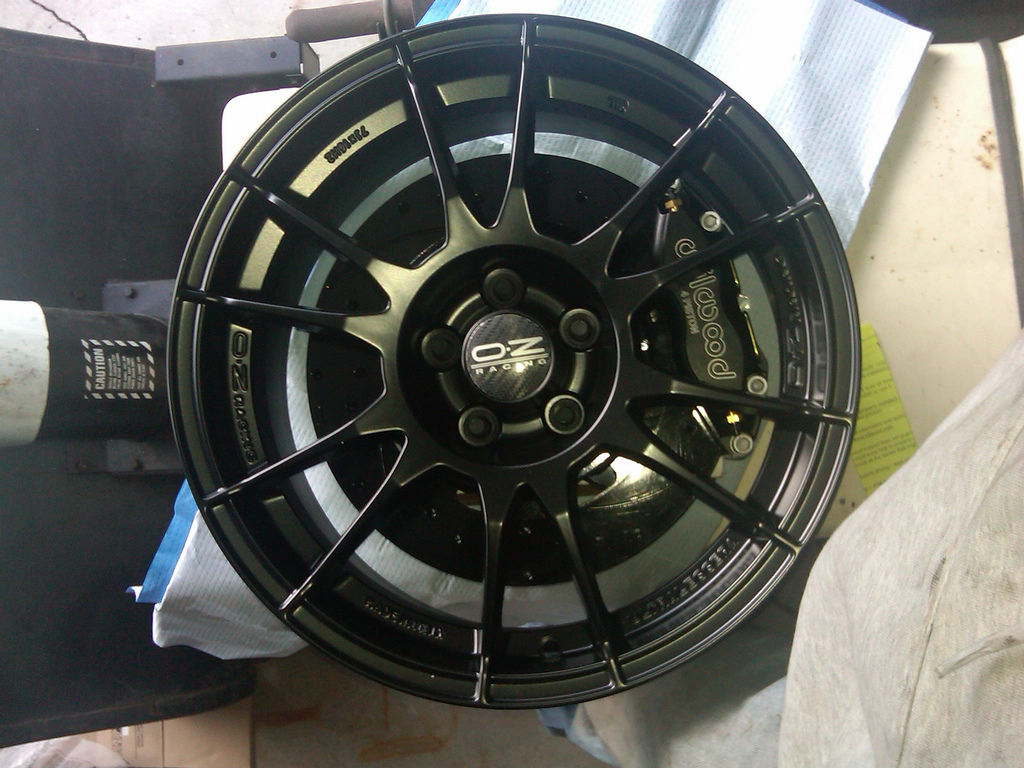

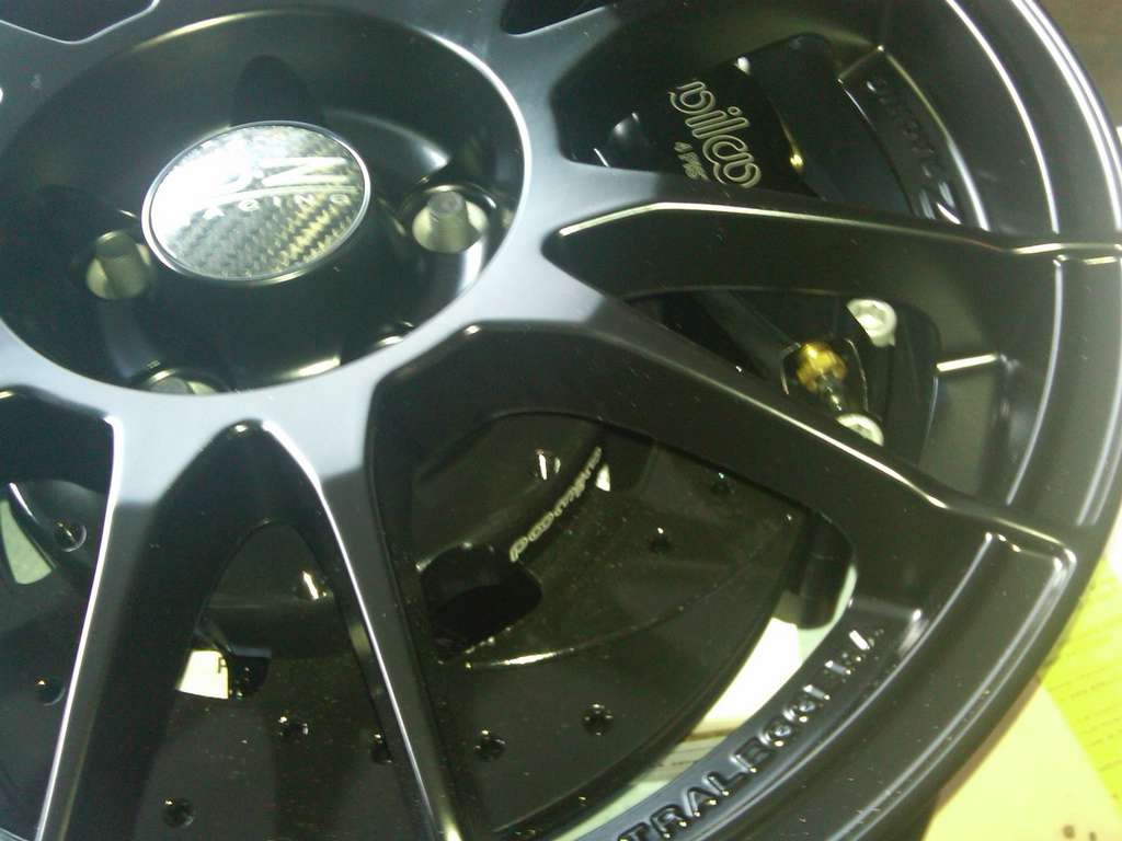

Got to test fit my rims for the wilwoods and powdercoated the timing cover.

88_GTU wrote:Got to test fit my rims for the wilwoods and powdercoated the timing cover.
Is that a Wilwood J-body kit?
Thats a very nice option for those who want to keep the 5x100, use a 16" rim but want 12" rotors.... weighing a measly 10.8lbs... BUT you need to put up 1k for the drilled and slotted kit.
88_GTU
Posts: 474
Post by 88_GTU »
It is the j-body kit. It fits the 92-up knuckles perfectly. I will have to get custom stainless brake lines made but that was the plan anyway. I was really hoping they would fit under my GTU rims without much of a spacer but that didn't happen. They do however fit quite nicely under the 16" OZs that also happen to weigh 7lbs less per rim than the GTUs so I'm not really complaining. If you can get past the steep pricetag they're actually a great mod.

Why was the stock 42mm not working? did the rim face hit the caliper? If so that would probably be more of an issue for his since I know they seem tighter in, or they are probably the same 42mm, if not 45mm.
Cavi guys say that they can still use stock rims on this setup though, so thats what made me think it could work.

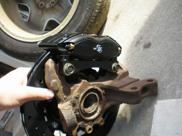

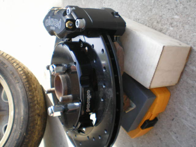

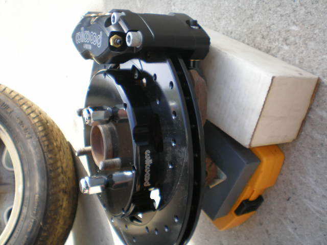

Yeah, the 92+ knuckles are needed. thanks for the advice on the fitting Modified! I'm going to have all 4 lines made as I'm working on the neon rears also so that helps greatly! As for the wheels, with the GTU and GTZ rims it was the face hitting the caliper as these are 4 piston and much wider than our stockers. I'll try to snap a pic if I can find one of the old calipers layin around.
88 GTU 5spd 67k black
08 TBSS LS2 AWD
88_GTU
Posts: 474
Post by 88_GTU »
Here's 2 pics of the setup. Notice how much further the caliper sticks out from the rotor hat. It's a pretty large difference from the stockers.
