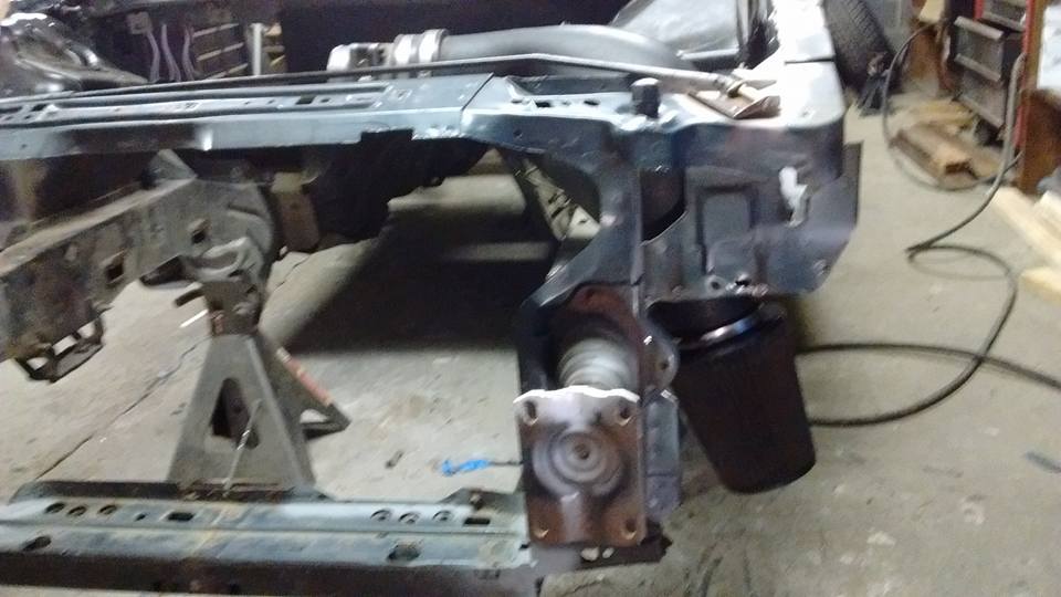

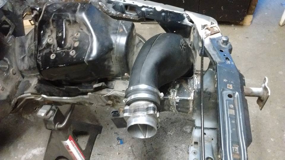

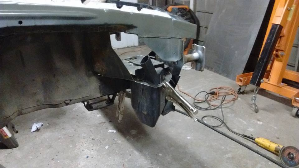

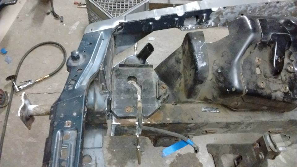

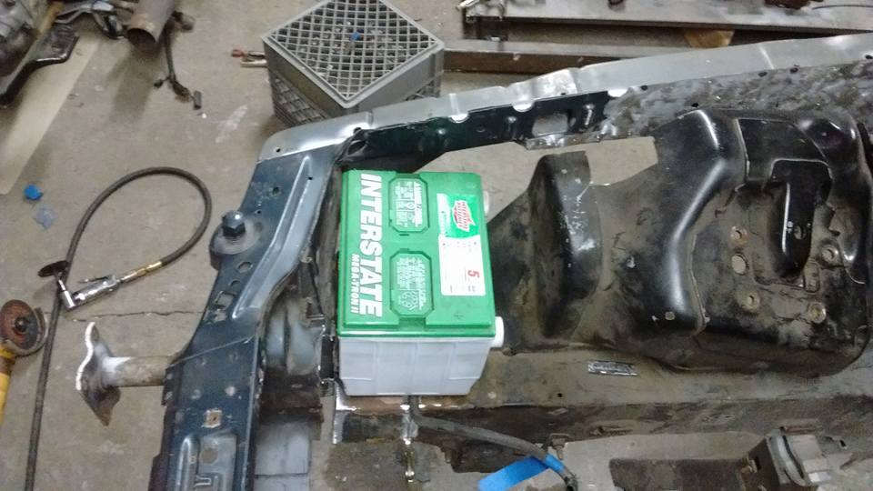

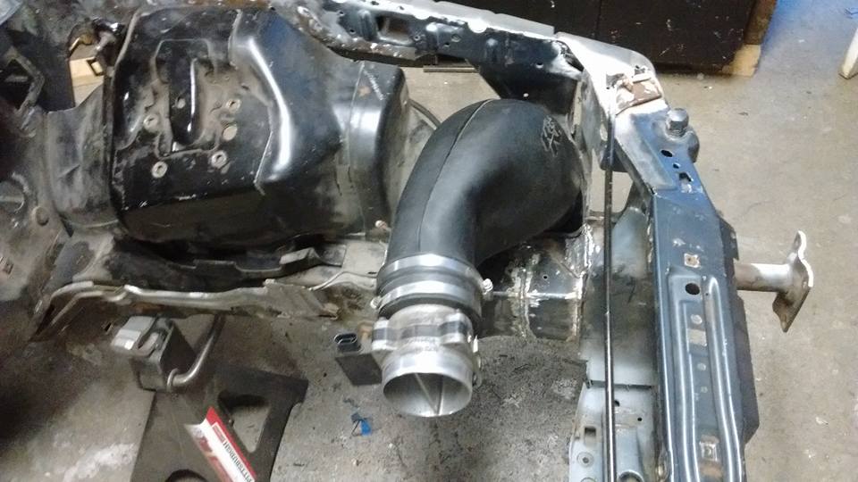

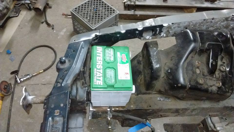

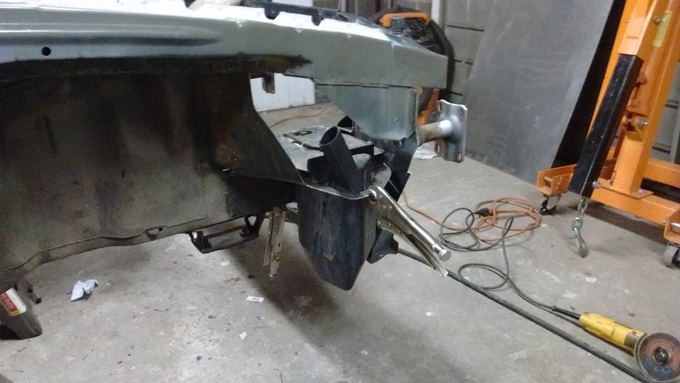

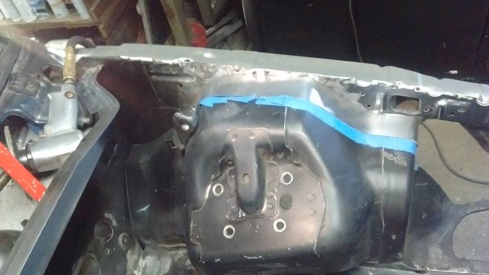

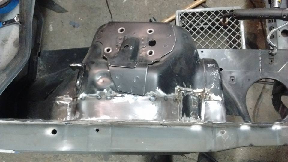

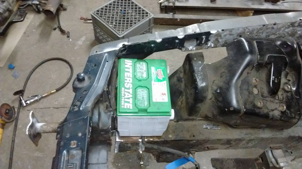

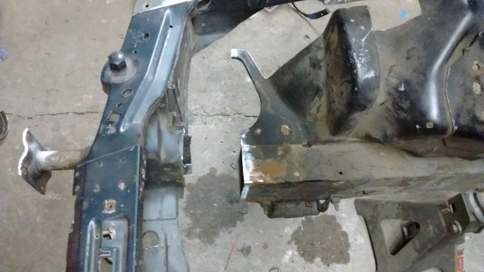

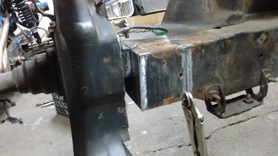

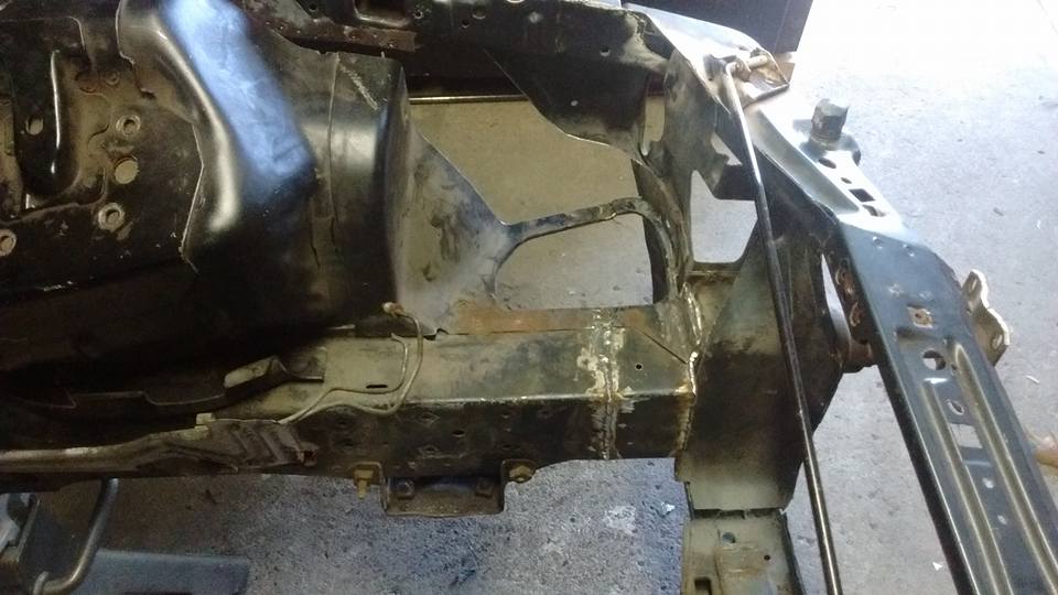

Front frame rails tied back in to the rad support and bumper rails. And was able to preserve the stock location for the coolent overflow / battery tray and KN air filter !!!!

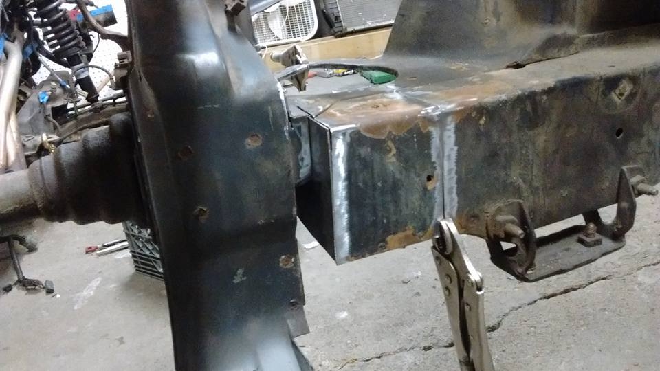

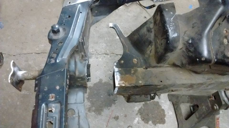

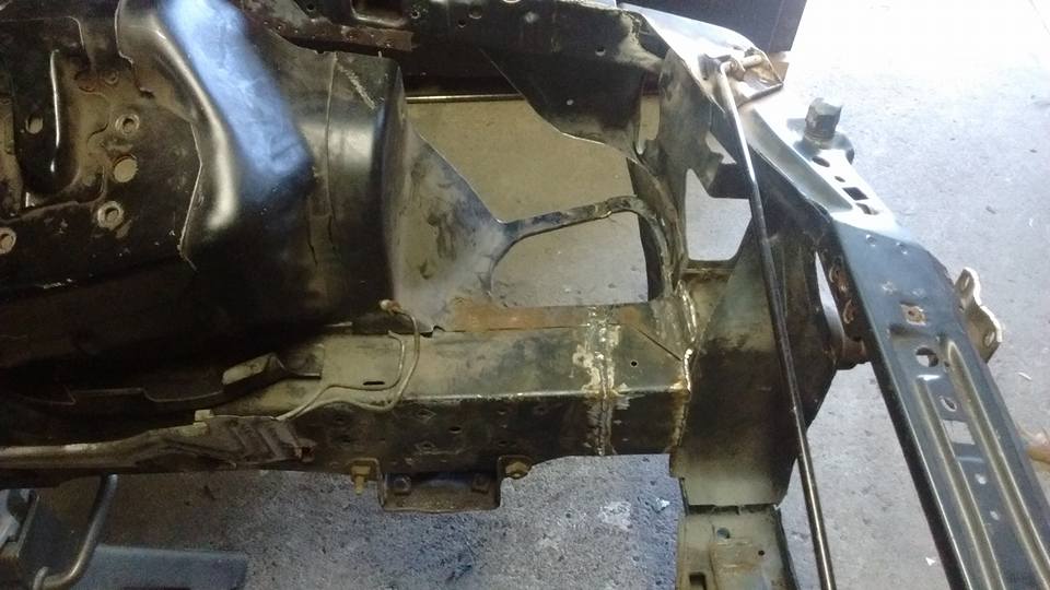

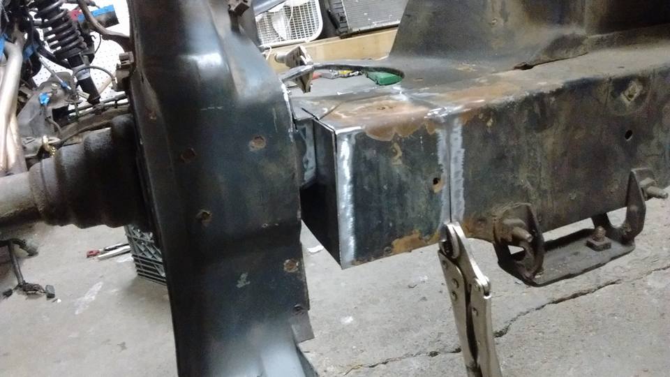

Did you cut off 2" of the Camaro frame - then weld those 2" back on and plate in the difference between the Beretta core support and the Camaro frame rails?
If so - good thing you kept the Camaro frame chunks around to weld back on.
It sucks working on a project - throwing something out and having to either fab or buy new again!
jjanke
Posts: 425
Re: Beretta Z28
Post by jjanke »
Yeah .....I over cut the rails in order to properly position the body fornt to back and make sure the wheel wells were centered over the tires.....it would have been too hard to know exactly where to cut everything and have it all line up which is why I'm now doing all this tedious patch work now......I knew I would need these

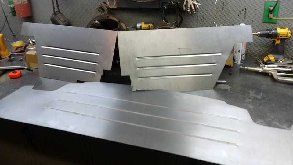

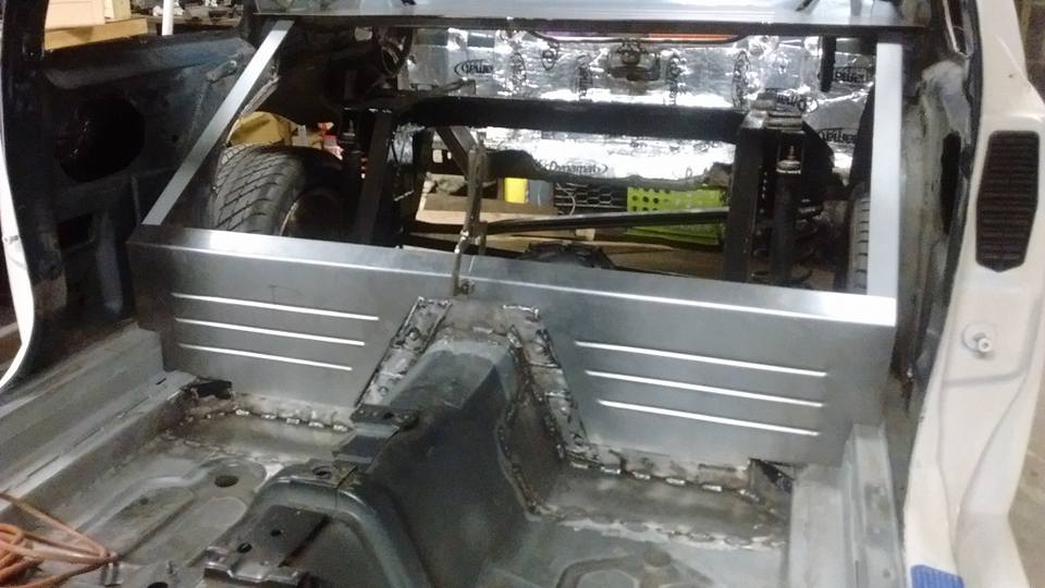

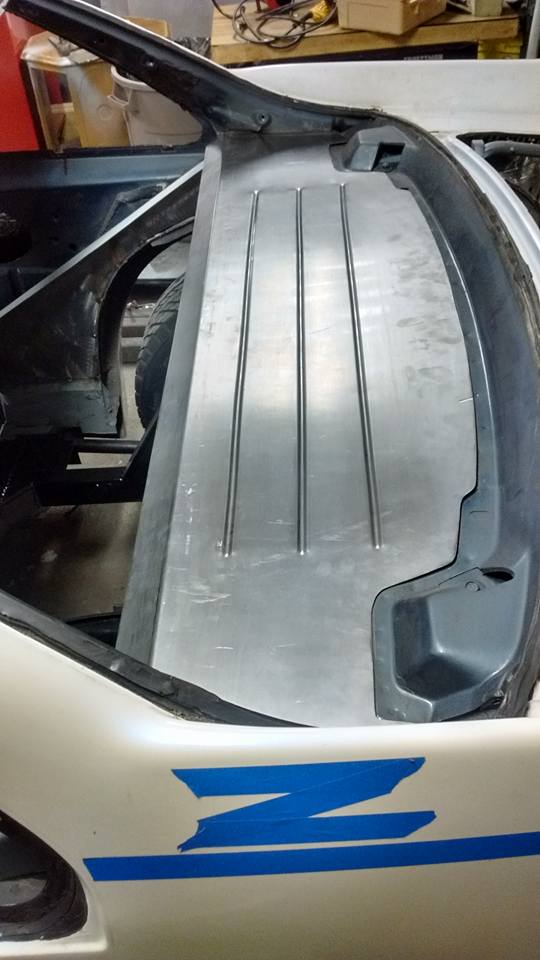

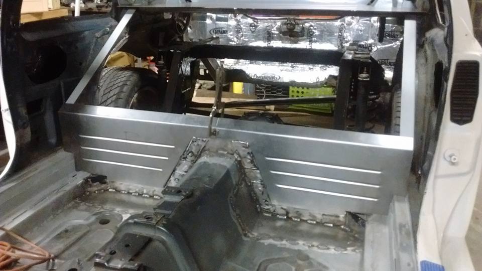

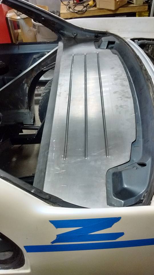

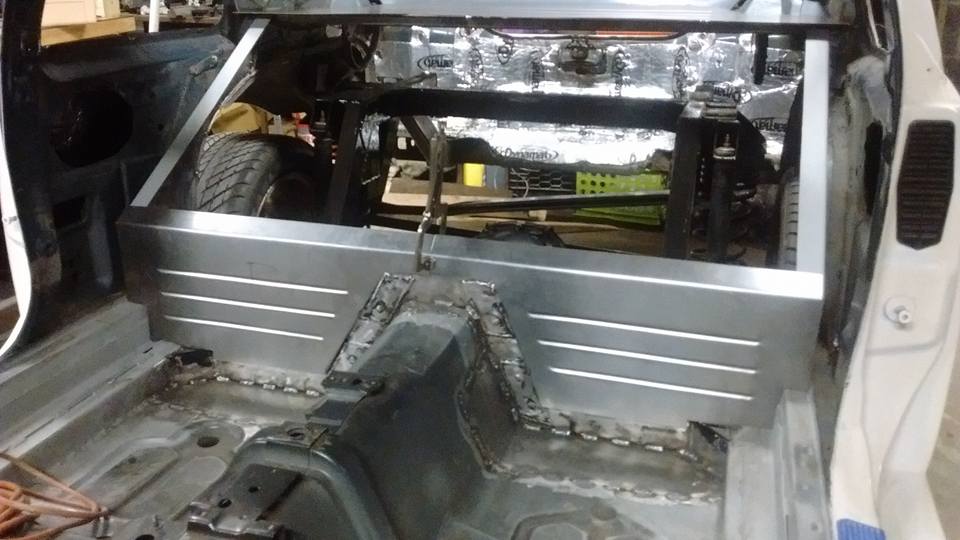

Beads rolled and flanges bent for the rear firewall
Posts: 4754
Re: Beretta Z28
Looks good. Did you buy a bead roller?
jjanke
Posts: 425
Re: Beretta Z28
Post by jjanke »
A friend has one....he hooked me up

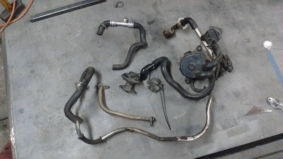

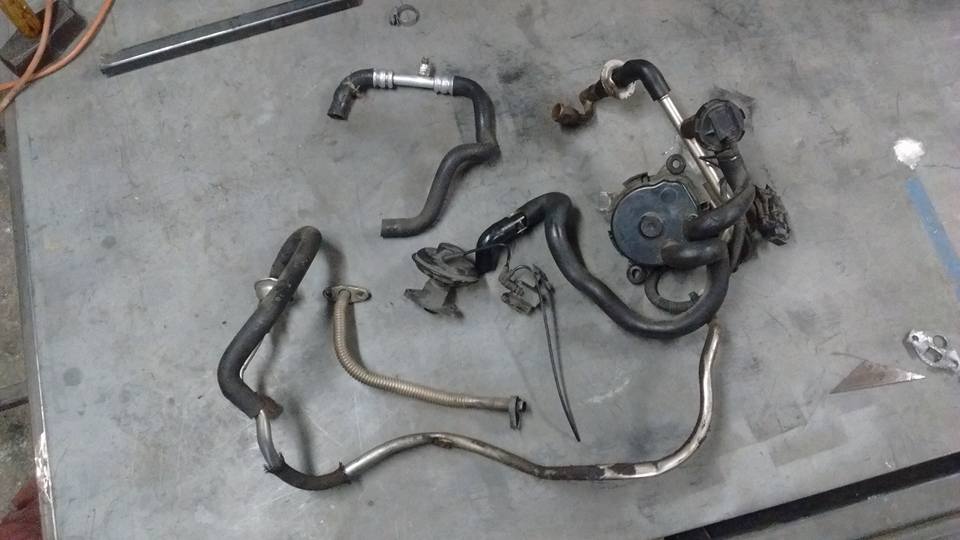

removing the EGR and AIR systems from the LT1. Ordered some fuel rail covers and some other lil things that should really help clean up the look of the engine

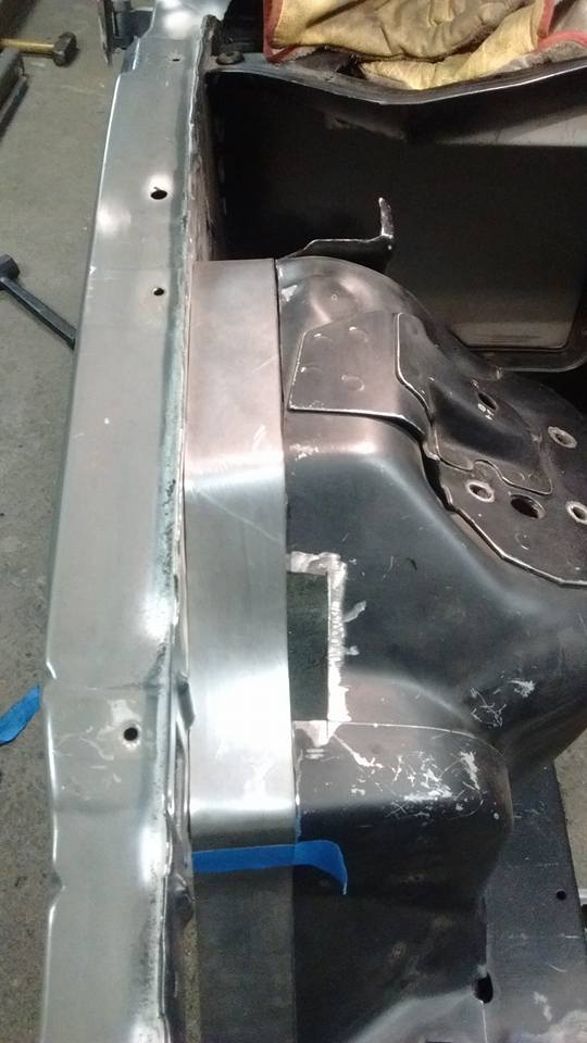

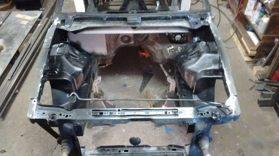

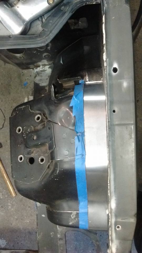

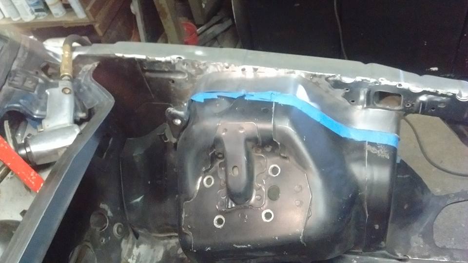

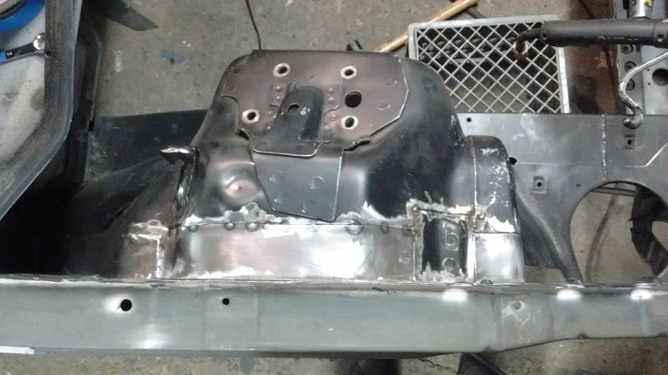

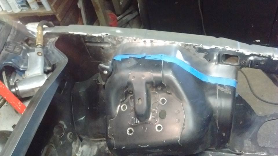

I think I may have finally finished all the metal work on the front firewall to cowl and strut towers to inner fenders......engine bay is ready for seem sealer and paint then gotta get the LT1 back in there
