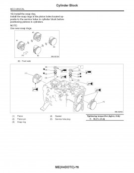

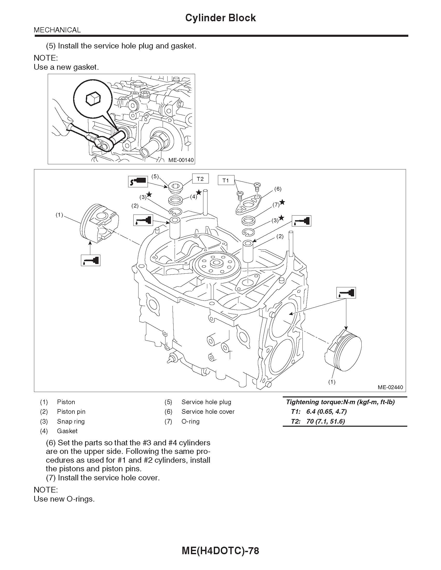

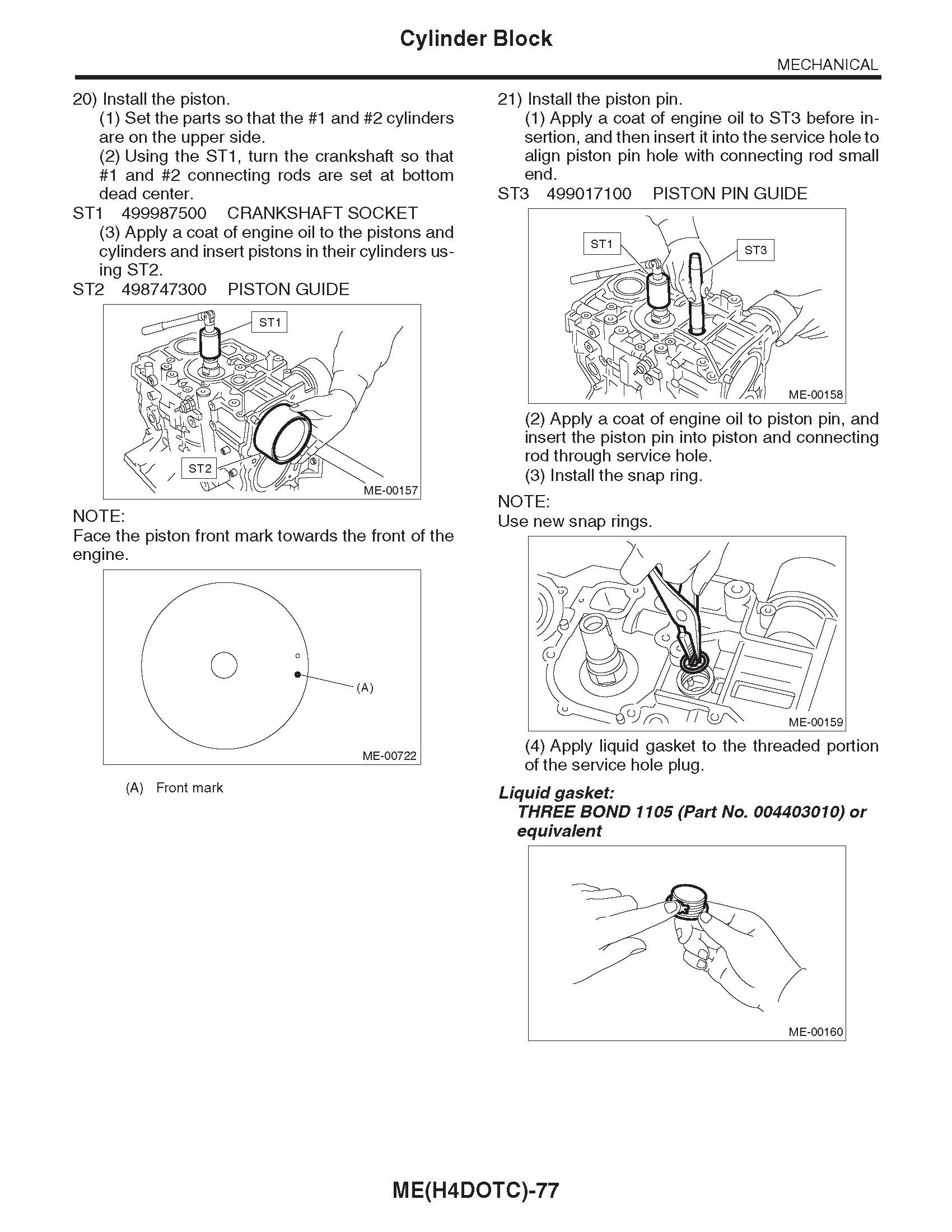

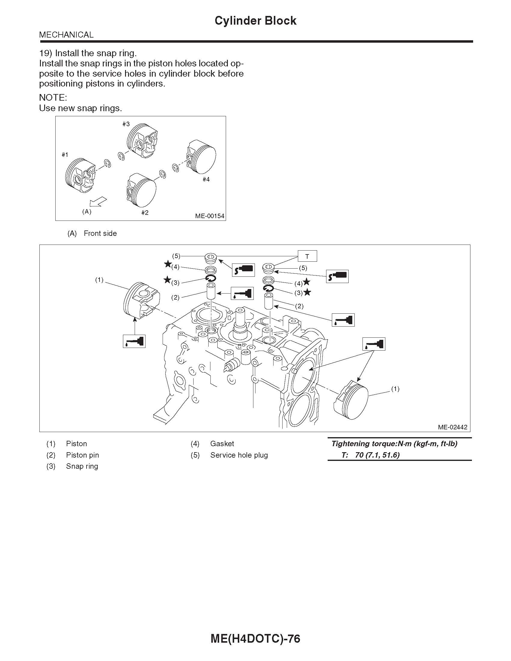

Wait...you are doing pistons after the rods? How is that possible?
Re: My Legacy Rebuild...
LOL I was waiting for that...woody90gtz wrote:Wait...you are doing pistons after the rods? How is that possible?
Easier to post the installation instructions than try to explain it.
Pistons wont go up from the bottom due to the journals so this is how its done when it's flat...
Yeah, I found that kinda odd myself. LOL
But that is pretty slick. Built in access.
