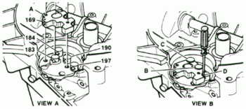

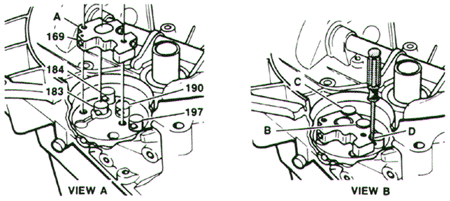

- Posts: 4778
Re: The trip into the "big leagues"
Try shifting it via the levers on the trans and not the shifter inside the car. I have a link in my build thread with a ton of 5spd rebuild pics.
That seriously bites. When I first replaced the transmission on my '90 "T-Type" Turbo 'Retta several years ago, everything seemed to go fine. The original Muncie had toasted itself when I let it run too low on oil, and the replacement was a stroke-of-luck junkyard find from an '88 or '89 GT for ~$80, with extras attached (I had been unable to find a spare Muncie for a number of years). But then I pulled the car out of the driveway... I had just put the original LG5 turbo 3.1 back in the car after an abortive use of the same 3.4 hybrid that is successfully in the car now (with alot more mods than it had back then), so I was already tired of working on this thing. First to second, second to.. Oh! No third. Or fourth. I had fifth and reverse though (for a while -those disappeared too, before I was able to pull the junk back out and complete the transplant of the Cavvy-sourced Muncie (VSS compatibility problems with that, BTW, avoid the older Cavvy or Fiero ones and save yourself a headache) and re-cranked 3.4 SFI Turbo engine that the car has now.

- Posts: 4778
Well, you could send it to Midwest Transmission like I ended up doing with mine. You'll be about $400-500 total for a complete rebuild. The other option is to crack it open yourself and have a look...it could be something simple.

Here's a pic of the forks where the shift shaft goes.
I've got a bunch of spare parts if you do need something.
http://www.motortopia.com/cars/1991-che ... uild-32579

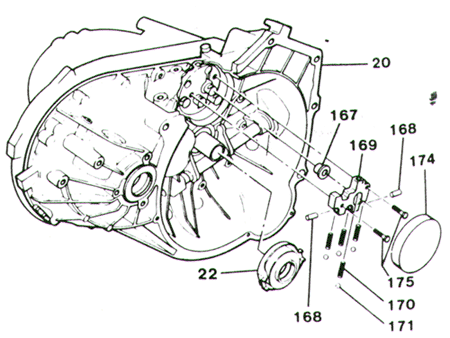

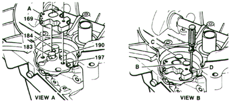

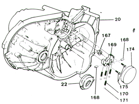

I am with Woody here -if you can take the time, crack open your case and see what you've got. Otherwise, I would chase-down that older 282 you mentioned. In the grand scheme we are talking, the few years difference in age doesn't matter much, and I have a number of 282s that old that shift fine (I also have three here that don't, so...
Here is a parts schematic and list for the 282 -it might help show how it all goes together, and if you do find something bad in that trans you could use the list to help get the right part from Woody. I hate to say it, but now might be a good time to consider an LSD upgrade too...
