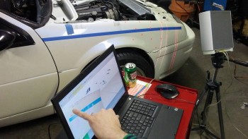

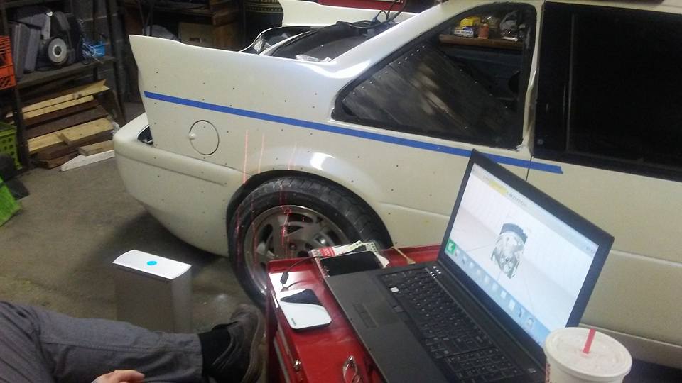

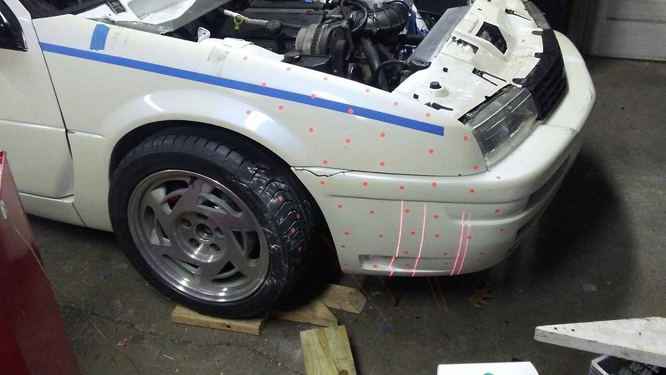

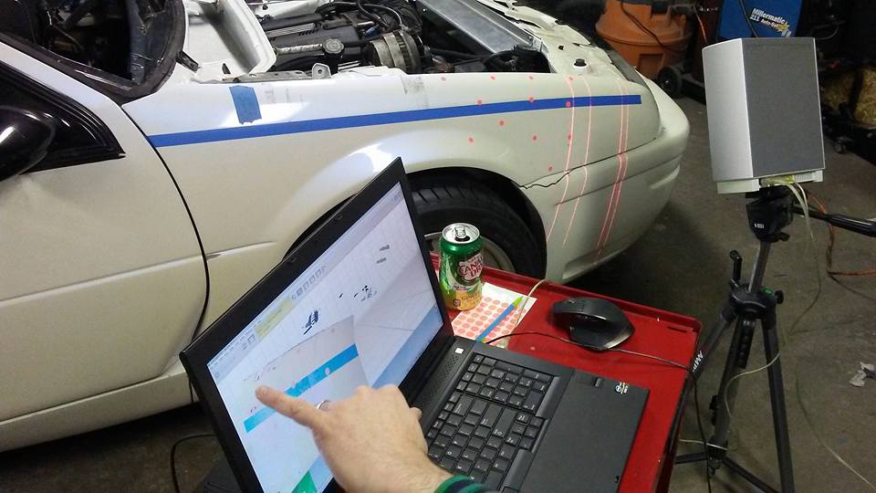

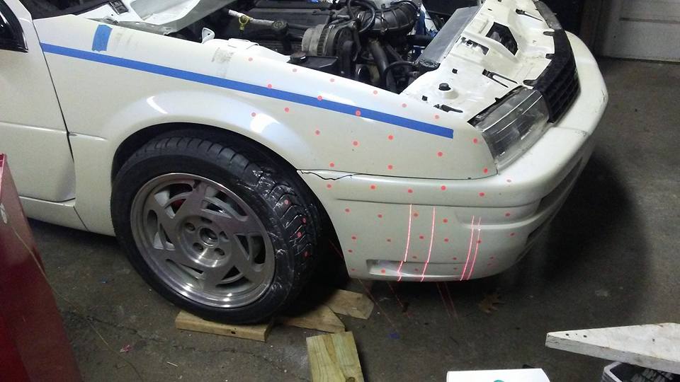

That's the idea...Scan existing surfaces, re digitize new wider surfaces, CNC female molds, lay up new fiberglass fenders.

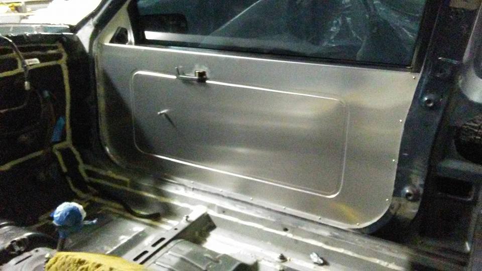

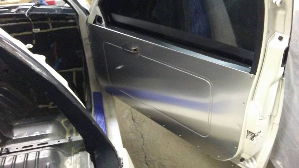

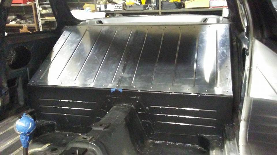

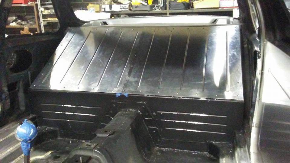

Door panels and rear firewall just about done :) feels good to be making some progress again!!!

What about stretching the stock steel fenders? I've seen people weld in a pie-cut to stretch them without doing the huge flare look.

maybe it would work if i just needed an inch ..... the wheels are way out there...... plus im planning on test fitting some extended upper and lower control arms to gain even more steering angle. which is gonna push the wheels out another 2 inches if i go that route..... im gonna need a widebody for my widebody :)

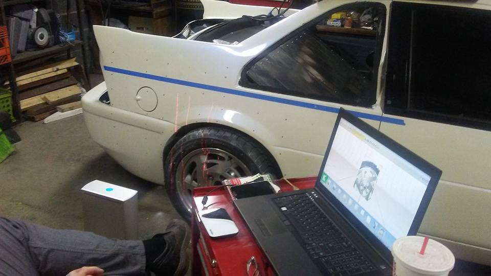

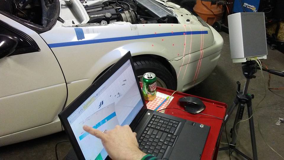

This will be the first step in creating the wide body kit for the Beretta. (If my plan works) We finished scanning and digitized the existing surfaces of
the Beretta. Now it's time to get WIDE !!!!!
