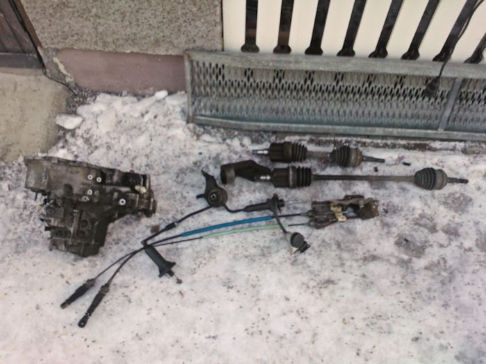

Out came most of the Isuzu parts from black car.

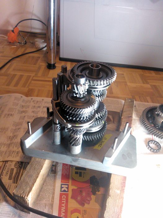

Transmission assembly platform I scored from Ebay is worth every penny.
Mounted there are the original Getrag 282 internals from my white car, still in perfect shape.
I decided to use these one because of the gearing. I also have 3 other Quad transmissions and 3.94 FDR, but I think the usual 3.64 will fit my application better.

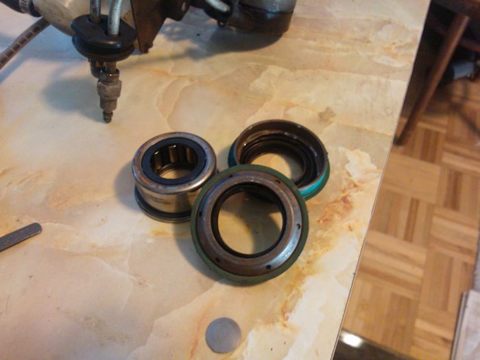

Only parts I replaced with new, 2 gaskets and input bearing, everything else was good to go.
I found NOS bearing out of Ebay, but it only worked with External slave, Lucky me, I had new bearing on the 4DFF trans case I never used.

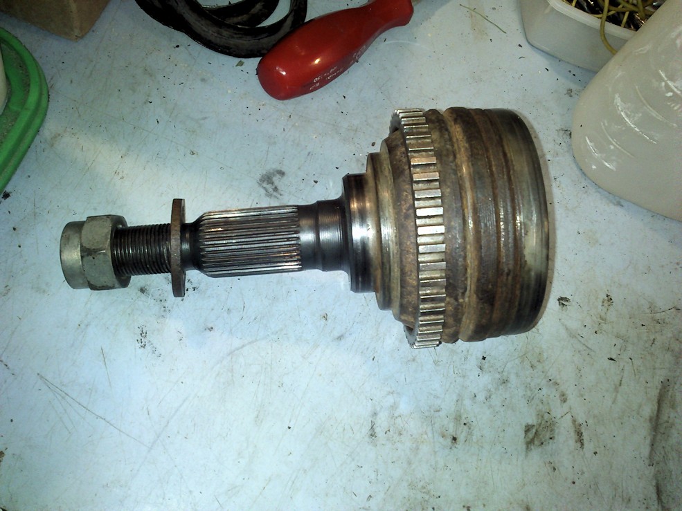

*4 Axles machined to fit ABS-sensor rings from 3T40 axles, also have to build a bracket for intermediate shaft.
90 Quad axle end & added ABS ring

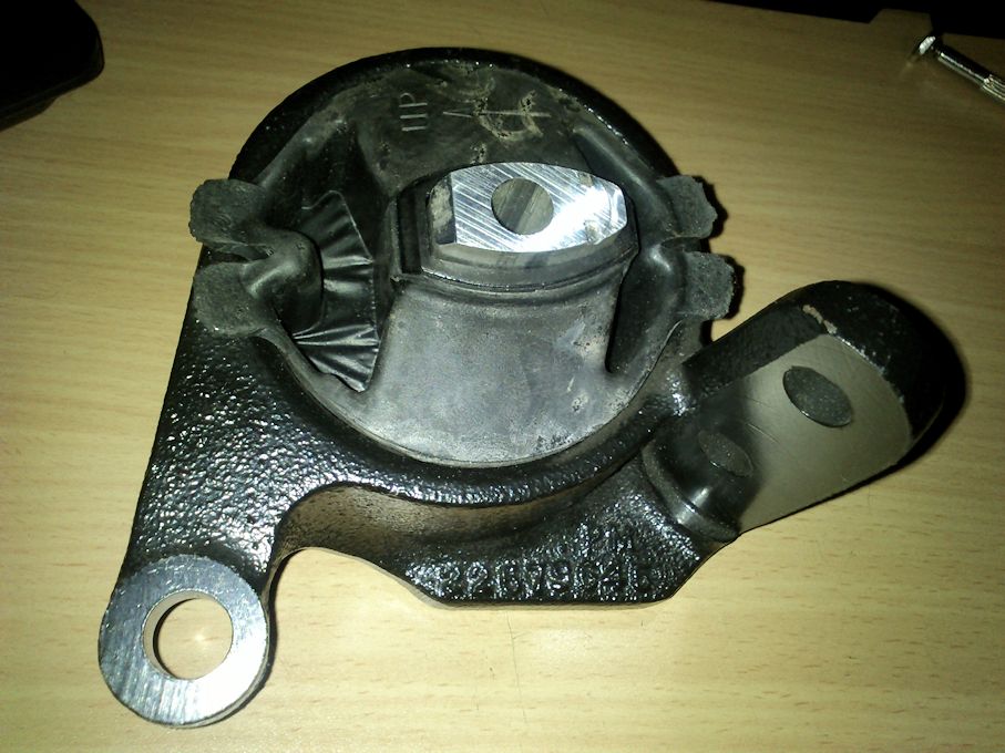

Here's a NOS NVG front mount from Vintage parts.
On rear I'm using mount from Quad car, still in perfect condition.
