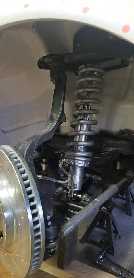

I'll have to checkout Viking - I was looking into Ridtech's setup - but that gets expensive super quick.

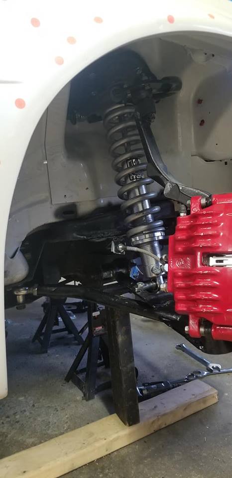

Thanks. The Viking stuff seems really quality. Lots of shock dampening adj....and ride height adj built into the shock body with different size springs as well. I believe UMI runs a 4th gen camaro in optimia street car challenge with Vikings and either won ....or was very competitive.

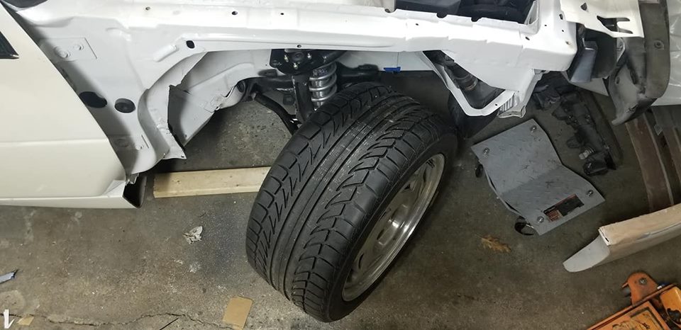

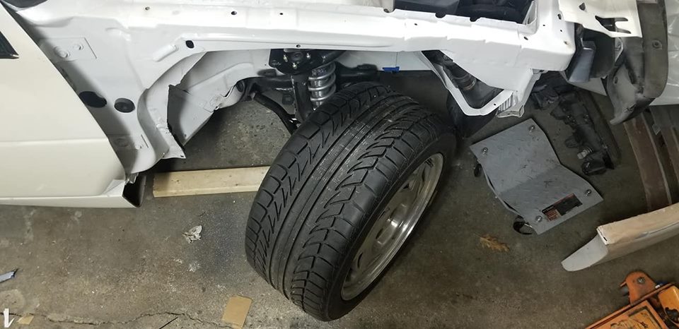

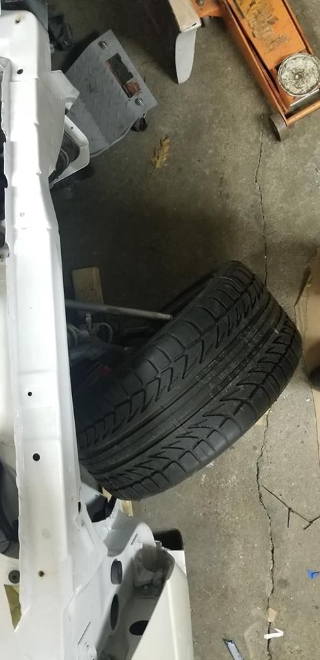

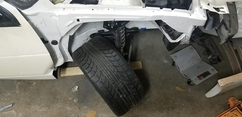

Felt great to get back to some stuff I had put too far on the back burner. Beretta progress!!!! Viking coilovers. Extended Spohn upper and lower tubular arms and extended tierods, shortened knuckles, flaming river power steering rack, power stop disc brakes

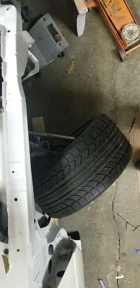

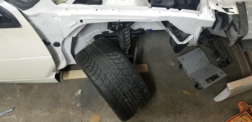

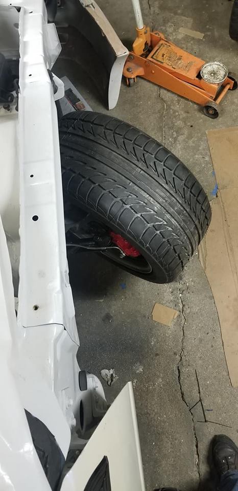

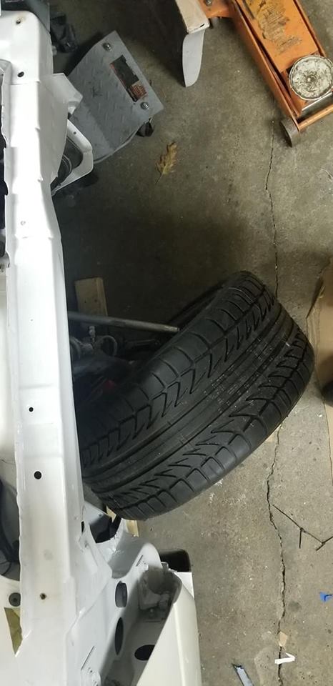

Some more trimming and cutting in the inner fender/wheel well= more steering angle
I'd say
this kit has some angle !!!!

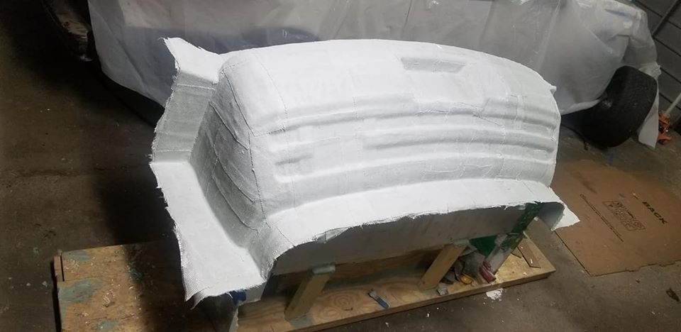

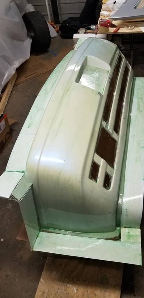

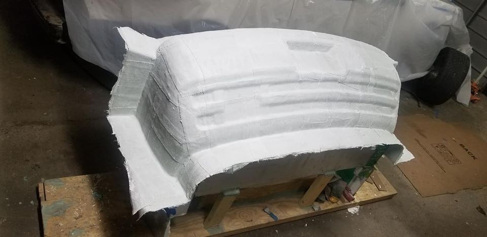

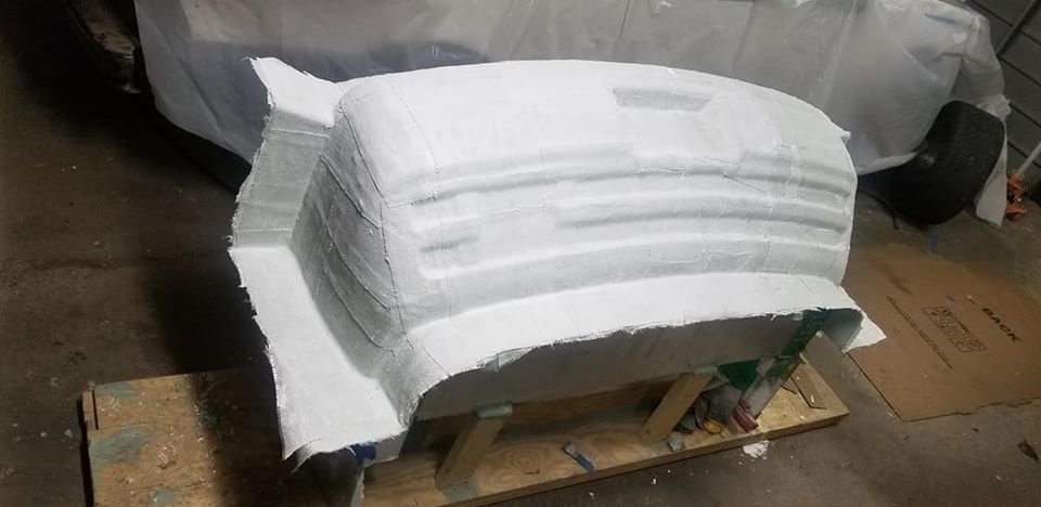

Made some progress on casting the rear bumper. Still need two more layers but ran out of laminating resin and cloth. Back to the store

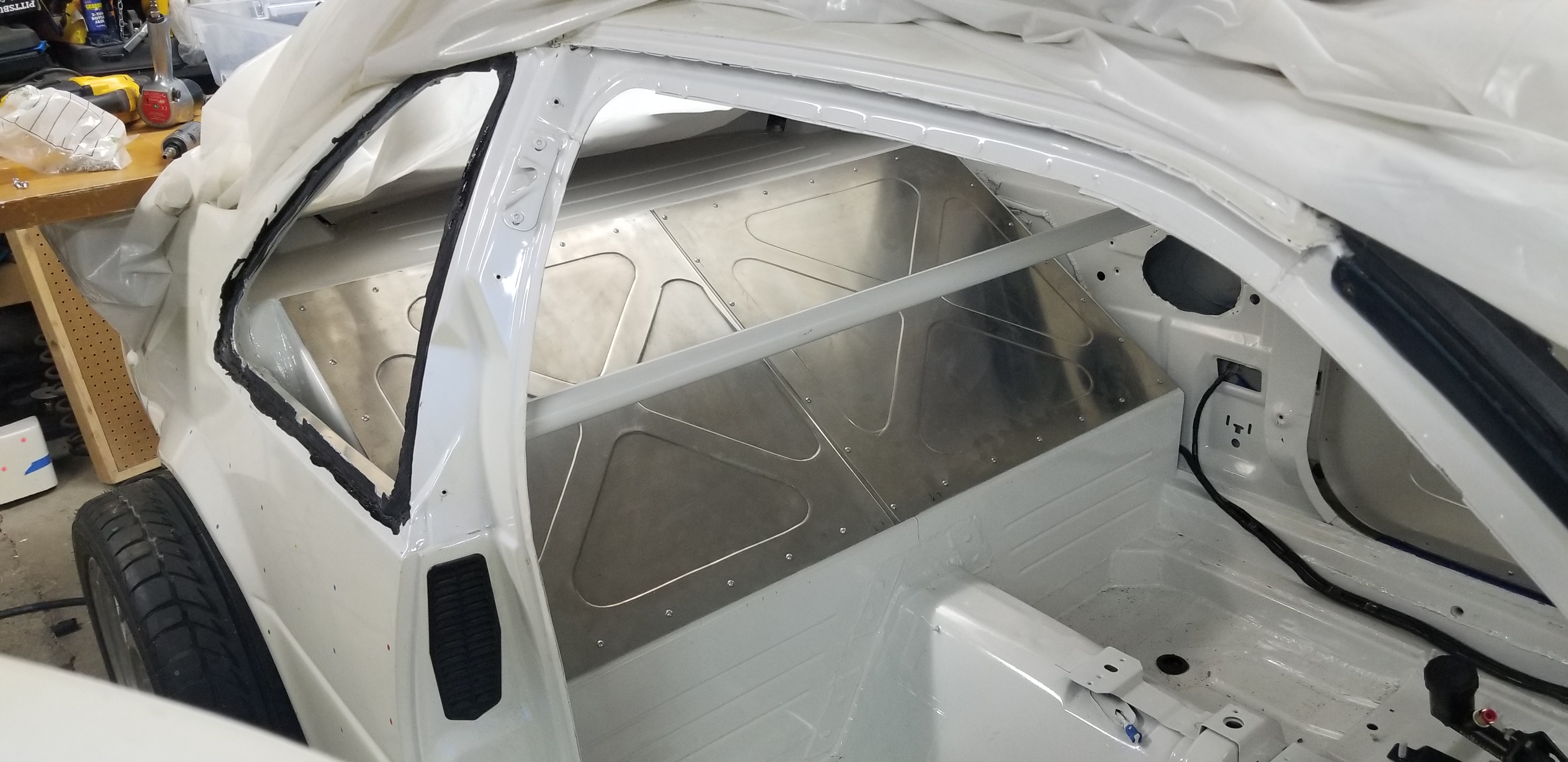

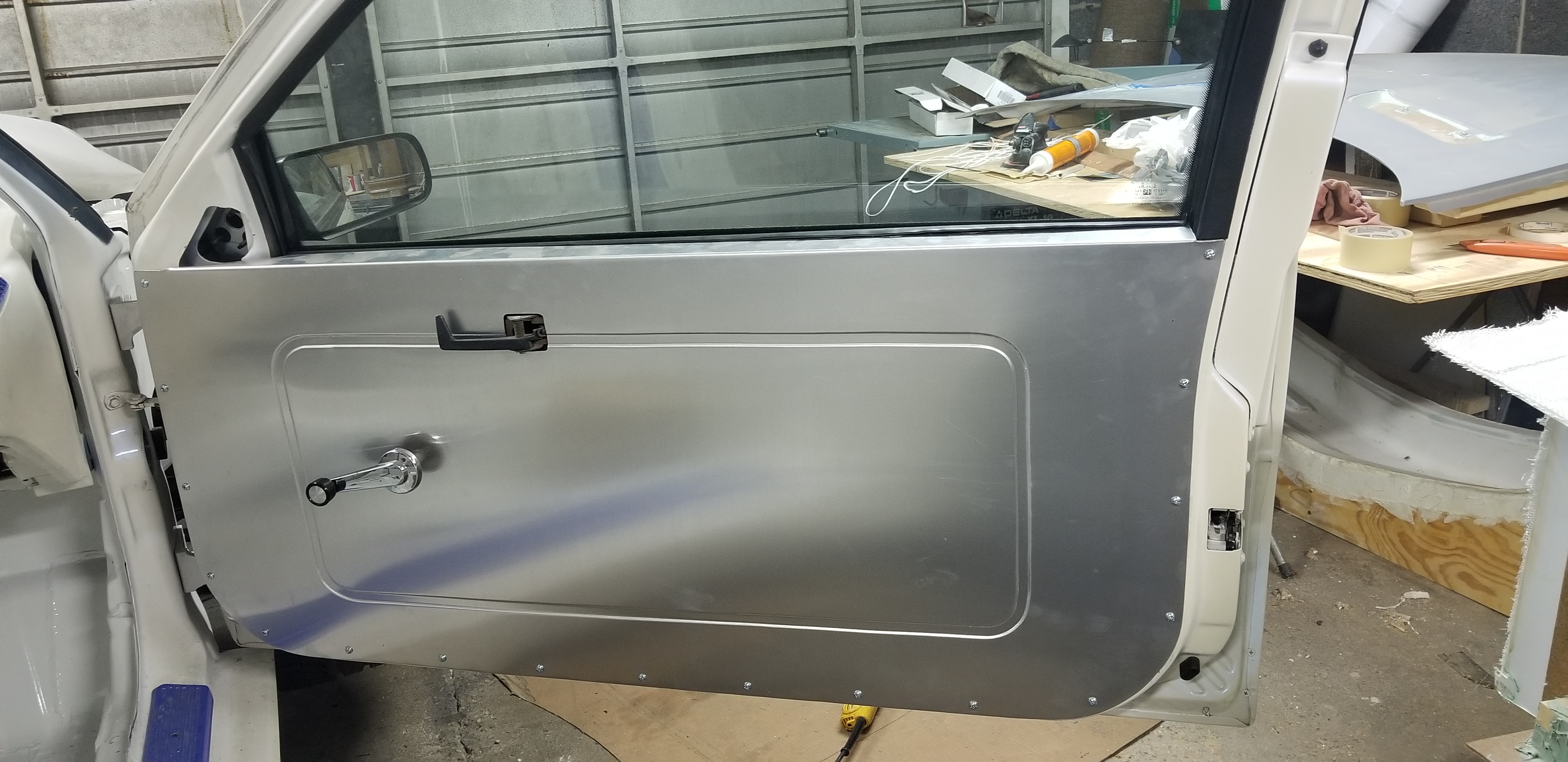

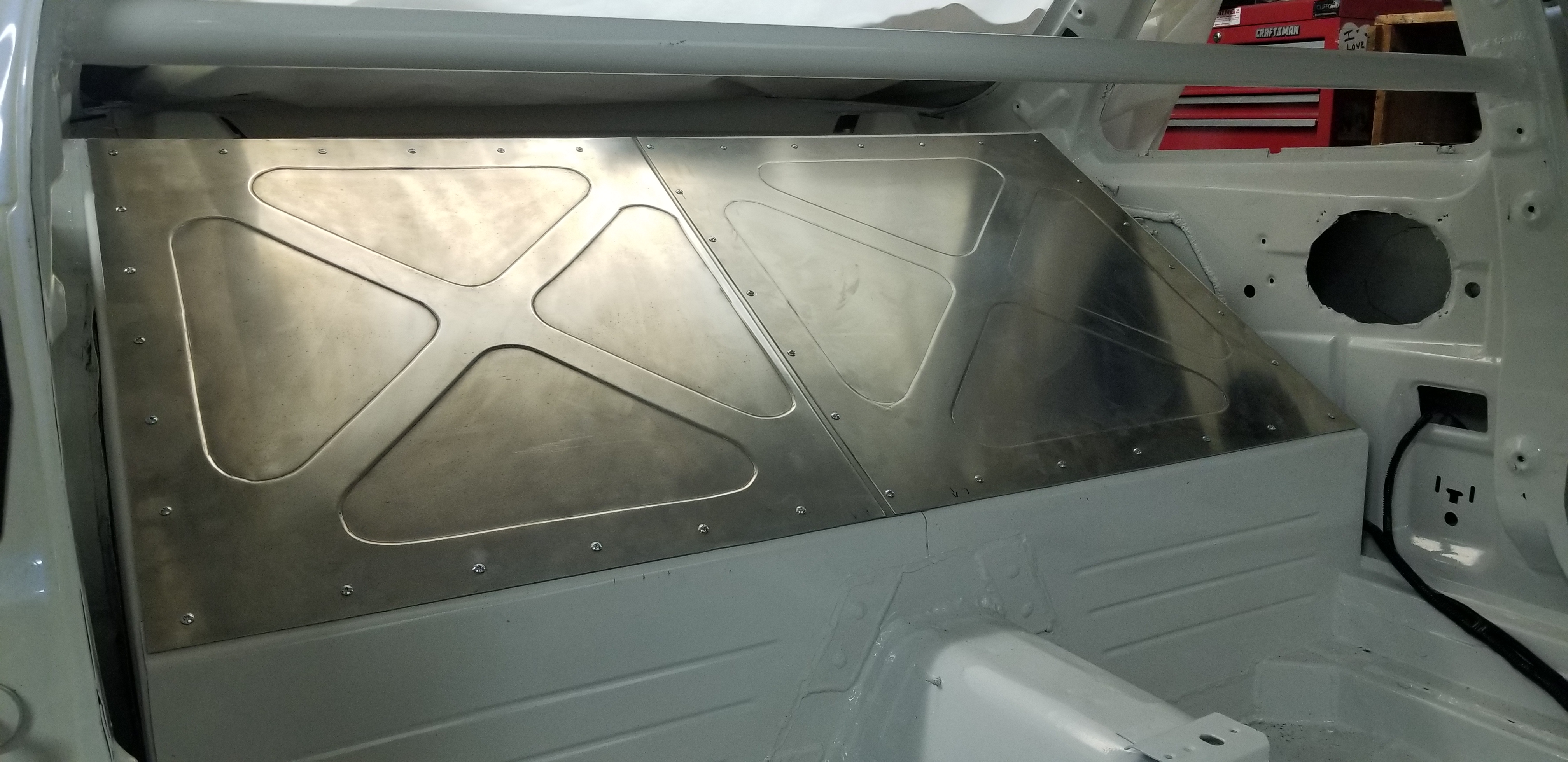

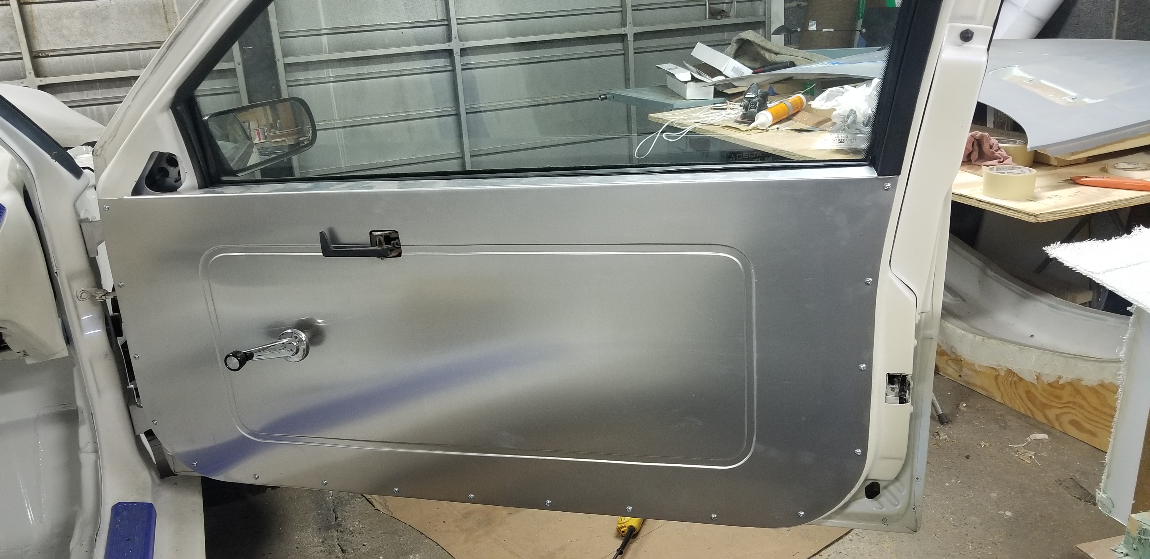

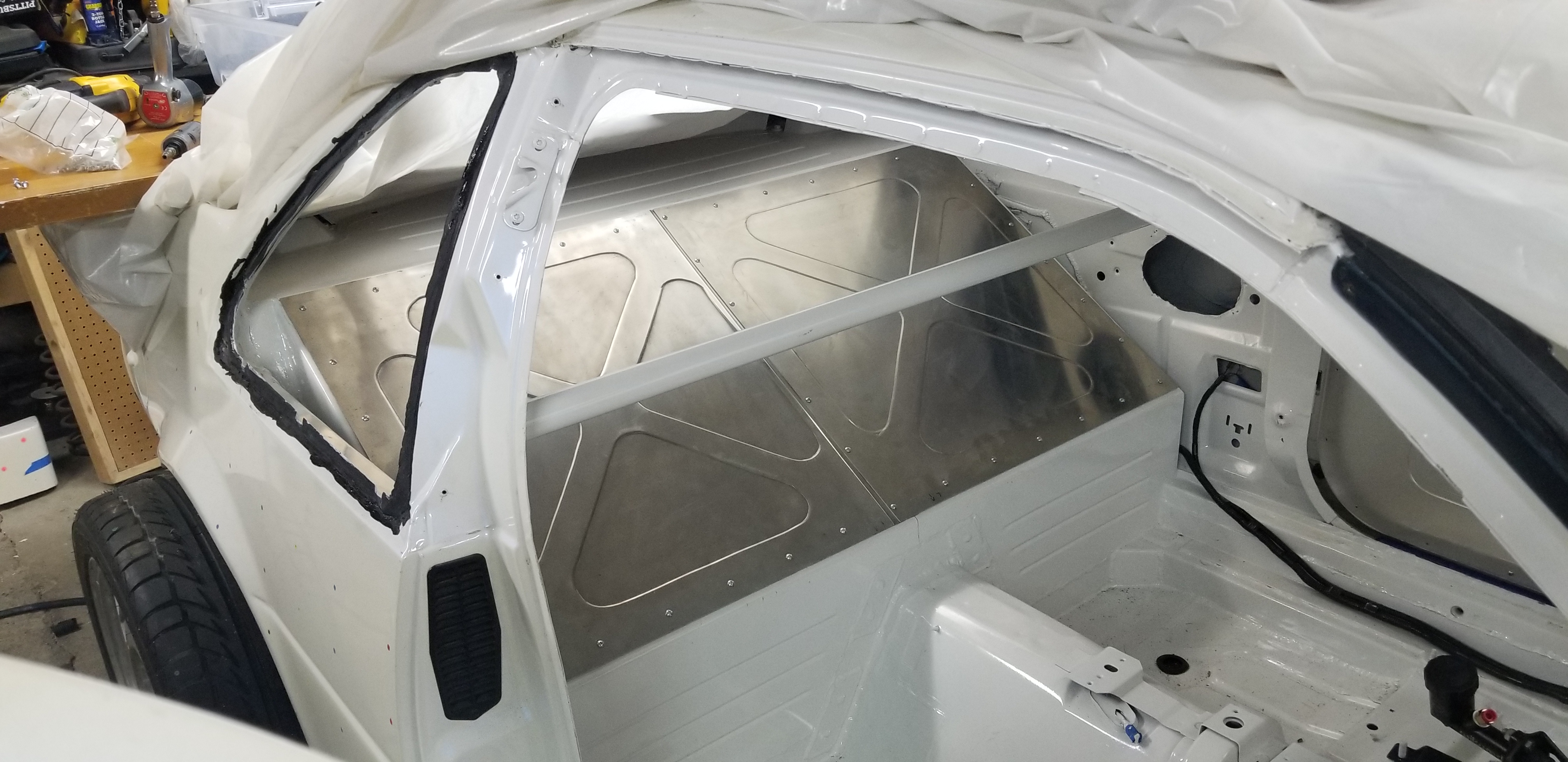

Finally got around to installing the new X rear firewall panels made out of thicker aluminum. Also installed rivnuts forball the fasteners on the rear firewall and door panels

Wow! Great progress, that is an impressive steering-angle, I am personally always laughing at GM's biggest failing in that department with the phrase 'turns like a Chevy' as I make a multi-point turn... :roll: You won't be able to say that about your car! :good:
Those aluminum panels look oh so clean in there... I can't believe how nice those door panels look.
Still watching, after all this time, and not disappointed at all. Keep it going! :Bravo:

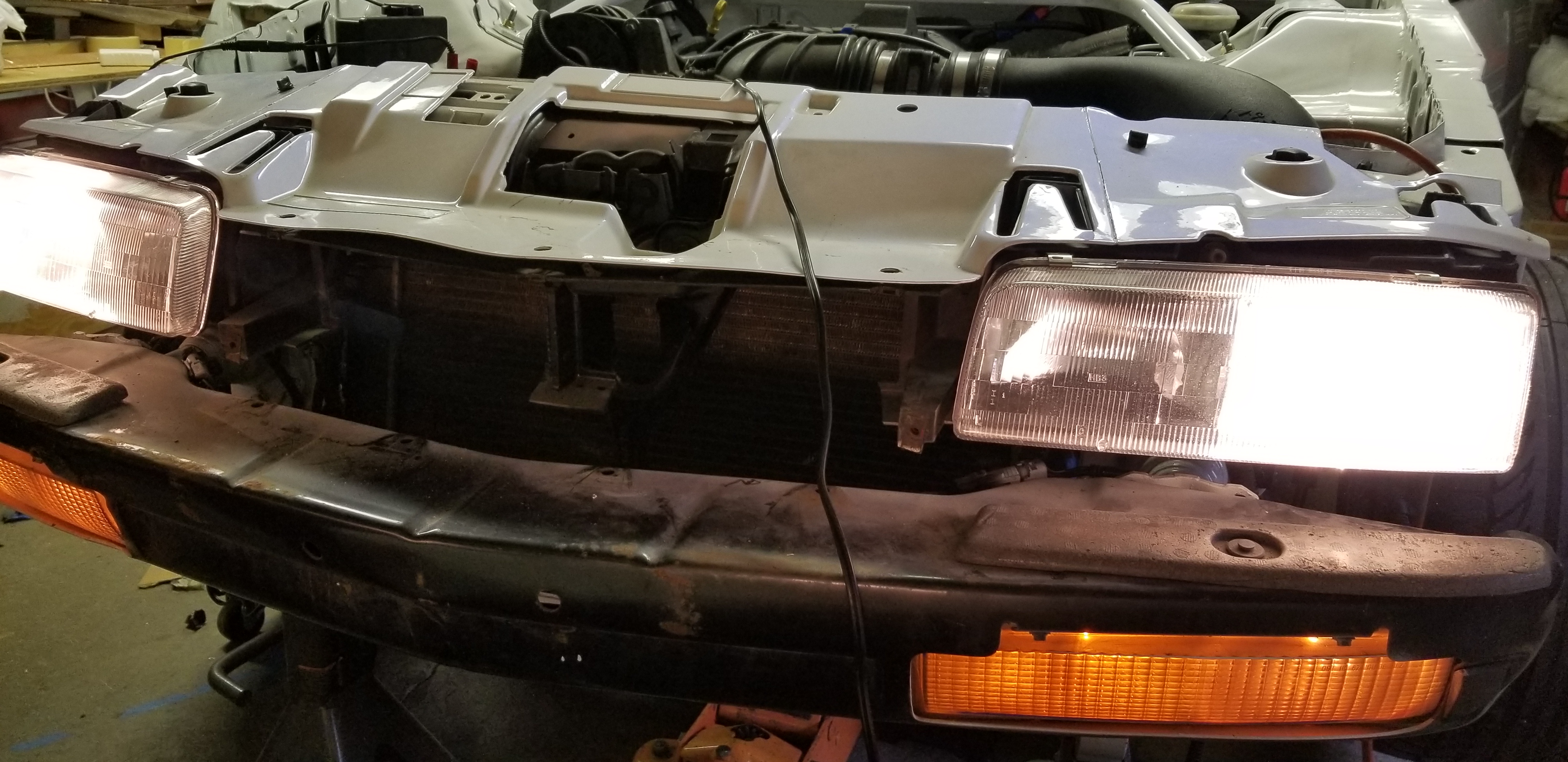

Was able to rewire and switch out some bulbs and pigtails and get headlights and brights running lights and turn signals to work properly on the beretta. All the lights are functioning as should again

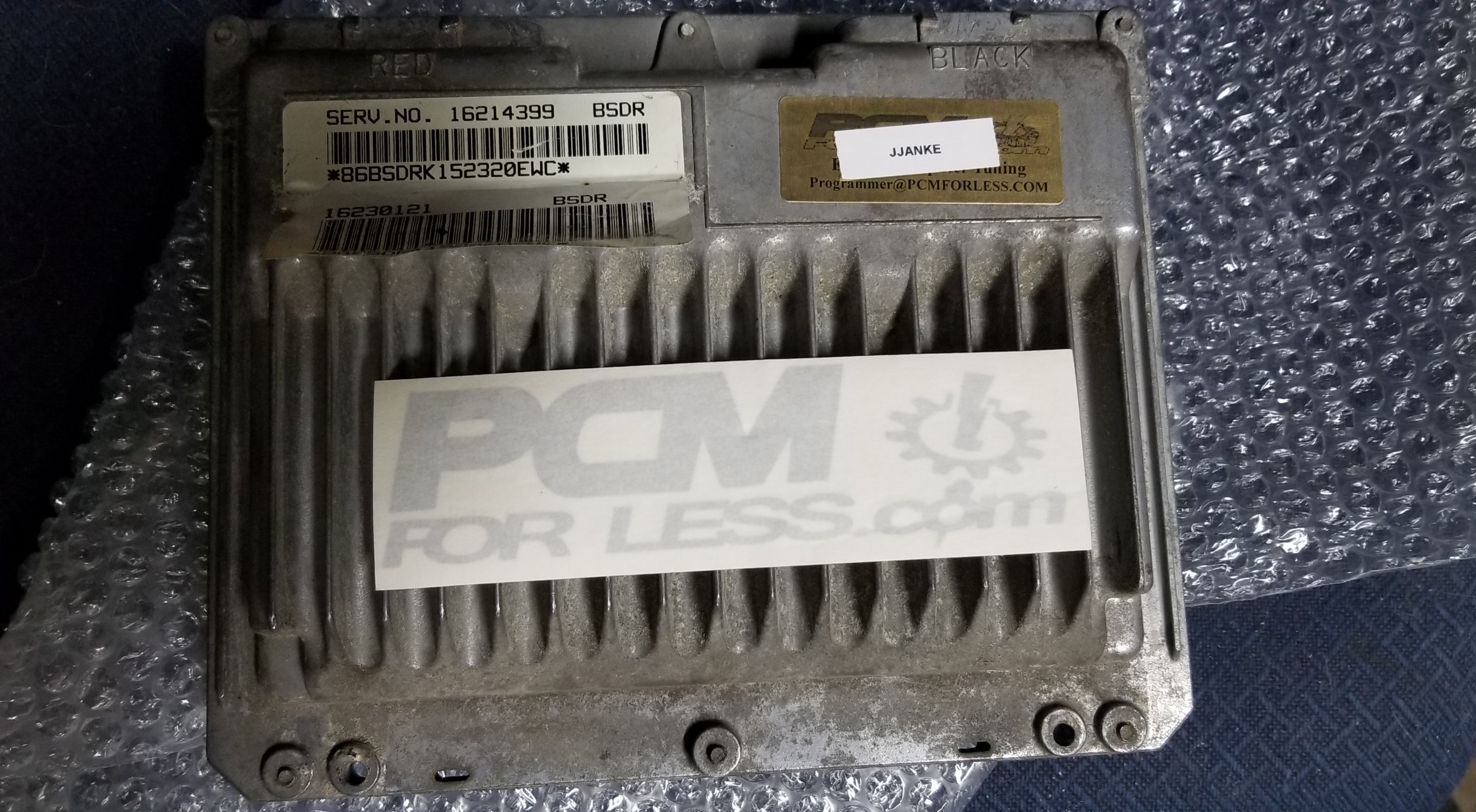

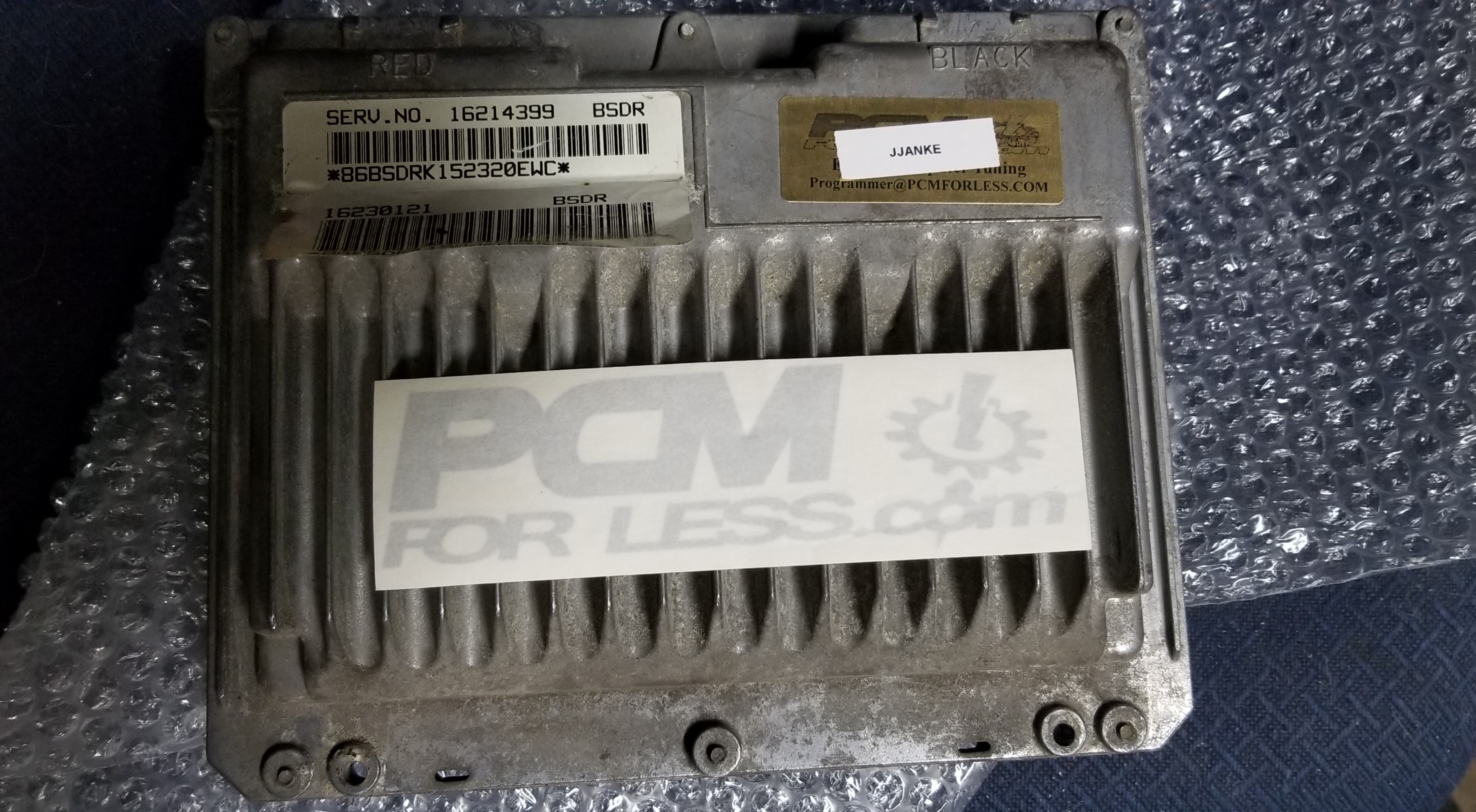

thanks to PCMforless.com for the fast turn around on this tune for the Z28 beretta. Shes gonna be running like a champ now!!!!

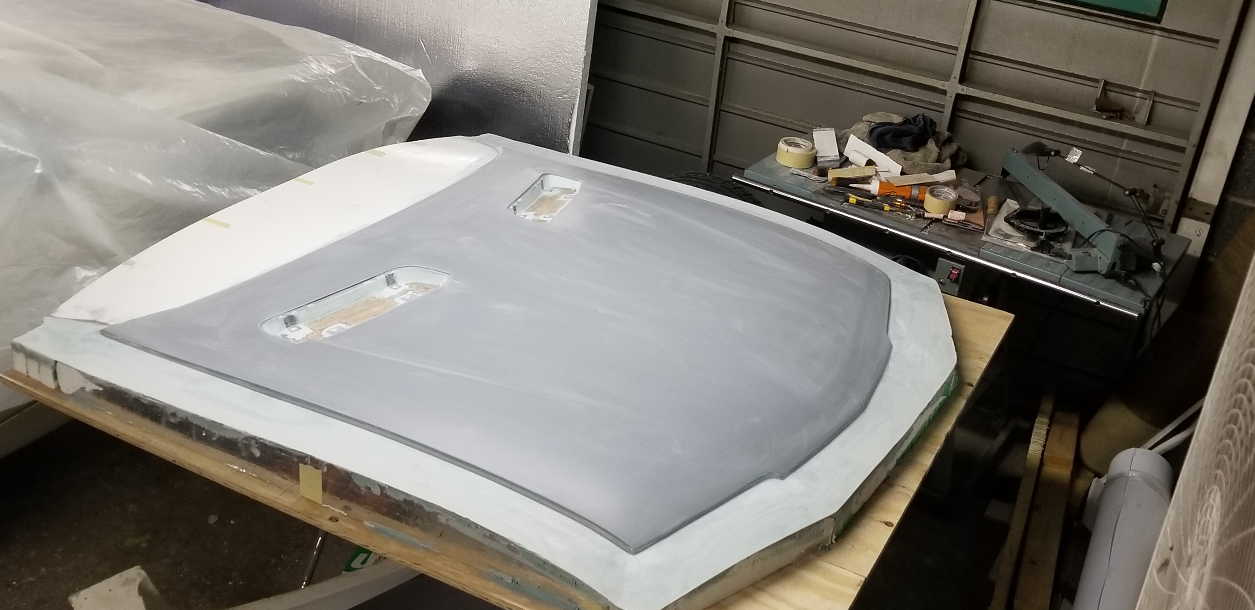

All the shut offs and run off flanges finished ...Z28 Beretta hood just about ready to lay up. Gotta hit up RussSimpson and re up on my resin and cloth and were ready to make a mold
