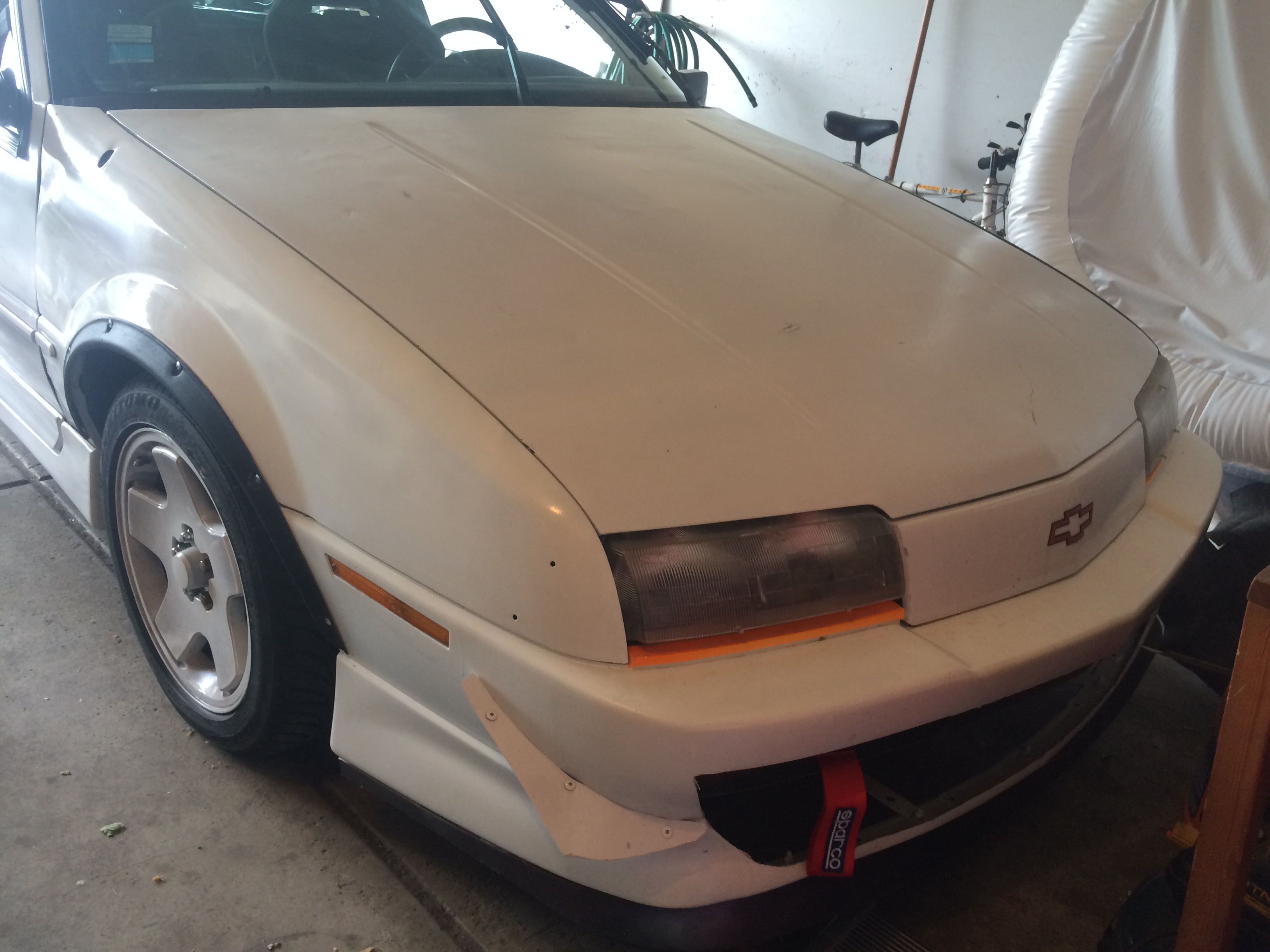

What's up y'all. It's been awhile! My car looked like this for the longest time:
I was going to get the paint professionally done until I lost my job like a month ago. I worked for Macy's annnnnnd they closed down my store so plans have changed since I need that money for staying alive. Looks like it's another year of Rustoleum spray cans!

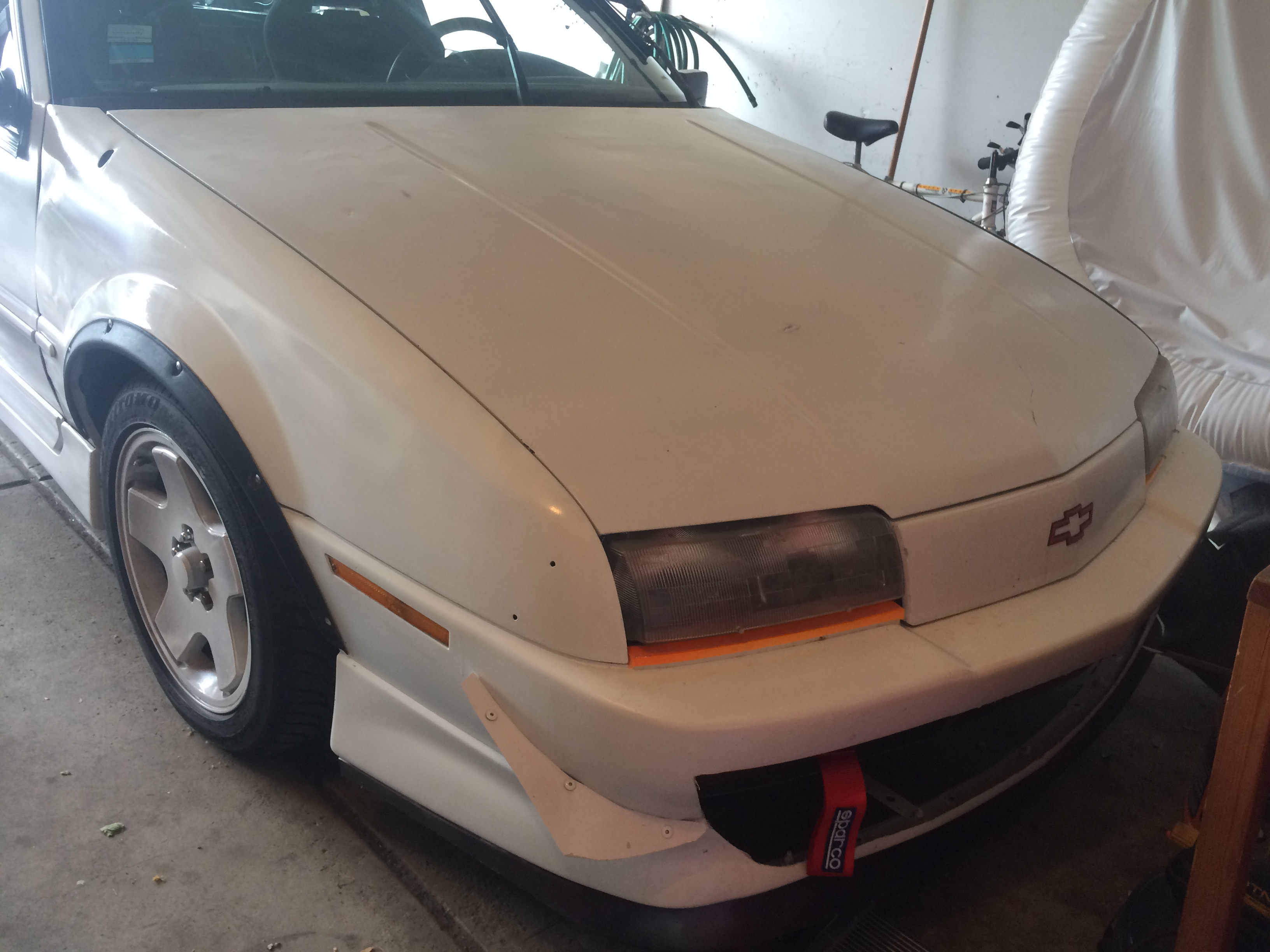

I'm like 95% done with my 2017 spec Autocross car.
Most notable changes is I spray painted the car and wheels white now. I also put a bigger face hole to get maximum cooling.
I will be painting those internal guts black to "hide" them.
Also I put on some fiberglass fender flares that I got from EBay from some dude in the Ukraine.
You'll notice I have those orange things under it's eyes. It's just a tribute I did off of a grassroots team that ran the 24 hours of thunderhill. It was an article I read back in 2010 that I thoroughly enjoyed. They had a Nissan Sentra with matching livery.
You'll notice I have bumper canards in the front now.
This should provide a little front downforce from the high pressure it will create up there. Other than that, the next step would be a full on front splitter
I made them from scratch using what you see here:
I still have some odds and ends to wrinkle out but progress is being made on the racecar.
Also I put back the OEM hood. I'm going to daily drive this for like a month and would like the added practicality of a hinge.

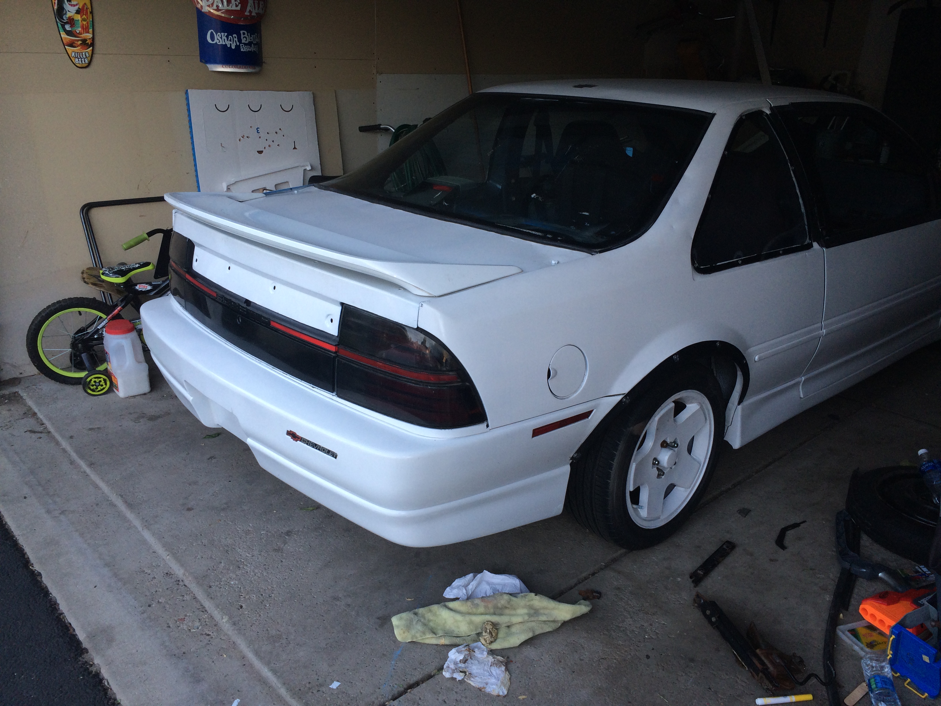

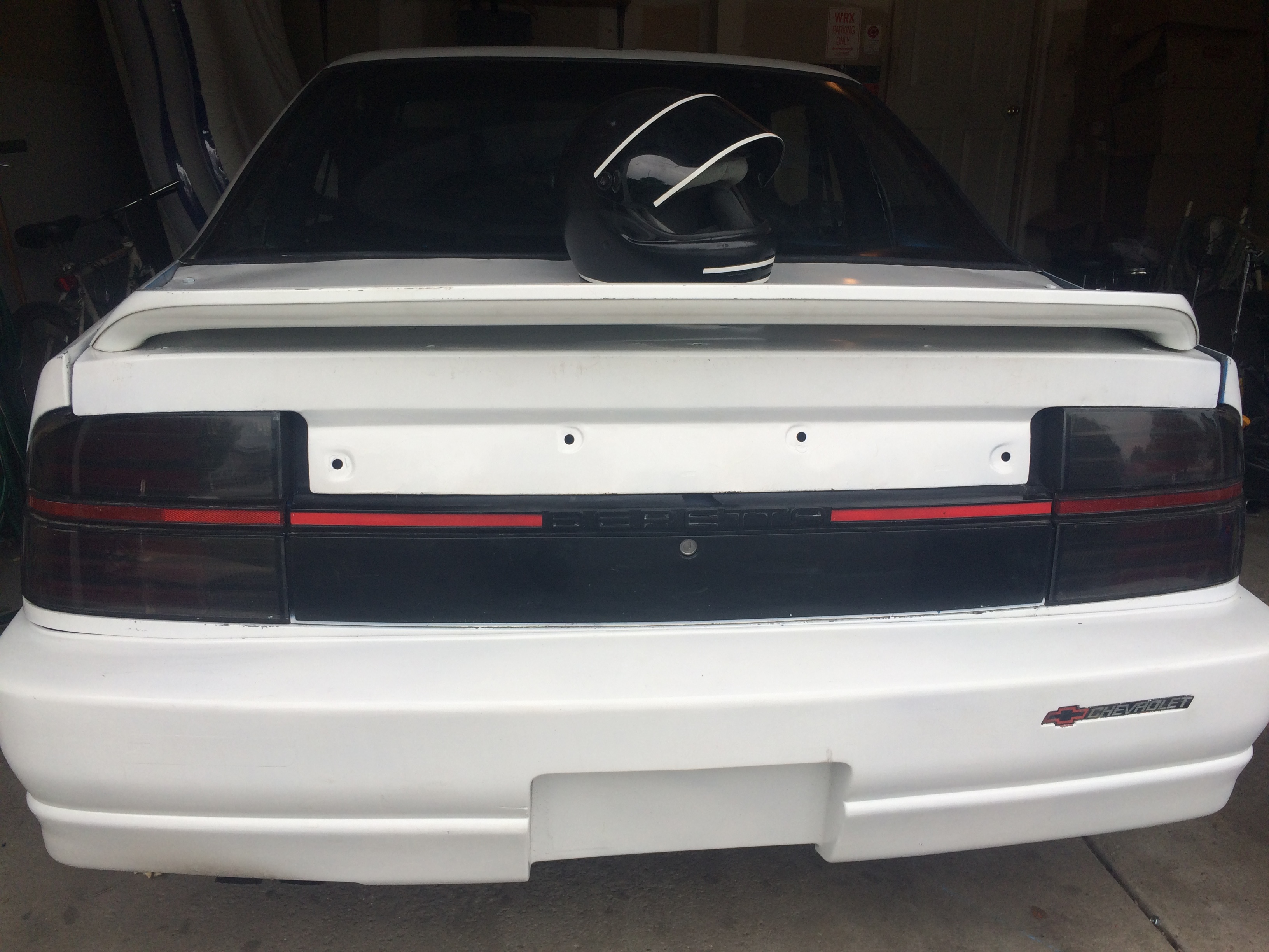

Dostom
Posts: 12
Joined: Sat Apr 22, 2017 7:07 pm
Re: Beretta 2017 Autocross Spec D-prepared
Post by Dostom »

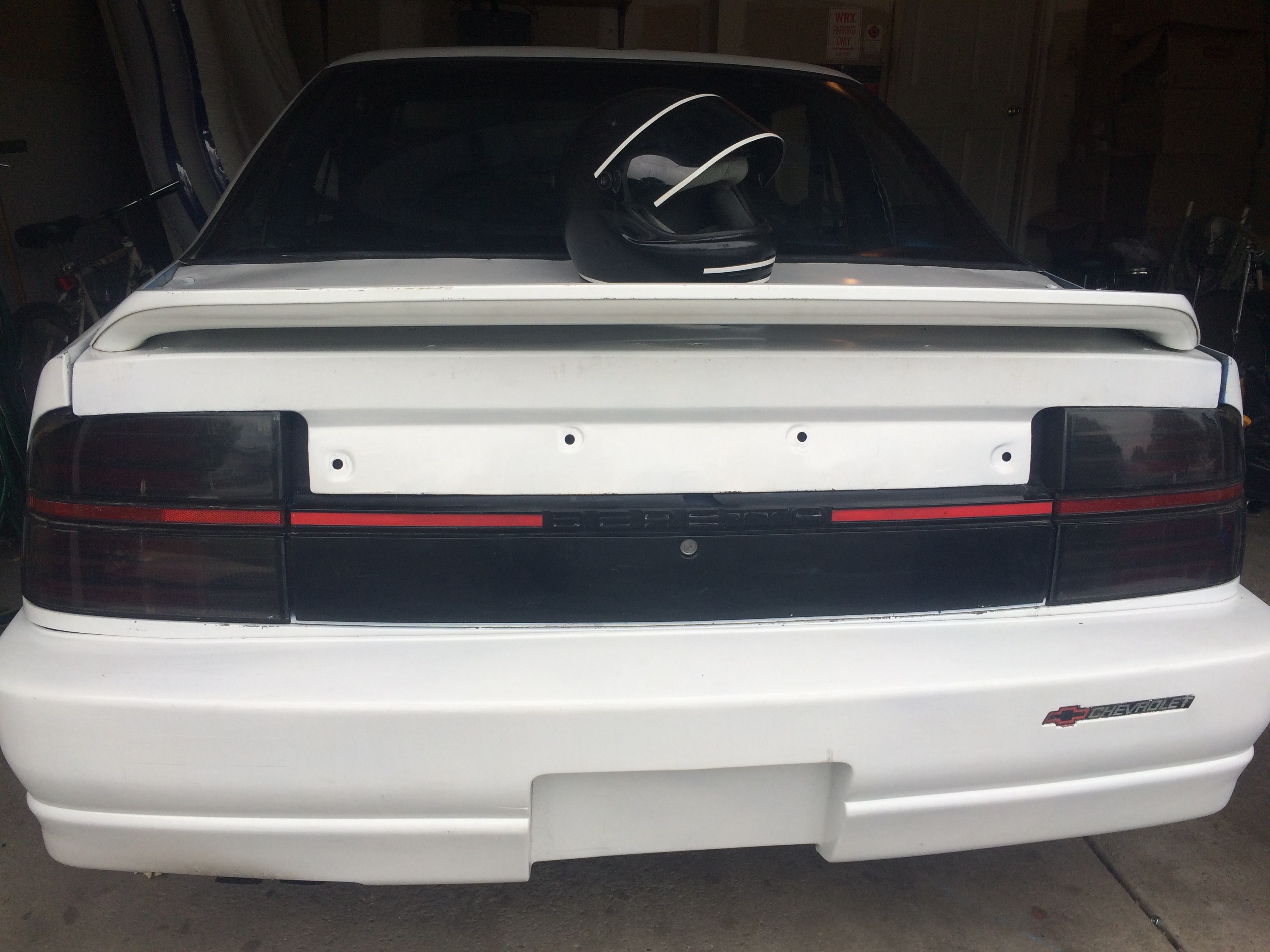

I don't know whether to post here or create my own thread, but I am the new owner of this beretta, since owning it for about a month, I've put in a racing seat, harness, new spoiler, did some touch ups and installed a front tow strap, I have big plans for this car, it will continue to be an autocross car and maybe more! I love this thing, and the history behind it, I've only had it for about a month so I haven't had a chance to do much, but I have big plans
(I've added a 2000 mustang spoiler, did some paint touch ups, restored the badge and removed some duct tape)

No problem with keeping the info in this thread :) it only makes sense.

Turn signals going back in? Extra support for the lip coming too?

Definitely want to add some extra support for the front lip, was also thinking of doing a front splitter, have a template mocked up from my last Beretta so I'm sure it wouldn't be too hard to make one,
As for the turn signals, they were in when I bought the car thankfully

Dostom
Posts: 12
Post by Dostom »

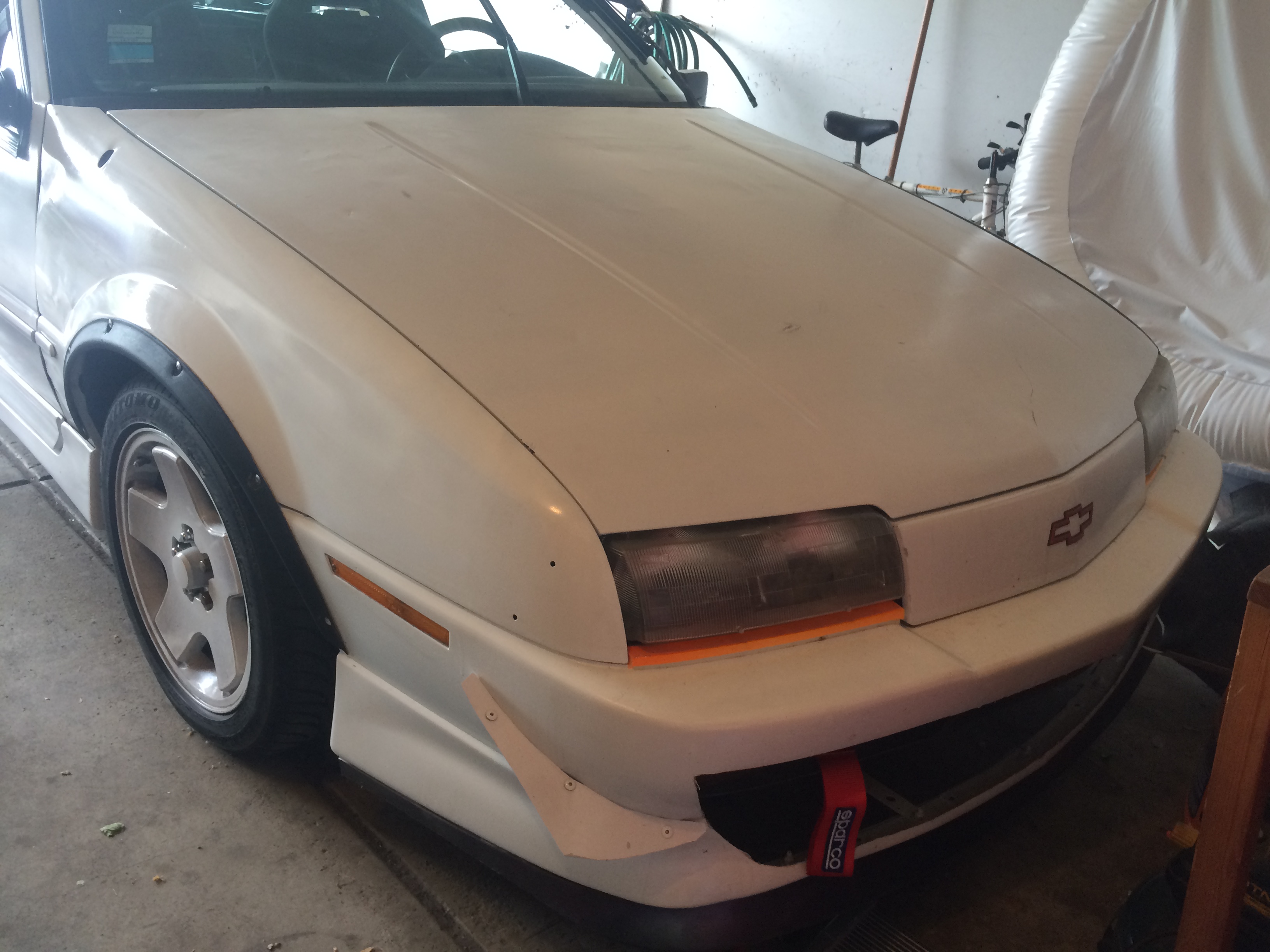

front tow strap is on the car, I'm trying to figure out how I'm going to mount the front splitter, as for the back the next thing I'm going to do is space the trunk to sit flush, since it's bolted on it sits lower, and I'm sure that's why he removed the back panel, i'm getting a "new one", fixing the fitment and putting it on
Other plans for the car are rear disc brake swap(from a neon), 4 point roll cage so I can safely run a harness(as you can see in this thread it has no airbags, and the door has a crack near the seat belt mounts, id feel safer with a legit harness to go along with my new seat :) )
I'm putting blast pipes on with a magma flow muffler, I had them on my last beretta and i think they look and sound badass(but going from a 3100 to a 2.2 I'm not sure how these sound with exhausts) hopefully I can run a full exhaust at some point soon too
Future plans for the interior are custom lightweight panels, paint, and the roll cage
I also want to lower another inch and get some wider wheels for it

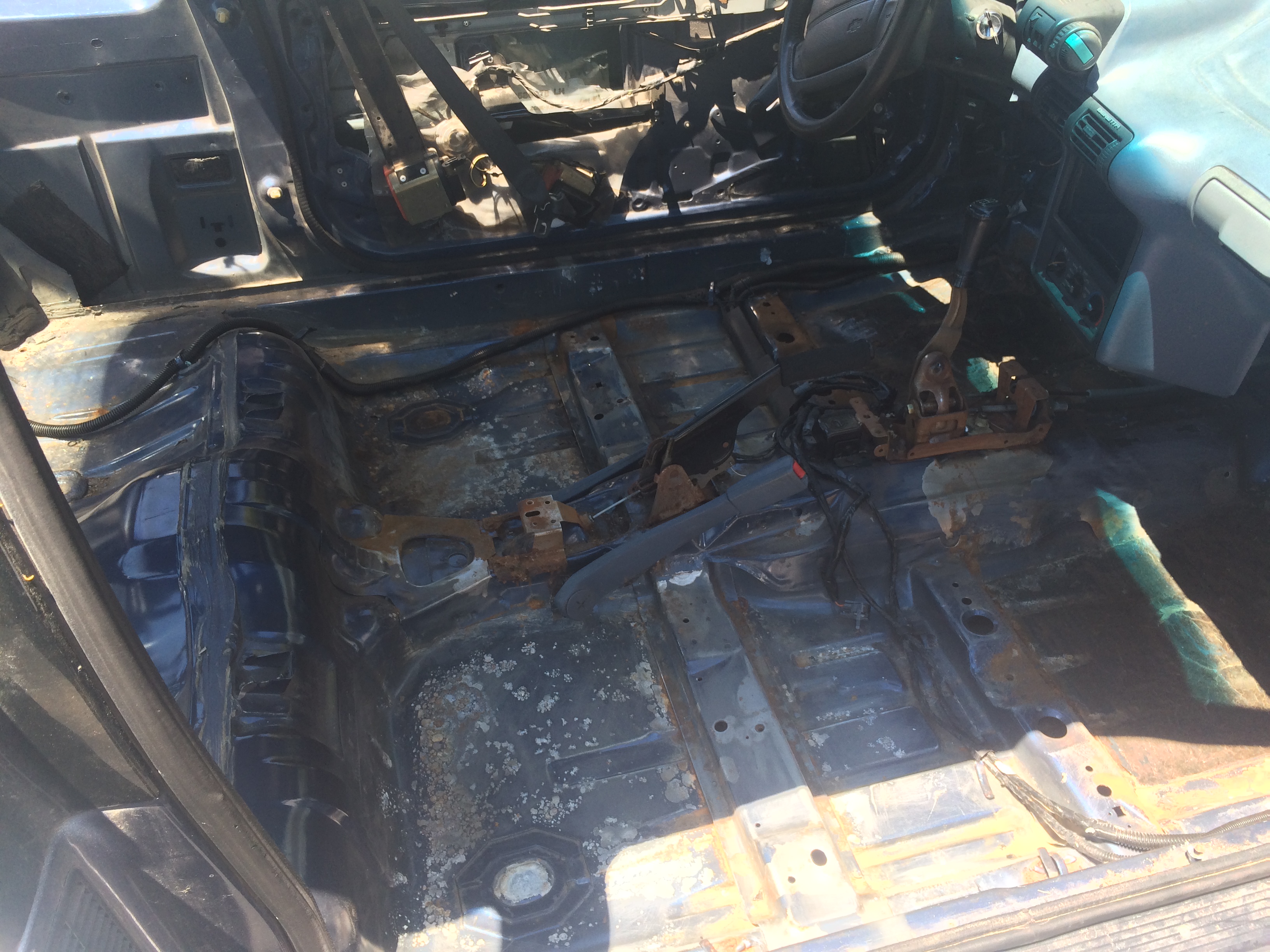

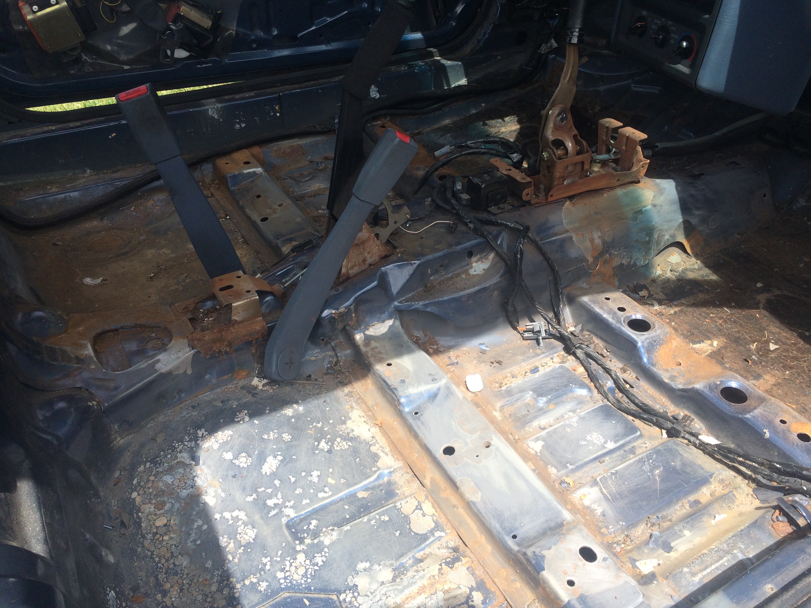

Dostom
Posts: 12
Post by Dostom »

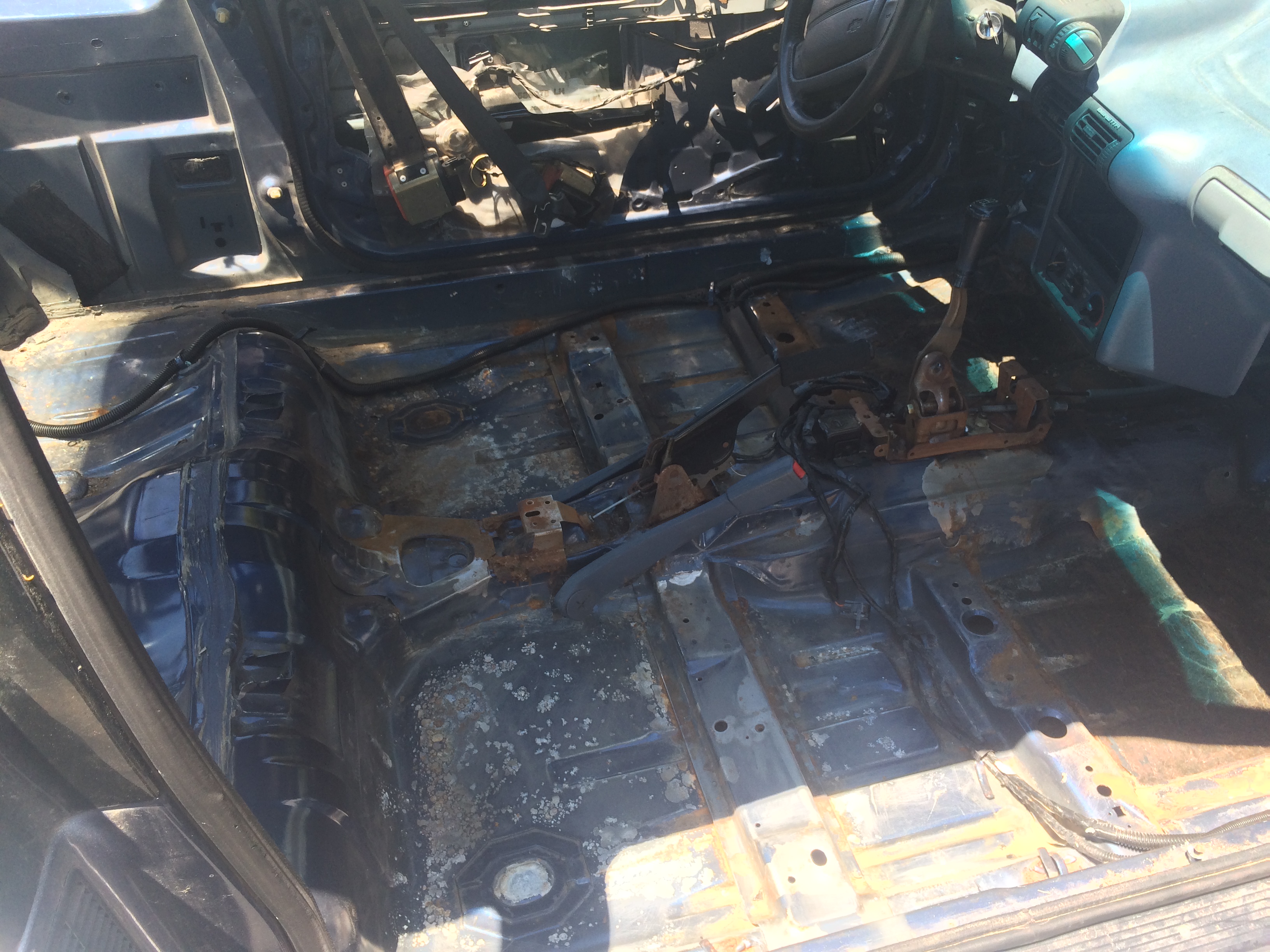

started prepping for the interior paint, i'm going with a gloss black, hiding all the rust and rough metal, also going to use a "rust" primer because there's way too much rust and it's a cheap and effective option, to avoid having to mask everything off, I found that using a brush works fairly well, so I'm going to give that a shot
