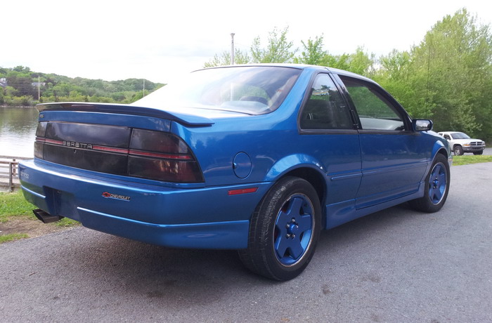

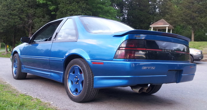

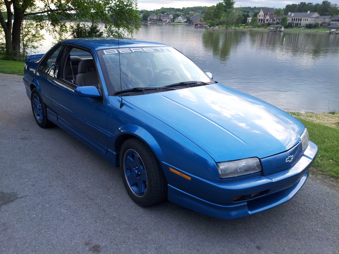

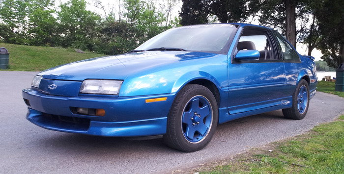

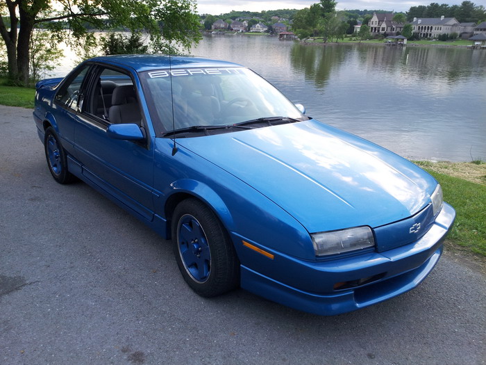

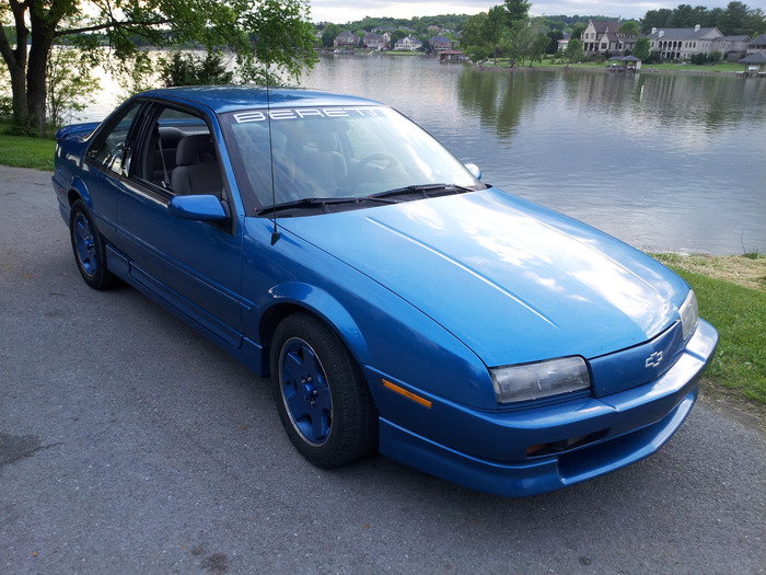

I finally got the correct jackshaft and got everything put back together. I still have an idling issue, but the car is semi-drivable. Parts still needed:
Correct 92+ axles
New wheel bearings (old ones are toast)
alignment
Still need to correct alignment on downpipe
Check/top off fluids
Send HO injectors off to be refurb'd and replace the SOHC ones that are in it now
Bolt on rear license plate
Needs shocks/struts pretty badly
The car has NO power with the SOHC injectors - I figured it wouldn't but I went ahead and used them to get the engine running so I could send the HO's off for service.
My first trip, a quick run to the lake - It feels good to have ~10 miles on the car now!
