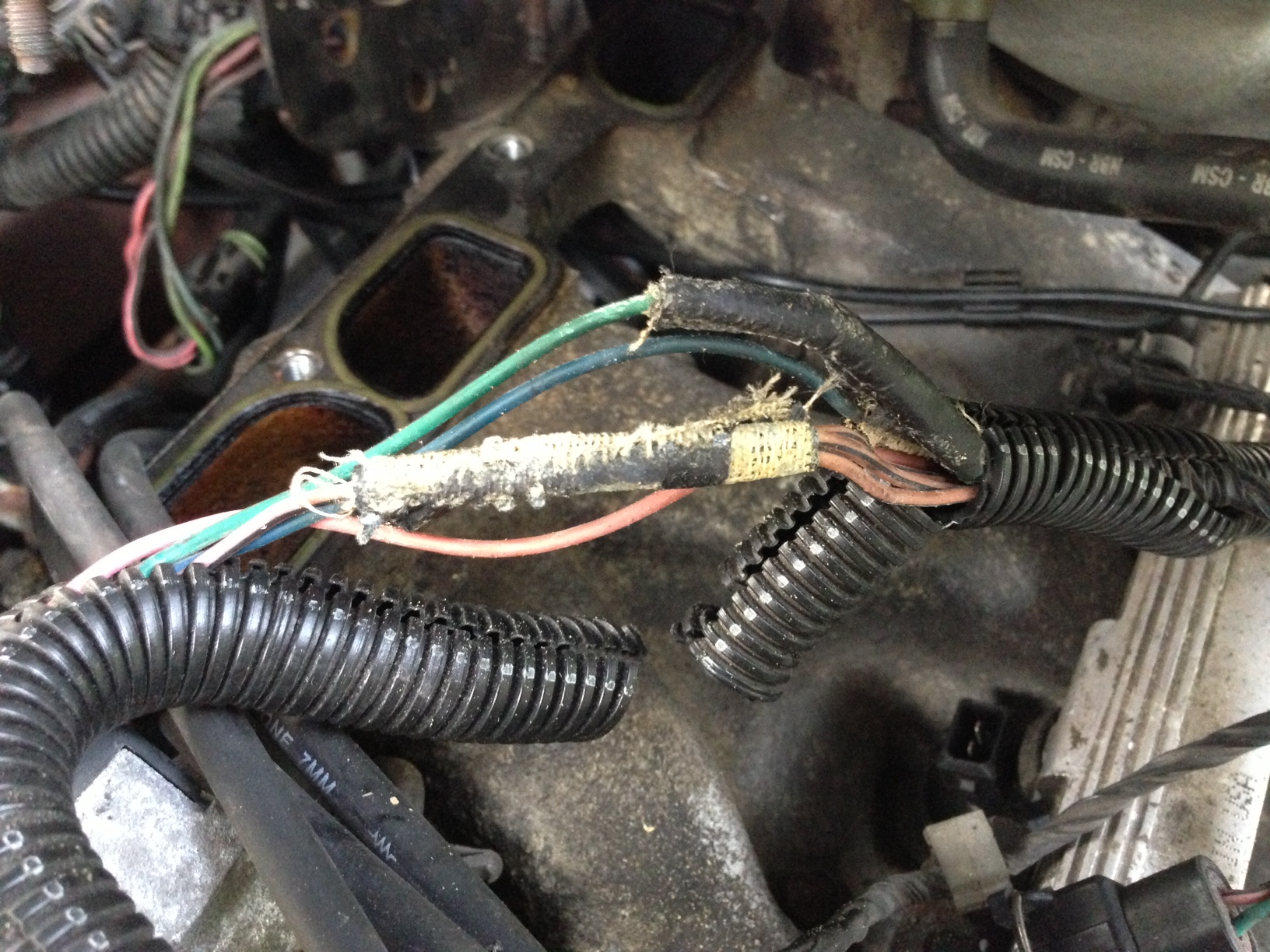

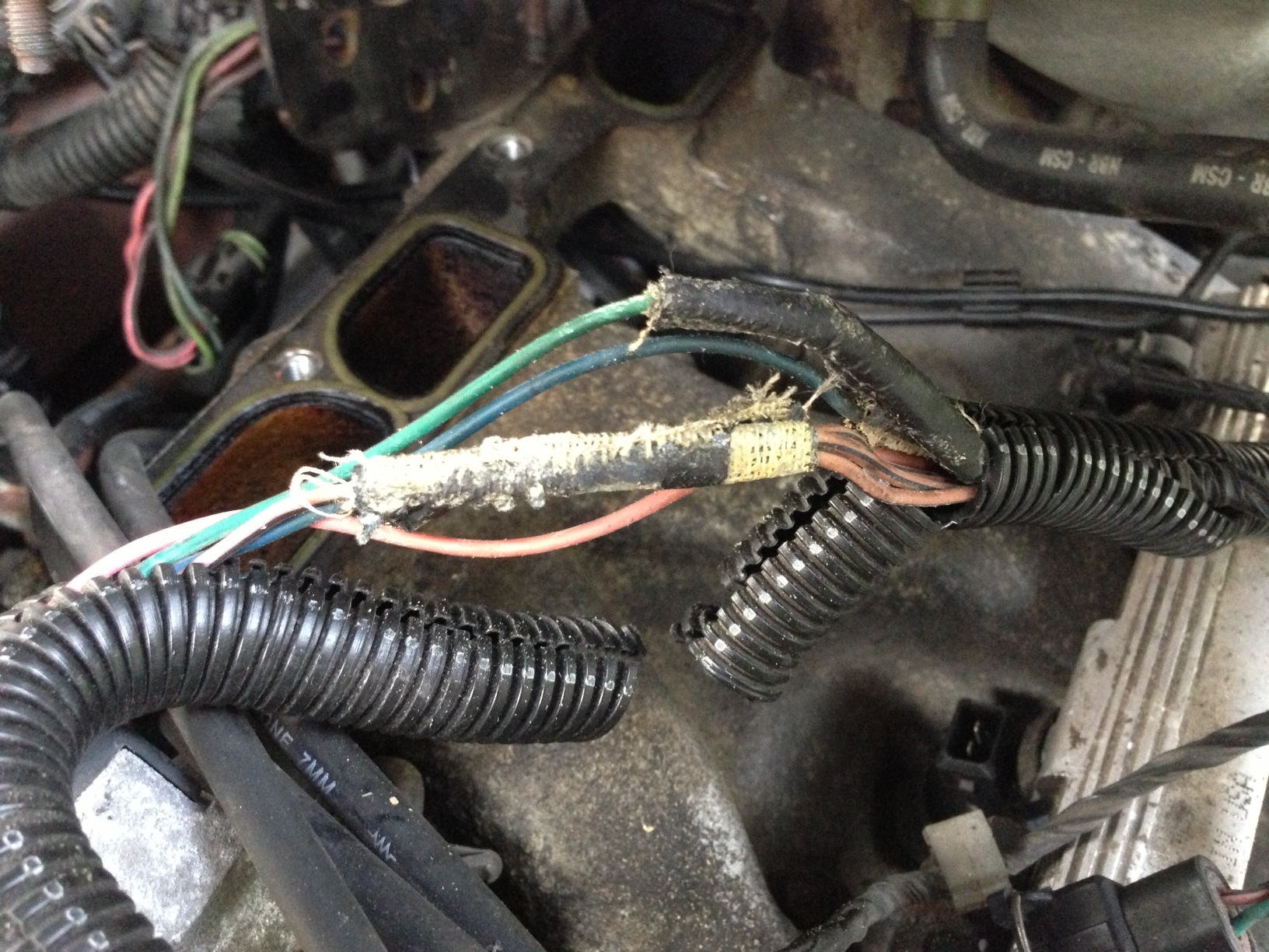

My injector harness looks like it was modified at some point but I checked with someone else and I guess this is factory. I tested to be sure there was no shorts in this cable. It seems the front 3 cylinders are wired parallel and same with the back 3. From what I have read in the manual this is accurate.

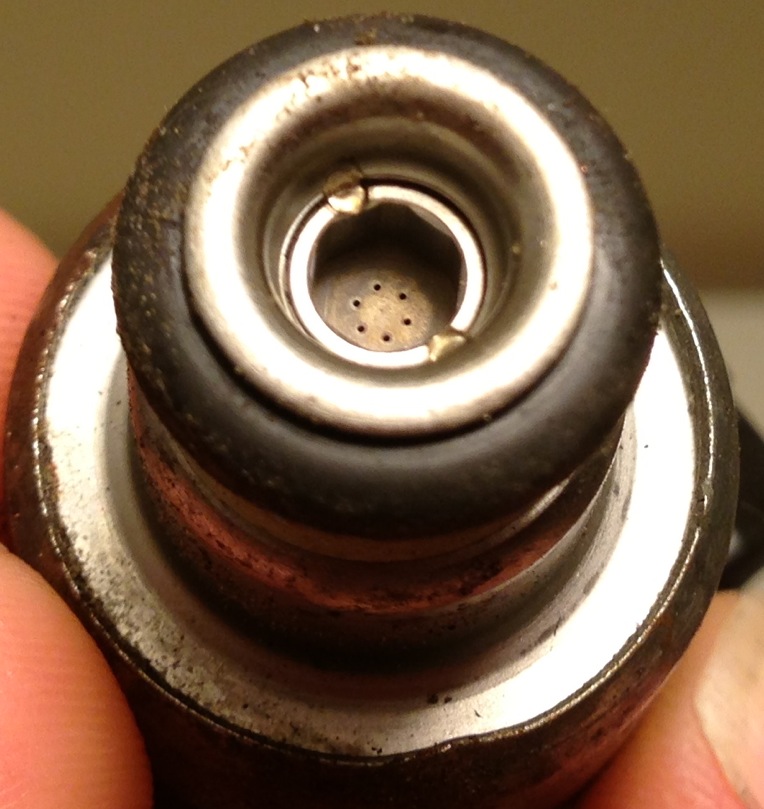

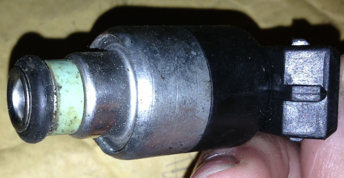

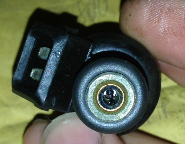

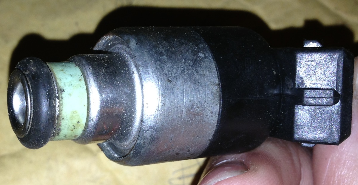

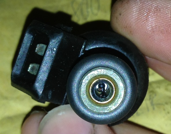

changed out the injectors with the originals and the car is actually better, i got about 100km more on my last tank of fuel. it has changed the way the car sounds when its missing. something else interesting about this is the set of flow matched injectors that i got were actually quite different looking that what was original to the car. I am surprised that I didn't question that before installing. I am on the hunt for a set of 6 working injectors, may just end up taking them off my running 2.8 for a test.
Here are the ones i took out
Re: rich smelly and farty
Those look like 3100 injectors, but that should be fine for that engine.
