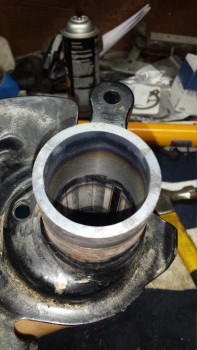

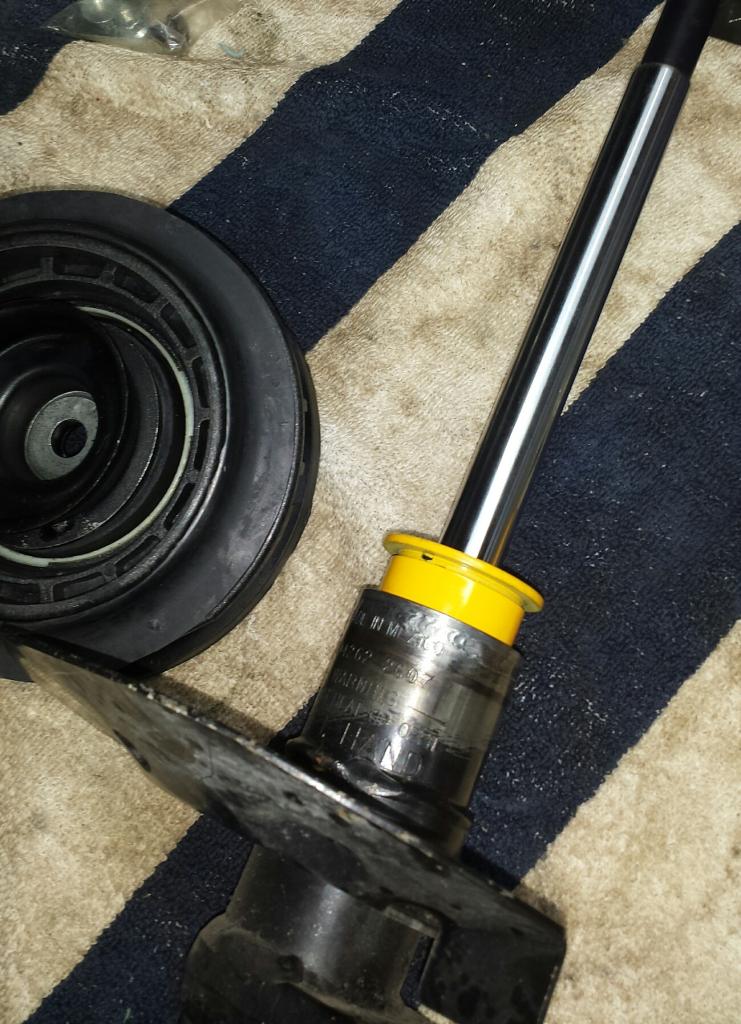

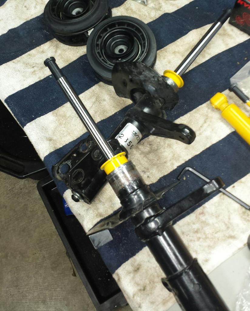

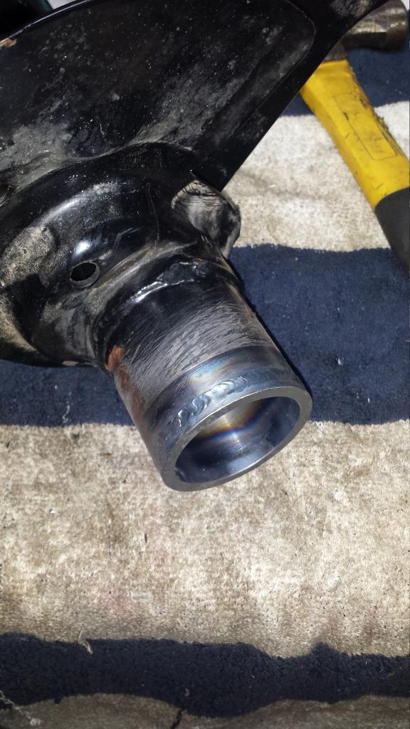

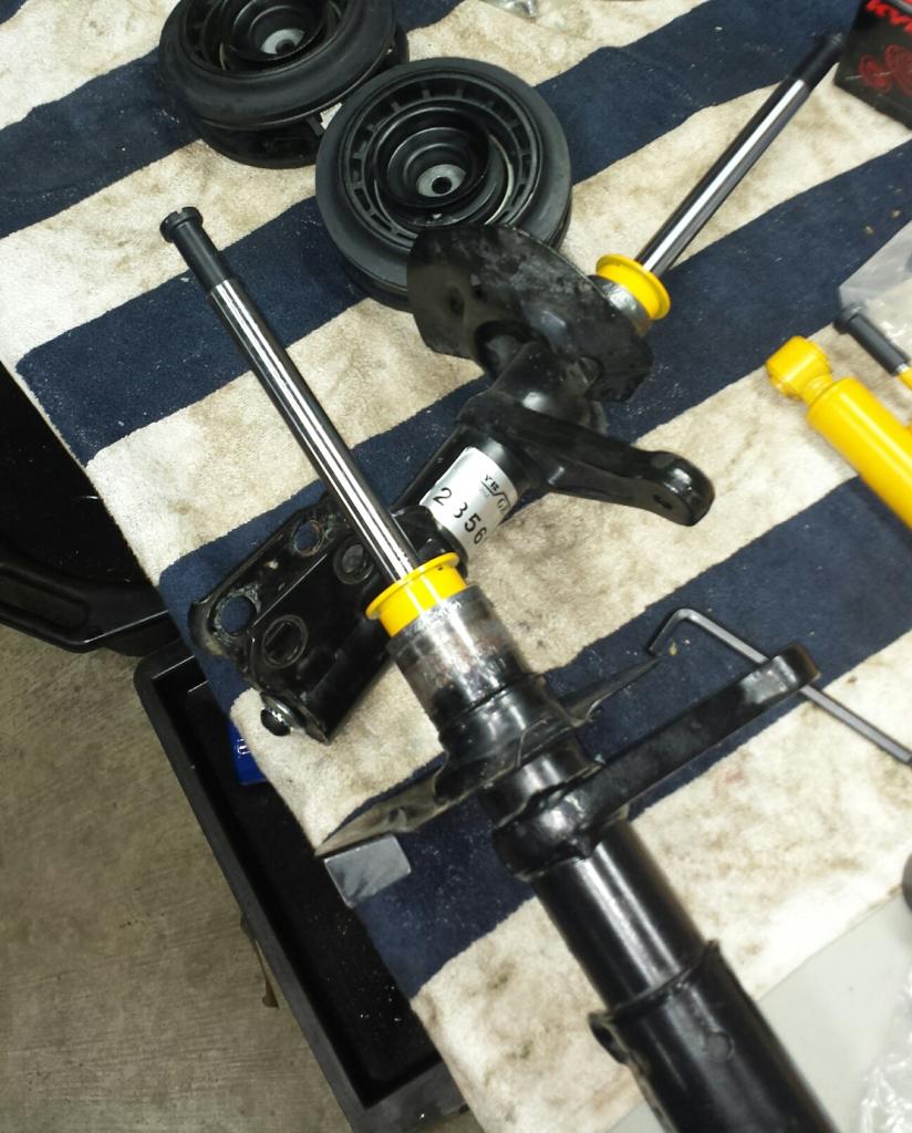

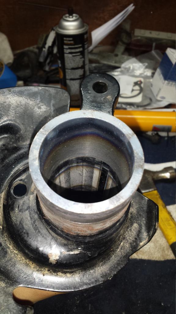

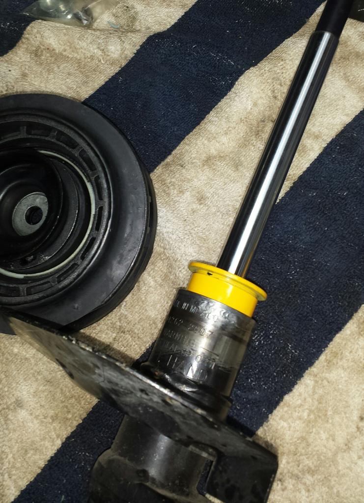

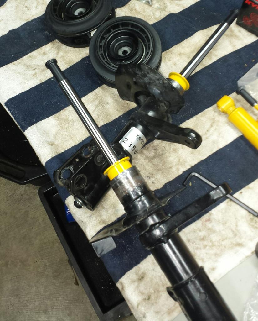

I'll see what he's got for time, I think switching to steel bushings will be the best because they wont have to be made specific to each shock like I did before since you can tig or mig them into place, mine only have the centering bumps on the tube holding the insert down in the strut housing, there is a step milled on the inside of the bushing on top to do that.
Well here is the steel inserts welded in with a set of Koni's unfortunately these are the Jbodys so I don't have Mitsubishi ones to try and make sure they fit.
