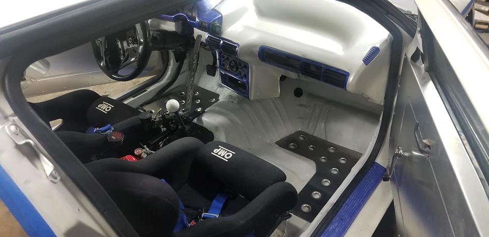

was able to get these awesome heel plates for the floor pan of the Z28 Beretta made.
looking super fresh and functional !!!!! No more melting shoes and burning heels for myself or my passengers.

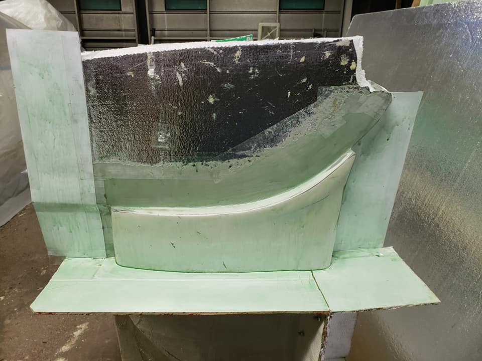

. Top return flanges cast. And just have to cast around the wheel well.
Was a little worried about the part getting die locked in the mold so I made it a 5 piece mold.

5 piece rear bumper mold is done. Finally .....

Now we are finally ready to start on the wide body fenders. With all the body panels I have mounted again I can actually start on the wide body fenders and quarter panels.....the Beretta has bumpers again. Finally finished creating the molds for these bumpers and was able to put them back on the car.
