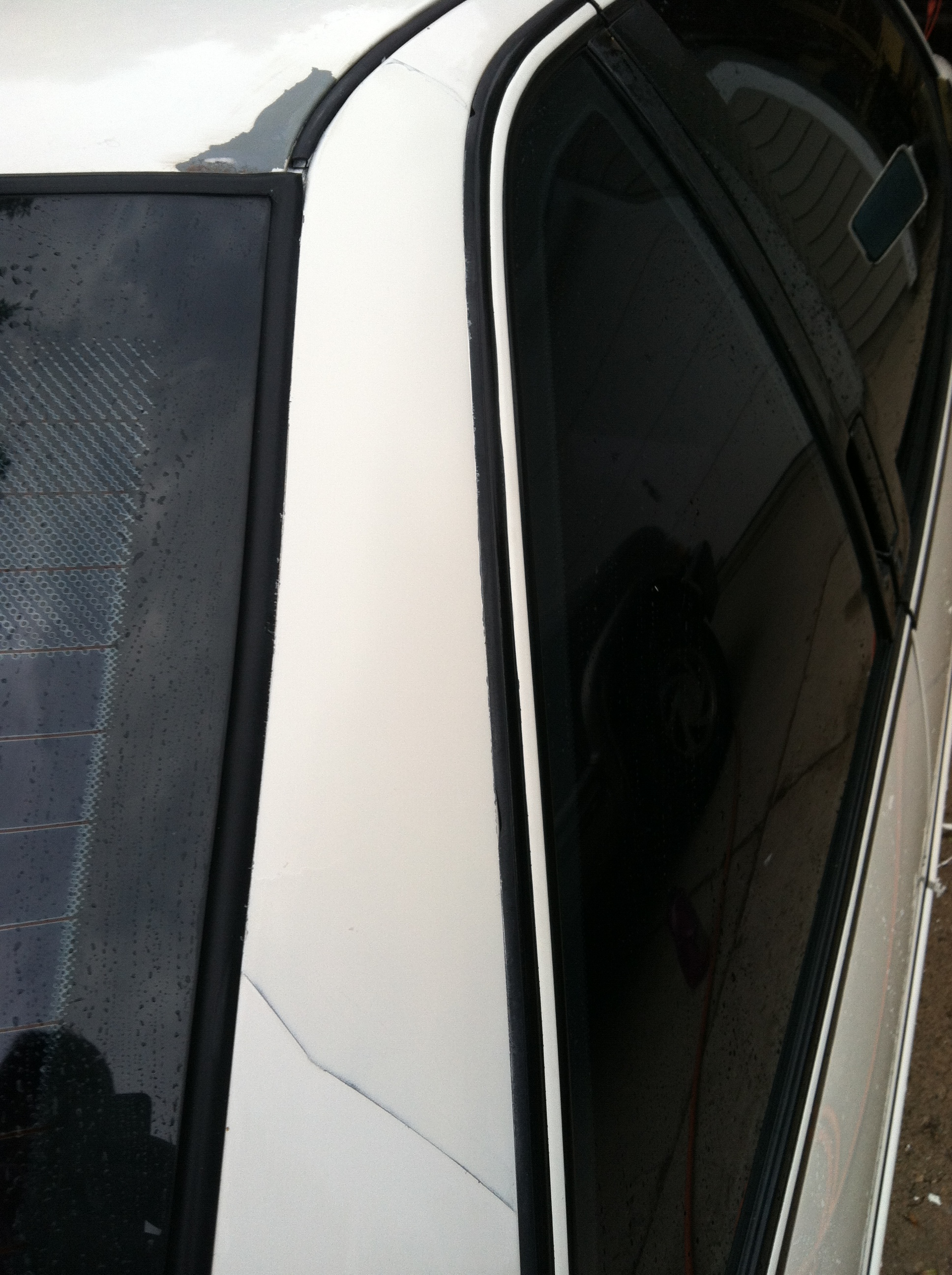

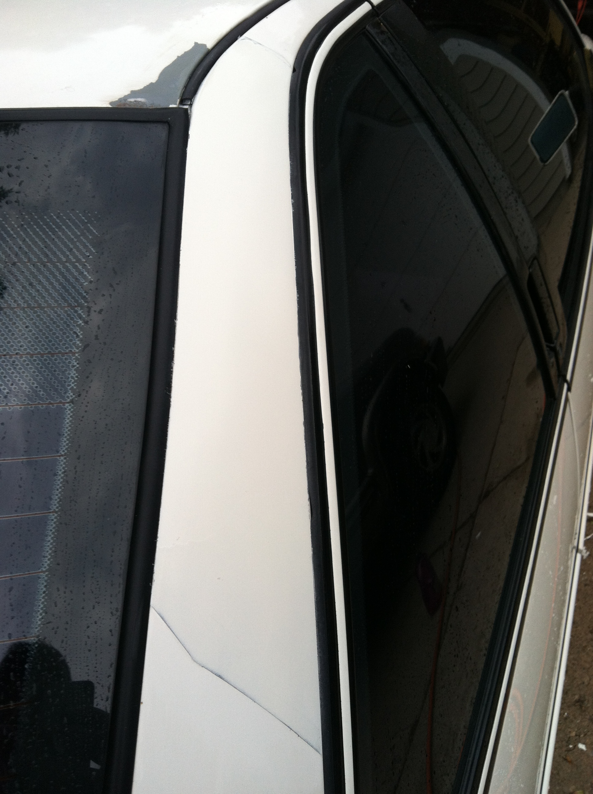

Just trying to make the care look one color again, and to prevent (attempt to) further paint from escaping the confines of the body.
