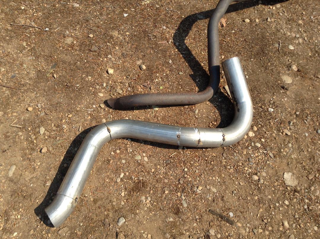

If you swap the muffler, SAVE THE TIPS, if nothing else (heck, if you don't want 'em, I'll buy them from you! :wink: ). I put a Flowmaster under my Turbo 3.4 LQ1 '95 Z-26, 3" mandrel-bent pipe all the way from the turbo's outlet flange to the inlet of the muffler, 2.25-inch mandrel-bent pipe out each side (dual outlet muffler, very odd with a single 3" inlet and dual 3" outlets...) of the rear bumper, and the thing was too loud and sounded only better than terrible. I welded two of those twin-tips onto the ends of the pipes and it saved the car -sounds great and much quieter. Those are decent resonator tips, plus they look awesome, and the four outlets flow the same volume as two 2.25-inch pipes, which flow the same volume as a single 3-inch pipe, so it was perfect for me. :) Glad your car is coming back together for you.

Rettax3 wrote:If you swap the muffler, SAVE THE TIPS, if nothing else (heck, if you don't want 'em, I'll buy them from you! :wink: ). I put a Flowmaster under my Turbo 3.4 LQ1 '95 Z-26, 3" mandrel-bent pipe all the way from the turbo's outlet flange to the inlet of the muffler, 2.25-inch mandrel-bent pipe out each side (dual outlet muffler, very odd with a single 3" inlet and dual 3" outlets...) of the rear bumper, and the thing was too loud and sounded only better than terrible. I welded two of those twin-tips onto the ends of the pipes and it saved the car -sounds great and much quieter. Those are decent resonator tips, plus they look awesome, and the four outlets flow the same volume as two 2.25-inch pipes, which flow the same volume as a single 3-inch pipe, so it was perfect for me. :) Glad your car is coming back together for you.
I understood almost none of that. All I know is that when I bought the car. The muffler leaked, so the guy i got it from replaced that part for me for free and he welded the original tips back on I've been meaning to polish them for the longest time but just havent gotten around to it haha. If I do change it, definetly going to keep those. They just complete the car. But I'm excited to drive it again. I just have to hook up all the coolant lines, get some wheel liners in, exhaust, wheels, hood and them I'm good! Hopefully

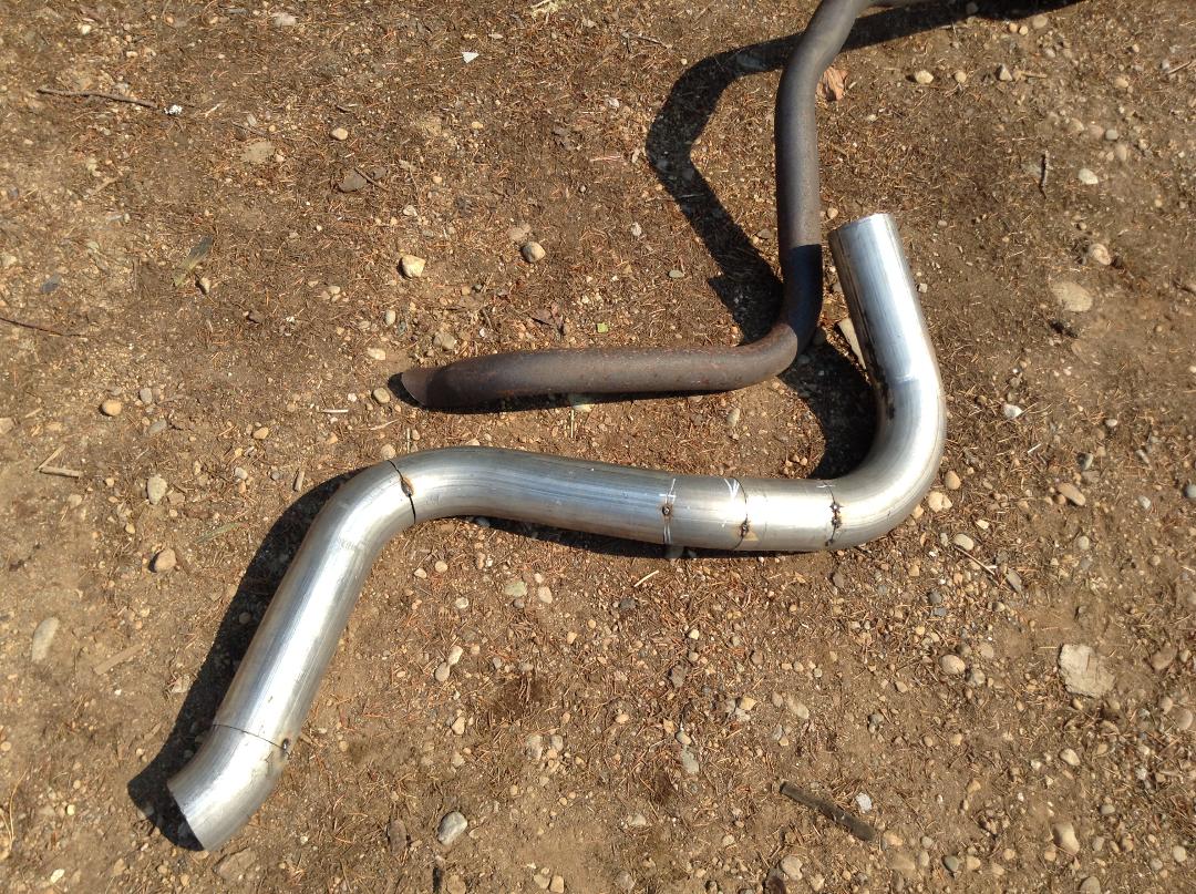

The pipe I used on my '95 Z vs stock.  "Mandrel-bent" is a machine/process that does not crush the pipe in the bend, so the radius stays constant throughout, thereby preventing restriction.  3" just equals big for exhaust, though nothing to brag about anywhere else in life.
