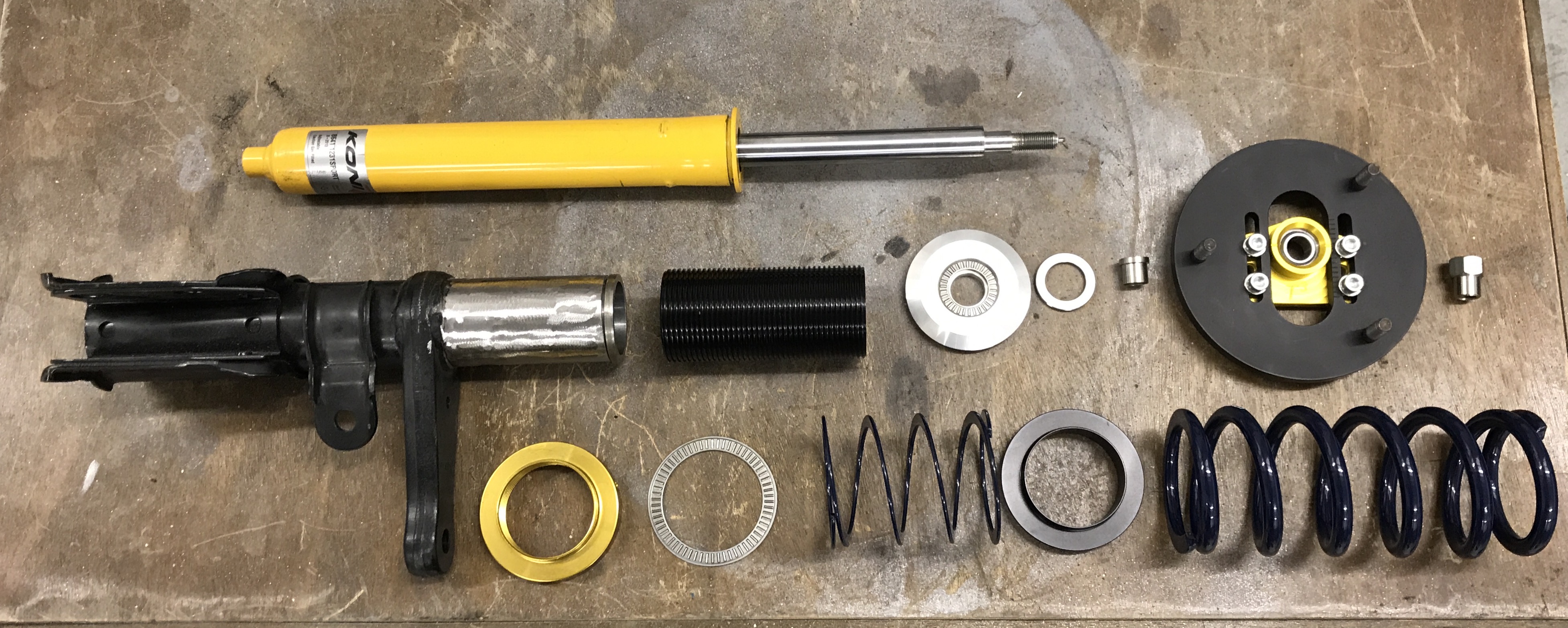

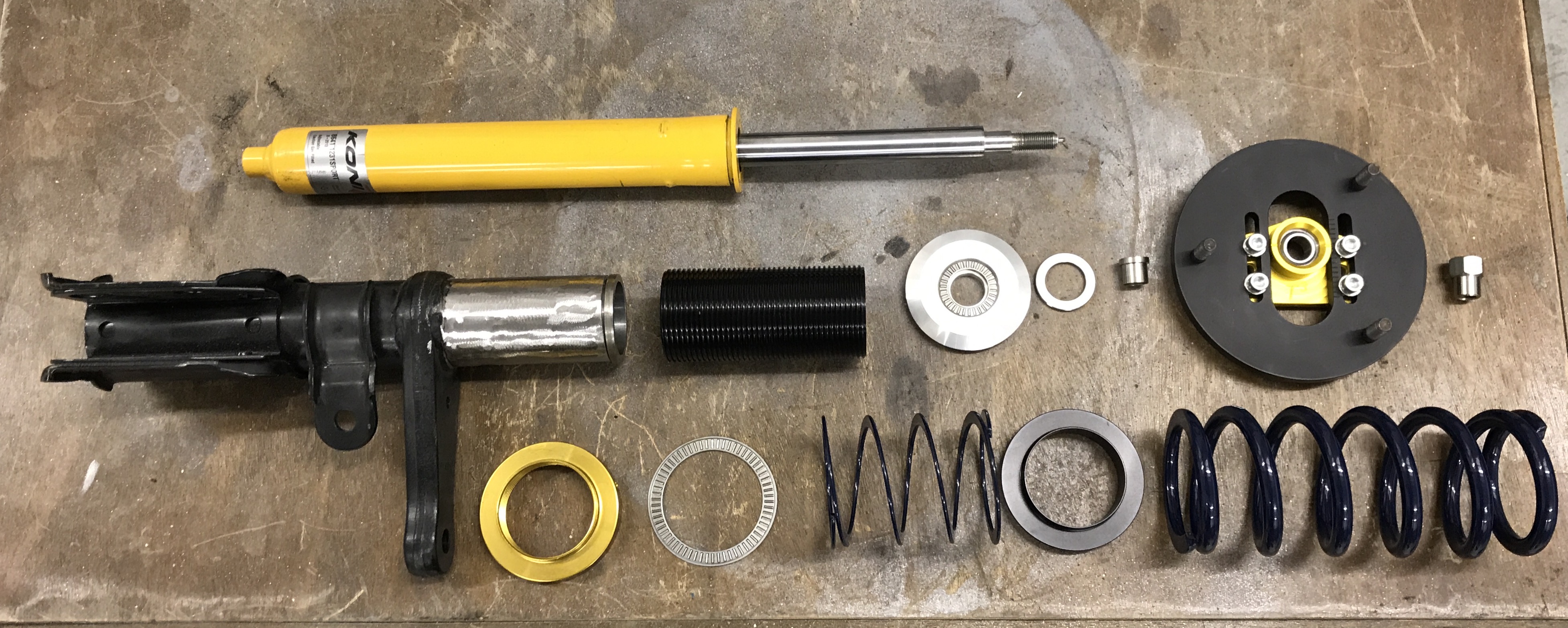

So time to bring this back from the dead... expect some updates in the next coming weeks.
But for now...
But for now...
Re: Not your average Z26... a resurrection
Does that little spring go in series with the big spring? O_oheavywoody wrote:So time to bring this back from the dead... expect some updates in the next coming weeks.
But for now...
I feel like that little spring would be flattened if that's the case.
It's a helper spring - it's sole purpose is to keep the main spring in place when you remove the vehicle weight from the assembly.
When the weight of the vehicle is on it, it will be completely flattened out.
