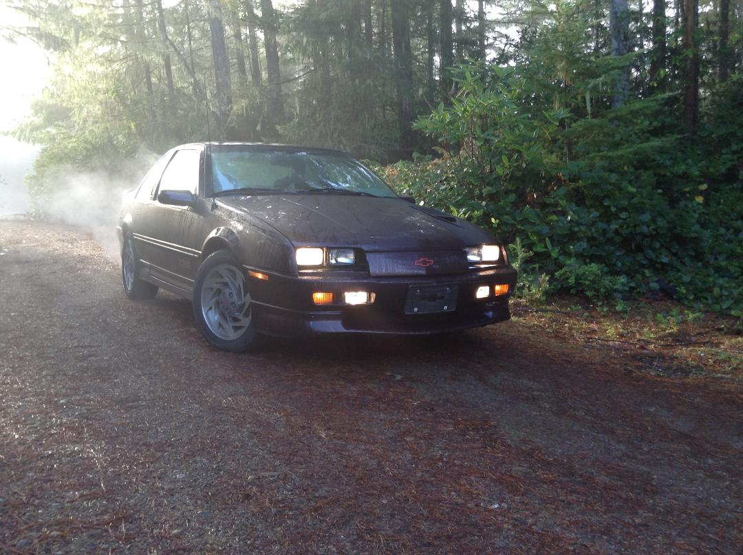

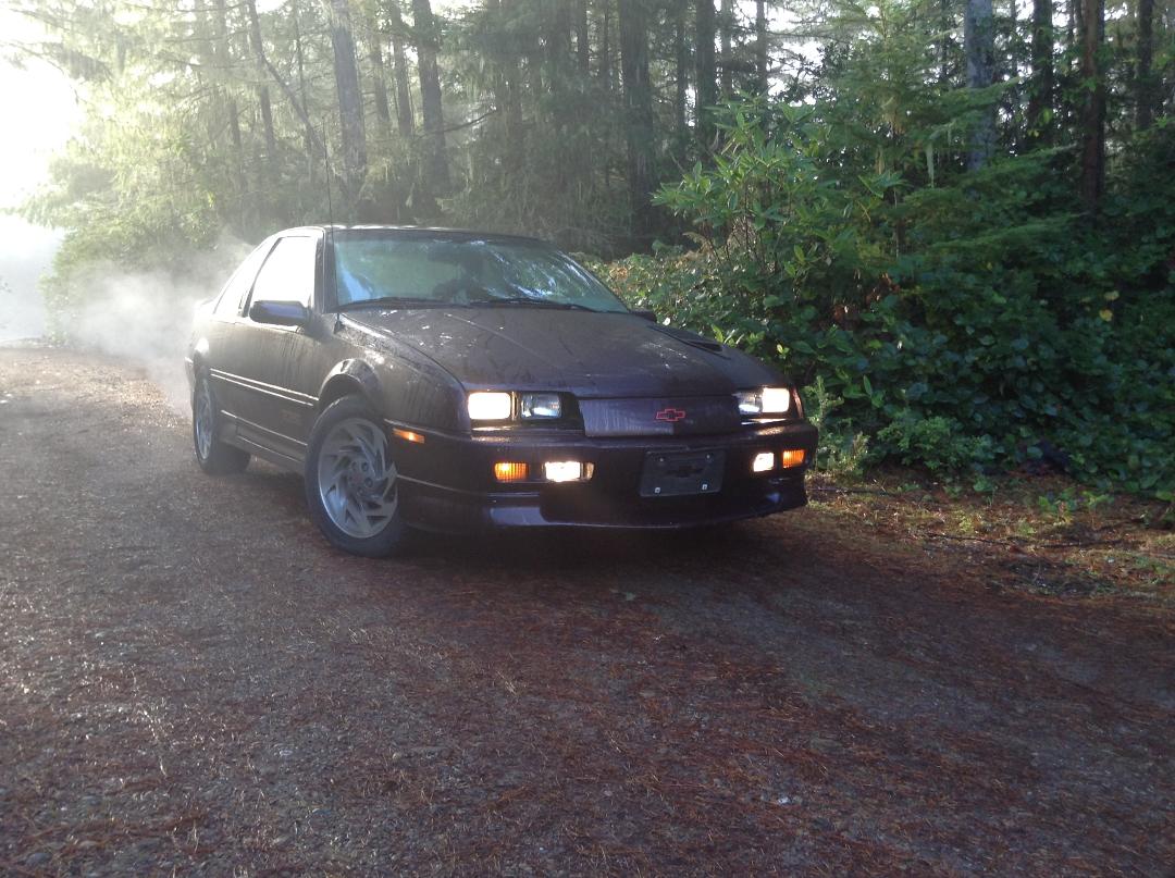

Hit the junk-yard today, not much exciting there. Good sale-day though, so I grabbed a spare E36 headlight (left side was toast, so I only have a spare right). Since the BeeMer lights didn't fully pan-out, I walked through the Chevy truck section, and grabbed the headlights off of an '88 1500 -the four-light option. These are either the same sealed-beam bulbs or so similar to the Beretta Euro lights that I couldn't tell the difference from ten feet (H4701, H4703, low and high beams). I think they will go in the Turbo Z-26, but I will retain the Z04 grill on that car. The egg-crate, especially modded like Jon's with every other horizontal slat removed, looks so aggressive, but I want to retain a little more of the Z aerodynamic look, and I have egg-crates on a few of the other Berettas still anyway. The lady at the counter is starting to recognize me now
and only charged me for the trim-rings around the sealed-beams, instead of for the whole housing and mount. $1.97 each...

The lights look good, they kind of match the separate turn/fogs in the bumper on the Z's.Rettax3 wrote:Got the idle issue straightened-out over the weekend, learned a thing or two I should have already known. The 'spare' TPS I had was from a TBI unit, from a slightly earlier V-8 car, BUT it turns out that while the housing, plug, and angle for said plug is a perfect match to the LQ1, it rotates in the opposite direction... So that didn't work. The previous TPS I had on there is CLOSE -but the pigtail plugs in straight, rather than at a very slight angle away from the throttle-body. It does fit okay, but a thin O-Ring attached to the back makes it perfect. I tried to snap a couple of shots of the Euro-like lights, but they came out pretty bad. The lights actually look pretty decent on the car tough, and once I install some buckets around the assemblies, they should look about right.
