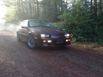

Got the idle issue straightened-out over the weekend, learned a thing or two I should have already known. The 'spare' TPS I had was from a TBI unit, from a slightly earlier V-8 car, BUT it turns out that while the housing, plug, and angle for said plug is a perfect match to the LQ1, it rotates in the opposite direction... So that didn't work. The previous TPS I had on there is CLOSE -but the pigtail plugs in straight, rather than at a very slight angle away from the throttle-body. It does fit okay, but a thin O-Ring attached to the back makes it perfect. I tried to snap a couple of shots of the Euro-like lights, but they came out pretty bad. The lights actually look pretty decent on the car tough, and once I install some buckets around the assemblies, they should look about right.
EDIT: There, that is better!  Much better pic than the other one...

The lights look good, they kind of match the separate turn/fogs in the bumper on the Z's.
