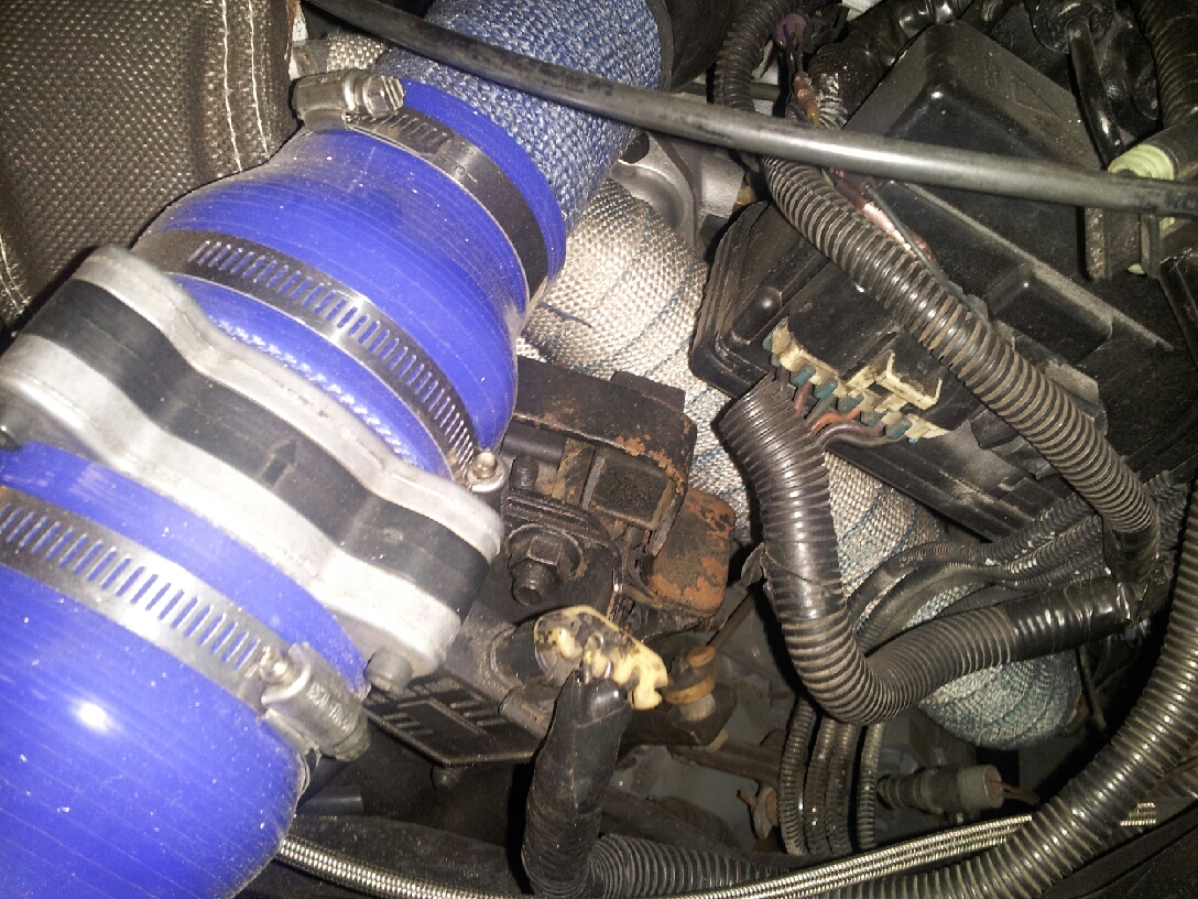

How it looks now (I took this picture 12/18/12)
There's probably more that I'm forgetting. I by-passed the heater core and drilled the t-stat to help prevent bubbles (Superdave had this issue). I used a 2005 equinox thermostat housing because it was straight and not curved. I also put in a 2001+ starter motor because it's a lot smaller. And of course I used 2 step colder spark plugs. I will update as I go along and feel free to ask lots of questions. Also heat wrapped everything and a turbo blanket. And after I rebuilt the trans I painted it industrial gray for Jon ;).
