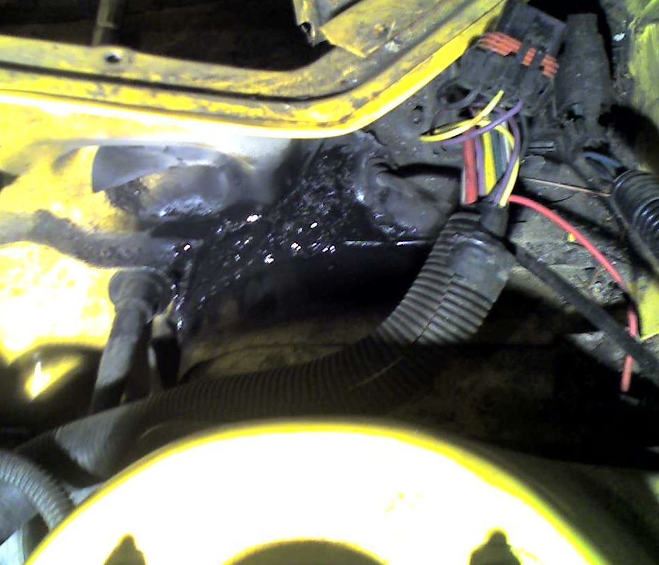

I just bought my fifth Beretta a couple of weeks back -a yellow Indy. It is the first one to have the firewall-leak issue, and it is in the exact same place you are describing.
Remove the driver's side wiper-arm and cowling to access the wiper-motor drive-arm, pull the wiper-motor. This will give you all the room you could need to fix the problem. Then, cut the sound-deadener/under-dash insulation to access the other side of this seam.
Use whatever tools you need to scrape-away the old sealant -I used a cheap dental-pick, various screw-drivers, and a 3/4" wire-wheel on the end of a Dremel to clean mine perfectly down to the primer.
My car had better than a 1/8" gap in areas between the sheets of metal there -just crap IMO :x . I welded the $%!t out of mine and primered it, re-scraped/chipped any sealant damaged by the heat, and I am now sealing it up again with rigid silicon under either flexible silicon or possibly butyl-tape (this is the tar-like substance used on old car windows -it stays sticky and flexible for literally decades -a good example is 3M's "Windo-Weld Ribbon Sealer" -why can't they just spell 'window' correctly? :fool: ). I will then seal it again from the inside with epoxy and possibly more butyl-tape (available at most automotive stores). I might go cheap and use a household construction-grade sealer, but I loaned both my caulking-gun and tube of sealant to a friend who wanted to seal his truck-bed in a few joints, and I trust the butyl-tape to stay there permanently.
Just skip the welding part if you don't have the equipment, time, or desire to do so. For my car, it was a little more important to weld it up because of a couple of stress-cracks that I wanted to cure, but I would still recommend using a flexible roof-sealer, a construction-grade sealant, or the butyl-tape over just silicon, and definitely take the time to primer it first to help keep rust from forming under your chosen sealant. Top the whole thing off with decent paint of your color choice for aesthetics and to protect the sealant and primer. Good luck.

Re: help me diagnose this moisture problem?
This seam is important as well but is like 3 or 4 layers of sheet metal all meeting at the corner.
The other area that needs something is right on the corner of the cowl to direct the water toward the drain, IIRC though if it does leak on this seam it only comes out right above the bulkhead for the wiring harness, which also may be one of your leak points.
People don't realize that the wiper cowl steel part, where the wiper motor and blower motor is bolted to does not have a seam that enters the vehicle, its simply just a piece of steel spot welded to the firewall itself. The are's of concern are the brake master cylinder mounting plate since that is glued to the firewall, and then the main seam running down each side of the engine bay as well as where the firewall meets the floor pan.
remove your wiper motor and seal the seam that is for the brake master plate, and try to check your bulkhead connection since you said it's coming down near the fuse panel.
I will say it again... the crack that he "sealed" in that website is not the one thats leaking, that seam is an external seam only..The seam of the firewall to the fender well is the one leaking, the rusty cracked area shown in his last photo.
If you look at that last photo, the first TOP most layer of steel you see is the cowl part that the wiper motor connects to, then the second layer of steel is the actual firewall to fender well, so you can see that the first seam is not the cause of the leak it will be the seam after that. The only reason why there is sealer on the inside of the cowl is to direct the water toward the drain and away from getting in that seam and causing rust. It does not physically fix or prevent a firewall leak.

those first pics of the inside firewall are definitely a prob. i pulled back the plastic cover as far as i could and that seam has about a 2 inch crack that water trickles around half way. if i can get that panel pulled down to get up there i will be sealing that side. judging by those pics in the link i will look at the wheel well area in the engine bay. i havent checked that out yet. i've only been looking under the cowl and below the drain hole.
