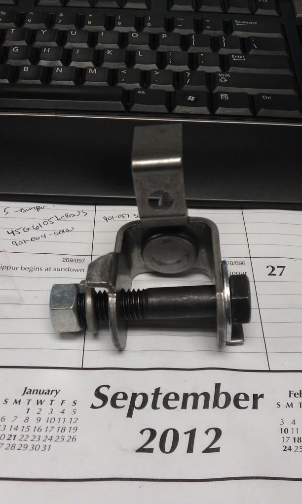

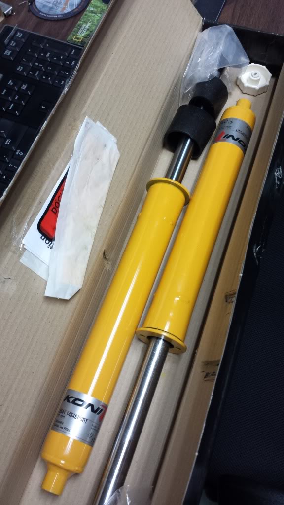

Found a new shock for the rear for 95+ cars... Verifying some info on the bottom eyelet but the only change between the saab and the new one is the bottom mount is a 14mm collar. You can either bush it to match the 10mm that comes with some Monroe brackets, or drill out the lower brackets to be 14mm and get a bolt.
The Gabriel shocks I bought to get the brackets from ended up having a 12.5mm bolt instead of the typical 10mm, so I have to braze a washer on it for the meantime if I wish to use the saab shocks this weekend. I will probably order these to replace what I have. 19.2" uncompressed and 11.85" compressed they go shorter than a stock Beretta shock so that's really good!
*Update
Lower bushing is 41mm wide vs 36mm so you will have to customize the bracket width to fit
This is the bracket I got with some $9 Gabriel shocks. Needs to be widened to fit the Koni... I will verify this is even possible tonight.
