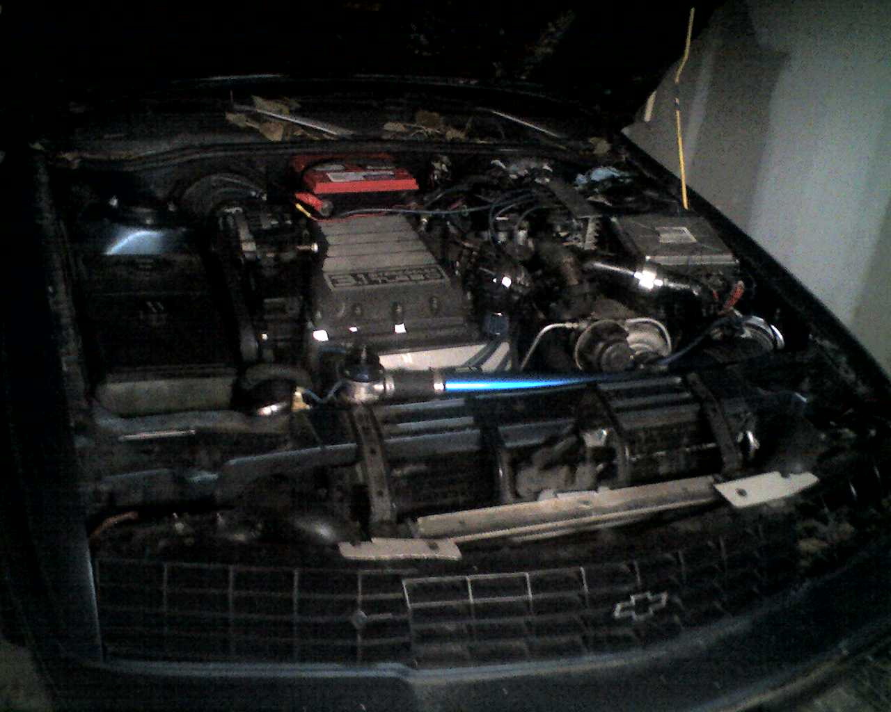

Thanks thats pretty cool.... I would be interested to learn more about the swaps... are they one some old threads? That and some pics of the engines?

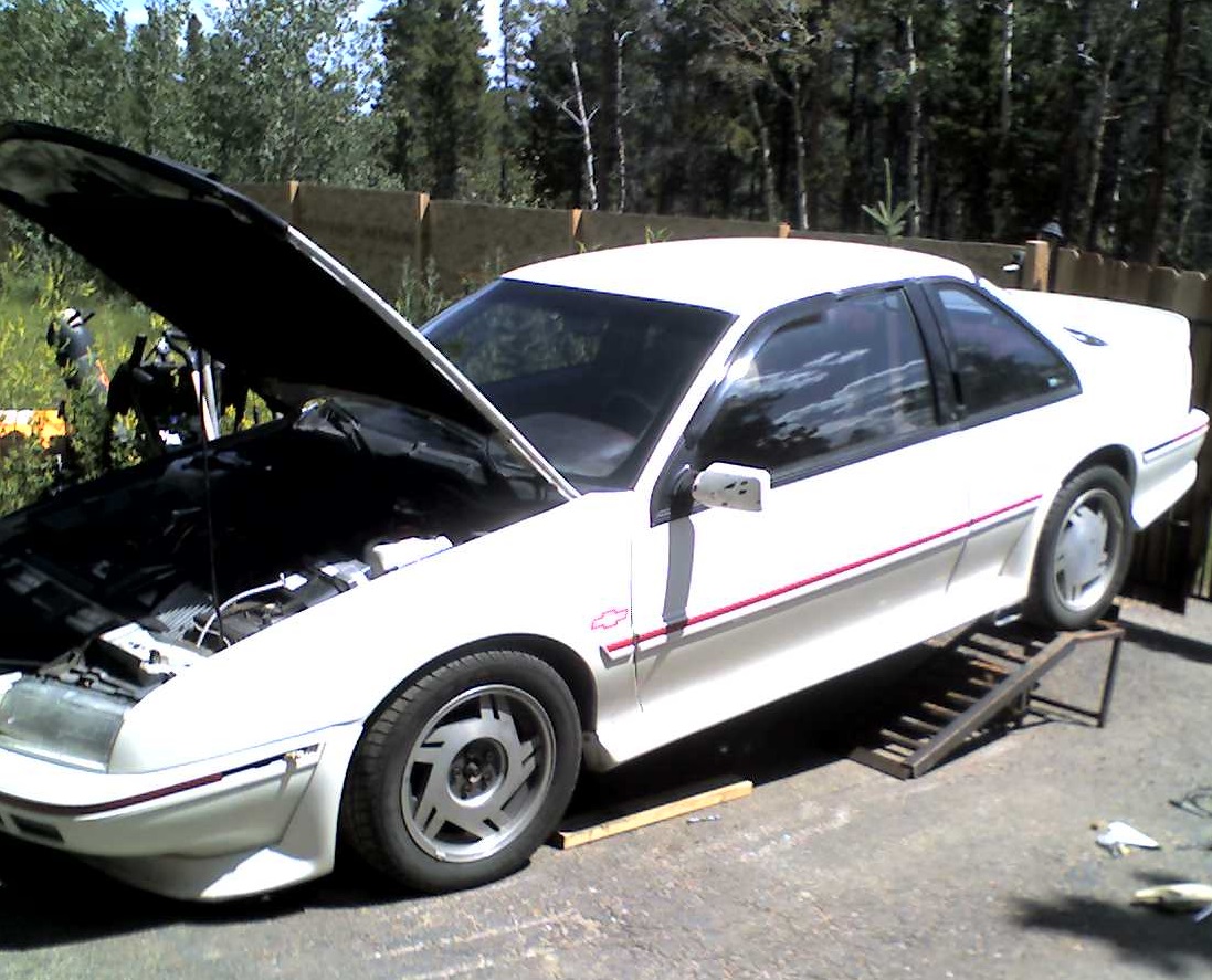

I did a full write-up on the 3800 swap back on the bstuff site, which is gone now, and I had it all stored on my old computer, which was stolen about two years ago. I can answer questions for people on it, but basically I proved the swap could be done with the tools necessary for any engine swap, a power-drill and a hack-saw (I also used a MIG welder and a porta-band, but they weren't strictly 'necessary'). I also made my wiring-harness as a plug-in to the Beretta's engine-bay wiring, so there is nothing permanently modified on my GTU, except for two holes in the right sub-frame, and one ground-wire from the fuel-pump was cut and spliced. This was not strictly necessary either, as I ran the 3800 on the GTU's stock pump for about a year before swapping in the 3800's multi-speed fuel-pump control and a Bonneville SSEi 3800 SC fuel-pump. I also cut-out some of the ground effects, where they were cracked anyway, for the exhaust-outlets, one on each side. I do have some more pics of the cars on here, I think I have some in the 'Members Rides' section.
My '90 Turbo was upgraded with a 3400 block and ported-out 3.1 MPFI Turbo top-end, modified for roller-rockers and 1.5" primary headers feeding a new Garrett T-4 externally waste-gated turbo-charger. I've been fighting chronic oil-leaks from the turbo's supply-lines, and have been playing with different instrument clusters for it, so it hasn't gotten much run-time since the swap was finished.

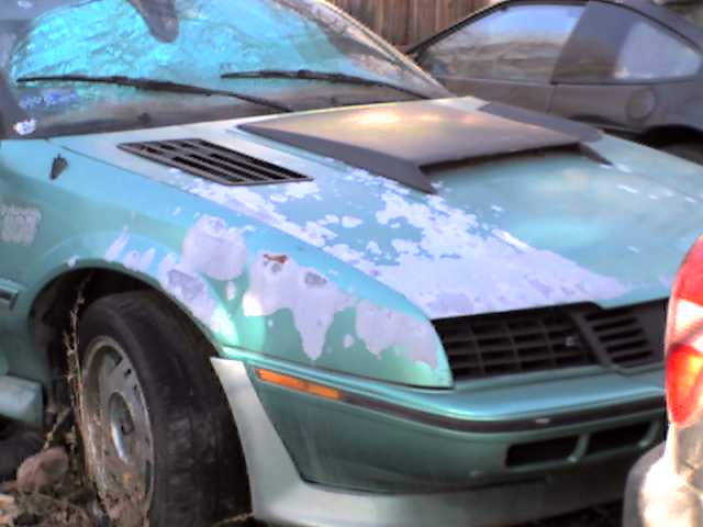

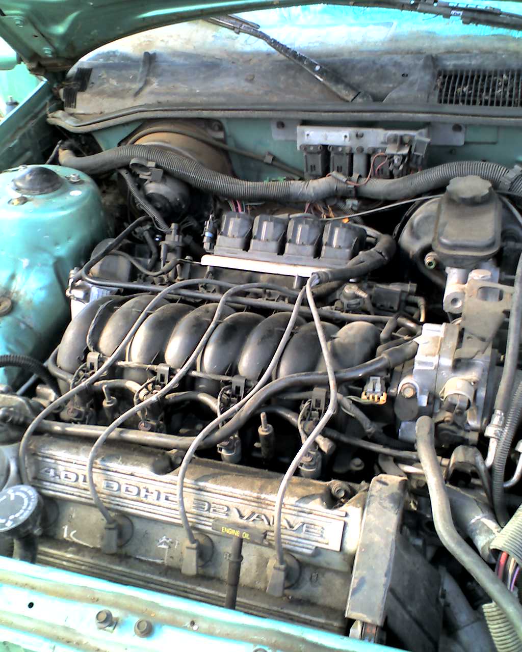

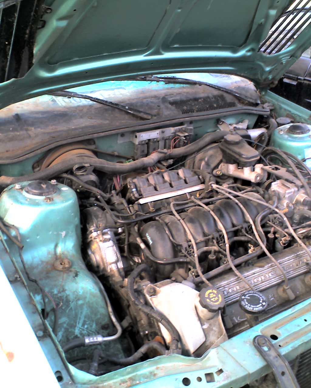

I don't have any new pics of the V-8 Indy. Here are the old ones from before I took it home. It is an original five-speed digi-dash car. Most likely, I will re-paint the car in black with teal accents and custom teal Indy decals. It also has a Fiero GT Wing spoiler, which doesn't look bad on the car, just a little big.New engine and tranny mounts, radiator hoses, a full L47 PCM re-wire, and a new dual-exhaust are in the works. I have, um, misplaced that radiator too, and it is virtually impossible to replace, so hopefully I can find it. This car was a kick in its' day, with 240 HP and a wicked V-8 note, I really want to get her up and running again, hopefully better than ever. I am concerned about the internal condition of the engine, as it seems to be stuck, so it will likely be coming back out again before being run. And, a new custom oil-pan has to be built, as the original modified pan was busted -why the car was parked to begin with. I still hear from people that the Northstar engines won't fit a Beretta bay. I don't talk much about the car, just because I am tired of arguing against ignorance.

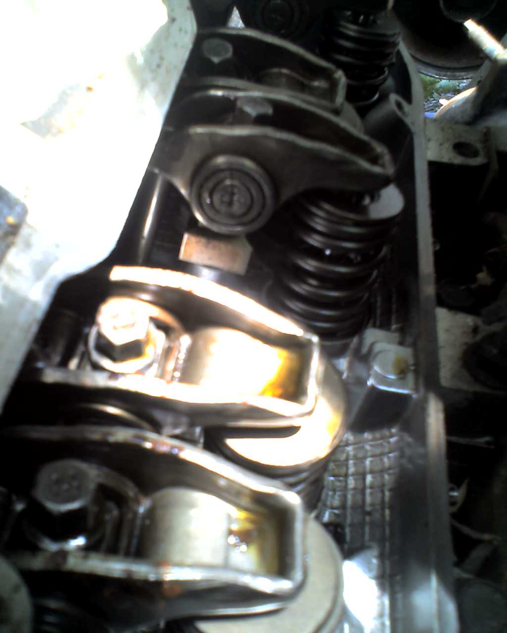

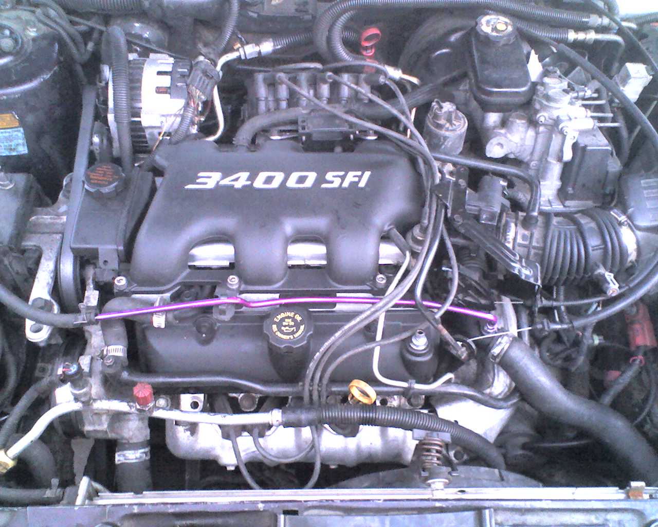

The Z-26 was also lying about her displacement -but the other direction. She actually has her original 3100 block, but with replacement heads and a 3400 intake and TB, modified to clear the 'M'-code 3100's taller valve-train. EGR will never be functional on this car again, but the PCV was actually hooked back up once the elbow was replaced. Not much of a 'swap', but neither is a full-on 3400 conversion, IMO.
At least not into the later-model cars where it bolts right in. In all honesty, it would have been easier for me to just swap a new engine into this car than to pull the engine apart inside the bay -it need both heads replaced, and one piston had impacted a valve after the head was so badly over-heated that it dropped the valve-guides out. Pulling a 3X00 pan while the engine is still attached to the auto-tranny sucks, especially in sub-freezing January temperatures in the middle of the night!
