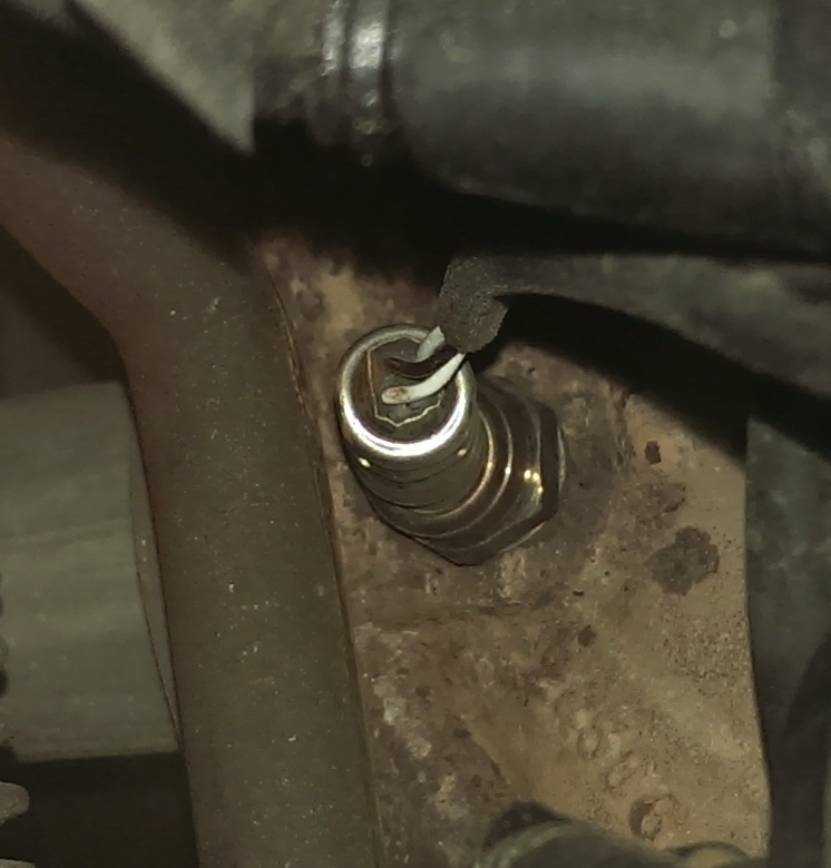

Car has been running perfect no issues at all!!! Then I decide to finally install the custom t-mount (thanks summitbalt08). I drilled the bottom and all went in no problem.
After a day or two my SES came on, P0134.
Sensor looks bent, works when it wants to. Any short sensors out there? BTW, im running Grand Am 3400 exhaust manifolds.
I took a look and found this....

What did it hit? Was that a solid trans mount that you put in?

Its hitting the steering arms.
Ill make time and take it to the muffler shop and weld in a new bung where it won't interfere with nothing. (Only thing I can think of)

Yeah the Beretta stock location is on the crossover inlet so its not directly on top of the manifold and with the 1" movement necessary for a 5-speed alignment you loose valuable space back there. I never had a problem with my 3400 manifolds and the auto.

Would it matter if I have the muffler shop weld in a new bung on the downpipe right where it connects to the manifold?
Would my O2 readings change?
'14 C7 Z51 7SPD
Re: Oxygen sensor rubbing after custom t-mount install
If there are no leaks it should be just grand.

Just so you are aware there is a shorter O2 sensor that would probably work, in fact I have one on my GTP, its made by denso for C5 vettes, downstream, you will likely have to re-pin it but that's not overly difficult. It's .75" shorter IIRC.
