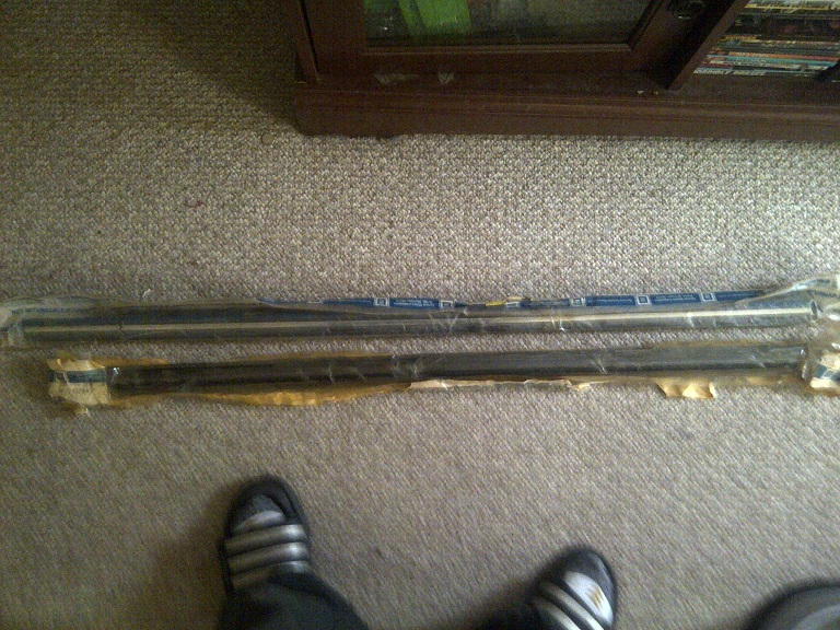

You mean like these......
88 GTU 5spd 67k black
08 TBSS LS2 AWD
Re: Exterior Door Window Trim moulding
Yeah and how long have you had those?
I have one where the rubber strip has a 99 date code on it so it's obviously not oem.
Offer still stands find some online retailer selling these and I will pay 1k.
SELL TO ME! :shock:
88_GTU
Posts: 474
Post by 88_GTU »

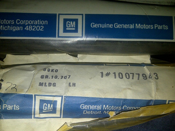

pretty sure they're OEM....
08 TBSS LS2 AWD
Miss understood my statement... I mean original run for production... a seal with a 99 date code was obviously not produced to be installed on a new car, it was made as a replacement part, so the dew strip I have was never installed on a car at the factory, it was more than likely purchased to replace one probably like the ones you own so they are not as old as the newest Beretta.
