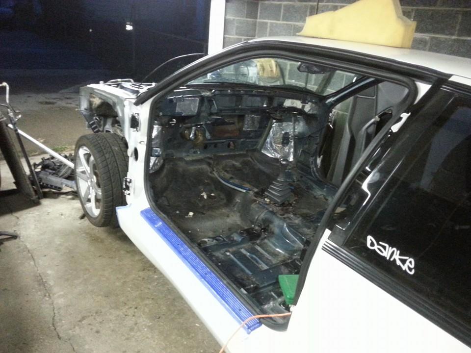

interior and engine removal

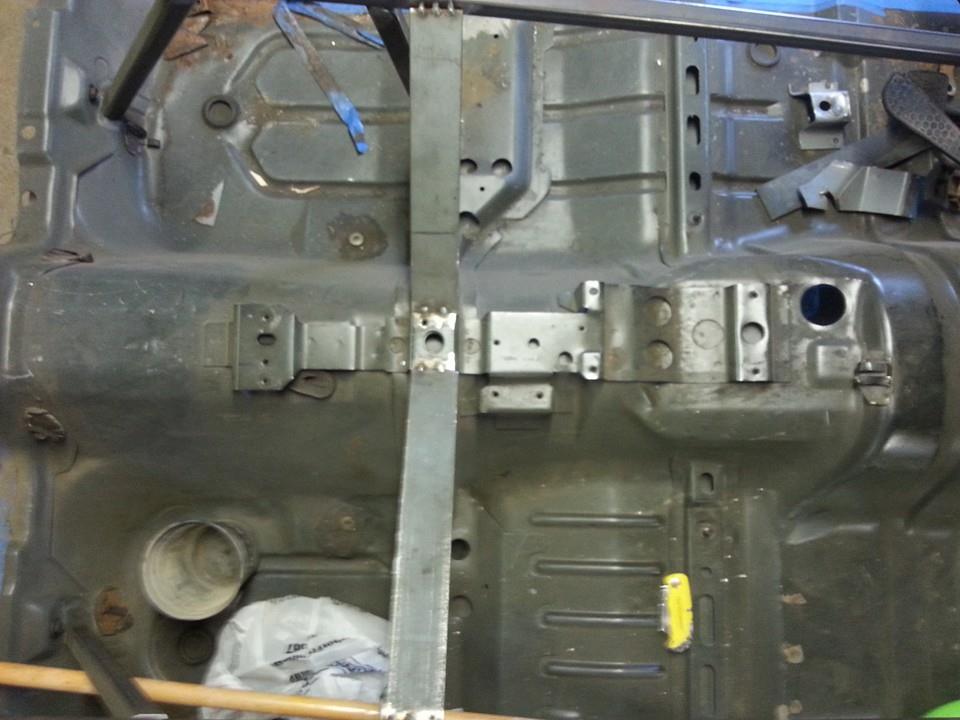

Looking good my man. Can you get a pic of the Camaro floor where the ebrake cable goes through the tunnel?

i think this is what ur looking for.......I know u were asking about the cluth pedal swing points too....(awhile back) but i cant test fit that any more with the braces in the way.......
Posts: 4754
Re: Beretta Z28
Thanks! Is there any way I can get a look at the sheet metal hole the rubber grommet goes in to? I have the ebrake and that grommet on the cable, but I need to replicate the same hole in the sheet metal for a clean install.

i can see if i can get the grommet out tomorrow to see what the hole looks like

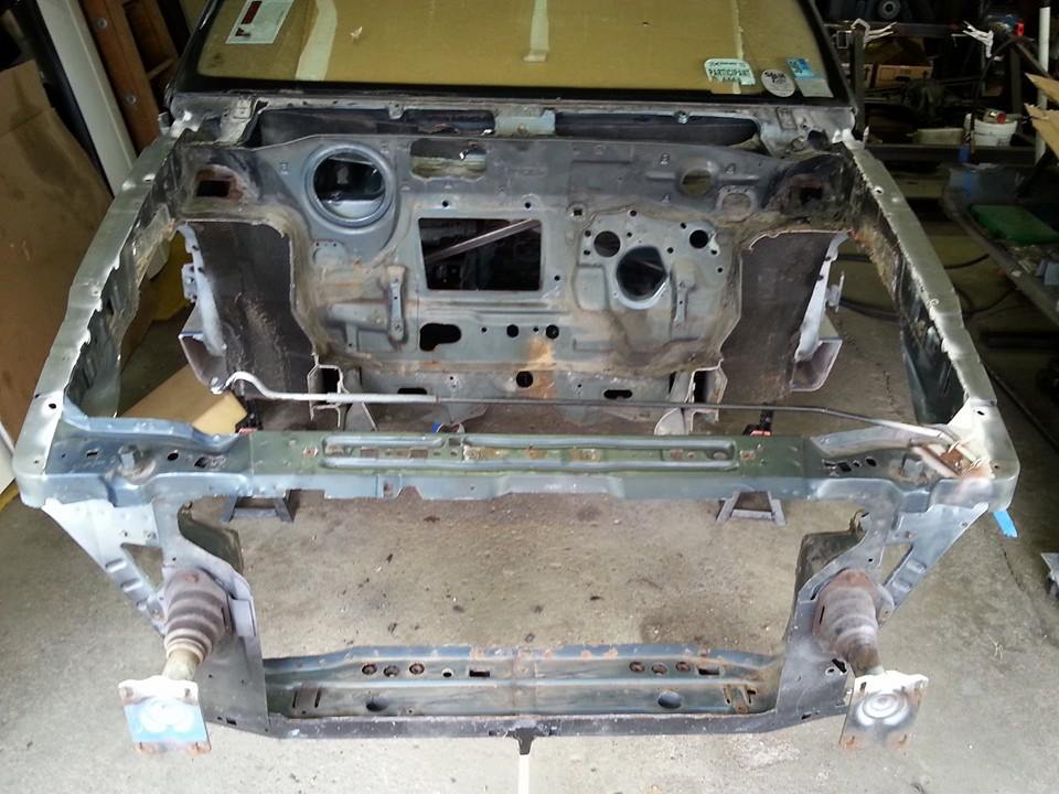

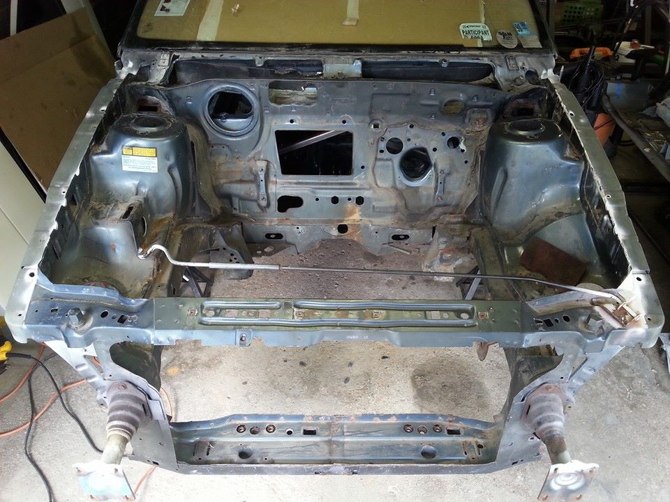

engine bay and fire wall and unibody stripped .......and rear end and gas tank also out.

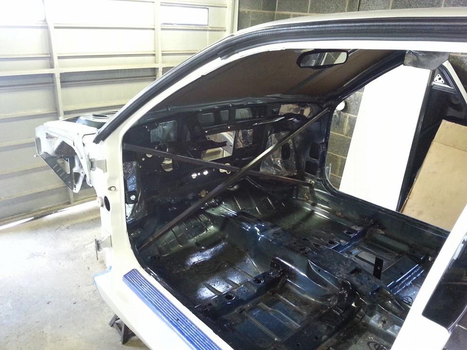

body/door bracing tacked in

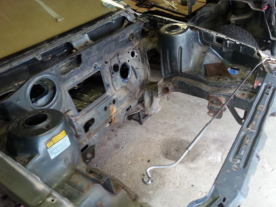

front rails and firewall removal

Are you going to reinforce the front to back at all with some cross bracing?

jjanke
Posts: 425
Re: Beretta Z28
Post by jjanke »
@ bonecrusher......i wasn't planning on any front to back reinforcements.......i am leaving the inner and outer rocker .....only cutting out the floor pan where it turns into one sheet .......... the rocker should be enough front to back rigidity with the door braces holding the side to side while im doing the transplant.........
...It definitely wouldn't hurt to add extra braces might think about making another trip to the metal store...............
