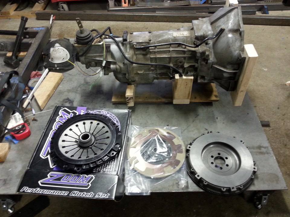

Well its been awhile since I posted about project...... .made a lil stand to help support the t56 during install and almost ready to install the new external balanced fly wheel and zoom HP Kevlar clutch and pressure plate. Just waiting on some new bellhousing bolts and the new flywheel bolts.

Re: Beretta Z28
Yup, same funky style pull clutch I got. haha
Re: Beretta Z28
...Also used on the Muncie/Getrag 284 found next to the 3.4 TDC quad-cam engine in a few W-bodies. Getting very hard to find parts for that thing -glad mine was already rebuilt, getting worried about future clutch replacements though...woody90gtz wrote:Yup, same funky style pull clutch I got. haha
That T56 is awesome, jjanke. Double-overdrive sixth... Very jealous here, as I have three Camaros that would benefit from those transmissions and the extra gear, if I only had unlimited funds for upgrades.
I know how winter can slow progress down, but your work is still really impressive. You got a lot done in not a lot of time last year. When do you plan on moving on to the Beretta-side of the project? What other goals do you have on the Camaro-side before you are ready to start in on the other half?
