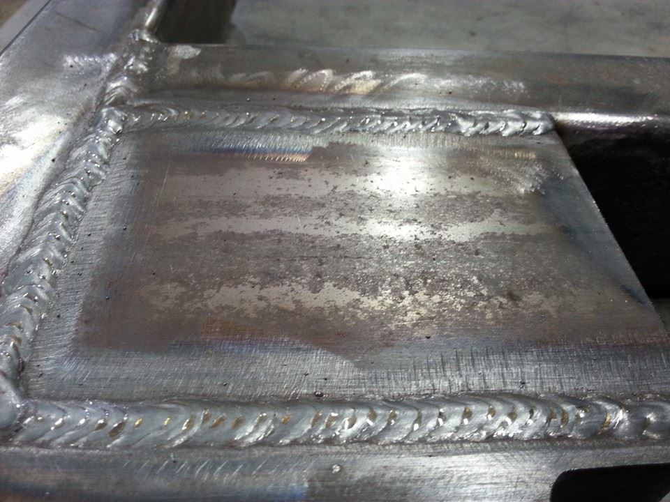

I think I said it before but I'll say it again... it's nice to see a build and pictures of REAL quality welding.
Re: Beretta Z28
i wish i had a quality welder to learn with! someday!

Re: Beretta Z28
This thread restores my faith in humanity
Damn bro! Those welds!! Come weld some stuff for me! LOL
Re: Beretta Z28
haha thanks guys....... as i said .... im obviously taking pics of the best looking ones....... but yeah with that Miller 211 with auto set it really takes any of the guess work out of it....... now there are times where i will have to dial it in a lil more....... welding different thicknesses together and welding upside-down is much tougher......

Added some gusset plates across butt welds on the trans tunnel and added gusset boxes on the 4 inner corners of the rear sub.....im sure im overlooking something ...but I think the metal fab work and welding on the rear sub frame is done !!!!!!!! gonna put some caps on the top of the panhard bar mounts to seal em up......
